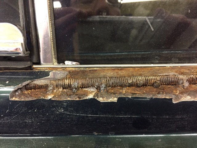

    Kids...don't try this at home.... Thank goodness I decided to attack this now. No telling how bad it would have been if I continued to leave it and let it collect water for a few more years. :/

    Looks like you'll need to gut your doors to strip/blast the rust from behind the window fuzzies as well. If you can set the doors up on some sawhorses away from the car at least you won't be spraying the inside of the car with sand and dust.
    Looking like a major job now for sure.

    looks like a piece of Redi-Rod stuck in there for filler....

    Damn that last picture is BAD lookin good thing your going to fix it now. Roger

    Actually, it cleaned up pretty good. I'm still going to blast the area before I prime it, but removing the doors and blasting inside is out of the question for now. This is not the only stage of body work I'll be doing and will ultimately strip the car all the way down, but not right now. I will be removing the fuzzies however and replacing the gl***, so I'll be able to check for serious rust there, but hopefully I'll be able to just clean it up and POR 15 it like the rest of the interior.
    Here's a shot of the same place as above, but all cleaned up and ready to blast.

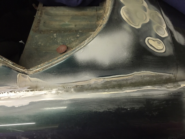

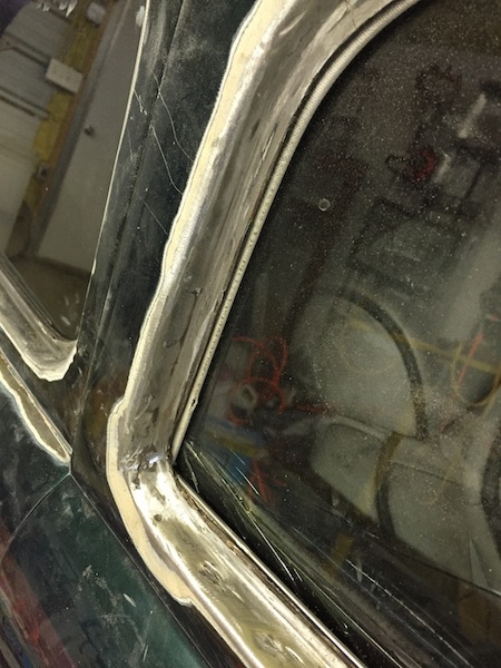

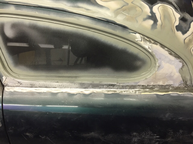

    A little more progress. Finished cleaning out the window frames and sanding down all the spot welds around the perimeter. Today I rolled the car out and sandblasted all the window frames, a few spots on the windshield channel and all along the belt line pinch weld seam. Cleaned up the huge mess then got it all in self etch primer, except for the belt line seam which is in weld thru primer in prep to weld the seam solid and not have this problem pop up again. :)
    You can see the difference here between the blasted and unblasted sections of the belt line seam.
    Ahhh, all nice and sparkly clean...quite the contrast from last week and the mess that was in this very same spot.
    Never mind the blasted gl***....it is about to all be replaced with green tint rather than the smoke tint. ;)

    As per Alchemy's suggestion a little ways back from when I first started digging into the belt line seam, welding the entire seam has begun. I finished up the driver's side this today. The section under the 1/4 window wasn't too bad, but going down the top of the fender from the rear window to the trunk was surprisingly tricky. It's a tight angle and was tough to get the welder tip down in there and was even harder to get down in there to grind the welds smooth. I got it though, finally. I generally end up doing way more grinding than I do welding, but my skills improve each time I tackle something, so I guess that's good.
    In hind sight, I wish I would have welded a little bit then ground those welds before welding more...that would have made it easier to make sure I kept my profile the way I wanted it. I didn't want a large radius down in the corner since I had to keep it consistent with the belt line profile stamped in the door as well as the trunk lid coming straight down onto the top of the fender with no radius. But, live and learn and I'll do the other side better. :) The messy welding and the very patchy patches from where the rear window was welded back in didn't help me much, but I just had to keep in mind someday I will cut the whole window out and redo all that metal work and not stress about it today. ;)
