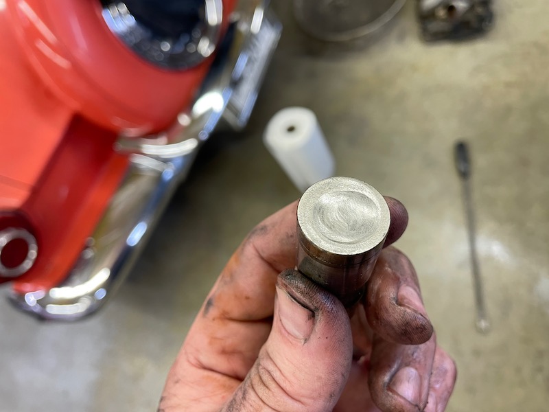

    Nailhead......
    Well, not really....SBC, but I did find this finish nail laying underneath the valve cover when I pulled it this morning. Why did I pull the valve cover you ask? Well, last year it started running suuuuper ****py and was behaving like it had jumped time. Suffice to say I got other stuff going on....a big house reno, new grandkids, finished a new motor in my '50 Chevy, blah, blah, blah, so it's just sat. Finally had some time over the last few days to mess with it. Started it back up and ran fine and dandy at idle, but not so much once any rpms were put to it and a nice banging developed at cylinder one....thus the pulled valve cover.
    Exhaust valve wasn't moving. Pulling the rocker showed the stud still in place where it belonged and a straight push rod. Turned it over with just the push rod and no movement to speak of, so off comes the intake....
    Was hoping for a hole in the top of the lifter but naaaaahhh. :/ At the very least there's no doubt been metal floating around the system, so I guess it's best to pull the motor and see what we got. Of course, me being me, this means there is likely to be a whole sweater unravel behind thread I'm pulling.....just been driving it since any real forward progress was made 7 years ago (!) when I painted the top half, so here we go digging into it again. :)

    Doh! Thats not supposed to look like that but would explain it running bad. :eek: Now would be a good time for that nailhead you mentioned. :D

    Swap cam and lifters pull the pan, clean it out ..... maybe spray some diesel on the bottom end to wash off any grit that might still be hanging around, and slap it back together. I've done it..... got about 15k miles before a non-related issue ended up killing the motor.
    If you pull it, you might as well rebuild it. If you swap the cam / lifters and the bearings fail.... you still end up rebuilding it. But there is a good chance you kick the can down the road for quite a while.... i'd take the risk...... always plenty of guys that like to make things much harder than they may have to be. Considering the risk being the cost of a shortblock, ain't no way I'd pull that motor.

    I agree Clay. That may well be the way I go for now. Seeing the price of the long block through Bob, I can't see rebuilding this motor (a 305)...the 350 with a warranty is just money better spent. That being the case, I really have nothing to lose with this motor putting a cam in it the way you say since push come to shove I'll replace it rather than rebuild it.
    So, mechanically minded people...what would be a reasonable cam to slide in if I went that way? I can screw a motor together, set it up and make it pretty, but picking components like cams and such I really don't have a clue other than to say things like "mild street cam" or "RV cam" without know really what any of that means. LOL Motor is an '85 305 out of an IROC Camaro running an Edelbrock 4 barrel and HEI ignition.
