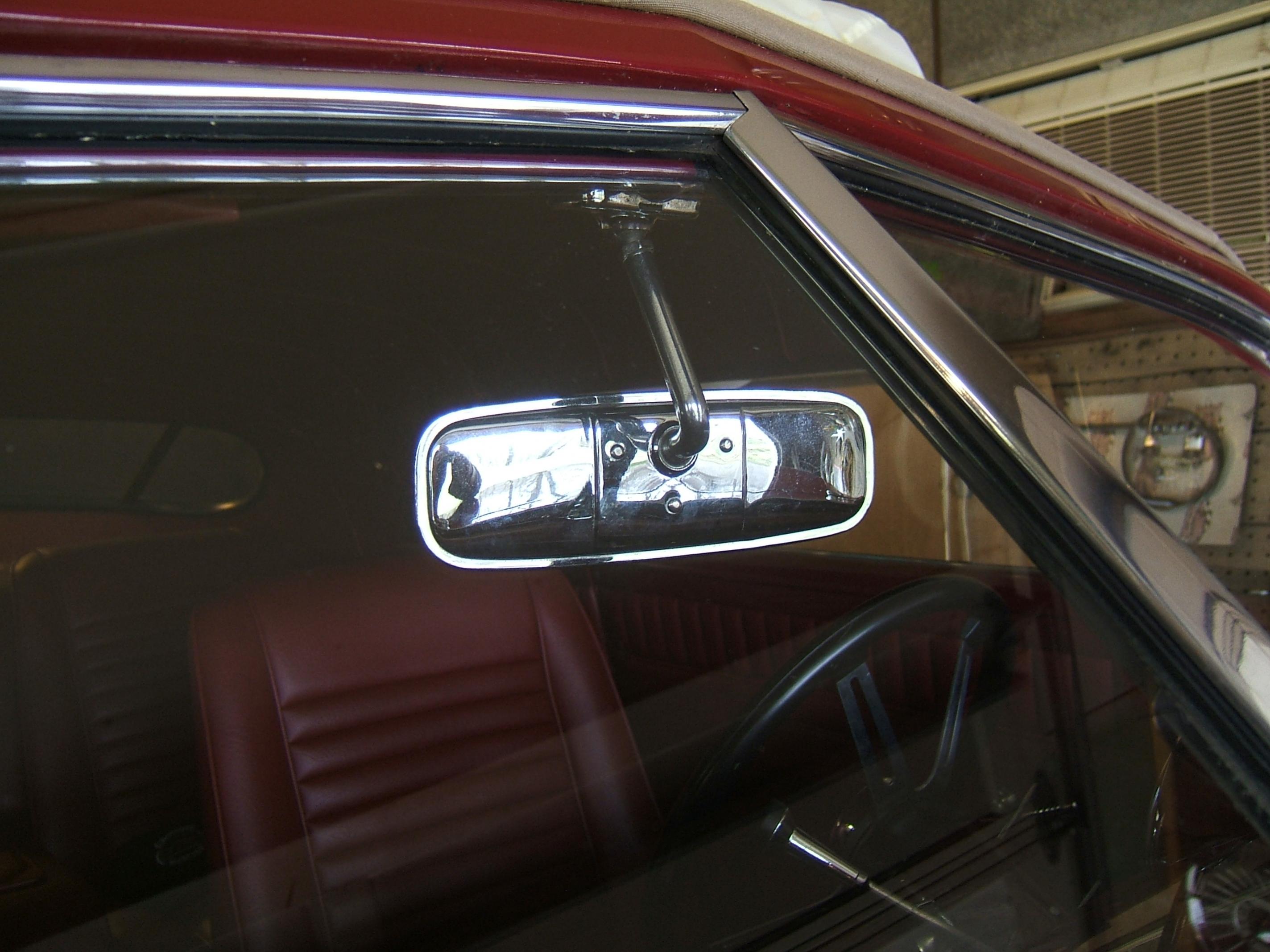

    Here's a little something that will maybe help you restore a little faith in me Roger. :) The merc came with this yuckola large black plastic mirror (complete with shiny silver AAA reward sticker on the back side) of unknown origin:
    Not only is is ugly and doesn't belong, it is clearly mounted in the wrong place in relation to the garnish moldings. When I went to the Merc Gathering at the Sacramento Autorama a few years ago, one of the things I really wanted to look at was what all the "greats" used for rearview mirrors. Most of them didn't really have anything, and some even had some surprising things (Zocchi's Cool 50 had some kind of chrome mirror attached to a small piece of strap screwed to the garnish molding). The Hirohata Merc had a nice chrome mirror of some 50's vintage that really looked like it fit. I could not get close enough to get a good picture of it, but thankfully, Rik Hoving had a picture that had a decent view of it. Using his picture, a few eagle eyed HAMBers were able to identify it as a '56-ish Cad.
    Armed with that information and Rik's picture, I scoured the swap meets for such an animal as well as picking up some other contenders (none as good looking, though). Finally, I ran across one at the Iola swap last year. It turns out the Cad has three screws and it looks like whoever mounted the mirror in the Hirohata cut the middle ear off and only used the two outside screws. Fitting it to mine, the third screw is fine, so I left it. Last night after finishing the wiring, I finally got to mess with it and went ahead and mounted it. I apologize for it not lining up well with the garnish moldings....mine fit terrible, so I think it is more a garnish issue than a mirror fitting issue. It still fits closer to the garnish and looks waaaaay better than the late model one. I have another set of garnishes that I will eventually cut and make fit right...and then chrome. ;) While the mirror could use a new head, in the mean time I'm thinking of doing a Minnie Pearl and leaving the $20 price on it...LOL The other thing you can see in these pics is my headliner is toast. It appears that whoever built it never painted the underside of the roof and over time the surface rust has stained the headliner. I have tried to clean it to no avail....but hey, I'd really like a full length tuck and roll one anyhow, right? ;)

    Kongrats to ya Dave! I need to replace my late model rear view mirror, Going to start
    copying your ideas.
    Happy Trails, Mick

    twochops
    Used repro 57 T-Bird on my 49 Merc.
    TwoChops

    Cheezzee, I wish you woulda asked me for a mirror, I may have a '55 Cadillac, and I think, even one day/nite mirror...hope you're not leaving that fuzzy "muff" on it...and you'd better be close, Mick's event is coming up fast...sorry to say, we won't be there this year...we're going the other direction...

    Haha! Well, actually, the one with the muff is the mirror in the Hirohata and the muff was knitted by Jim's wife, then girlfriend in '59, so I guess it's gonna stay there. No furry mirror in mine tho.
