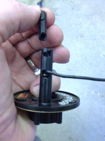

    The last part was connecting the wire from the canceler to the Merc horn contact. Ordinarily, the wire comes all the way up the shaft (thus through the hub of the steering wheel) and plugs in to the GM horn ****on. Certainly, I didn't want this wire all the way up to the front side of the wheel, so I drilled a hole in the side of the shaft above the spring inside. I also made a notch in the bottom of the spring retainer (the wire used to come up through the retainer) so the spring would still be compressed down tight, but not pinch the wire now coming out the side. Crimp a connector on the end of the wire, screw it to the Merc horn contact just like it was done in the stock Merc column and whalah (I'm sure there is actually a fancy spelling for that word), instant GM to Merc horn adapter. :D
    Here's the whole pie in the column just before install of the wheel. I will mention here I had intended to glue the PVC adapter to the GM canceler to keep it from floating around and possibly riding up and inadvertently contacting the horn ring, thus setting off the horns. It worked out that when I put the whole thing together, it clamped down on the canceler shaft and I don't think it's going anywhere.
