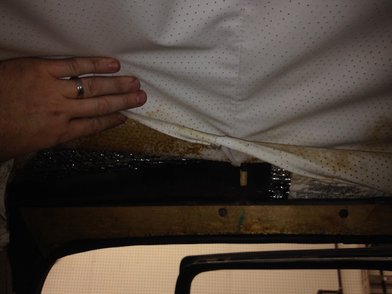

    Oops!!! Looks like the snowball is starting to roll. ;) Sorry Mick and John, I could't help myself. The good news is I can do a lot of the work before removing the windshield, so it's still drivable for now (it's sitting outside the office right now, actually). I was surprised to find that the headliner did not go under the gasket like it did at the back window. Although, I was prepared to cut it at the gasket if I needed to so I could keep the gl*** in for now.
    Thanks for the vote of confidence, you are too kind…and give me too much credit. I don't see myself as a man of many talents so much as a man who is not afraid to screw something up in the process. I too often find myself saying, "how hard can it be?" LOL
    Good news is that while there is surface rust under the headliner, it's not too bad. It is worse around the edges. It's almost as if the spray adhesive that got used corroded the metal. I may find on closer inspection as I start to clean it all up that it's not as corroded as it appears and just glue mess. Odd that the glue turned brown like it did. All the staining on the headliner is only where there is adhesive. There are no water leaks around the windshield or the back gl*** (my windwings fit poorly and leak, but that is a problem for another day), so I don't think I am really dealing with any sort of moisture problem.
    I'm also going to make a new package tray as the vinyl is stained and faded on this one and I'm really no fan of the way the speakers were done. When I removed it, I was greated with this big honkin' hole that someone cut into the deck, presumably for clearance for the speakers. Since I don't own a bead roller, I've already talked to slddnmatt about making me a patch panel. I have some of his floor boards that will go in eventually and he does great work, so obviously he was my go to guy.
    My big plan is pretty much to clean everything up, address the surface rust, paint everything in POR15, put in new insulation, sew a new headliner and package tray, new windshield (with stainless) and then finally to put in the new flatter back gl*** that started this whole thing (putting the stainless around it as well). Funny, it was the first piece out and it will pretty much be the last piece in.

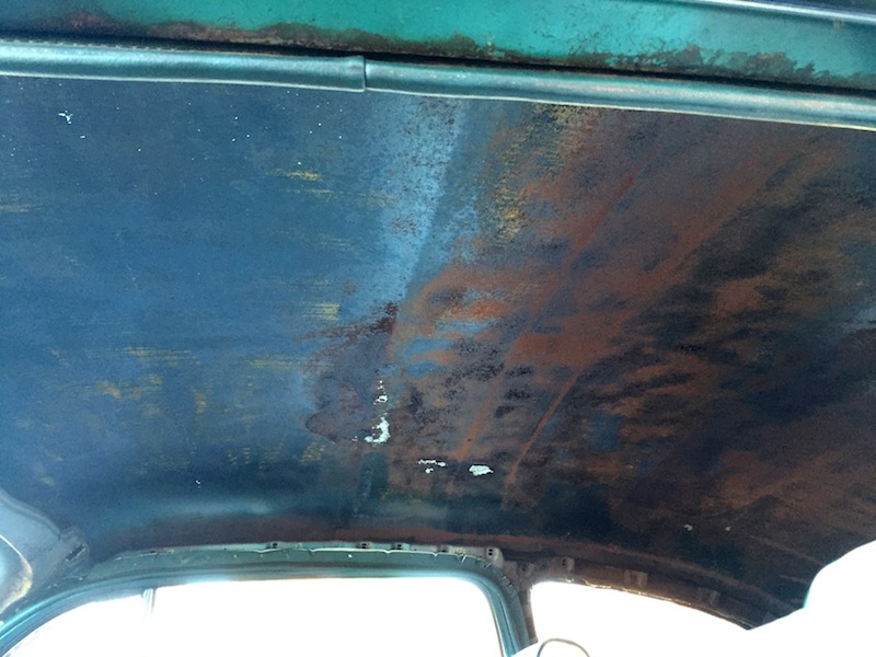

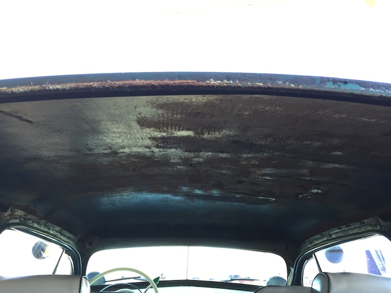

    Update time. Progress has been slow with the holidays, etc. But I have eeked a little time here and there to make some headway. First step was to clean the rust and yuck from inside the roof and get it painted. I have finished the messy part of the job….even with blankets covering everything, that mess gets everywhere! Messy job no matter when you do it, but really a federal clean up zone in an upholstered car. No one ever said I was smart. ;) Anyhoo, the inside of the roof is de-rusted, cleaned and prepped for a coat of POR15. While I was at it, I s****ed all the old undercoating under the 1/4 windows and will paint that as well and put in some now sound deadener. Hoping to start splorking paint in the next few day. Yeehaw!
    Before:
    After:

  15. Did you use a wire wheel? I have glue on my roof.

    Thanks guys! Hate to think of the stuff that ended up in my lungs over this deal even with a respirator. Well, ya gotta die of something. ;)
    John, I used one of those woven 3M stripping wheels on a sander. You can find them with a shaft for a drill, but I used the ones with just a hole in the middle and just mounted in one of my sanders. I have been using them to strip all the paint off my '69 Mustang and had it handy so just drug it inside the Merc.
    Before this vinyl headliner was in, there was a velour one and there were still bits of it stuck in glue around edges along with lots of the glue from this headliner. It did a good job on the glue and velour bits, so might be a good choice for you to try.

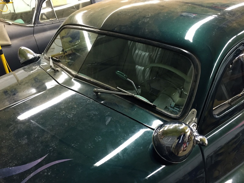

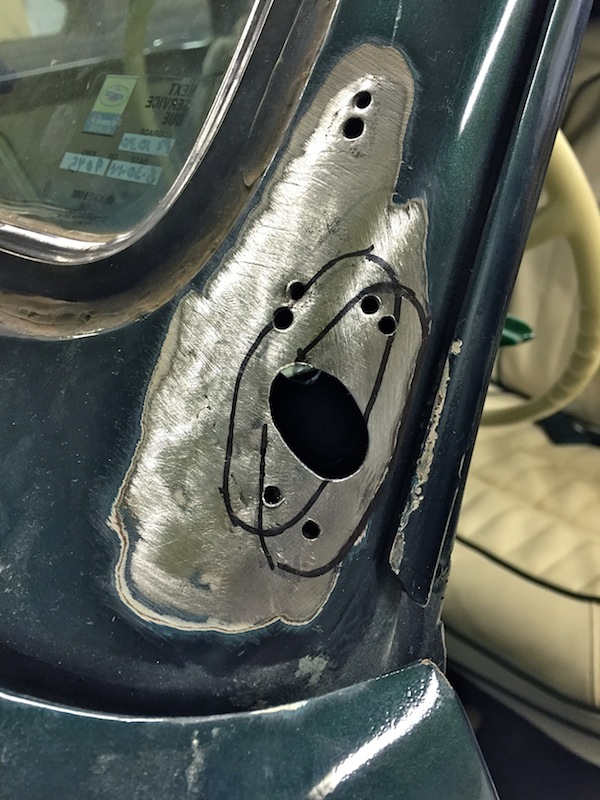

    After much more finagling than I expected, the Appletons are mounted. I studied piles and piles of pictures of early custom Mercs to plan the placement of the spots. I found the location of the bracket generally put the spotlight shaft pretty close to the level of the bottom of the windshield, the bottom of the side windows and towards the outside of the c pillar. I made a sharpie mark of those two lines and marked the tentative spot of the bracket near their intersection.
    Kurt McCormick gave me a tip a few years ago to use a large C clamp to help line up where to drill and this proved to be a big help. Clamping the bracket to the c pillar in the area where I thought I wanted it, I was able to tweak the bracket placement so the inside of the clamp hit the target of where I wanted the shaft to come out….for me I was shooting for the bottom outside corner of the garnish molding. The brown you see on the inside of the pillar isn't rust, surprisingly….it's the aged spray adhesive that stained the headliner that prompted me to replace it and prompted me into this round of un****ifying. I've never seen adhesive discolor to that extent before. Crazy. Anyhoo, the C clamp helped visualize where the shaft would hopefully be and I liked where it lined up, clearing the dash and being nearly horizontal with the belt line, which was the goal. I drilled the screw holes for the bracket and mounted it to the car.
    Reading all I could about spot light mounting, it was obvious that a drill guide that fit in the bracket would be most helpful. Not owning a lathe, making a "nice" one from scratch wasn't going to happen. So, off I went to the hardware store with bracket in hand looking to see what I could find that would serve the purpose. The plumbing aisle seemed the logical place to start and I quickly found that a copper 1/2" male adapter screwed into the bracket with enough thread to be stable. I then found that a copper 3/8" coupling had a 1/2" id and fit the drill bit perfectly (I had to file the little stop dimples out of the inside). Now the perfect thing about these two pieces is that od the coupling was just a hair too big to fit the id of the adapter. So, a few minutes with a rat tail file inside the adapter and I could tap the coupling tightly inside and viola….drill guide.
    brEad likes this.

    The inside of the roof looks good, and I like the thought you,ve put into the fitting of the Appleton.

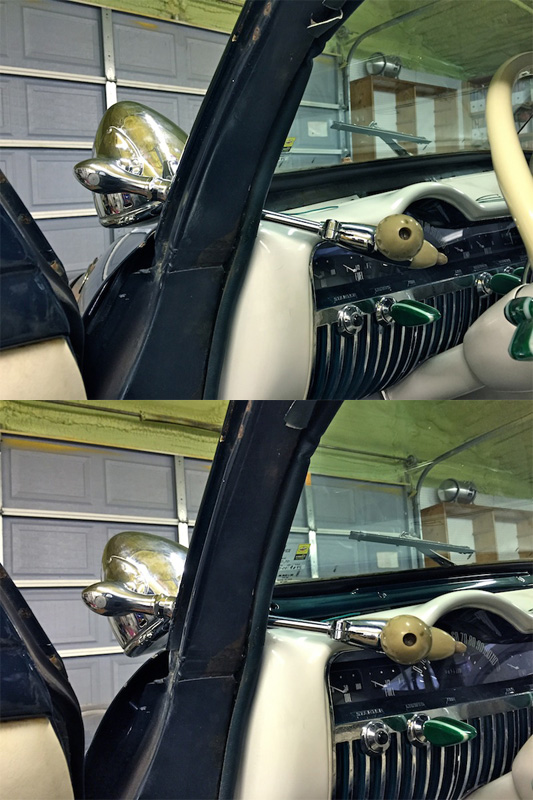

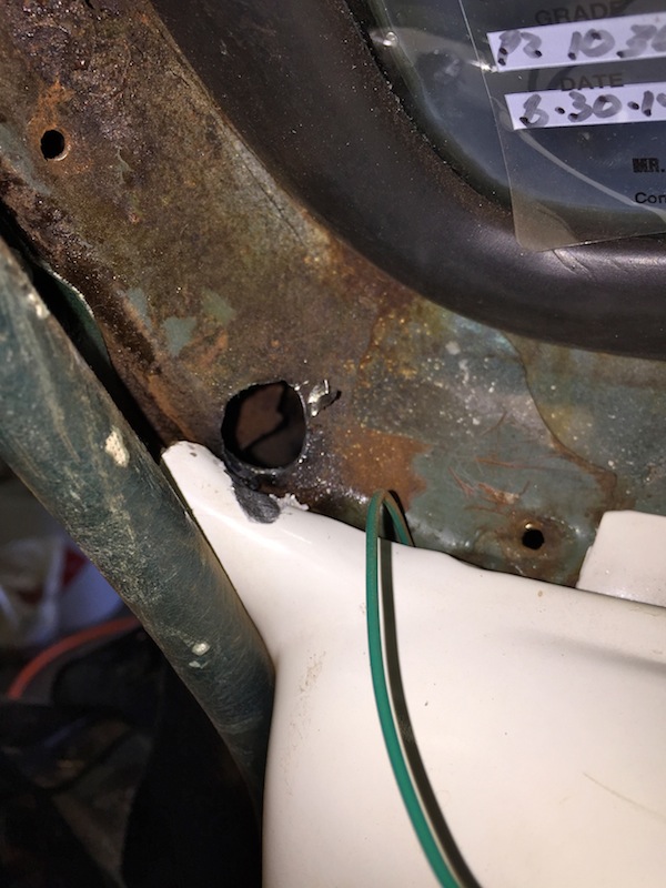

    Time to take a big breath, pull up my big girl ******* and drill the hole. While the guide does help line up the bit, it's important to note, the bit is hitting the pillar at an angle….especially when it hits the inside of the pillar and will want to wander. So, don't go hog wild with a ton of pressure and speed, cuz the bit will want to wander and if it does, it will grab hold of the guide and want to spin it further into the bracket…..which is NOT 1/2" pipe thread. Not sure which would win the cross thread contest, the pot metal bracket or the copper fitting, but best not to find out. A sharp bit, easy on the speed and pressure is the way this deal best goes down.
    When it was all said and done, the hole came out on the inside right where I wanted it. Yeehaw!!
    Time for the moment I had been waiting for since I first got the spots several years ago. My excitement dwindled greatly as soon as I slid the light in and saw the angle of the shaft. My intention was for it to be nearly parallel to the belt line, but it was clear I was way off.
    Hours of going back over my reference photos and a few sleepless nights ensued. The handles cleared everything and I was able to move the spot as it should and I appreciate it's a silly detail to get all worked up about, but it was not what I was shooting for. Rather than accept it, I set about to remedy it, knowing I would have to hog out the holes and weld back the extra when I was done. The conclusion I came to is that once upon a time when a fella could just go the to parts store and buy a new set of 552's and the specific brackets for a '51 Merc rather than the universal brackets most of us are stuck with these days, the "real" Merc brackets must have had a greater angle so the shaft would be horizontal. No matter, those days are gone and not having any hen's teeth on hand (original Appleton brackets left and right 990 for 49-51 Merc), out came the die grinder and the holes got bigger. I also trimmed on the brackets to help change their angle to the post. I ended up moving the bracket down and to the outside a bit more and was able to improve things quite a bit, but I'm still not all the way there. Not sure I'll be able to get them exactly, but I'm happier.
    Made a pattern to transfer to the other side, wash, rinse, repeat.
    Aren't the cat prints cute? :/
