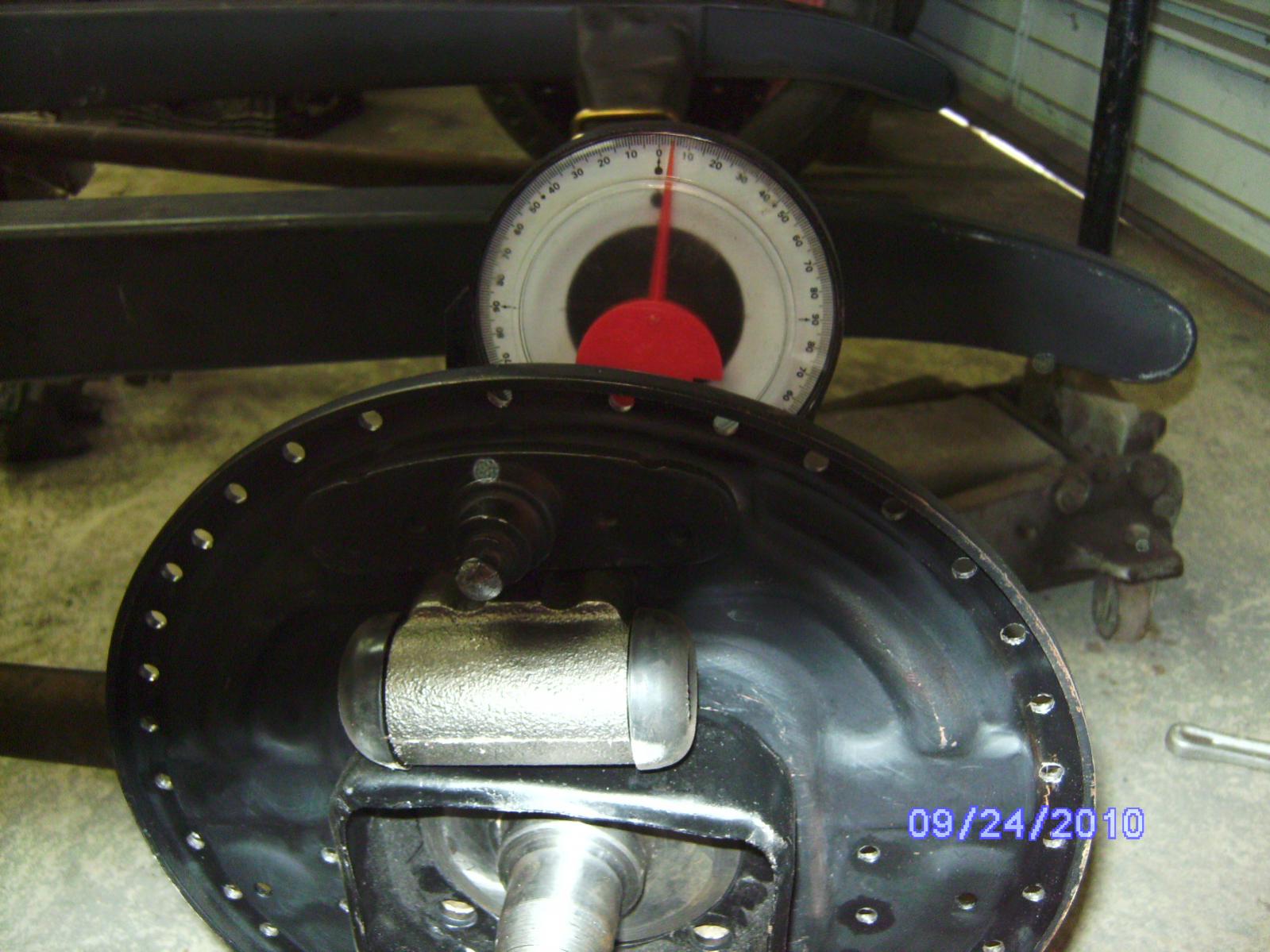

    Your front crossmember is welded in the frame at a certain angle, so that when your spring and axle are bolted up, the crossmember "sets" the caster, down through your spring and perches and then your axle and kingpins. The finger bone's connected to the hand bone! haha
    Your bones are used to lock that angle in and make sure your kingpin caster matches the caster set in the crossmember.
    So... just leave the bones unattached completely for now. Don't forget to factor in your rubber heights. I mocked my frame up with the tires on the front and rear axle, some guys do it without the tires on, but use a jig, or blocks or something that'd put the axles at the final height once the tires would be mounted.
    Set up the rear suspension of the car, you'll know you've hit the right frame height in the rear when the very middle section of your front crossmember reaches your desired caster angle. Lock in the rear height and pinion angle, TACKING everything in place!
    Then you go back to the front, lift the bones up until the caster on your kingpins matches the caster angle of the front crossmember, then you've got a bind free spring set up and your at the desired caster.
    If you ignore the engineered ride height, you can end up binding up your front spring using the bones to correct the caster. This is why companies invented adjustable spring perches and fully adjustable 4 links and blah blah blah...
    It's because when people just put the puzzle together the way they think it's supposed to go without fully understanding the engineering going on, they end up with a frunkied up car that only adjustable thingies can fix! hahah
    Follow?

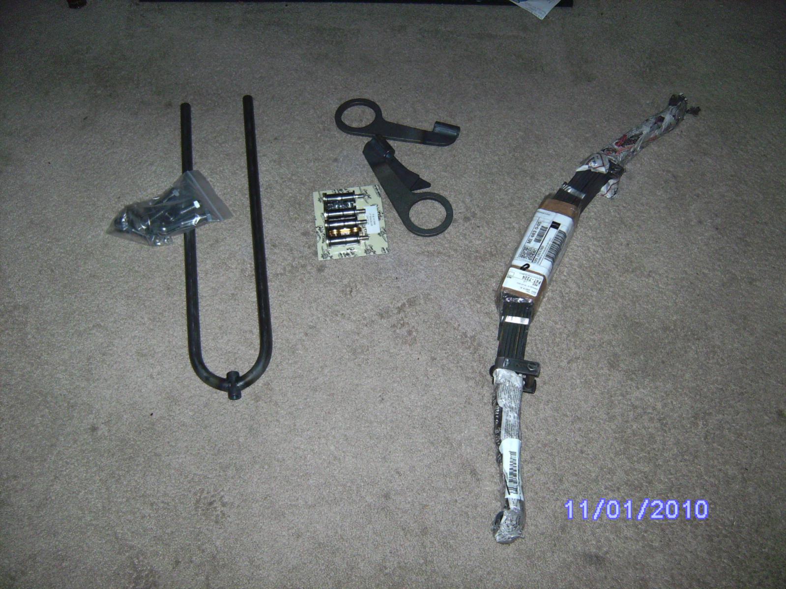

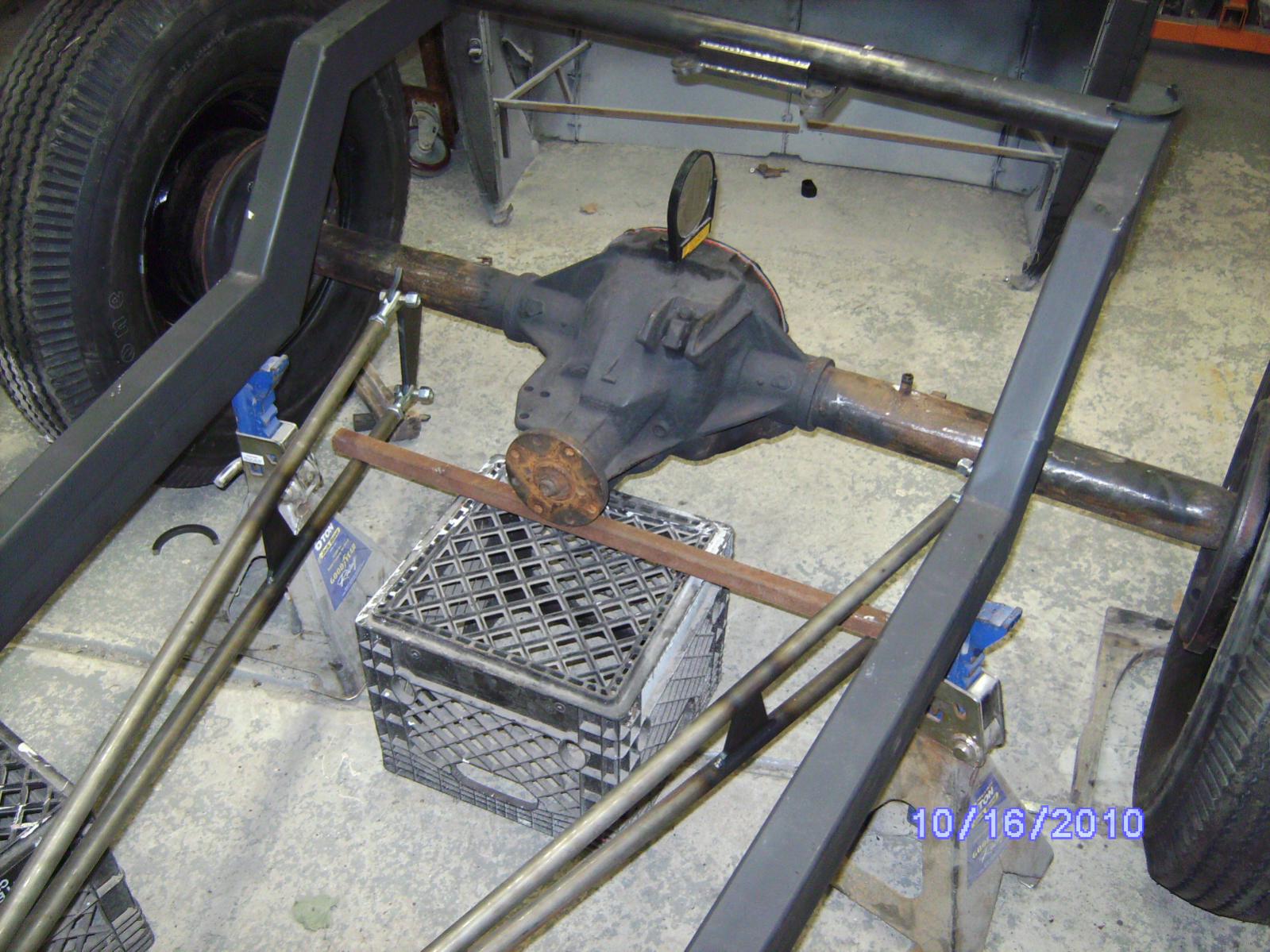

    OK..let me get this straight.I am installing my rear spring this weekend and what I have read on other posts is to install it this way..( anyone with a better idea,PLEASE let me know...).Now my spring is 42 1/2 long.Now I read that you ADD 4 to 5 inches onto that measurement and this is the measurement you use to weld your spring hangers ( brackets...) to the rear axle..So I need to measure 46 1/2 inches and then weld the brackets at this measurement...correct.? Then take the spring apart and use the main leaf and a method to SPREAD the spring so I can put the shackles on,then put the rest of the spring back together..correct..?If I have left anything out....PLEASE let me know...Thanks guys.
  18. Sounds like a **** shoot the way you're going to try it...just remember to tack things.
    When the weight of the complete car is on the spring, and the spring is mounted on the axle and the frame....your shackles should be at a 45 degree angle or close to that.
    Here's how I'd do it...take from it whatever you want.
    Put the rear axle under the frame with the tires on it, jack the frame up close to the height that it looks like it's gonna sit at. Get the axle situated square in the frame, roll it to the right pinion angle, and block it up there so it doesn't roll or move around.
    Then get a spring spreader, spread the spring so it goes flat in the middle, and that way you can bolt it up to the frame. Let the spring spreader off the spring and then let it hang at that arch. Put your shackles half way between 0 and 45. Mock the spring hangers on the axle at whatever width you have now. You'll have to make final adjustments on the axle there, moving it forward or backward to get the hangers in the right spot. You also might have to move the frame up or down and make sure that when your hangers go on the axle, you're not binding the shackles. Tack the hangers and the gussets on your rear axle, making all your measurements so that the hangers are in the exact same spot, side to side on the axle.
    Then, mount your spring in the hangers, you might have to use the spreader again to move the spring just a touch. Then let the weight of the frame down, and it should get you half way between 22.5 and 45. Add the weight of the body and the motor and all the extras and you should be pretty close to your 45 there. The spring will settle over time too.
    Or, do it your way and hope that you land at the right angle. Either way, you can't neglect your rear pinion angle, has to be bang on, because if you adjust it later, you'll bind that rear spring. Helps to have at least one extra set of hands.
    Good luck and have fun!

    Ok...Maybe it was working 31 hours in 2 days but I am lost on what your saying DZ.I dont have access to a spring spreader...cant find no one in Michigan I can use either.Now my axle if squared in the frame due to the fact that I installed my ladder bars and brackets already.Pinion angle is 3 degrees,pointed up.Now....am I supposed to take the spring apart and only use the main leaf to do mock up..?I didnt understand the part about bolting the spreader and spring to the axle..sorry,but being this my first build of this kind I dont really understand some things...sorry.

  21. Yeah he's right too, and you could use those measurements and just tack your hangers on the axle at that distance.
    You would still benefit from having the spreader though. I'd use the full pack and a spreader so that you can see your actual frame height as your working on it. You can make a spreader easy, do a search on here.
    It's hard for me to explain my suggestion any other way, I've done it that way and it worked perfect, but I understand it my own head better than I can say it and explain it someone else.
    Try chop top kids way, tack the hangers and gussets on your axle at whatever measurement your spring manufacturere says, use the spreader to mount the spring on the rear end and the frame. Let the spreader off and see where you sit. If you're shackles are hanging halfway between 22.5 and 45 degrees, side to side, with an empty frame and no body on there, you're good. If you're way over 45 degrees, you gotta widen your hangers a bit to adjust and vice versa if your shackles are looking almost flat.
    Don't forget that your hangers have to be at the same angle, front to back, that your shackles are at, so you don't bind the shackles up when you bolt it together.
    Hopefully you're getting this. haha. All I can suggest, if you don't follow, to pick up a good book on how to ***emble and build hot rods that use the same stuff you're using.
    I think you'll understand everything better when you start doing it. And if you tack everything, you can make minor adjustments the second time around. It's a real learning process and until you do it, it's hard to understand all the pieces of the puzzle.

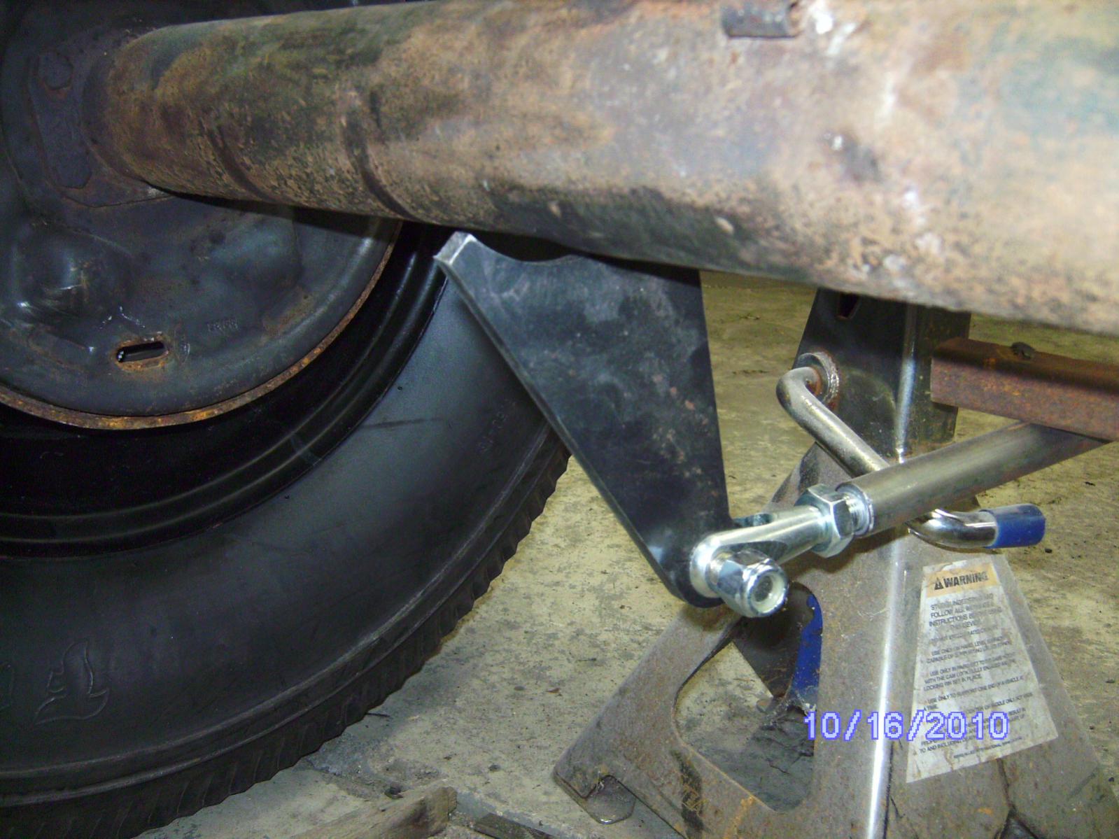

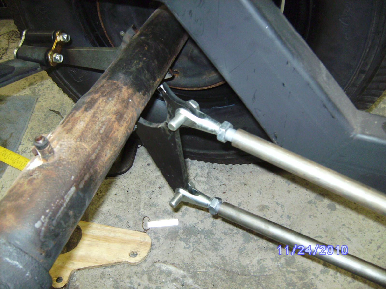

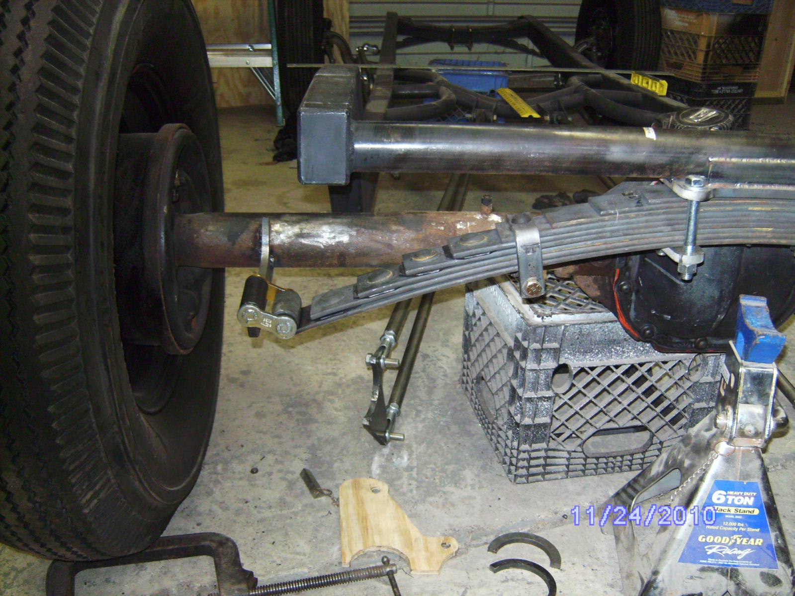

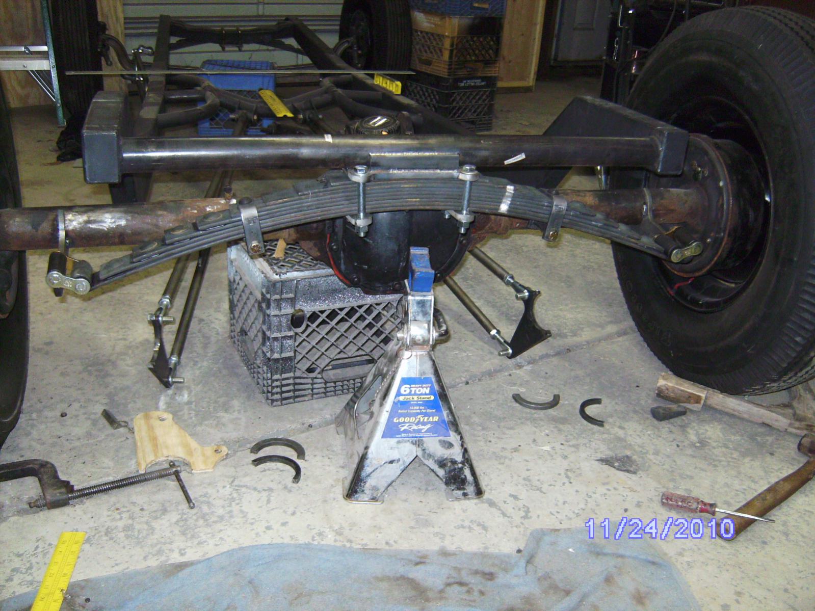

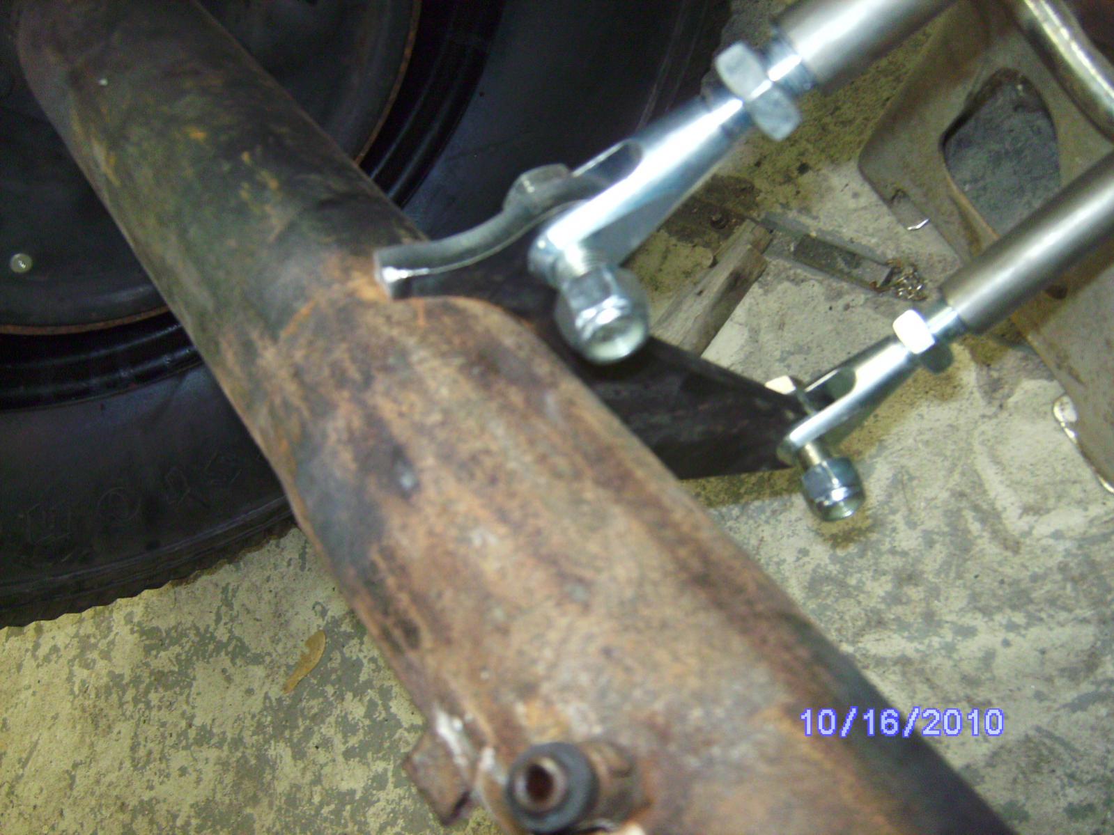

  25. Man....that's exactly what I told you to do! I donno if I'm my explanations are more complicated than they have to be or what??!?! Except for the "not using a spreader part"....you still gotta use one or you're gonna have problems.
    Even though your spring is not a high arch spring, it still has to be flattened out in between your u bolts when you're done bolting it up...Because of the wide style mounting pad on your rear crossmember, you need alot of frickin force to flatten that ****er out...even though it might not look like that...everything is under tension there...big time.... If you continue to crank on those bolts without using a spreader you're going to A. bend u bolts...pulling them inwards towards the middle of the frame or.... B. bend that mounting pad...yes it can be bent even though it's pretty thick...I've done it :eek:
    Then you're gonna have a car that sits tilted. Not to make you paranoid, but you really do have to watch out for that stuff. Just because somebody tells you something at the manufacturer, doesn't mean it's %100 correct either. Now....if you had a small mounting pad where the u bolts were close together, like in the front, then you wouldn't have to use a spreader.
    Trust me, I've made this mistake and it's annoying and painful to correct. Just figure out a spreader, it aint that difficult, use it to take the tension off your u bolts when unbolting after mockup, and use it again to put it back on the car.
    -Steve

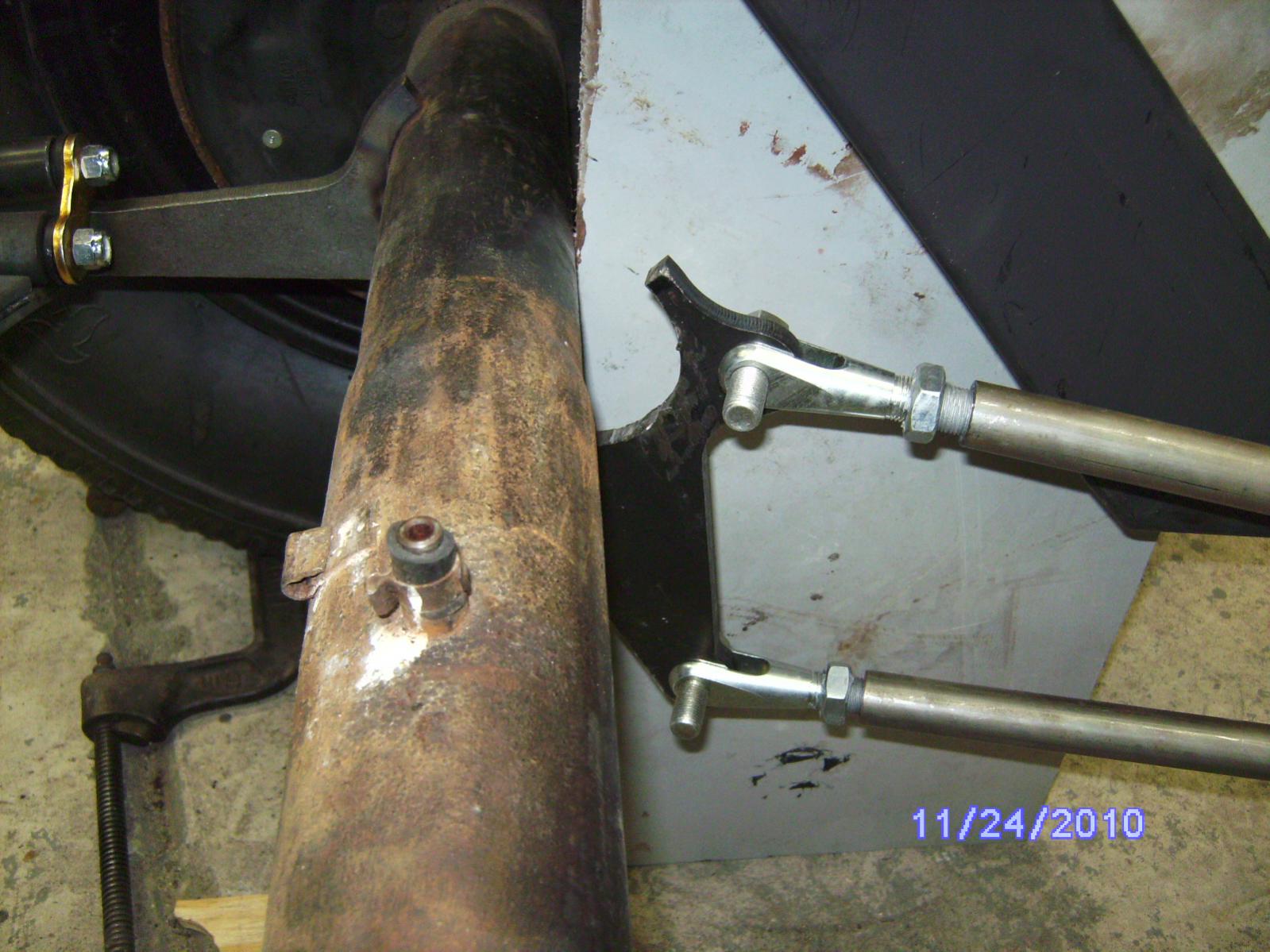

  26. And as Chop Top Kid said...your spring hangers are definately on there upside-down. If you leave them as is, your shackles are going to smash into your hangers when you go over a bump.
    Think about it....hit a bump...spring compresses...shackles swing well past the 45 degree mark and they run into your bracket. If they're on the right way, the shackles are free to move through the arch.
  27. Sorry to keep going on and on here, but you gotta take control of the direction this thing is headed in...it's gonna get ugly if you start hacking and modifying.
    Get the right ladder bar brackets from the frame maker...simple. You paid alot of money for that frame and the parts to ***emble it....the idea being that the ****ing thing is right. I hate when suppliers **** up and then leave you hanging when you wanna get cracking. It's really really really really not acceptable.
    DO NOT start hacking your frame....not at all! What happens if you move that ladder bar mount backwards, and then it fails on you some day on the highway....EXTREMELY dangerous situation.....
    Plus, the manufacturer ain't going to warranty any workmanship if you start messing with their design. It's like when you send a tool away to be warrantied....if they see you opened it up and tried to fix it yourself, you're **** out of luck.
    If I were you, I'd get pissed and get that **** straight with the manufacturer. Not only that, I'd be looking for a few little goodies to keep me happy and make up for their mistake.
    YOU'RE THE BOSS...YOU PAID...GET THEM TO MAKE IT RIGHT!

    You guys SURE about those hangers..?!?!? I checked with the install instructions and thats how they say to install them....
  29. If that's what's on the instructions...then that really confuses me. I've never seen them mounted on the axle that way, on any car I've ever seen. Was that the instructions that the frame builder gave you? If so, I'd be getting them on the phone again and questioning that as well. They may have some weird reasoning behind setting them up that way...I donno....Maybe your shackles will never go that far, but I would not be setting them up the way you got em.
    If you turn em right side up...or what I believe to be right side up....you're probably gonna end up lowering the car a bit too.
    Can you post a better pic showing the tube part of the bracket that your bushings go in....so I can see how it's welded to the straight part of the bracket.
    If the tube is offset towards the middle of the car, there will be less chance of your shackles hitting.
