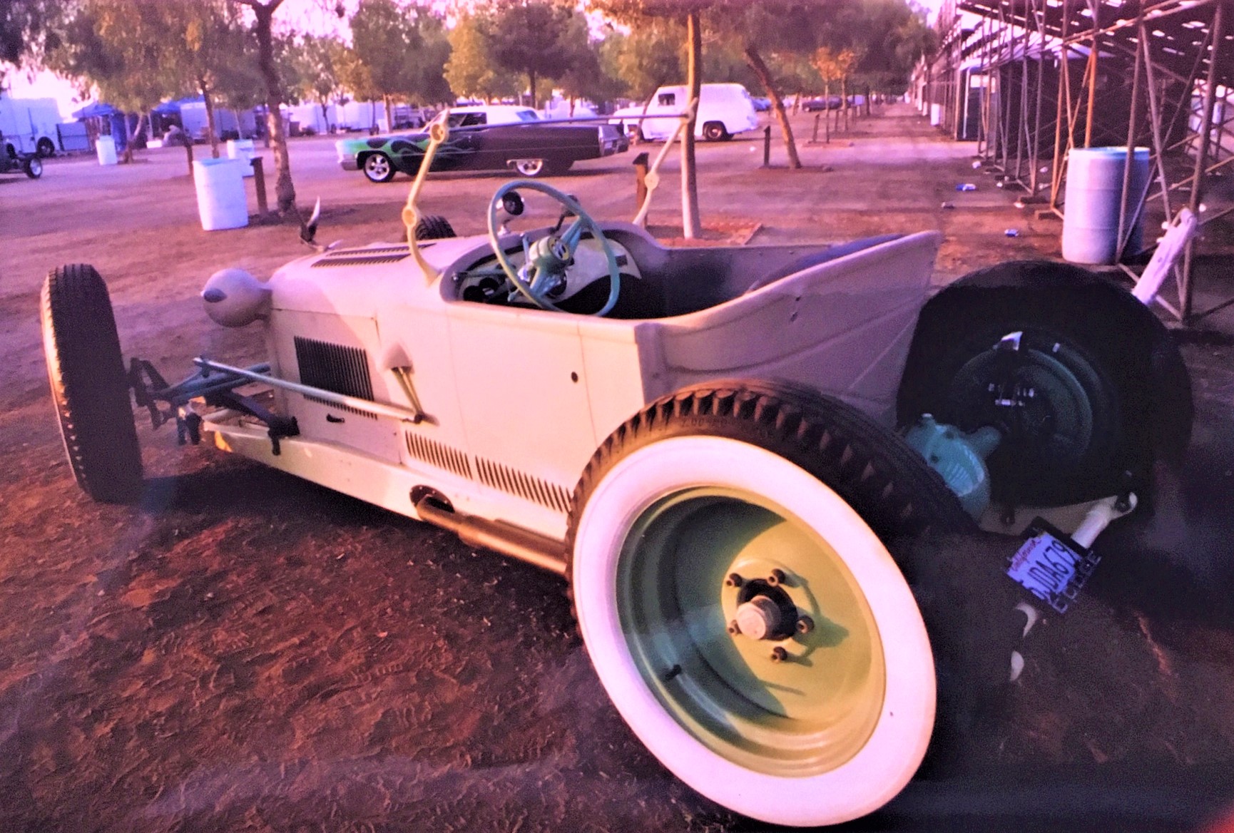

    Hey @DDDenny
    I saw that car at the CHRR at FAMOSO a number of years ago. It is indeed a very cool car!
