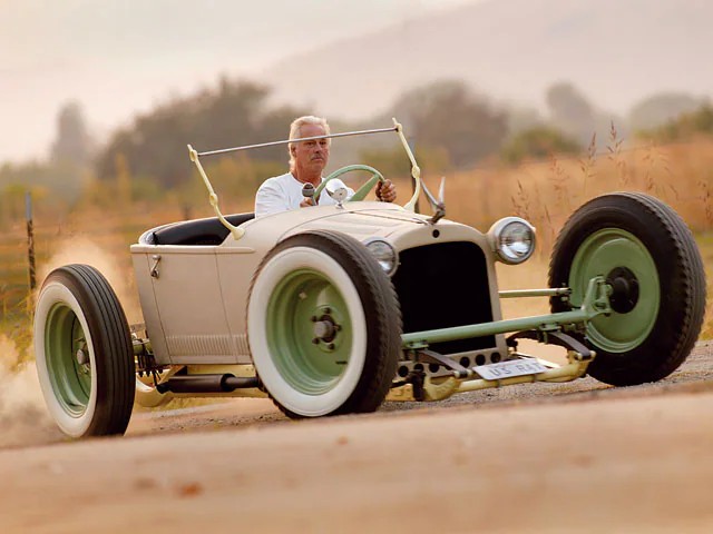

    Good catch, @2OLD2FAST !
    T based (26-27, not 25), underslung. Even looks like it's got room for a V16!
    Depending on OP's desires for rolling stock and springs, this would be valuable to get if for no other reason than to take a lot of measurements and swap over parts to their AL frame.
