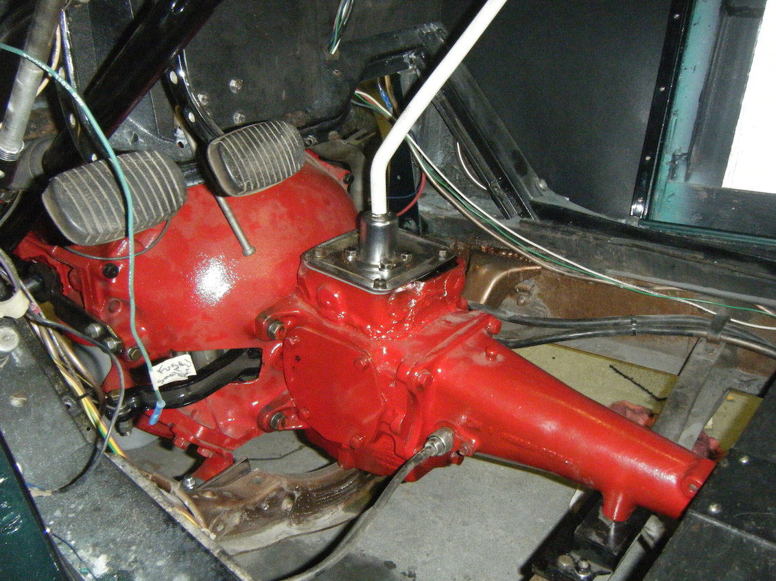

    Hardly exotic but unusual by todays standards, this is a 1936 Chrysler Corp. mechanically (no electric switches and solenoids, just a push/pull cable) actuated automatic over-dive transmission. As I remember, Chrysler invented the over running clutch which led to the free- wheeling transmissions of the early 1930's. The over-running clutch also led to the first over-drive transmission (Airflow) in 1934. These were 3-speed transmissions, that when free-wheeling was engaged, would automatically shift from third to overdrive (33%, I think) at around 40 MPH, depending on how they were adjusted, and back into third at around 30MPH. The transmission pictured is a Borg Warner T86-1A, a slightly simpler, smaller version of the Airflow transmission to be used in Desoto and Chrysler cars in 1935. I've seen them in Dodge in 1936, and seen references to their use in export Plymouths in 1936.
