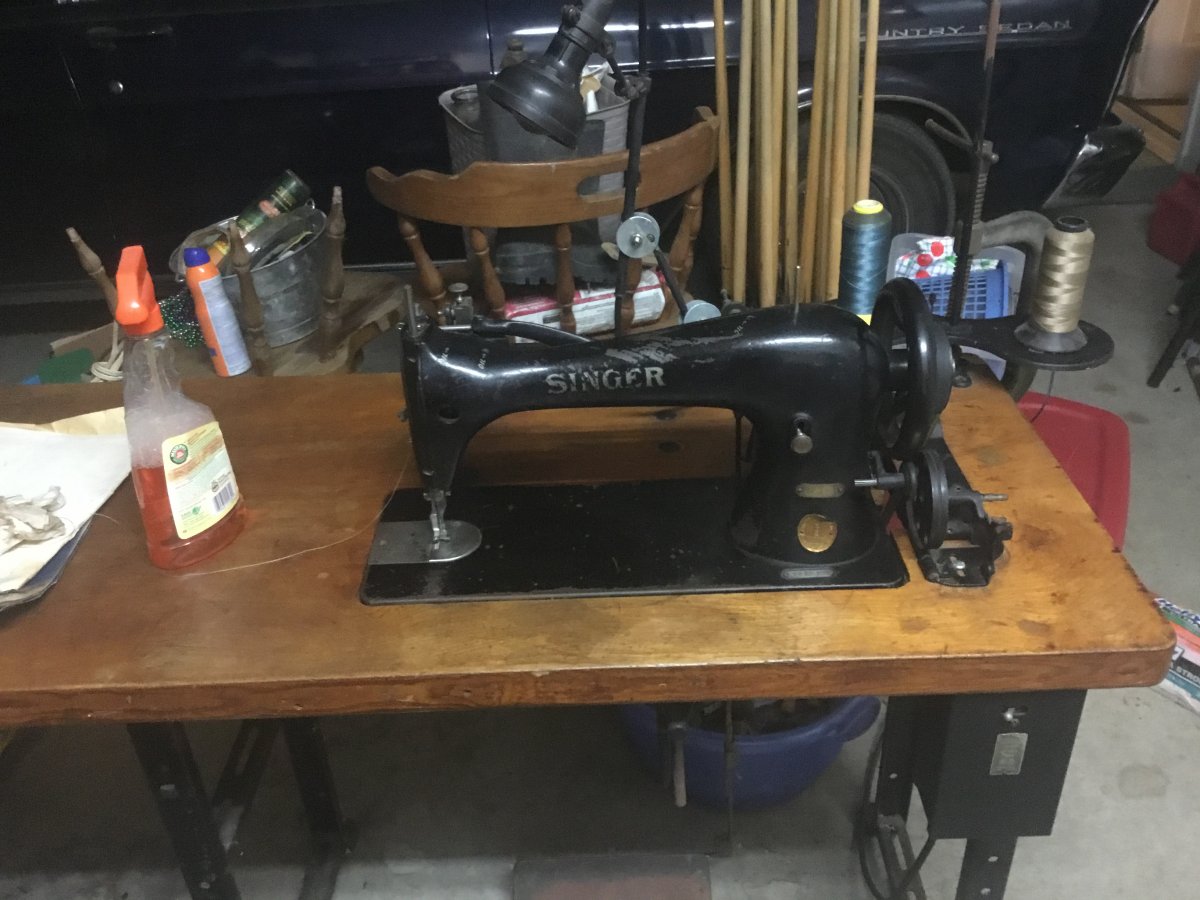

    Here is my old Pfaff I just bought. Had to lug this mutha upstairs by myself. It cleaned up decent. Reading tons of reviews on servo motors...makes my head hurt.

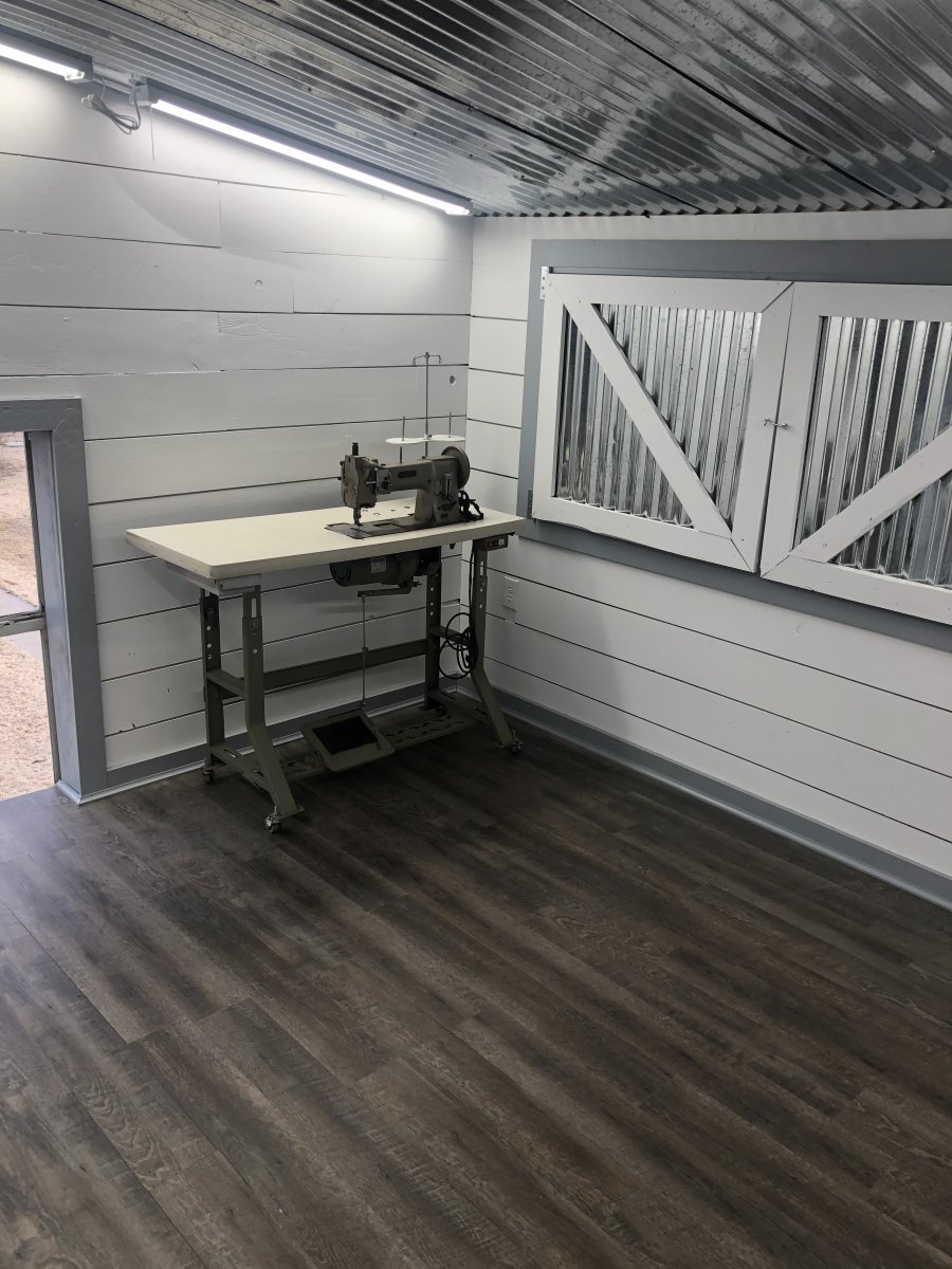

  5. Just picked this one up last night for the old lady. She's gone about as far as she can with the little cheap machine, but she's doing great. She's bought every book that's been mentioned on the hamb, and she also has been doing the lucky needle program. The machine i bought her is a reliable. This rich guy bought it to try to do the upholstery in his BMW, failed, and i bought it for half price. Got a ton of needles and thread with it, bobbins and such, but i don't know the specifics. It's a walking foot with a servo motor. The best part is soon I'll have an in-house upholstery ***** :D

    Was the pun intentional? Love the machine. Many years ago, my wife used a Viking (Husqvarna) sewing machine to do the upholstery for my truck. This was done with a heavy material, and she had no problem handling it. A few years later, she did all the cushions on our old beater Land Rover, using a real heavy material.
    This was done in the 70s, and she did buy some special needles, but I believer they were available at the local sewing machine store. (She just confirmed this). After talking it over with the wife of a friend of ours, who was a professional seamstress, the needles are not difficult to find, and they are what make the difference between success and failure.
    Bob.

    You could tighten the wing nut on your arm below the motor. Will put more resistance on the foot pedal. Your place is way to clean for an upholstery shop !
