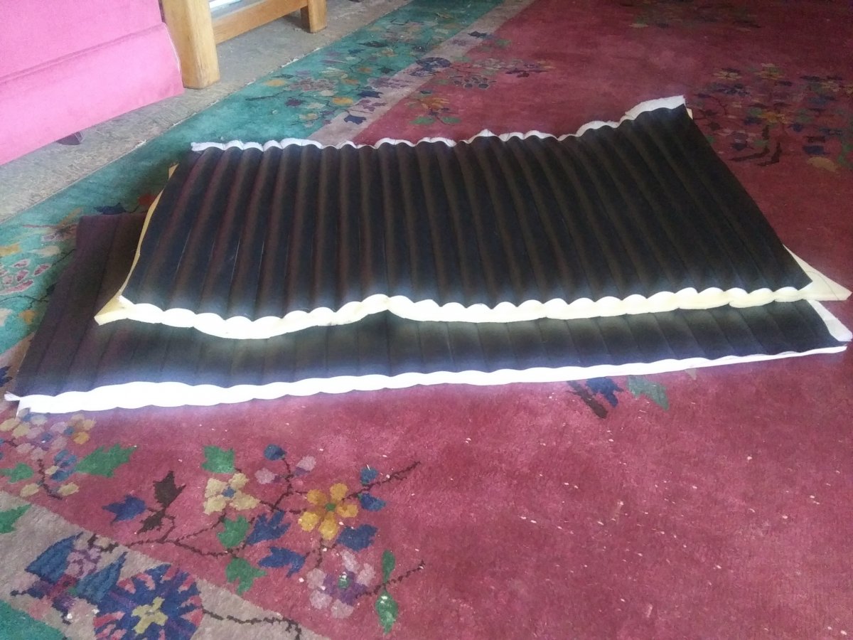

    Got a question for anyone with experience:
    I bought some pleated vinyl, cheap heat seamed stuff to experiment with, unless I actually manage to pull it off, for my seat. Looked pretty flat so I sewed half inch foam behind it. Really puffed it out, looks pretty good. However, this also shorted the width and it's now 3-4 inches too narrow for my seat back. I can almost stretch it out but it flattens the pleats back out. Better to sew a non pleated section in the middle I'm thinking.
    But, what I am wondering is when I sew the piping and perimeter material on, is that going to flatten the pleats back out and make the width longer again, or is the piping going to be wavy from the pleats?

    First, sew across your piece (on both ends) of your pleats. This will determine your finished width. The welt won`t be wavy when sewn on. .

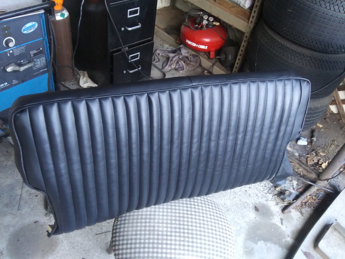

    Thanks for the advice guys. Well I'm no Tony Nancy but I'm getting it done. Far from perfect, just good enough for my heap. Still working out the wrinkles before I staple it to the back. Need to get it in the sun too and see how that helps.

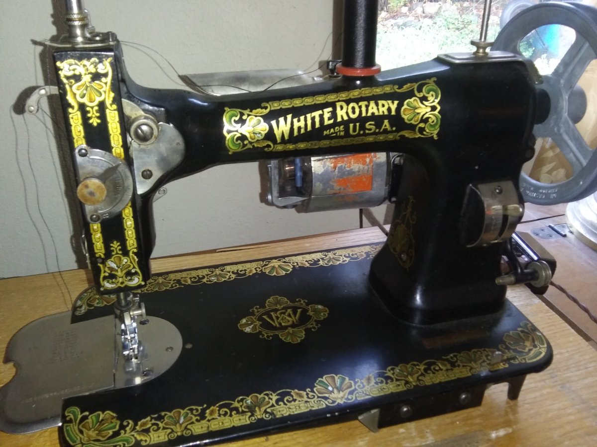

    BTW, my machine is a White Rotary circa 1920s. I adapted a variable speed drill motor and big pulley so it goes nice and slow. No special foot for the piping, tough going but it sews pretty reliably. I've done a couple of motorcycle seats in the past but getting a car seat through the small throat ain't easy.

    Nice work. The one thing I would say, to try and impart some constructive criticism, is pay attention to where your seams are located. Simple stuff like that make a huge difference in how "professional or homemade" something appears. Something as simple as making sure the seam on the top boxing is centred on the back would go a long way to improving the overall look.

    Very true. That is centered, btw, within a half inch, must be the photo. I will also have to make sure the bottom pleats line up with the back pleats.
    Anyone who thinks upholstery is easy is nuts. I hate sewing, and that's the easiest part. Predicting where the seams will end up, for a novice, is another story. Be glad when it's over. Since I've done everything else on this truck from driveline to paint I figures I might as well do this.

    Is that a regular treadle sewing machine or was it originally for upholstery? I have heard others using a treadle machine for upholstery but was not sure how well it would work. I have a few collected over the years, I think one of them is a White.

    I don't know to be honest. It had an electric motor when I got it but it too had been adapted. I doubt it was made for upholstery but it's proven very tough as I have jammed it several times and broken needles without damage. I started out this project with a newer Singer machine I was given with more bells and whistles but it couldn't handle layers of vinyl and stripped the plastic gears inside.
    I bought the White for $25 I think, years ago but I think they're probably still cheap.

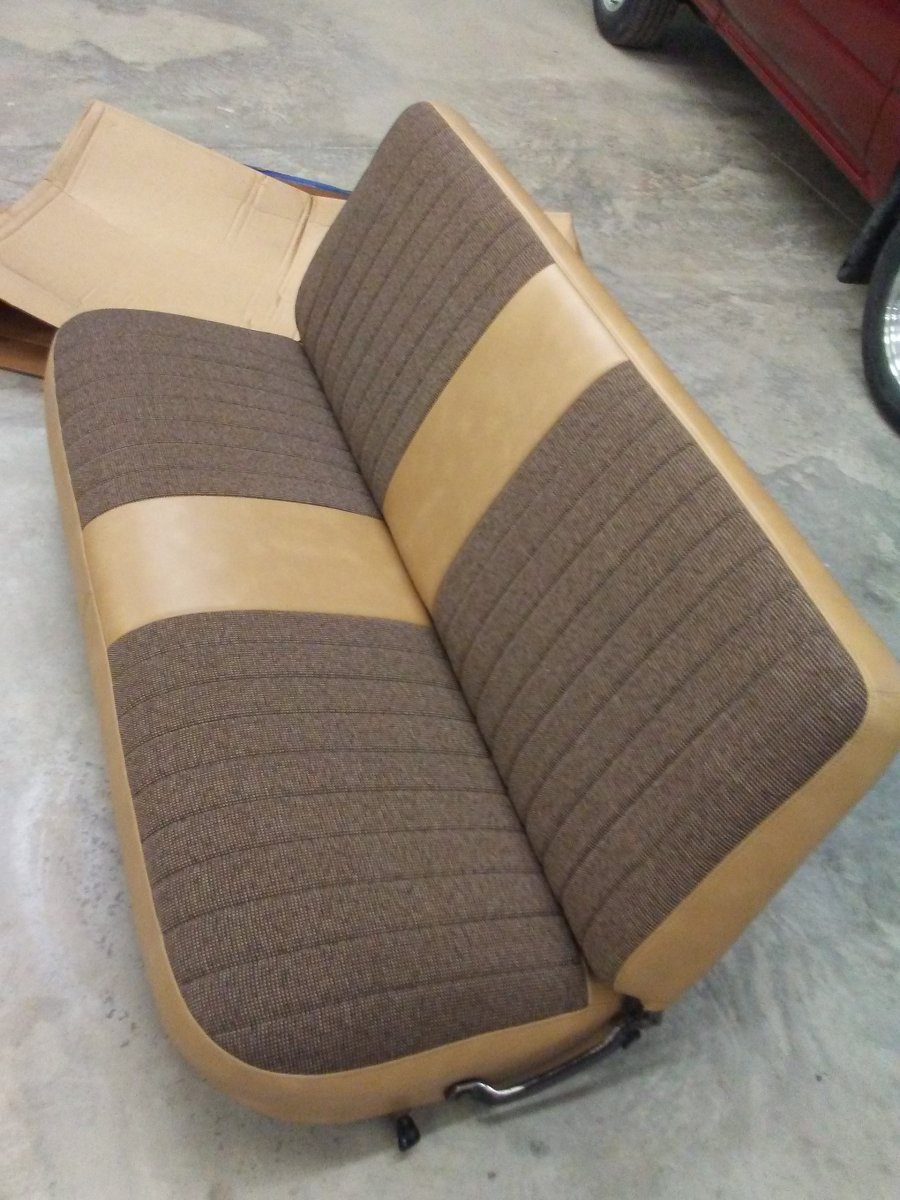

    Got my seat back today!
    6inarow, brEad, reagen and 6 others like this.
