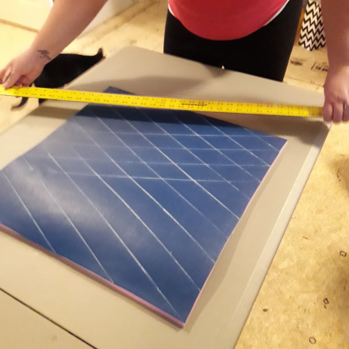

    Generally attached to the seating surfaces with trim tack adhesive. And with pleats or diamonds, the foam is what gives it shape. You can see the foam sticking out from under the blue vinyl here 20210214_162844.jpg

    thanks @Lloyd's paint & gl*** ! That’s what I was thinking but I tend to over think dam near everything. I have giant roll of white diamond tuck I’m planning on using for inserts for my seat covers. That let me know exactly what I needed.

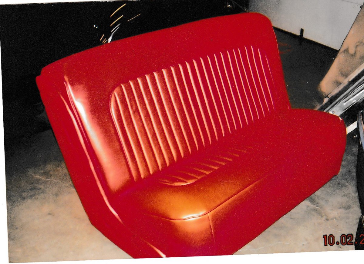

    Scan0897.jpg All the parts you sit on or lean against get 1/2 inch scrim foam glued to the material. I also use 1/4 inch scrim backed foam on all of the other panels. It gives the vinyl a full look as compared to looking flat. Just try it. Also adds strength to the material. Look at the color change in the windlace.

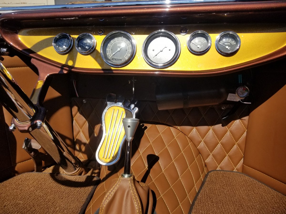

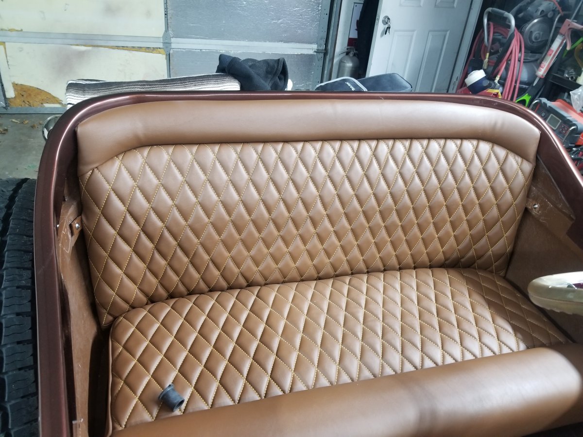

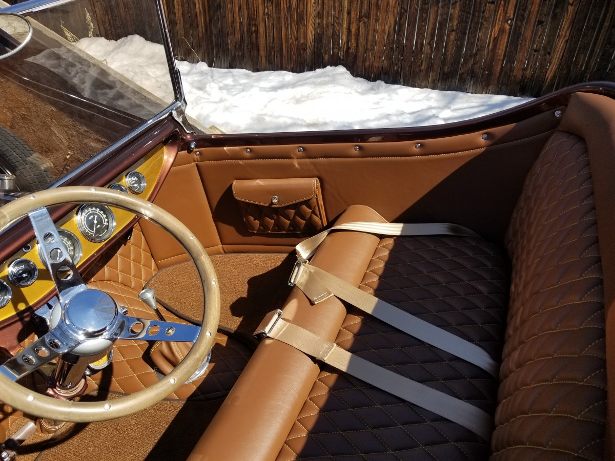

    My bucket, seat and tonneau cover done by @woody45 before his p***ing. Recently had the rest finished by a local master.
    Small car, but a lot of work in it.
    Last pic is Mike test fitting the seat

    WOW he did an AMAZING job. RIP

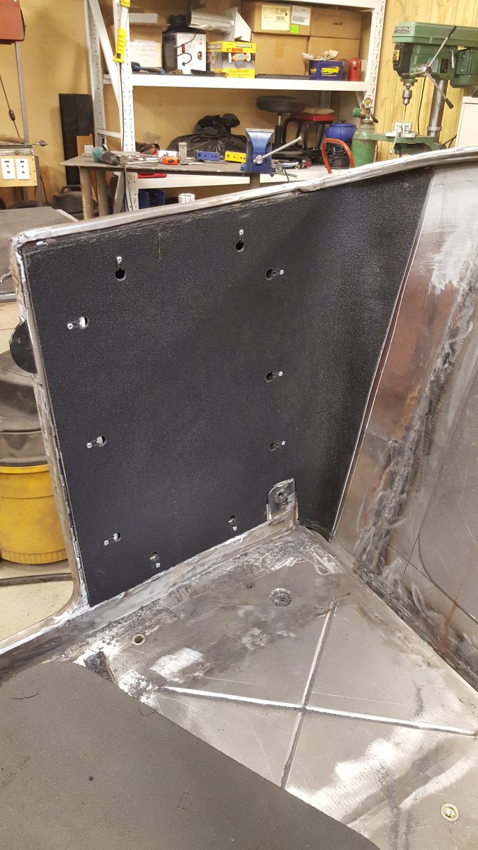

    I had a couple of panels that needed some repair and this was what used to hold them in. I read another thread here on the HAMB about using Industrial Velcro was/is a much better way to attach panels. I used contact cement to make the bonds more secure and its the only way to go IMO.

    Seriously :rolleyes: Industrial Velcro and contact cement :rolleyes:
    Better? And more secure and the only way?
    :D:D:D
    Come back and tell us that later on down the road when your Velcro is failing or the contact cement has lost it’s bond and your panels are falling off. :eek::D

    I was taught that trick by an old upholstery guy that's retired now man. I've done it for years and never had an issue. I've noticed around here that most are closed minded, their way is the only way. And if you're not 70 years old you don't know what you're talking about. :rolleyes: I'd love to see them keep up with me in my shop.
