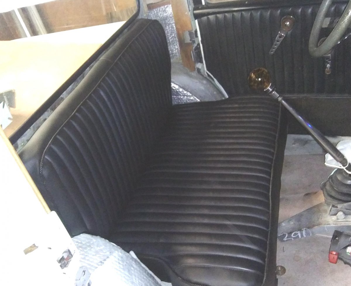

    Got my seat bottom done and back in. I've learned a couple of things, the hard way of course, that will make the next one nicer. But this is good enough to use and see if the dog eats it.
    Problem one, I bought premade cording at the fabric store. Instead of the usual nylon tubing inside it just has foam, so it lacks the rigidity for a straight line. Probably made clothing, purses or whatnot.

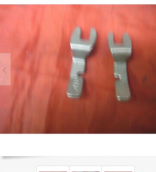

    Second, as I mentioned earlier, my machine only has the standard pressure foot (feet on both sides of the needle), which made it very difficult to keep the cording from slipping off of. What I needed, and later bought, was these 'zipper feet', left and right. So they do not bear down on the side of the seam with the cording (or zipper).
    I matched the only remaining vestige of past upholstery that was in my heap when I got it, the door panels, which are in decent shape. Still needs headliner and carpet.

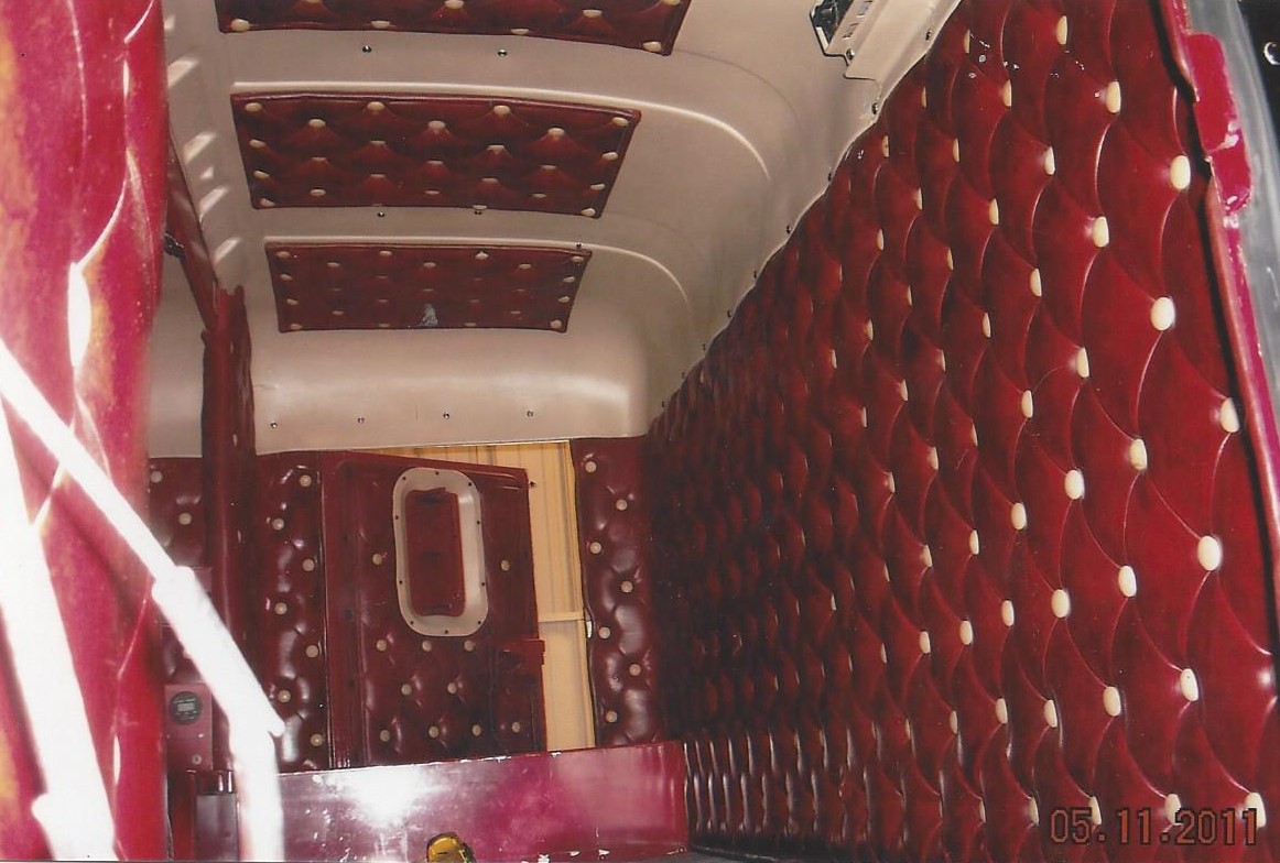

    This is an 80 Kenworth I did a partial on. Mainly just cleaned up what was their. And redid a few of the panels. The ****ons are size 30. Scan0888.jpg IMG_20210405_0001.jpg
