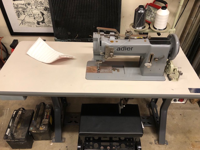

    I've been wanting to dive into this ocean for a while. Mostly did everything on walter on my old home machine. Came across this Adler walking foot for 200$ and now already planning everything out to redo everything. Been practicing... man it rules. My goal is to be able to adequately do my buddies cars.

    Man you stole that machine and it looks new to boot. As a pro upholsterer said on another forum, Jukis and Consew are the Fords and Chevys of walking foot machines, and Pfaffs are the Buicks. But Adlers are the Rolls Royces.

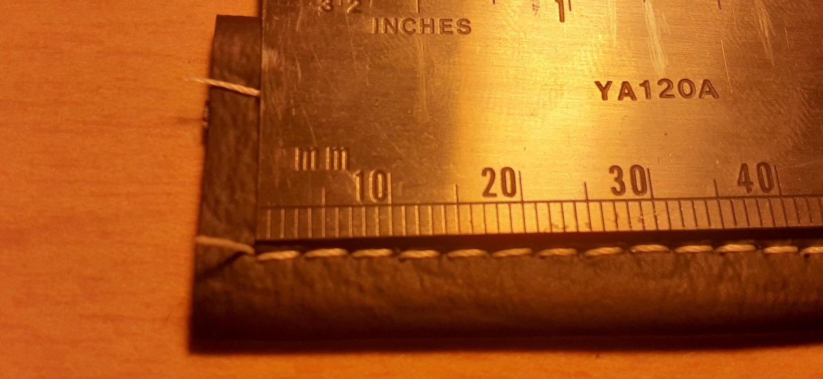

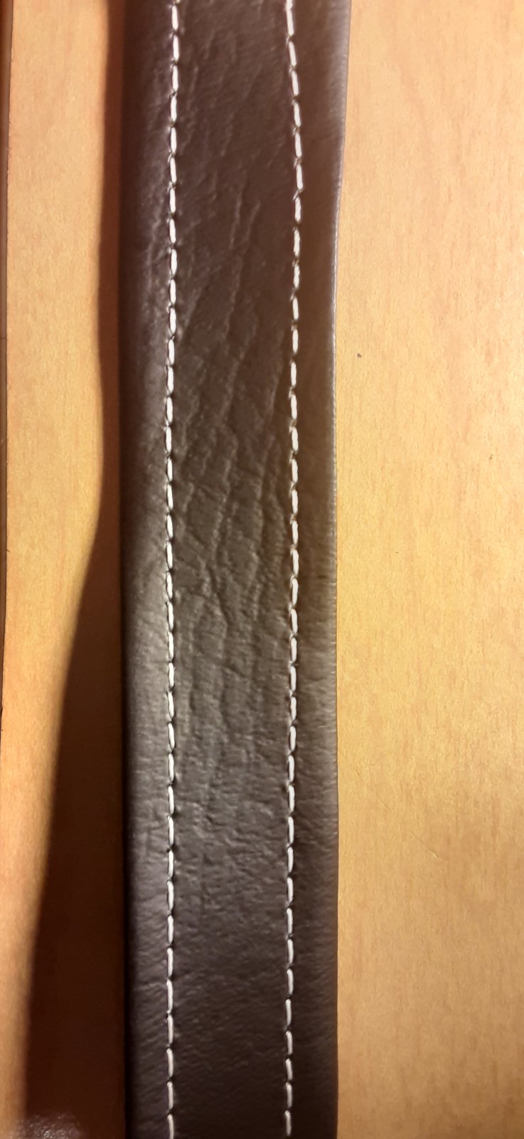

    Ok, so I replaced the needle bar, re-timed my Consew 206RB. Installed a Sewquiet 6000 motor. Finally is s***ching without making a birdsnest. But now I can't seem to adjust the s***ch length no matter how much I turn the dial. The s***ch adjustment lever jumps while s***ching, this can't be normal? Please help
  16. ZZ Top Chop
    Joined: Aug 12, 2018
    Posts: 534
    ZZ Top Chop
    This is the longest s***ch I can make, is this enough?

    It looks like you are getting about 7.5 s***ches per inch. That machine should do 4.5. I could never get mine to go to the longest advertised s***ch. But it should go longer. Flip your sample over too. It looks like the tensions are adjusted well but it takes a look on the other side to be sure. What do you mean the s***ch lever jumps? What model do you have? the earlier 1 or 2?? or later 5??
    Either way check out a video from Ben Jackson June 30, 2016 "adjusting Consew 206RB-5 Forward/Reverse S***ch length" It will give you a real good idea.

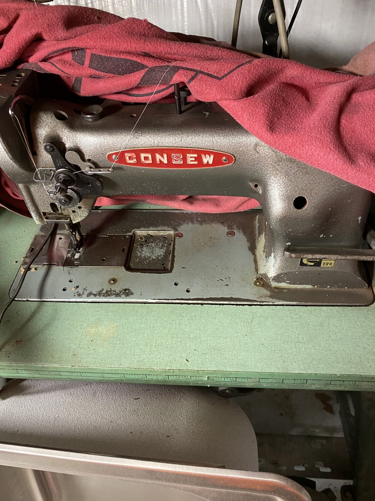

  20. 1-SHOT
    Joined: Sep 23, 2014
    Posts: 2,901
    1-SHOT
    from Denton

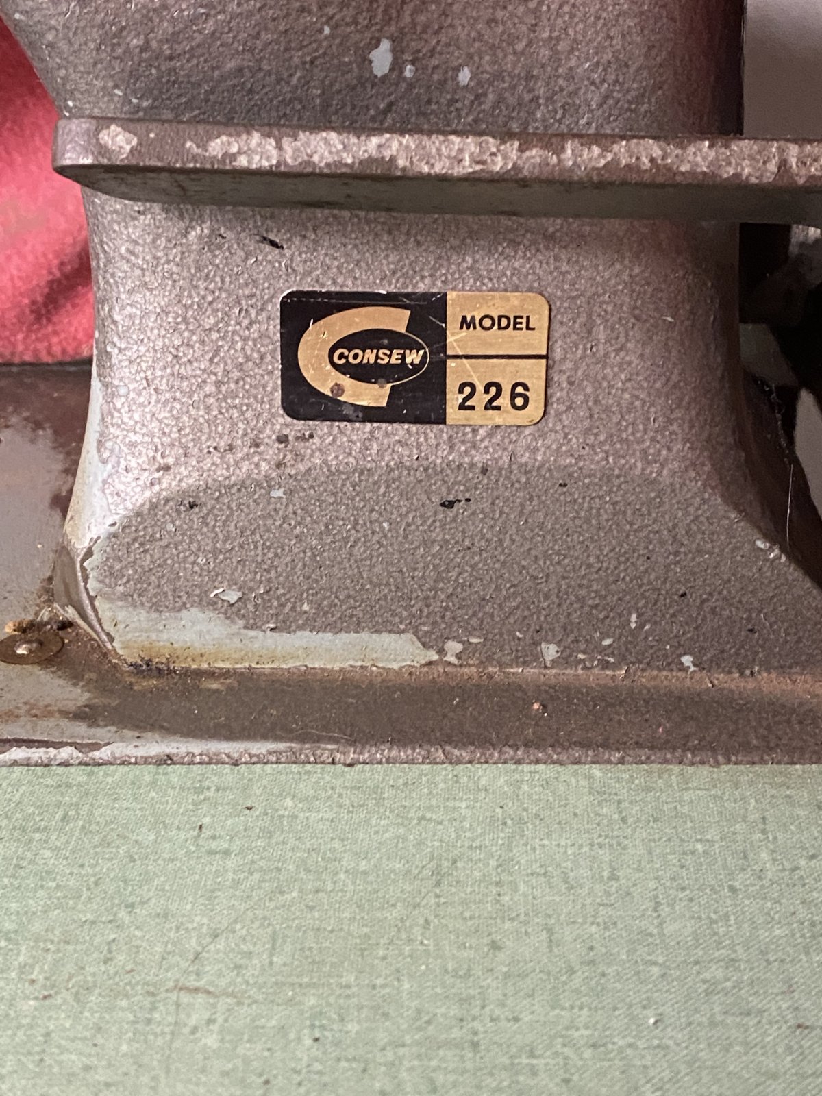

    I have a CONSEW 226 , what 4A33B173-A4D3-4346-9CB6-63F0D52D4AA3.jpeg 2923BD3F-E654-4CB4-BF63-4FAD01A29C20.jpeg video are you talking about. Thanks Frank
  21. jakesbackyard
    Joined: Feb 13, 2007
    Posts: 949
    jakesbackyard
    from ND
    My 206RB1 gets 3 s***ches to an inch with lever all the way down. Make sure that the shaft of the s***ch lever is tight. With the lever adjusted all the way down you’ll see a set screw back in the top of the opening. With a long screw driver tighten the screw. Mine needs to be tightened about once a year.

  24. 1-SHOT
    Posts: 2,901
    1-SHOT
    from Denton
    5EBA8BC2-7E04-48AA-83CC-801D8A834727.jpeg A2B3C298-7824-40AB-8902-4D4EBC5C42D8.jpeg This is the labels on mine and it’s reversible thanks Frank

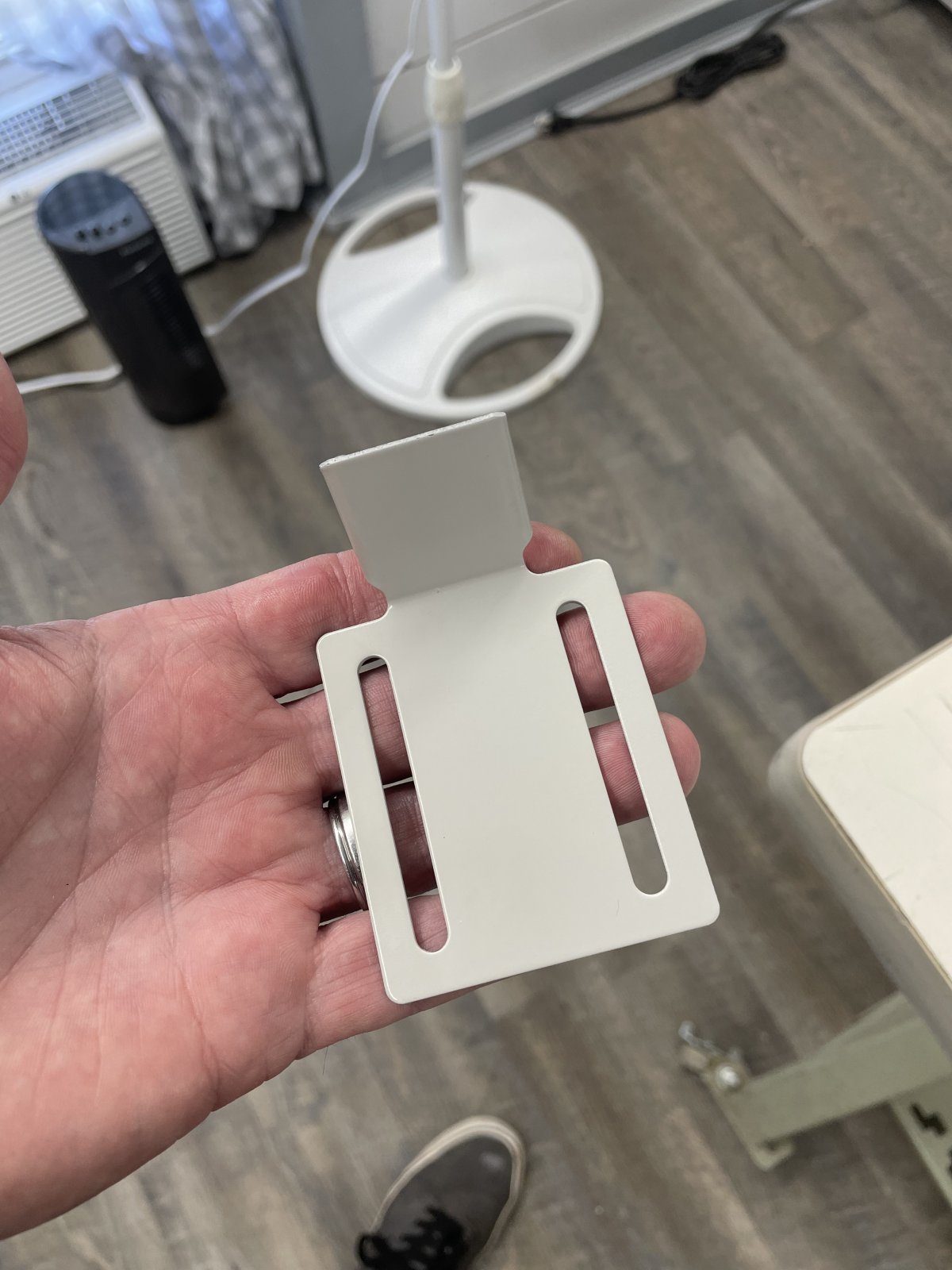

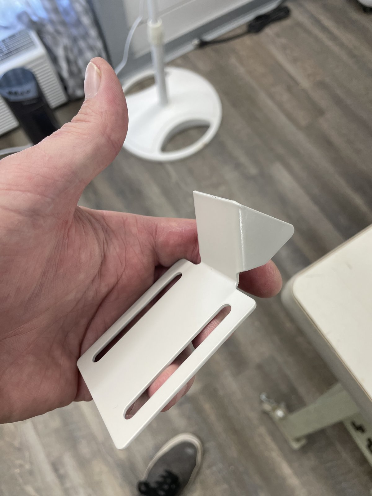

    So, I ended buying a new Juki DNU 1541.
    It comes with no instructions. I found some videos on YouTube to help me ***emble most of it . I still have this piece left. Anyone recognize it?
    1736F2D8-F032-4C87-9F18-938D18EDA637.jpeg EB78A5DF-A5BE-4449-995E-EE191BF23EEF.jpeg
