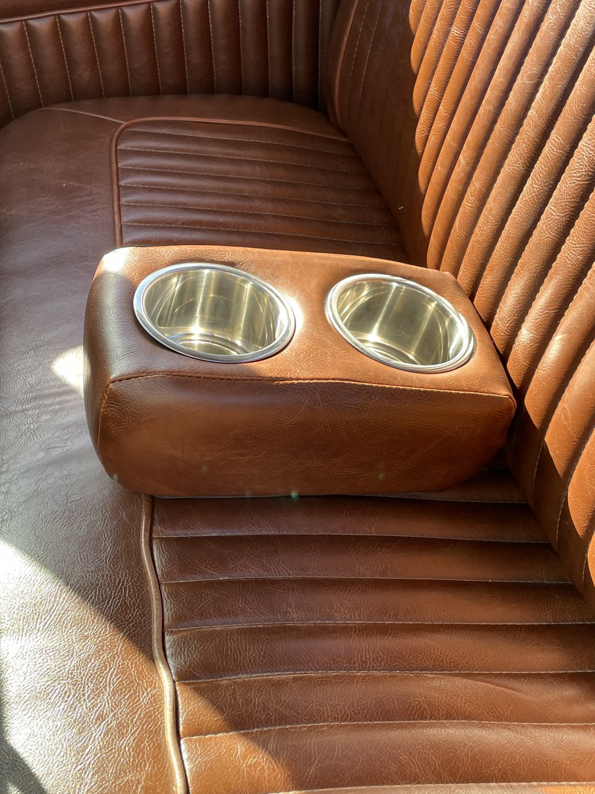

    So, don’t look too close but mama and I decided to try our first real project. We needed a console to hold our cups, but the 35 cab is made for little skinny folks from the depression that didn’t get to eat as much.
    We made some mistakes and learned a lot. It’s pretty simple, but it’s project number 1. Now we just have to do 20 more to make it pay for itself.
    The seat was previously done by a professional. I always order more materials than I need, for reasons just like this.
    Nothing fancy, but a year ago I would have just stapled some vinyl on it an hoped for the best.
    Let the hazing begin.

    Nothing wrong with that Root! Looks good

    Thanks. It has plenty of room for improvement, but it’s a start.
