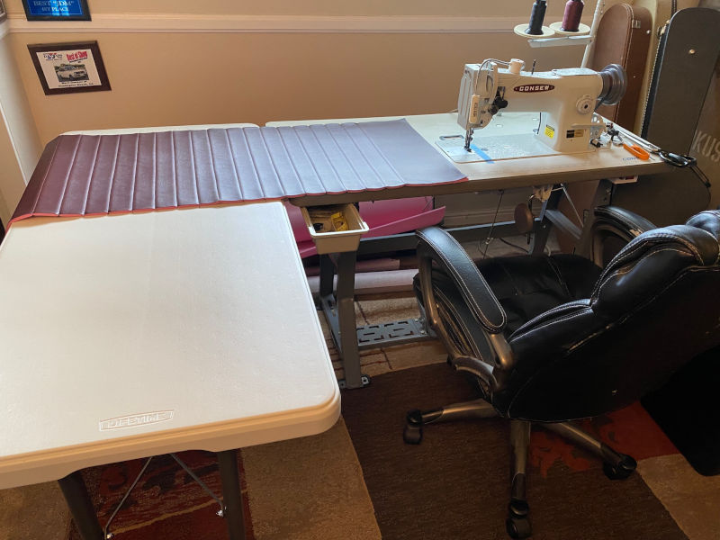

    Just a quick heads up if anyone (like myself) doesn't have a lot of room for their machine. Costco has a folding table that is 24'x48' and has adjustable legs. At the tallest setting, it is 29" which is exactly the same height as my sewing table. It's $40-ish.
    I did some carpet binding before I got this, and really struggled with folding the material up to get it through the machine. I did this large pleated section today and it made a huge difference.
    It's not a pro setup, but it really works for me in my tiny bedroom/office space.

    In addition to nearly the same setting as above, I added a folding leaf in front of both the
    sewing machines table and the side extension table shown at the left. When I needed to
    use it I just folded it out and it has a support frame leg that is hinged to the back of the
    extension. This allows for the material - carpet - large canvas etc to have its bulk or weight
    supported past the sewing machines working surface. It's just a suggestion to another
    way of setting up your work station.

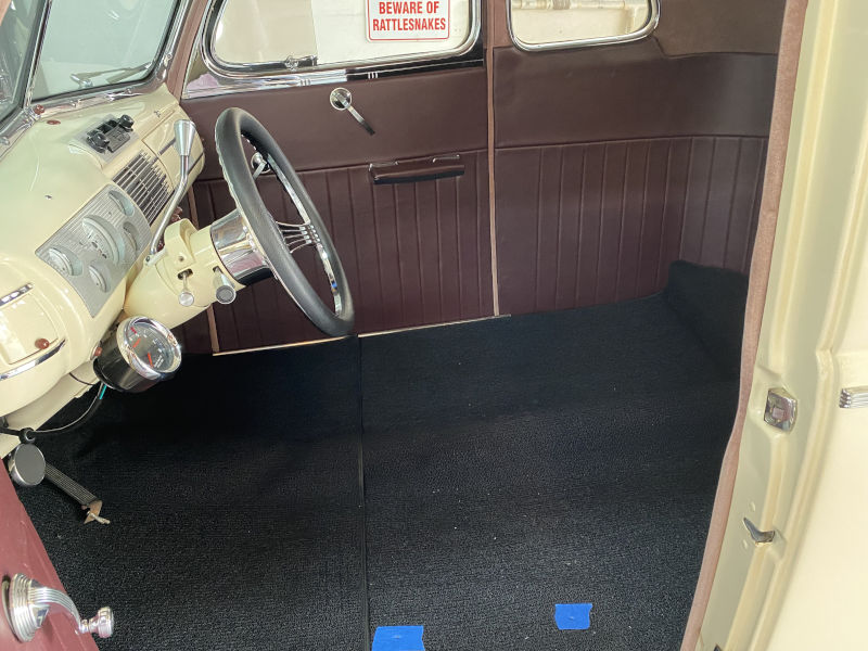

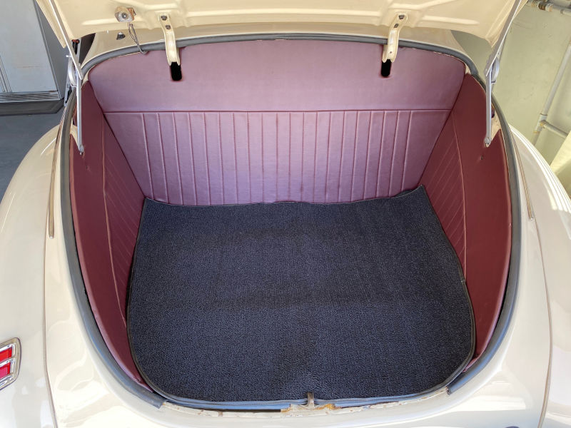

    I never touched a sewing machine until the first of this year. Just wanted to touch base on my first project, and post a follow up photo or two. I struggled with a few things, got frustrated a time or three, but I kept at it and re-did the trunk, all interior panels, and the carpet. I still have to sew a heel pad on the driver's section and glue it down, and hope to get that all done tomorrow.
    Quite a learning experience to say the least.
    Mark
    whoops! I should mention this is a '40 Ford Coupe....

    Just shows that it doesn't have to be fancy to look good!

    Awesome work! Your trunk came out great! Interior is also beautiful!

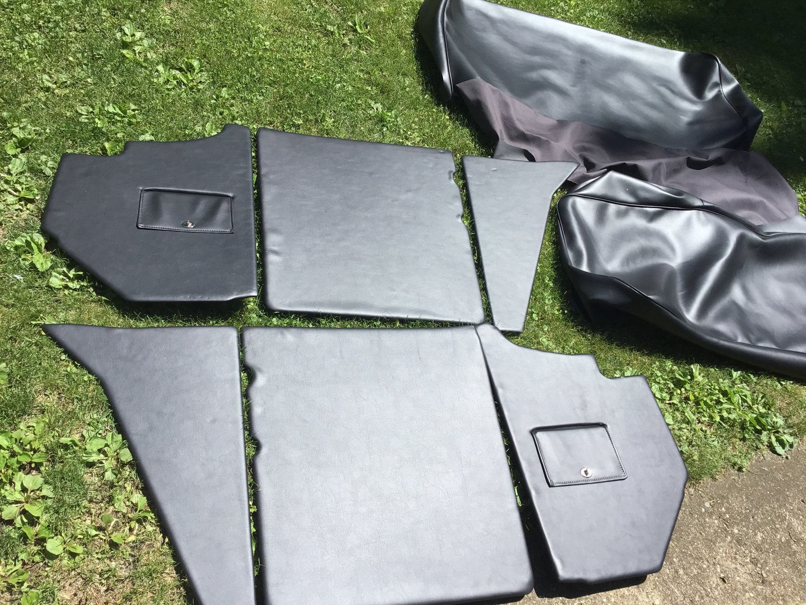

    @Torana68 the model a seat is 5 yards and door panels 3 and rumble I would think 4 to 5 as I haven’t done a rumble in awhile.. I just did this standard roadster and was 8 yards of vinyl . If adding pleats add more yardage 25% as it’s amazing how much pleats eat materials . 340C4543-8917-444D-8DF5-30EE11C7C5A9.jpeg

    Bravo my friend! It looks great.
