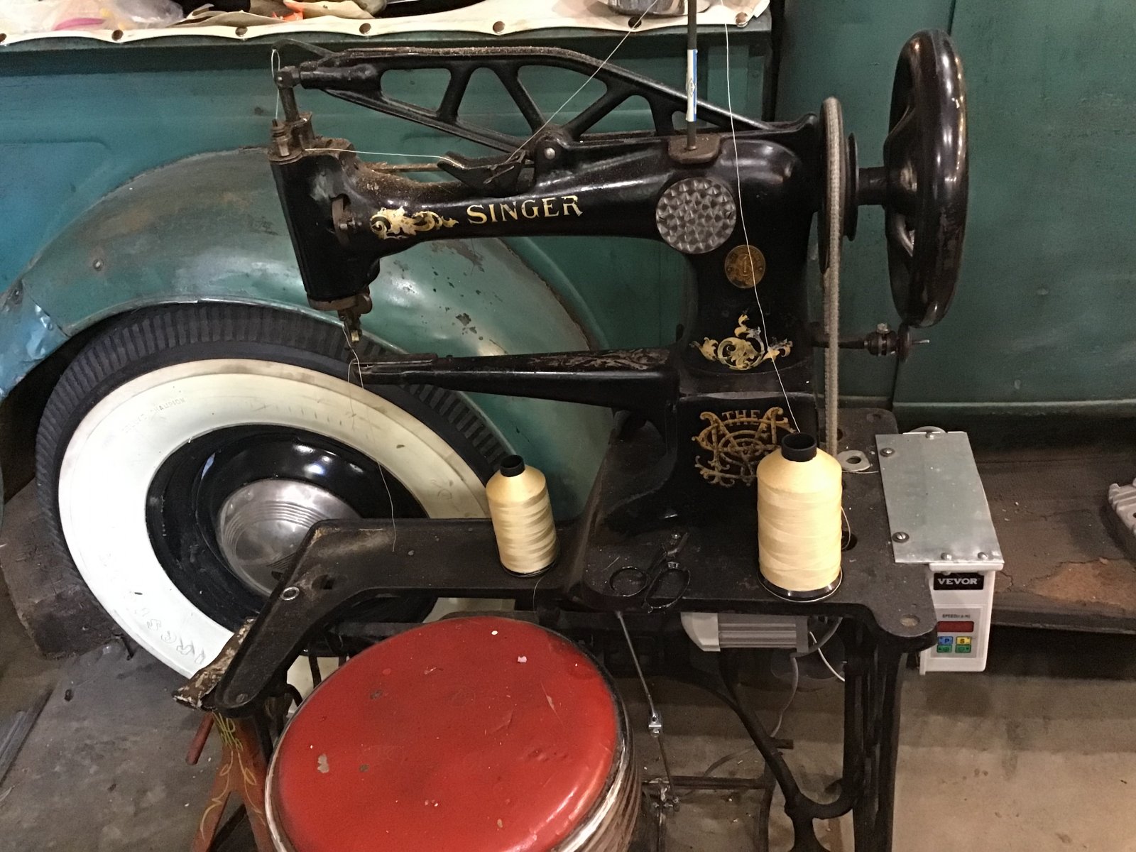

    @Mo rust great idea on the sbc pulley and going to try that on a consew that’s deadly fast. The 3w interior looks great.
    I bought a servo motor for my singer 29k4 . The install was easy and just a few mods plus it works pretty good . C6A2458F-0183-45C6-96A0-45FC6F1F9937.jpeg

    I thought mine was old but yours really does look like an antique. One step above an old spinning wheel.

    @Mo rust lol yeah it’s from 1914 but sews great and built to sew leather like tool bags,shoes and holsters 297E9311-B2EC-4934-89B1-48D12234D8FF.jpeg

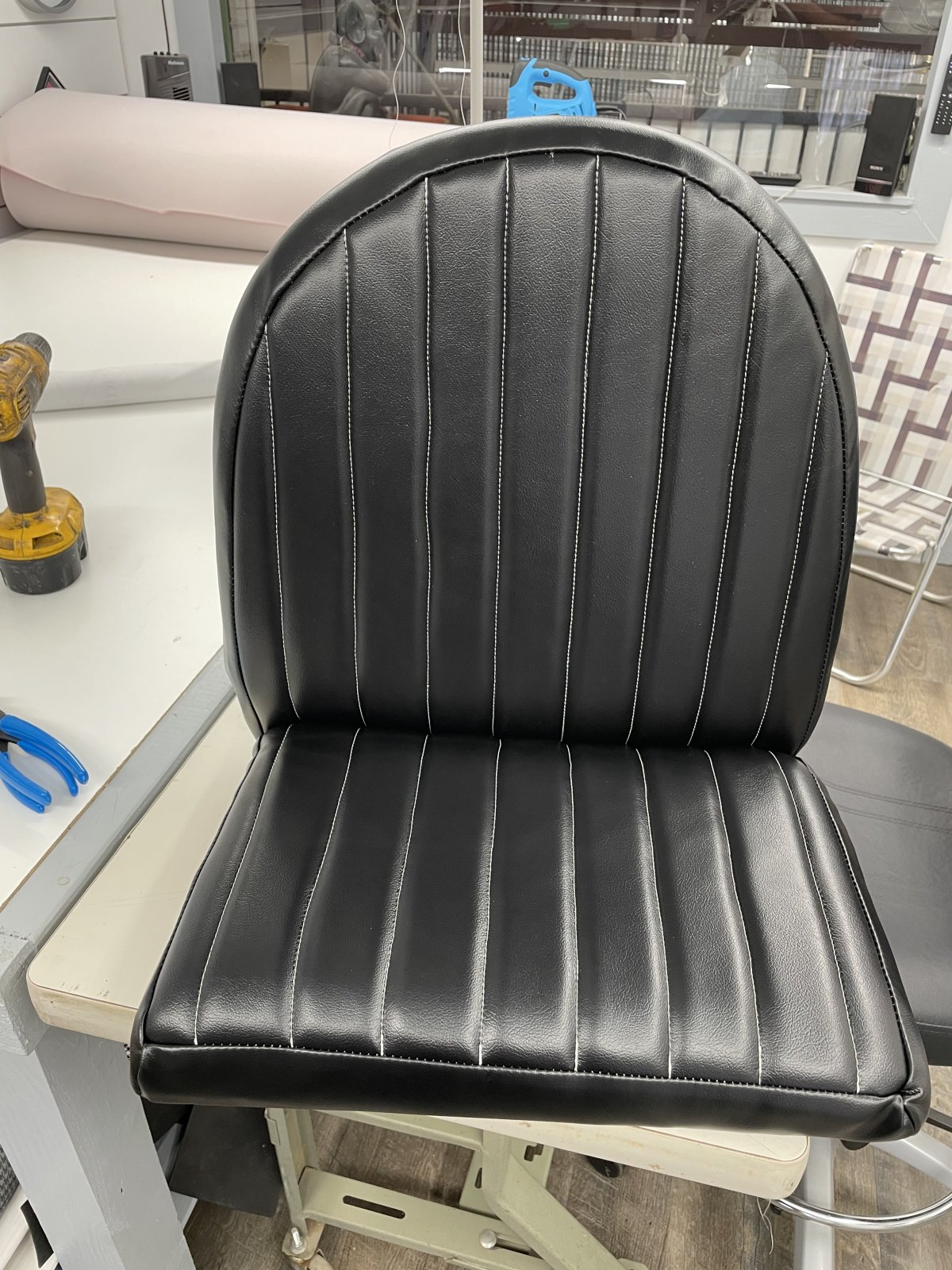

    So, after the tornado and the forces house renovation…..we finally got to try out the new sewing machine. We did a go cart seat for my nephew.
    All I can say is that it was a lot harder than it looked. We learned a lot and we are going to start playing a round with it now that we have a lot more time. It looks like ****, we know. It was an afternoon project with no prior skill or training. But, with that said, I think if we start upholstering stuff around the shop for practice, we will eventually get the hang of it.
    We didn’t have any welting, so this one just gets whatever I had laying around.

    If it were easy, *everyone* would create *****in' T&R interiors.

    I bet my first try would look way worse! Looks pretty good!

    We learned a lot.

    Looks pretty darn good for a first try I'd say. Here's a tip my upholsterer aunt gave me (after I had finished a seat) for making sure your upper and lower pleats line up: sew the upper and lower pleated panels as one larger panel then cut them apart. That way all the pleats are the same width top and bottom and match.

    That's a good idea. Live and learn. He will just have to live with it.....:D
