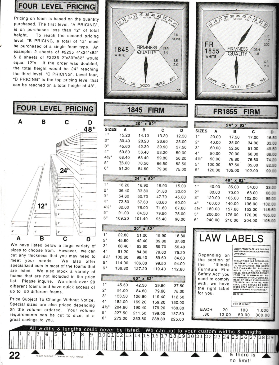

    Hope I am not high jacking the thread. But it's been a number of years since I have upholstered anything, the company that I use to get all my supplies from in Milwaukee is gone now. I am looking for a foam supplier that handles different grades of sculpturing foam to build up my framework for comfort and support and to be able to shape the contours I want. Any sources in the southern Wisconsin/ Chicago area that you might know of. Thanks Larry

    Did active Foam go out of Business. They carried everything. --------Thanks @drdave Scan_20230103 (2).png

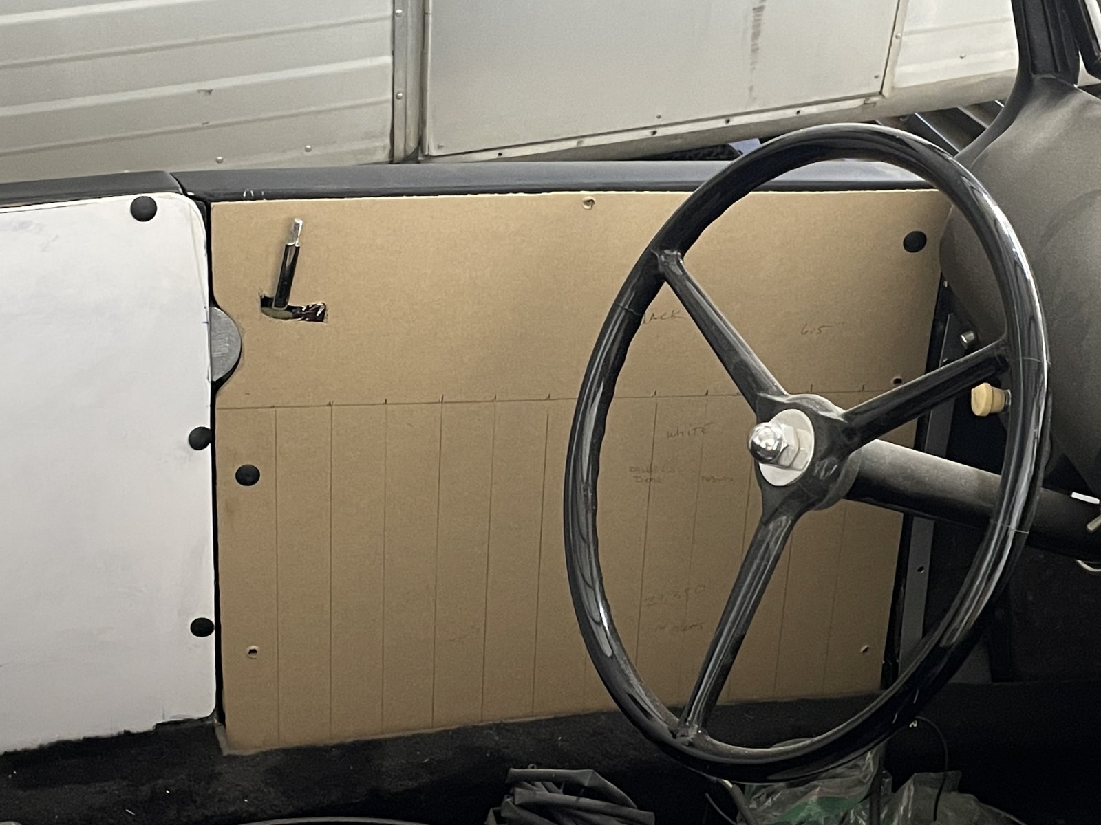

  11. Roothawg
    Joined: Mar 14, 2001
    Posts: 26,001
    Roothawg

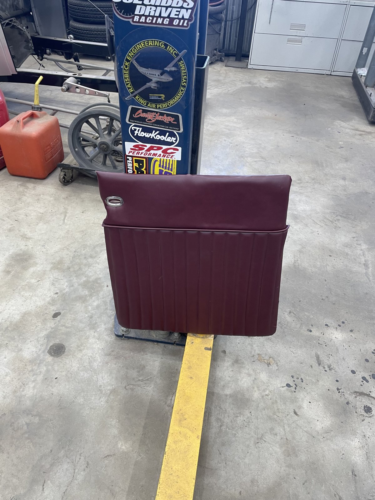

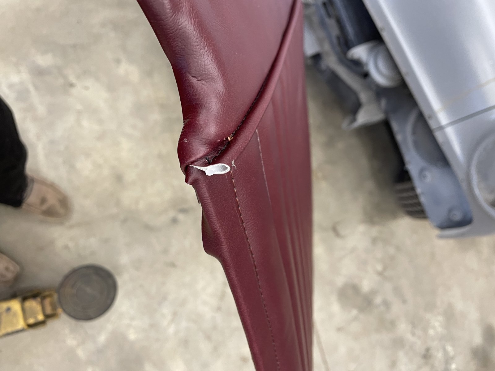

    111084A2-FD34-4B8C-BD9B-935EAD1F805D.jpeg F02A9CA4-6234-46FE-ADB6-B3841DE15EFC.jpeg 3A08D14A-EA08-44EE-8605-EB27D49619E4.jpeg So, the wife and I decided to do a test run on a door panel with some s**** material. Figured it would point out the things that would eat our lunch pretty quick. It did.
    I have decided that welting is of the devil. It was easy enough to make, I just don’t know how to get it placed correctly. It sticks out too far. Then, I don’t know what to do with it when it ends.
    Don’t make fun of me. This was my first attempt ever at a door panel.
    I have the upmost respect for good trimmers. It is gonna take me years to get decent.
    Keep in mind we didn’t staple it etc. it was just to see if we could actually construct one. It will all gets stripped back off when we decide to do the final version. We didn’t staple anything, just for ease of removal.
  12. stanlow69
    Joined: Feb 21, 2010
    Posts: 7,346
    stanlow69
    Cut a V notch in the panel. Tuck the welt thru it. So, the edge is even with the rest of the material.

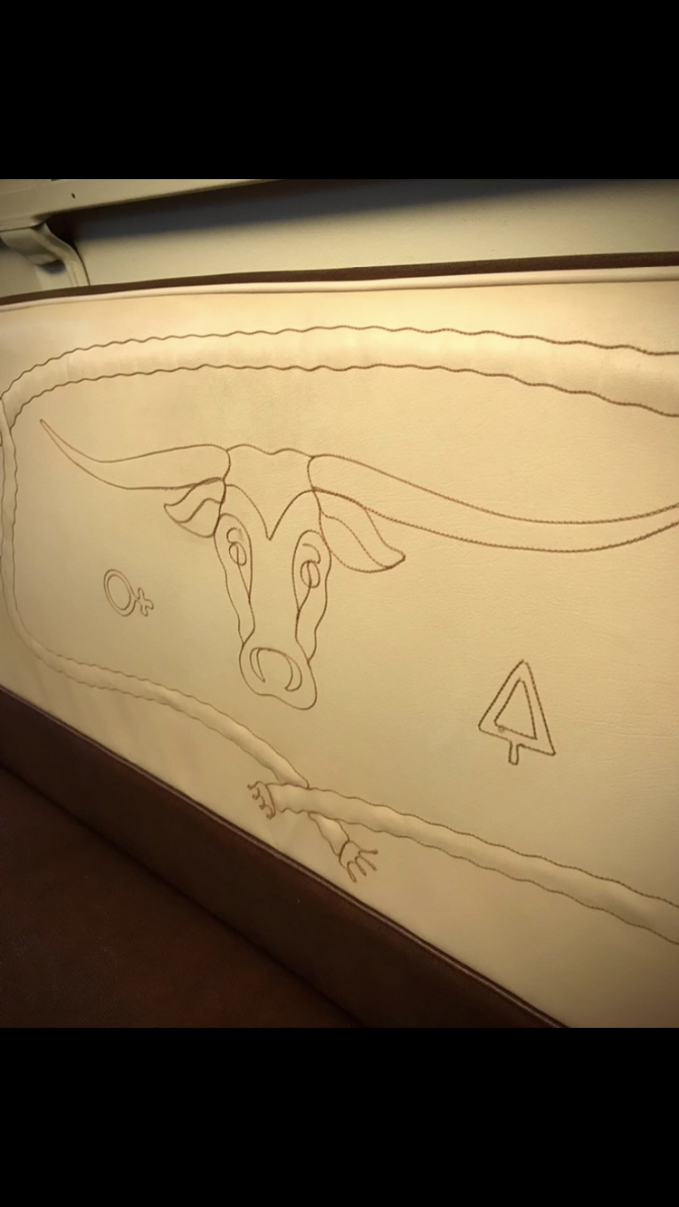

  13. F-head
    Joined: Oct 20, 2007
    Posts: 1,482
    F-head

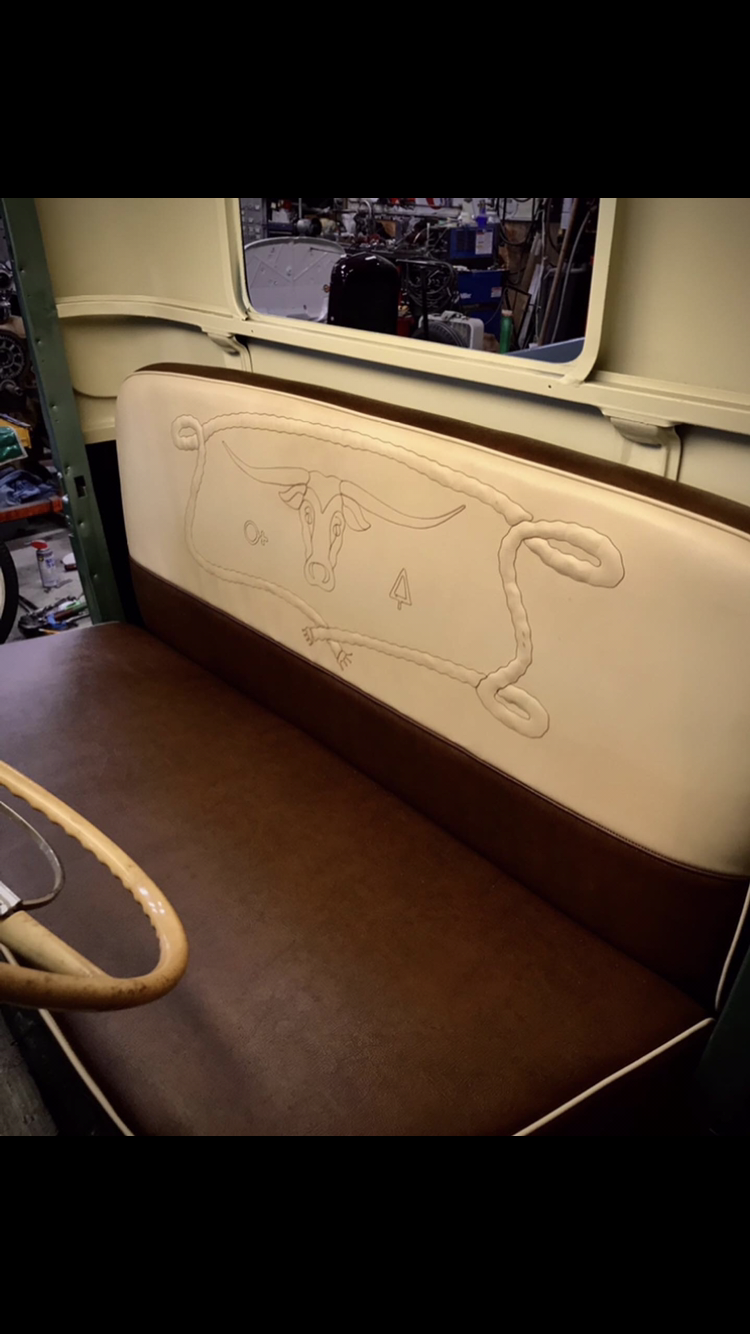

    Here’s a seat I did for my 41 pickup using a piece of vintage embroidered ivory vinyl I found on evilbay many years ago
    Someone cut it off a mid century wagon wheel couch before s****ping it
    Glad they saved it and I was able to incorporate it into my truck seat F08EB048-69C7-4EA2-8977-7C01504B041A.png 3FE87867-A256-43F8-AF12-332ABA30DE47.png

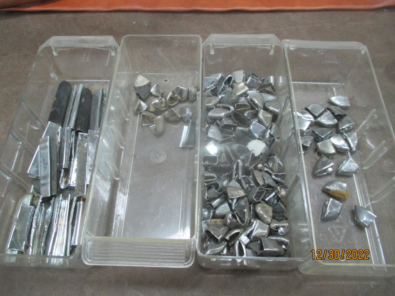

  18. Whoamel
    Joined: Jul 22, 2007
    Posts: 127
    Whoamel
    from So Cal

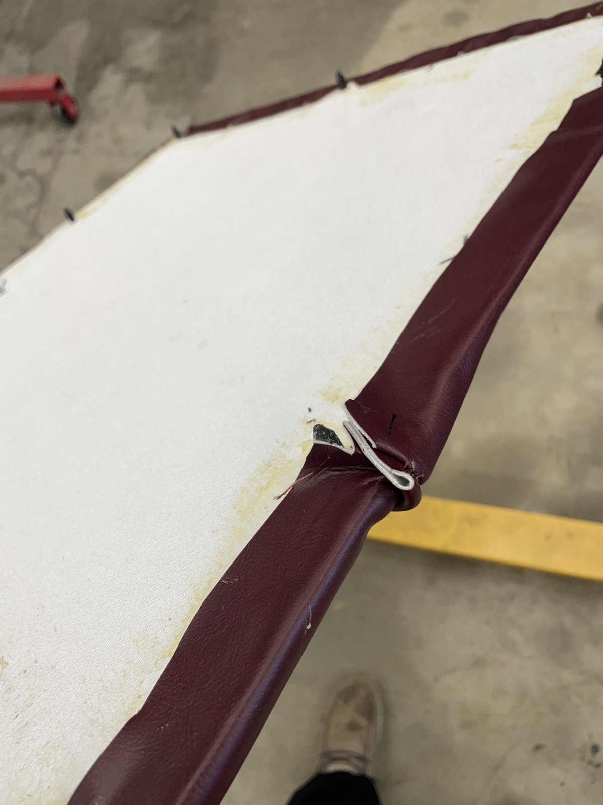

    Curious what these tips are called, and where can they be found?
    I don't do a lot of upholstery, but I generally make my carpet binding. After you glue the edge over, hit them down flat with a rubber mallet. The lumps go away and they flatten right out.

  20. stanlow69
    Posts: 7,346
    stanlow69

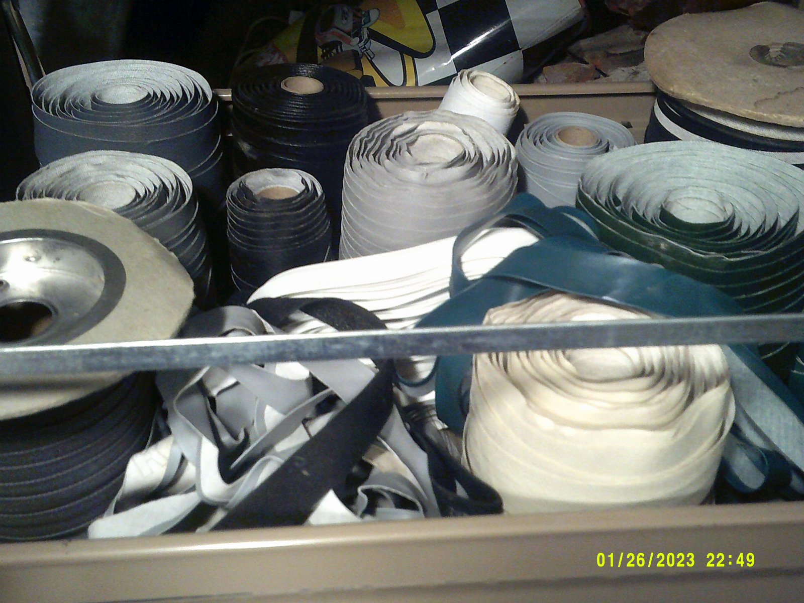

    I find them on sun visors from the 70`s automobiles. They are a bit bigger than the others. I would like to find a source for them as well. I use over a hundred (maybe 200 +) yards of binding a year. So, making it would be a pain in the rear. I used 2 yards today. Regular vinyl is not durable when used on carpet.

    I do upholstery stuff for myself and occasionally some simple stuff for friends. (I'm still learning) I just found a local place that has 300 yards of single edge binding for $70-ish dollars. That's about a ten lifetime supply for me, but I'm thinking I might grab it anyway. Thanks!

  23. stanlow69
    Posts: 7,346
    stanlow69
    Alot of these I`ve had to reorder. More than once. 70 ish, do the math. DSCF0021.JPG DSCF0022.JPG

  28. Roothawg
    Posts: 26,001
    Roothawg
    So, I need some input. I am Mocking up the door panels for the roadster and I have a weird deal. I drew out the pleats etc and temped the panel in place. Because of the angle of the door, the pleats and the smooth area look crooked.
    Here's the practice panel we made.
    Do I stay with my measurements and say screw it or do they need to jive with the door aesthetically? I am in the aircraft business, so everything is always either in tolerance or bad.
    it’s an optical illusion but it drives me crazy.
    Also, I was trying to make the smooth portion tall enough to clear all of the weird hootis that are in the way. It looks too tall to me. It’s 6.50” now….
    The panels are actually longer, but the body is channeled over the frame 6" so You can't see the full panels with the doors closed.

  29. alchemy
    Joined: Sep 27, 2002
    Posts: 22,749
    alchemy
    If it looks right, it is right.
    If it looks wrong, well…..
    -Brent-, brEad, safetythird and 2 others like this.
  30. 1946caddy
    Joined: Dec 18, 2013
    Posts: 2,360
    1946caddy
    from washington
    Go with the angle of the door. Nobody sitting in the car will be sighting along the top and looking outside or people looking in will not be doing the same.
    Put a seat in it and most of the door panel is blocked from view.
    Other options are parking on a hill or getting bigger front tires.
