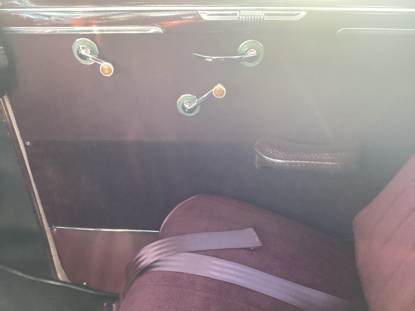

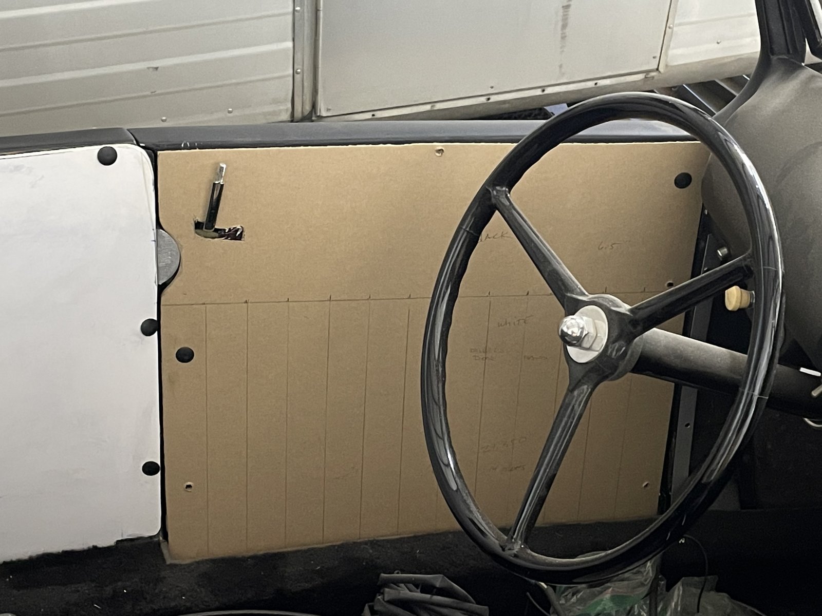

    Roothawg in an interior situation such as this the asthetics are more important than measurements so in this instance do what looks right as long as both doors look the same then don’t worry about measurements just make sure the pleats are the same throughout the interior

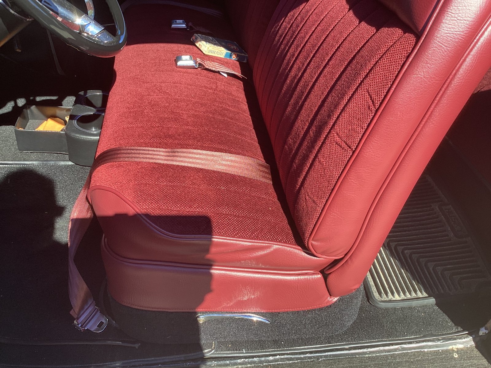

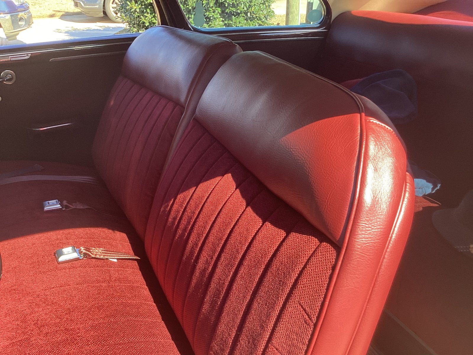

    Just got mine back from the upholstery shop. Huge difference. I can now sit in it comfortably. Snowman ⛄️ 8DCA82F4-8E20-48C0-B331-DEEEA4778578.jpeg 8DCA82F4-8E20-48C0-B331-DEEEA4778578.jpeg 1343A0EF-205F-4A2D-BFEA-51A6E0141A69.jpeg 8DCA82F4-8E20-48C0-B331-DEEEA4778578.jpeg 3853F25D-8361-48E9-AB50-9876DB22C9F6.jpeg 1343A0EF-205F-4A2D-BFEA-51A6E0141A69.jpeg

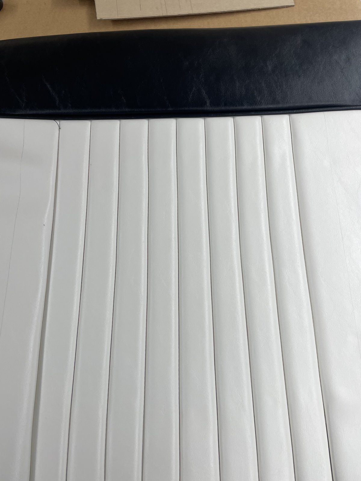

    I'm shrinking the top cap down to 4.5". We will see if that makes it look better.

    What's your plan on the next panel. If you stay straight it will run out the top of the car if you level it your pleats will be at different angles?

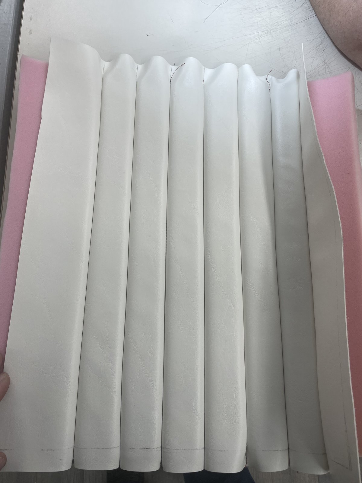

    So, today we got excited and made all of the pleated pieces and did this one panel. It’s just laying loose. We still have to glue it to the panel. Pic is kinda ****py. I still hate welting.

    So don’t use welting. Can’t you just stuff the roll to get any ripples out that the welting might have hidden?

    When I sew pleats like the ones you sewed. I s***ch across the top and bottom twice. It locks everything in place and gives you a flatter surface when sewing on another piece. It has a tendency to come uns***ched when t******* the panel down to size.

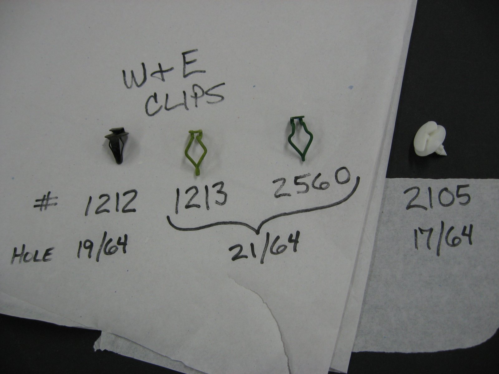

    I tried to buy the metal clips and the panel is too loose. How do you determine grip length? I am not a fan of the Christmas tree type, but I used them to keep moving forward. I used the Ford style and they are sloppy loose on 1/8" fiber board.

    Do you mean loose on the panel board or loose fitting on the door? The Ford/Chrysler style wire clips are made with two different lengths of the shank that pops in the door. I’ll search for my old picture.

    Unfortunately these are W&E numbers and they were bought up by AUVECO. You can look up a cross reference for the numbers on AUVECOs web site I think.
    Notice the difference in the length of the shanks on 1213 and 2560. 1213 is the most common to use on 20s-60s cars because the door is flat. 2560 is designed for doors that have a ridge around the outer edge hence they reach farther. 2560 also works well for fibergl*** doors that are thick.

    They fit the panel ok, but when I snap the panel on it has too much play. Sloppy.

    I use 808s usually, if not 807s when panel needs to fit tighter.

    I’m now remembering what I had to do the last time I ordered some of the short shank clips. The AUVECO cross gives a long shank 8206 which is wrong. The correct short shank clips for flat doors is #2309. The easiest place I found them was EBay.
