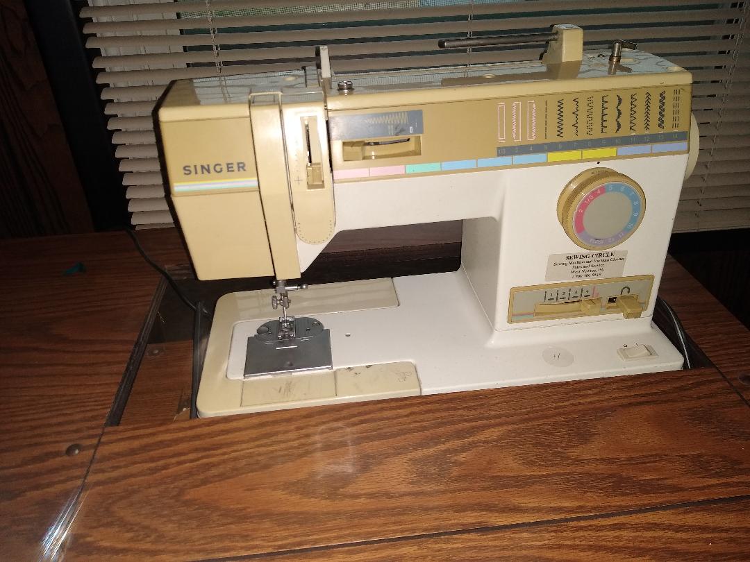

    Here is my Consew. The Lay Z Boy chair factory here used these for years, and when they bought a new line of machines, a lot of these ended up in the homes of their employees. My table has a front section that attaches with piano hinge and folds down when not in use.
    The machine was setup for production in a factory that paid according to piece rate. I tried a lot of modifications to slow this machine down. I would highly recommend buying a servo motor to replace the type that is on my machine. Learning a new skill on a machine that is designed for high speed is not much fun.

    That's because I just finished it. It won't stay that way for long. As far as your question about the servo motors, they are supposed to be way slower, since they don't have a clutch. You can sneak up on it , instead of the traditional on/off electric motor. Supposed to be really quiet as well. I just figured any help I could get, would be worth it to lessen the learning curve.

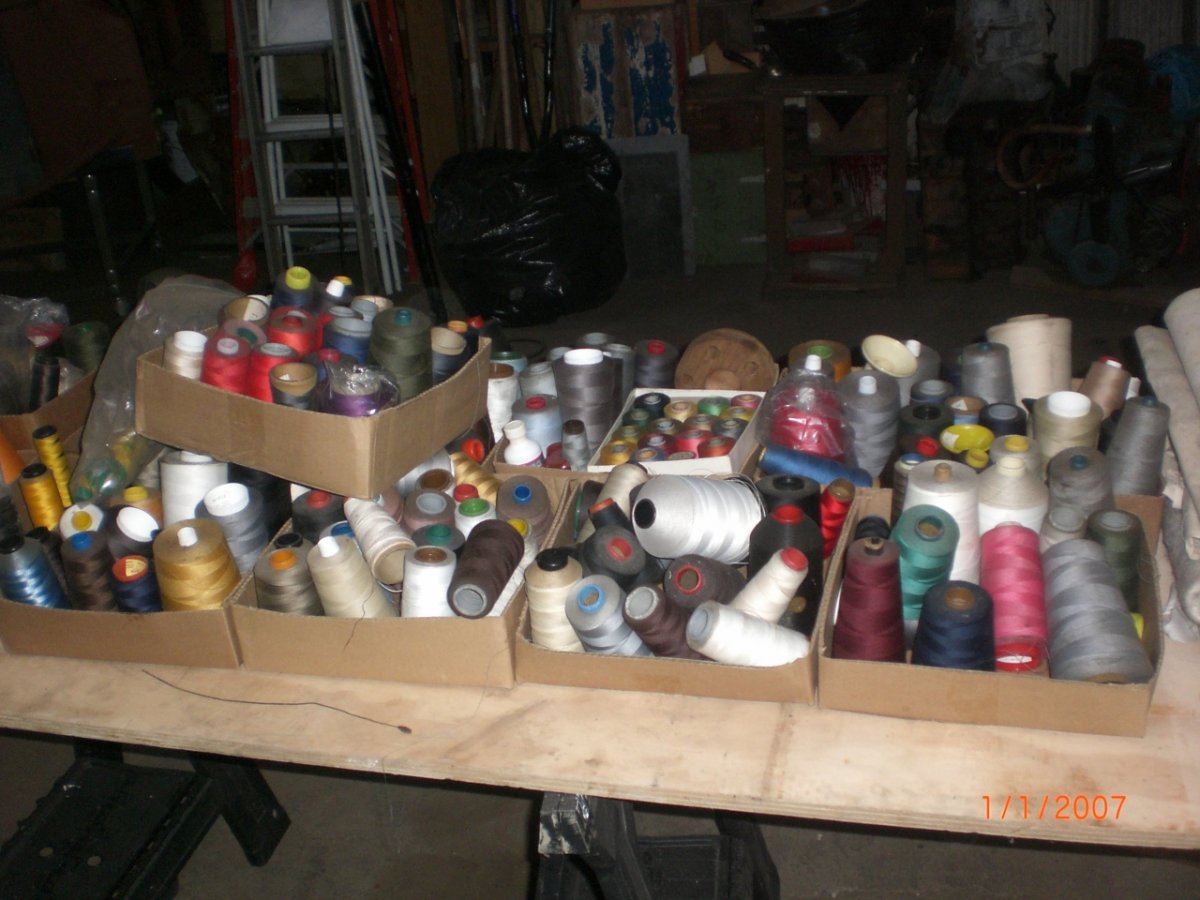

    first I bought this old Singer, then I bought all this thread, then I bought these books, then I bought this smaller machine, and I still havn't se 530auction9.jpg thread3 (1280x960).jpg sewBk1.jpg sewBk2.jpg sewMach1.jpg wn one damn thing!

    So I guess my main question is what thread and needle size is most common? I don't want to invest in a bunch of stuff that is a once in a lifetime use.

    Thread: 69 nylon bonded, Needle: 16/100.
