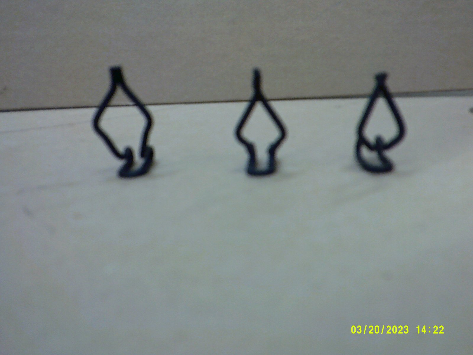

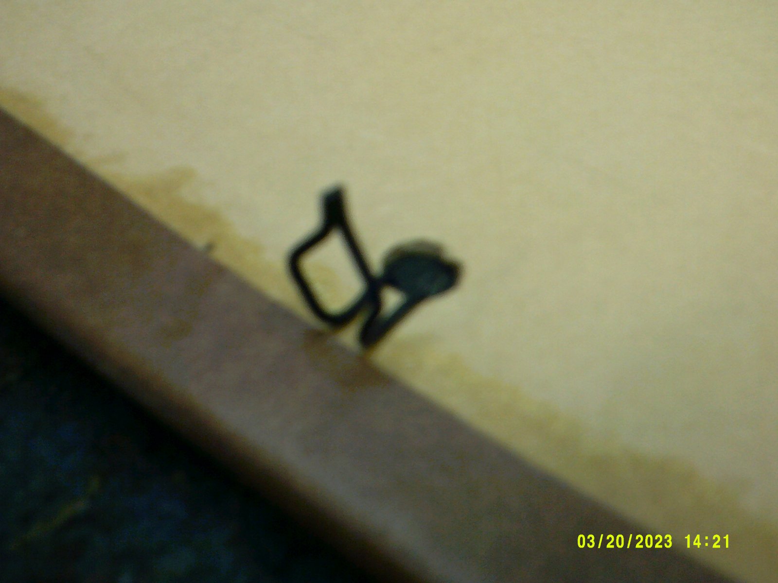

    Here is a Whitney punch I bought a year ago. Made a make DSCF0164.JPG DSCF0162.JPG DSCF0163.JPG shift stand to punch holes for the clips.

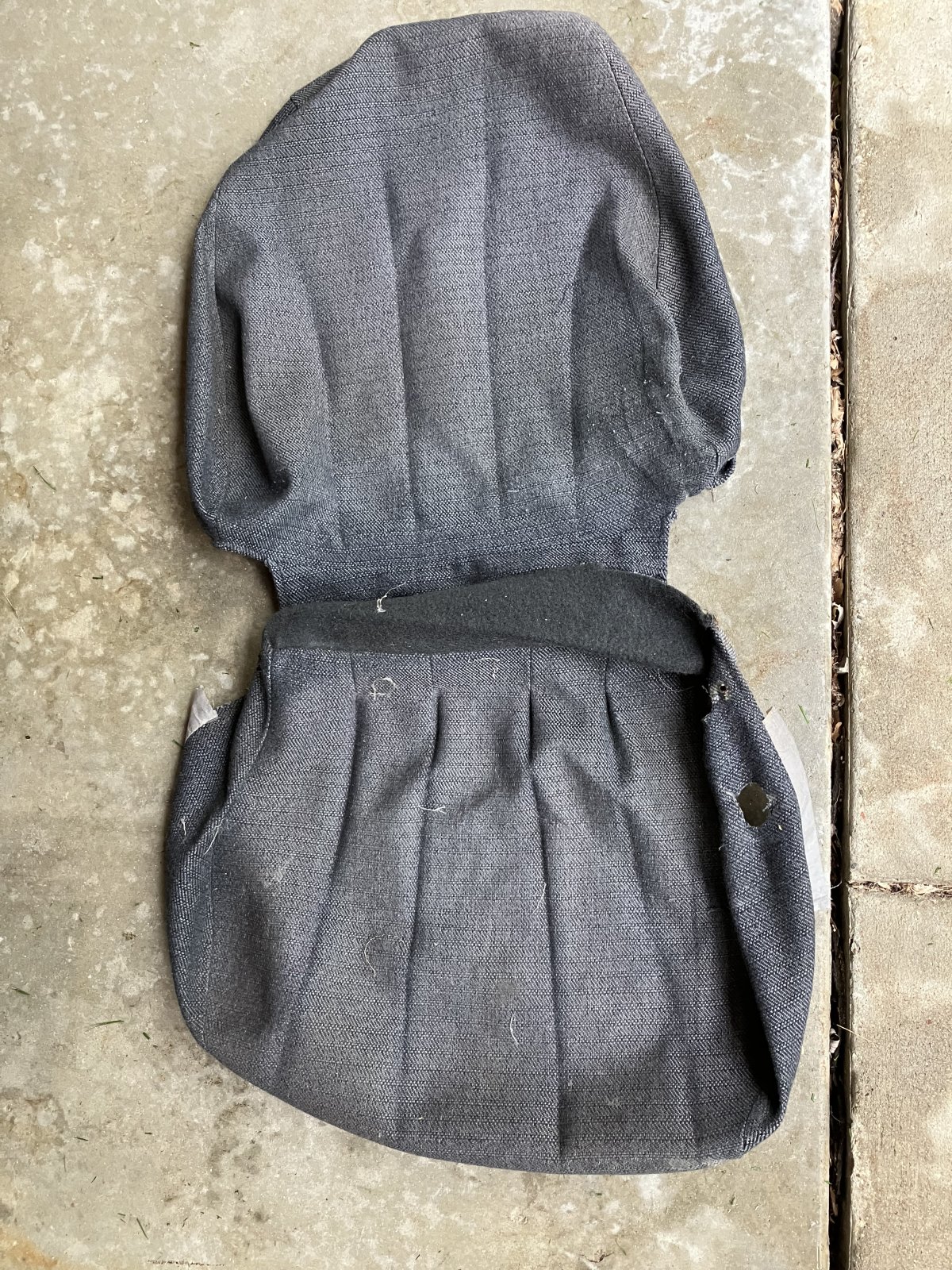

  5. Whoamel
    Joined: Jul 22, 2007
    Posts: 127
    Whoamel
    from So Cal

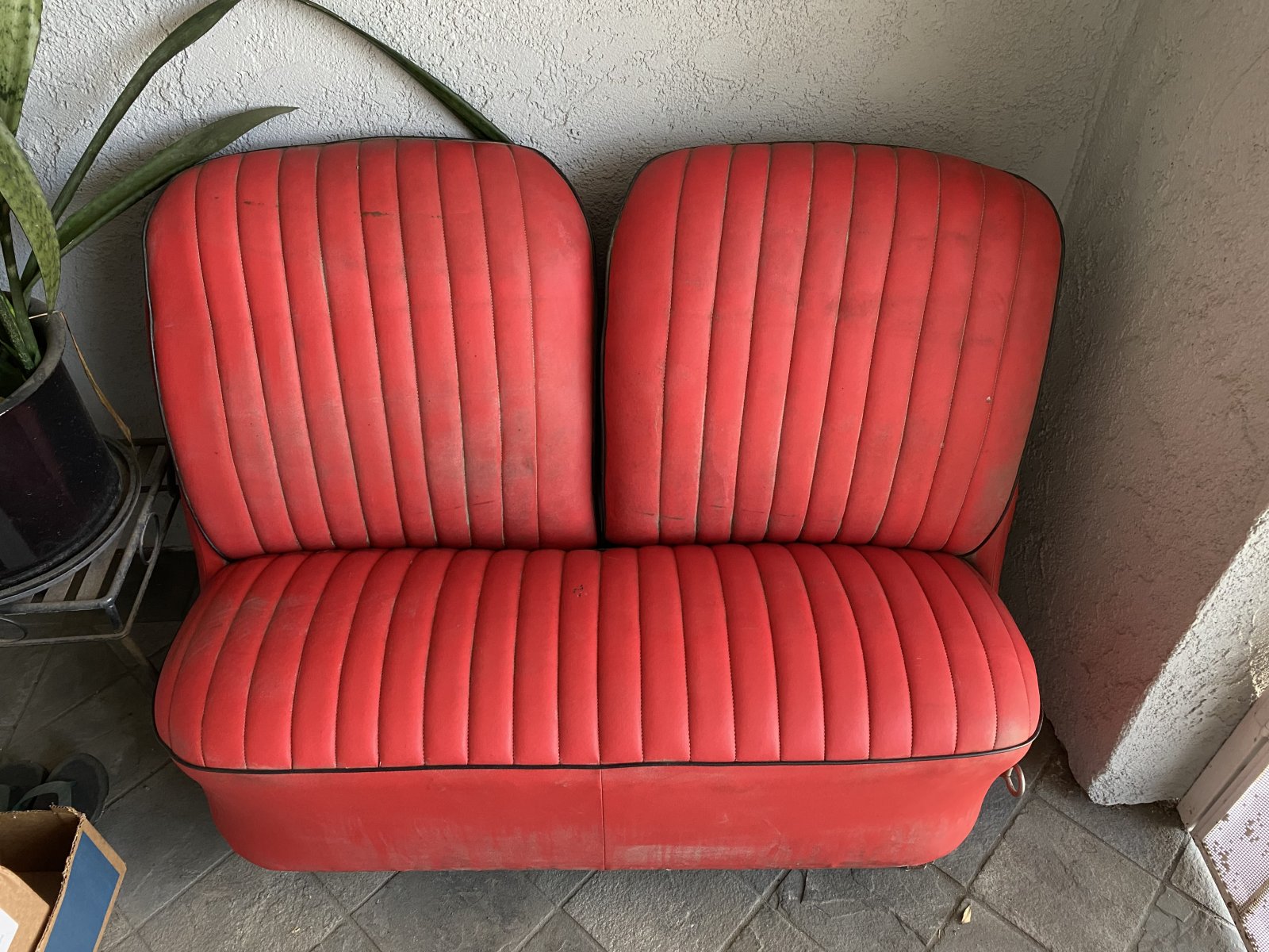

    It's been quiet in here for a while, so I thought I'd post up a bit of an update. I have a '40 Ford Coupe that was done with "rad" tweed interior, and really ratty bright red carpet. I bought a machine, and I've posted what I have done with it so far in this thread.
    My '40 came with a fairly nice Burgundy split bench seat, but it needs to be taken apart for a minor mechanical repair, so I have been looking for a temporary replacement. I love driving the car, and I don't want to have it inoperable while the seat is out. I have been looking for a somewhat nice '40 Ford seat, but most of them are really rusted, worn out, or just plain junk with a high price tag on it. I just missed a nice one a few months ago in Tucson, Az, but someone snapped it up within hours of it being offered for sale.
    This one popped up last week in Bakersfield, CA (appx 100 miles North of me) and I charged up there the next day and came home with this one.
    Not only was it a very nice price, (and in nice shape) but it turned out the seller was "Squeak" Bell. I gotta say, that he is even cooler and more gracious than everyone says he is. I was there for about 30 minutes, he gave me a tour of his shop, and even invited me to stop back in for a beer anytime I was in the area. Truly a wonderful guy.
    Anyway, my plan is to use this as my test mule to practice my seat upholstery on. I'm going to keep the same design (it actually matches the 2" pleats on my interior panels) but I'm going to try to get the pleats on the seat back to match the cushion. As soon as I feel it's acceptable, I'll install it into my car and start on the repair and upholstery on the existing one. I'll post a bit as I go. (Even when I **** in my hat!)
    Sorry if this post is a bit long...
    brEad, drdave, RMR&C and 3 others like this.

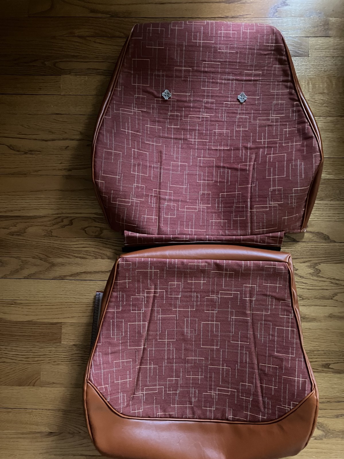

    Life stuff has been slowing me down, but I finally got a first attempt done on my 40 Ford seat cushion. It's not good enough to go on the seat, but it came out quite a bit better than I thought it would. I will say that making mistakes is a good way to learn.
    Much respect to you folks that do this so well. Getting that big cover manuevered around to go through the machine, while keeping the seam straight, and all while keeping the alignment marks on track is quite a juggling act.

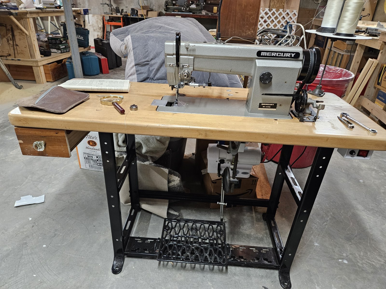

  22. Sporty45
    Joined: Jun 1, 2015
    Posts: 1,388
    Sporty45

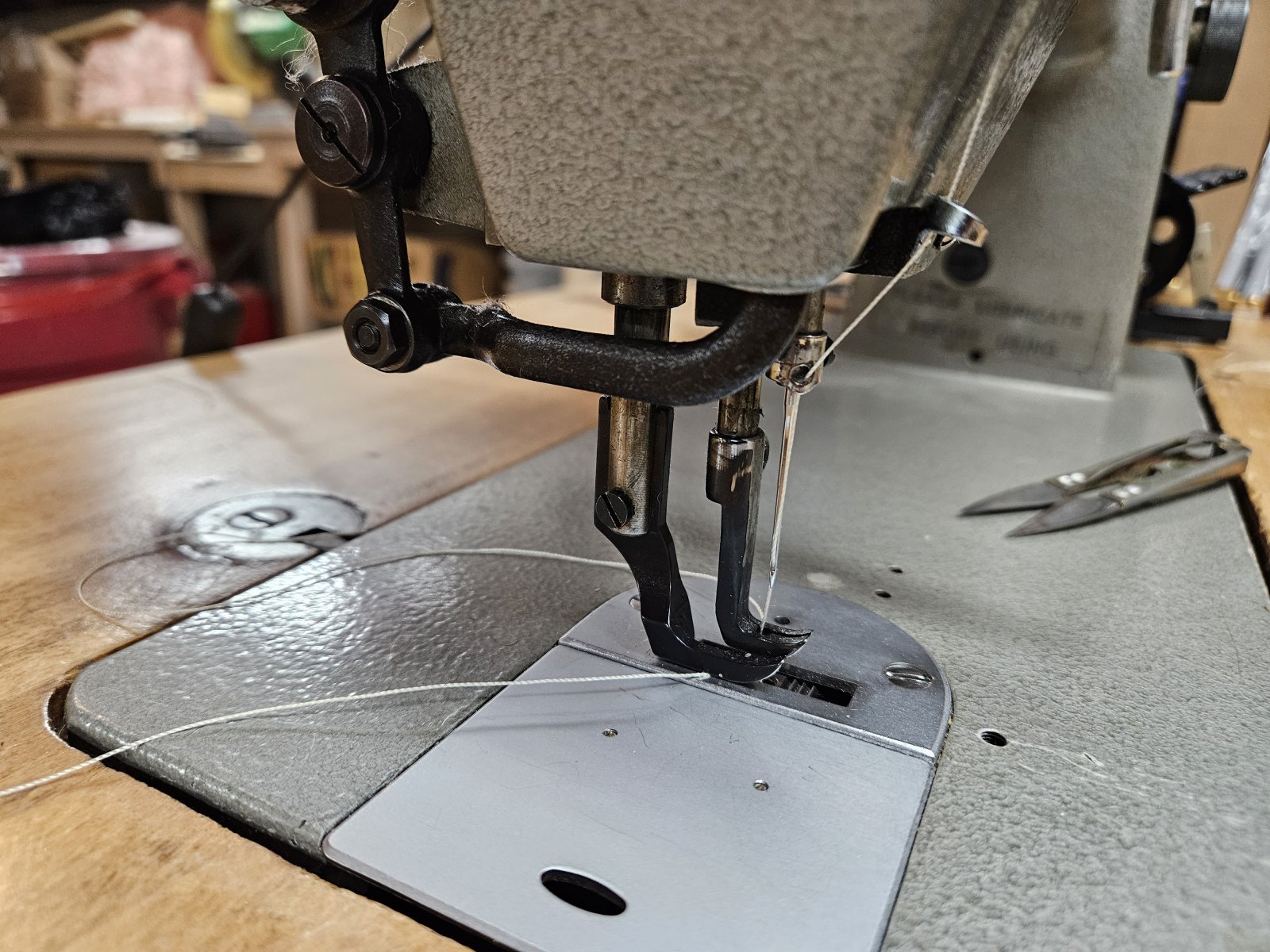

    Recently picked up this older Mercury branded walking foot machine with a servo motor, and it has reverse, for $400. Not much online about it, but looks a lot like the Sailrite Fabricator. Works well, still learning how to set tensions for different thicknesses and materials. I've tried doing short lengths of pleats and french seems threw heavy cloth cemented to 1/2 sew foam and I'm real happy with it so far! Being new to me, I might bring it in to the local sewing machine repair shop and have it gone over by a professional to have it cleaned and make sure everything is set up correctly.
  23. stanlow69
    Joined: Feb 21, 2010
    Posts: 7,346
    stanlow69
    Take a close-up picture of the foot with the needle.
  24. Sporty45
    Joined: Jun 1, 2015
    Posts: 1,388
    Sporty45
    Like this?
    stanlow69 likes this.

  27. stanlow69
    Posts: 7,346
    stanlow69
    Sunbrella is stiff and won`t stretch. Might be a little hard to work with.
  28. stanlow69
    Posts: 7,346
    stanlow69
    I thought it might not be a walking foot, but it is. Good find. It looks like it hadn`t been used much.
    Sporty45 likes this.
