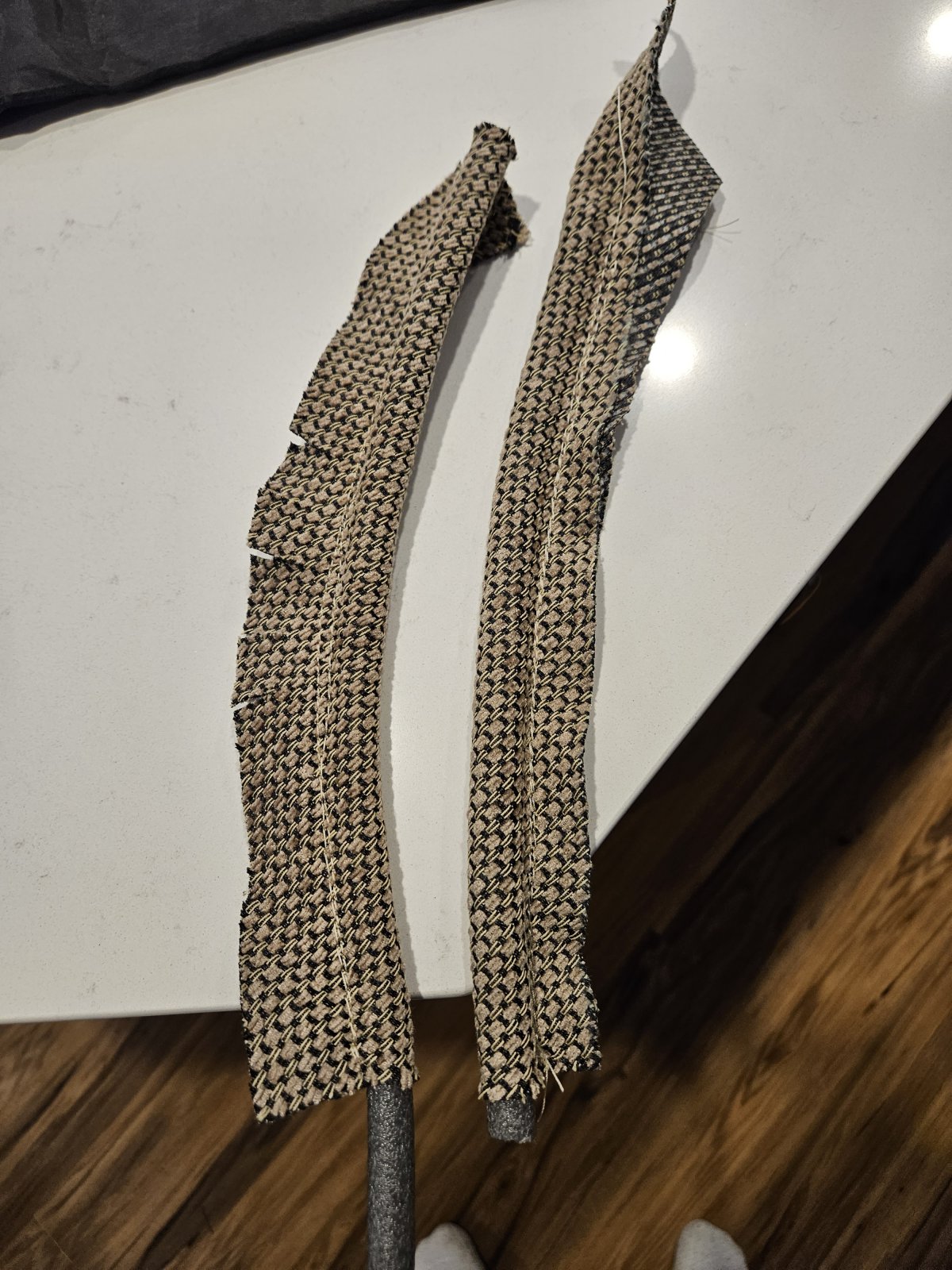

  17. Sporty45
    Joined: Jun 1, 2015
    Posts: 1,388
    Sporty45
    First 2 attempts. Both with the cording foot. windlace.jpg I think I need more practice!

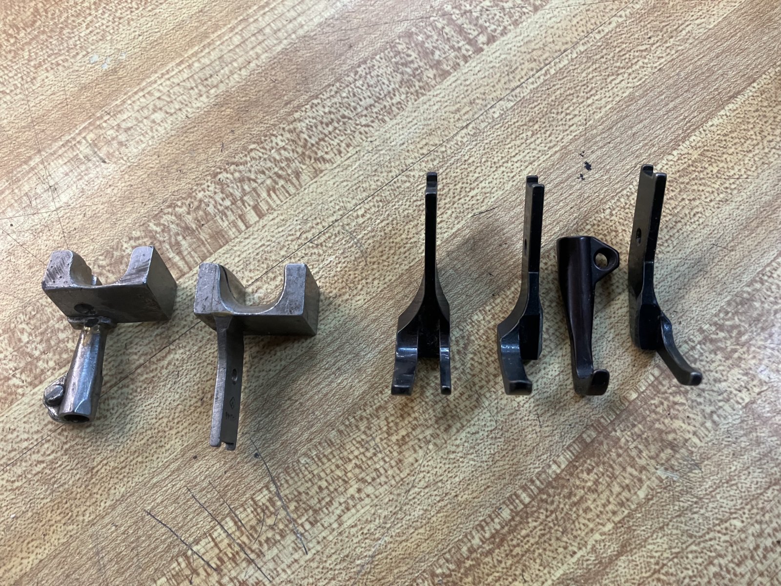

  18. jakesbackyard
    Joined: Feb 13, 2007
    Posts: 949
    jakesbackyard
    from ND
    I’m lucky enough to have 1/2” windlace feet (on left) that I acquired 30+ years ago. They are probably older than me. Lol. They work great. An alternative is to take the original flat feet which are rarely used (I keep my small cording feet on 99% of the time.) and remove one side of the main foot to be able to get close. The left black foot is an original flat foot. The other two black feet have had one side removed. I use them for special times I need to get close. Work great for sewing the edge of sun visors.

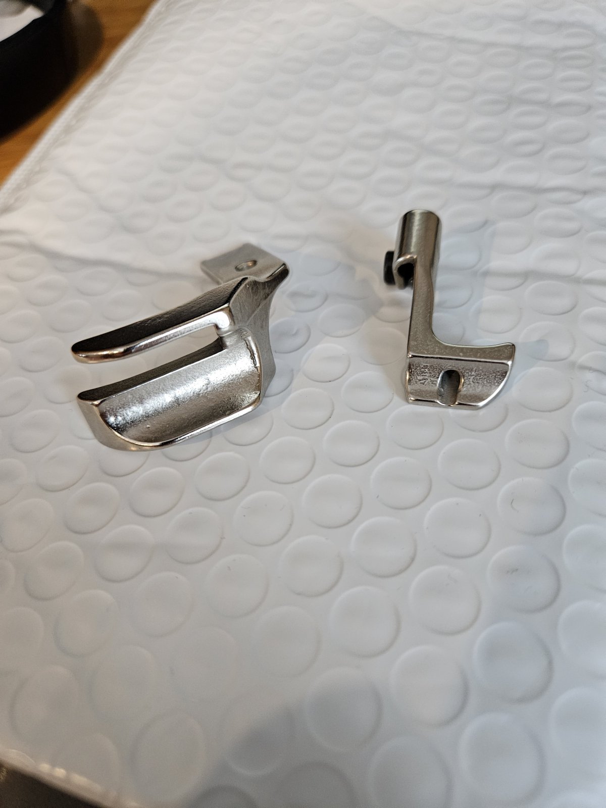

    Sporty45
    I found this set for 1/2" on amazon. How does this set look to you?
    https://www.amazon.com/Consew-Walki...ext&ref_=fplfs&smid=A3HPQS1YHCBIBL&nis=6&th=1
    Also this one.
    https://www.amazon.com/Sewing-Walki...ext&ref_=fplfs&smid=A3HPQS1YHCBIBL&nis=6&th=1

    Just ordered a set :D
    Dick Stevens likes this.

  25. Sporty45
    Joined: Jun 1, 2015
    Posts: 1,388
    Sporty45

    Sporty45
    Got mine today. Look pretty good. Haven't had a chance to try it yet, though. Have you gotten yours?
