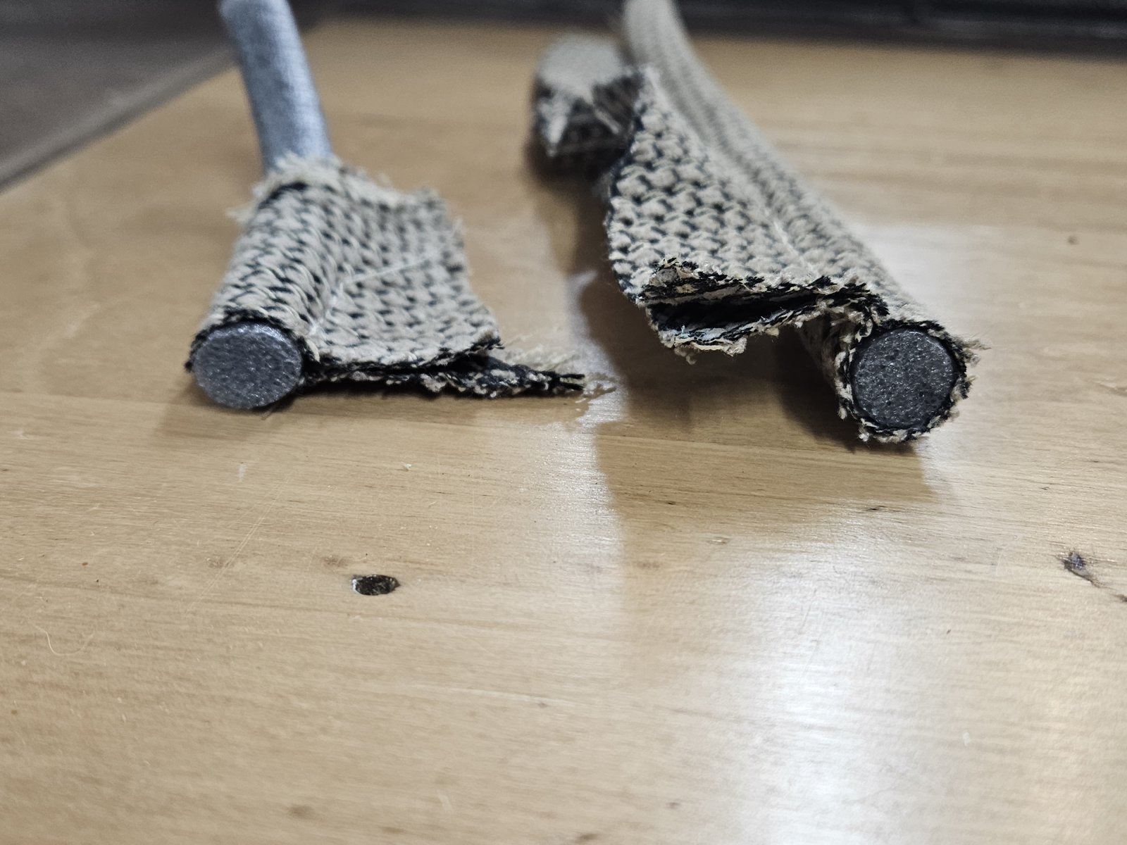

    I just ordered a 5/8" and 3/4" set. The 1/2" set that I just got doesn't really work well with 1/2" cord with heavy cloth wrapped around it. It kind of pinches the cord. I'll post a pic later showing what I'm getting.

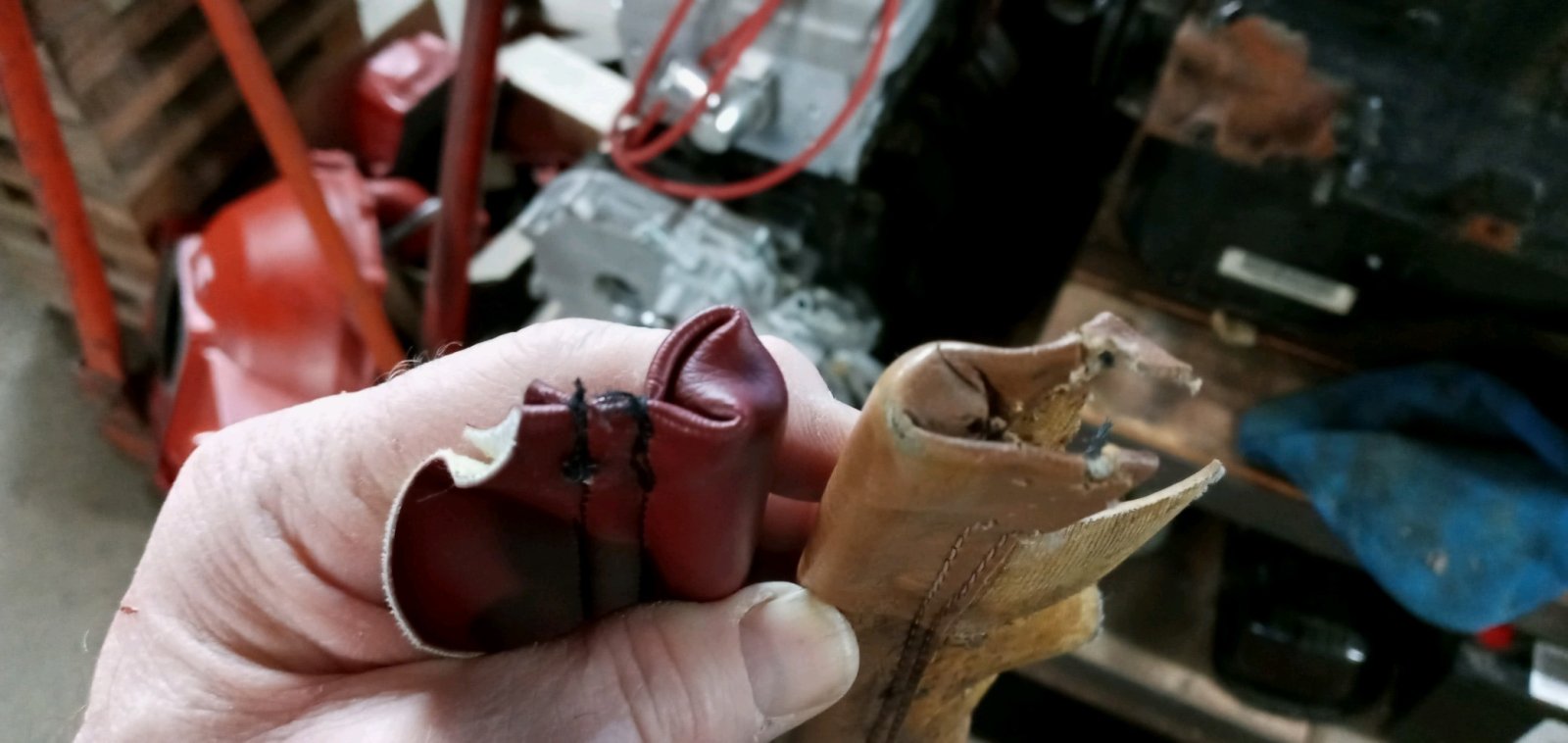

    Here's a picture of what I am talking about with the 1/2" foot. The one on the left is the one made with the 1/2" foot and the one on the right is made with an 1/8" cording foot. I fed the windlace to the right of the needle with that one.

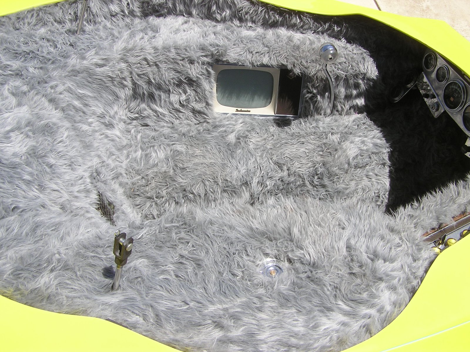

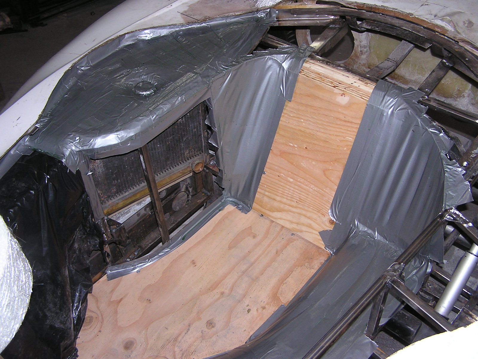

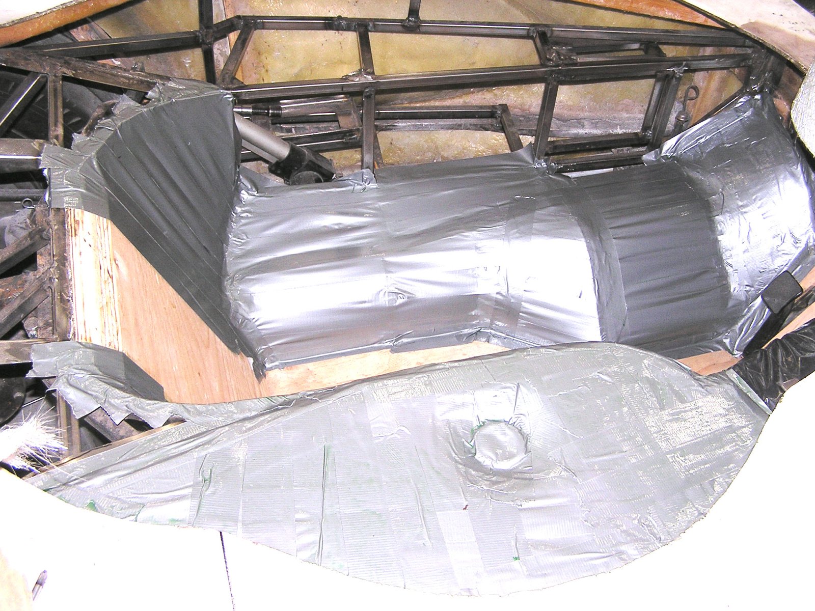

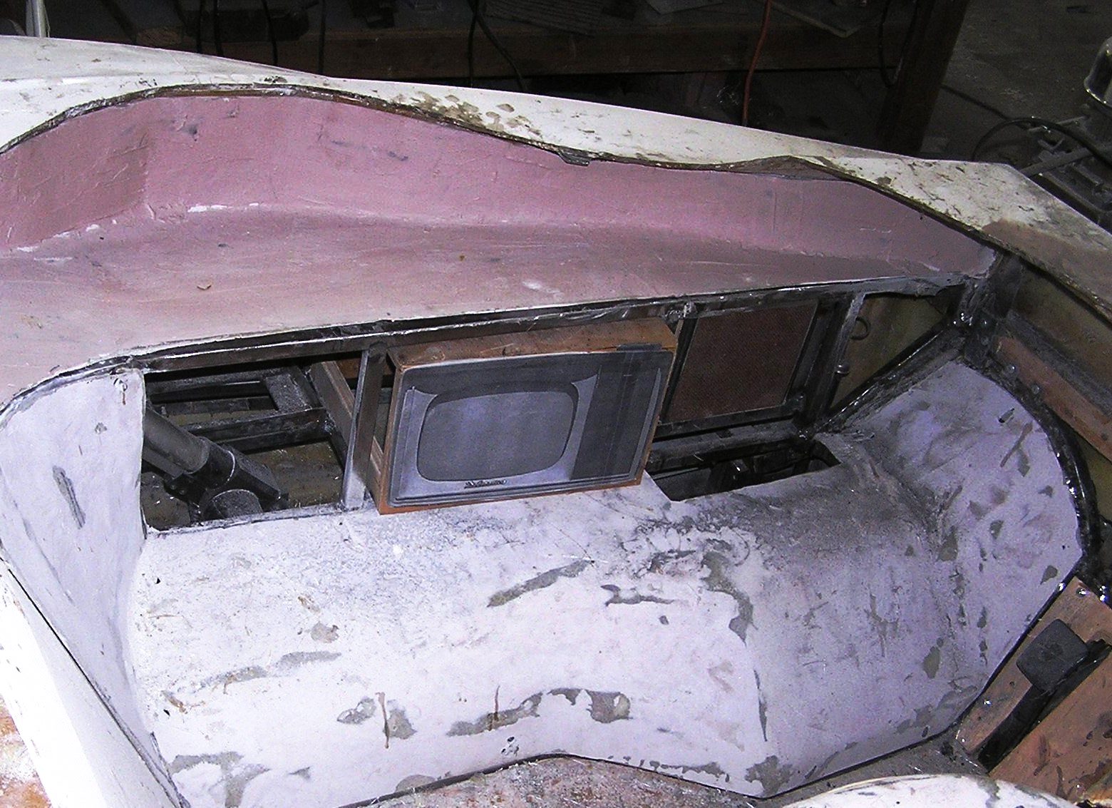

    Here is my attempt at Ed Roth upholstering. Needed fur covered interior for my Mysterion reproduction. Shopped around getting fur swatches from everywhere before finding the right stuff. Had to make the crazy shaped panels from mostly fibergl***. In this process I discovered a great method for making molds for fibergl***. 3 layers of duct tape was laid over areas to be paneled and I laid fibergl*** and resin over that. I figured the tape would become a permanent part of the panel. To my surprise, the tape easily popped off the 'gl***! All that was left was to contact cement the fur to the panels.
    interior panels duct tape 3 - Copy.JPG interior panels duct tape 1 - Copy.JPG interior panels  in progress 3.JPG interior panels  done 2.JPG p1010445.JPG P1010447.JPG

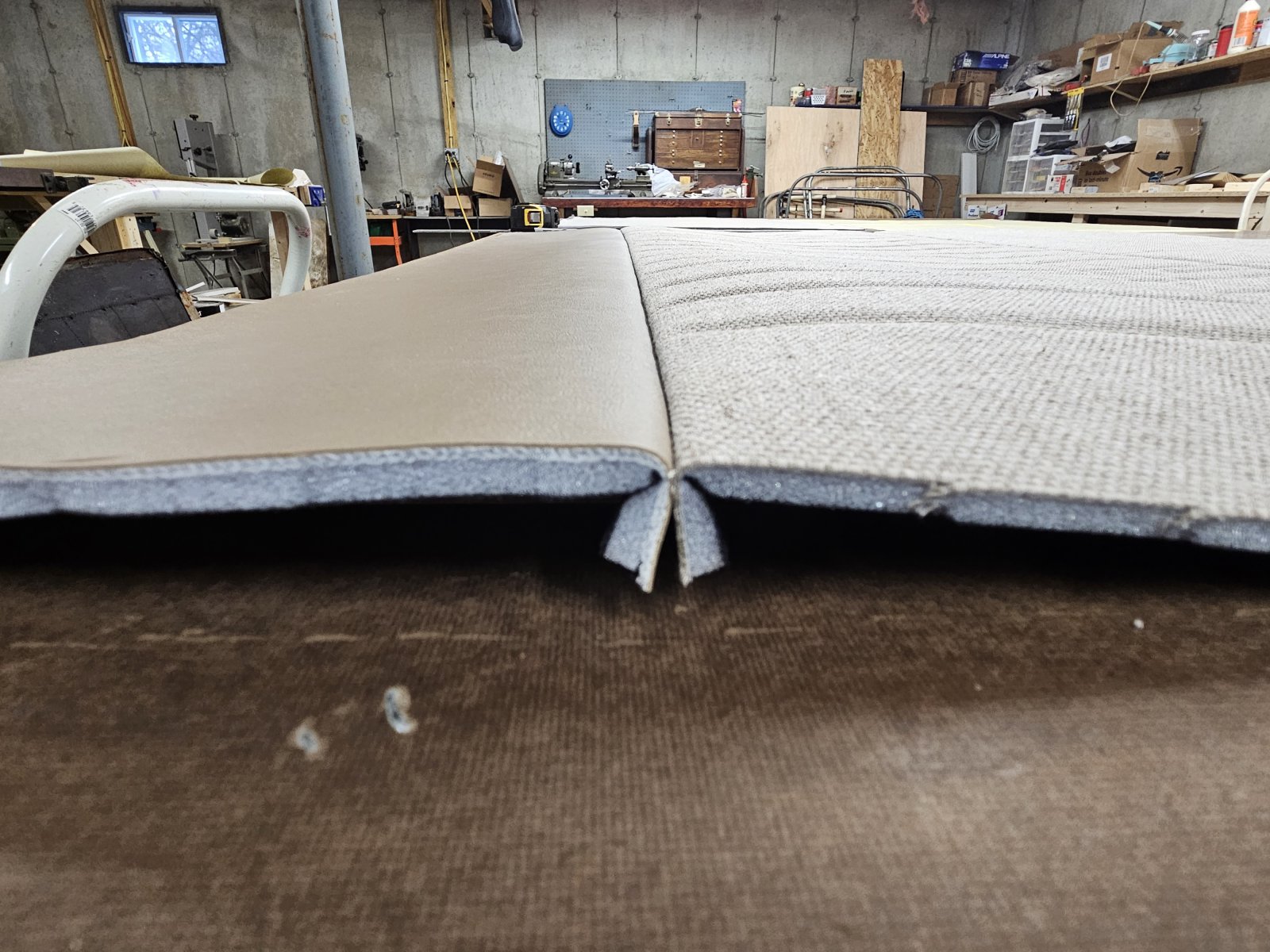

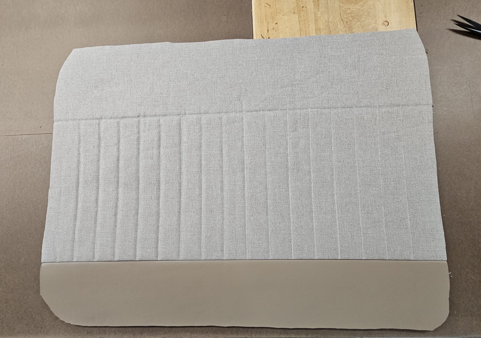

    I started work on the door panels today. It took me all day to get one put together! It came out pretty good, and I'm happy with it, but have a couple questions. In the first pic you can kind of see the wrinkles in the cloth. This happened from rolling it up as I was sewing the pleats. They aren't bad, but would like to get rid of them. Not sure how to go about doing that. I thought of ironing them out, but was worried about the foam melting, as well as the glue. Maybe steam? In the second pic you can see where the vinyl and cloth pieces are joined. Do you trim this excess material as close to the thread as you can, or just push it down as tight as you can when you glue it to the door card?

    Door panel looks great! I’m no expert, but pretty sure you want to leave some of the extra on the back side and not trim it all the way up to the thread. I would trim it to maybe a 1/4 inch and then try to flap it open so it would lay flatter. For the wrinkles I would try a steamer….should help quite a bit.

  26. SwampLedge
    Joined: Jul 3, 2012
    Posts: 39
    SwampLedge
    I’m just an old fart learning by doing and YouTube. I have been handling the excess material in the seam by cutting away the sew foam (to within about 1/16” or so of the threads in the seam, which is easy to do with scissors) and leaving the vinyl excess. That leaves plenty of material for strength but removes the bulk which comes from the foam.

  27. Sporty45
    Joined: Jun 1, 2015
    Posts: 1,388
    Sporty45
    Thanks for the compliment! There are a couple not so straight sew lines, but I think it's not too bad for a rookie :p I was afraid to trim too much off that back seam, but a 1/4" sounds reasonable. I'm going to try going over it with a roller to flatten it as best I can, and will try a steamer on those wrinkles ;)
