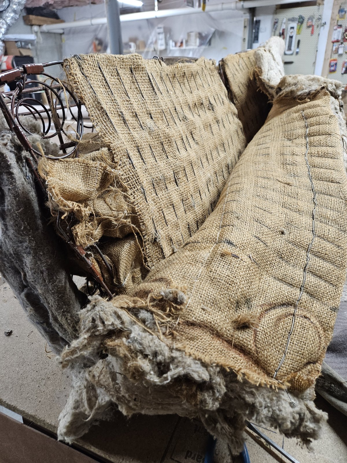

    If it wasn't for the worn area in the drivers side and the musty/mildewy smell, I think I would just recover this bench seat in my 47 Olds! It is in pretty good shape otherwise. The springs (all coils) seem kind of weak too, but not sure if there is anything I can do about that. There aren't any broken ones, but I would prefer a firmer seat. Any ideas to firm it up? I can take more pictures if needed.
    osage orange likes this.

  6. Tightly roll sheets of foam and stick them inside the coil springs, then wrap the springs in burlap. Stiffens the springs, helps hold them in place and doesn't take much material to do the entire seat.
  7. Sporty45
    Joined: Jun 1, 2015
    Posts: 1,387
    Sporty45
    That sounds like a great idea. The springs are already wrapped in burlap, so I will just need to stuff some foam into them. Can probably pick up some 1/2" foam fairly cheap to do it with, too! Thanks for the help :cool:

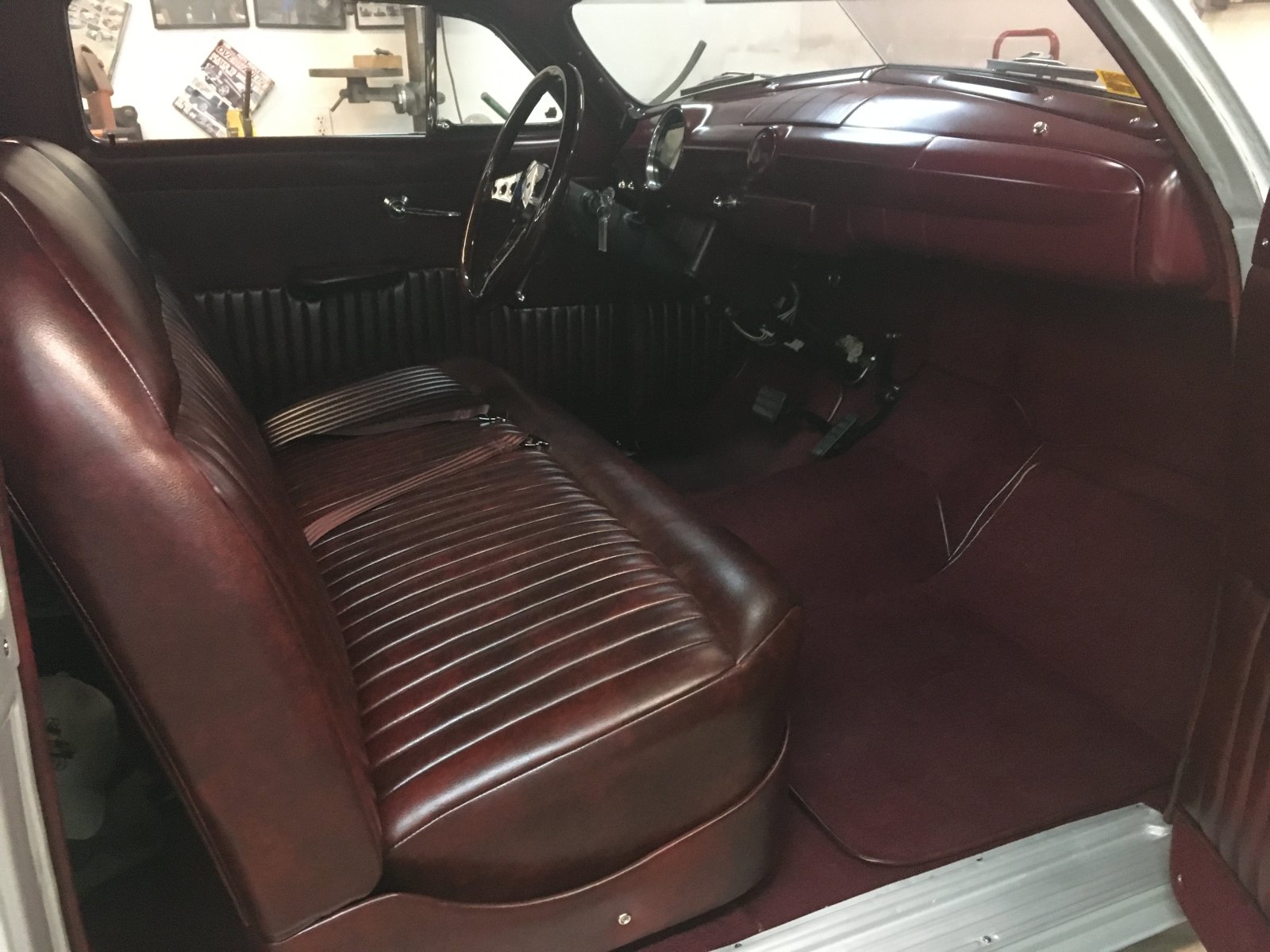

    Finished up that roadster seat a couple weeks ago and it’s in the car…

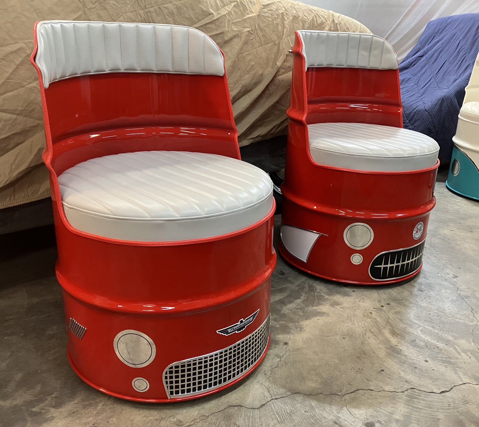

  13. jakesbackyard
    Joined: Feb 13, 2007
    Posts: 949
    jakesbackyard
    from ND
    Looking through some pics reminded me of these…
    Only a small portion of it is upholstery. I cut up 55 gallon soup barrels, painted, detailed and upholstered these last year. Working on a couple more right now. Just fun stuff to do in retirement. A guy has to have something to keep busy.

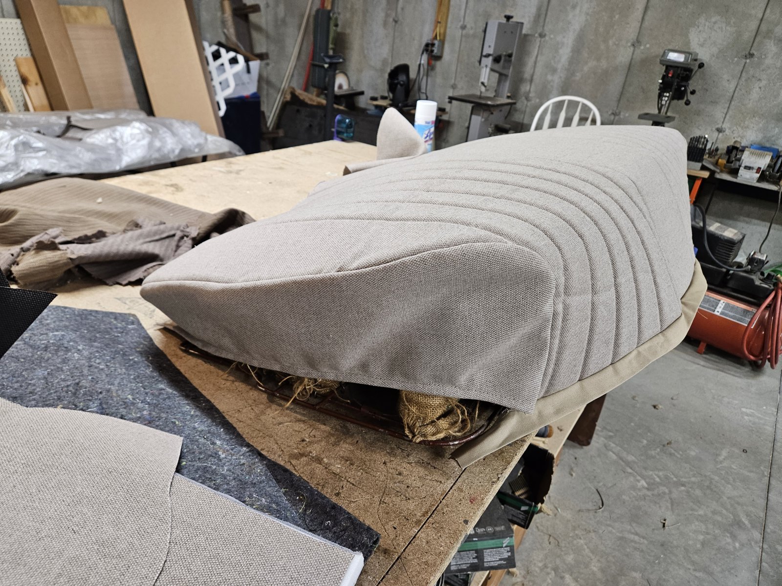

  16. Sporty45
    Joined: Jun 1, 2015
    Posts: 1,387
    Sporty45

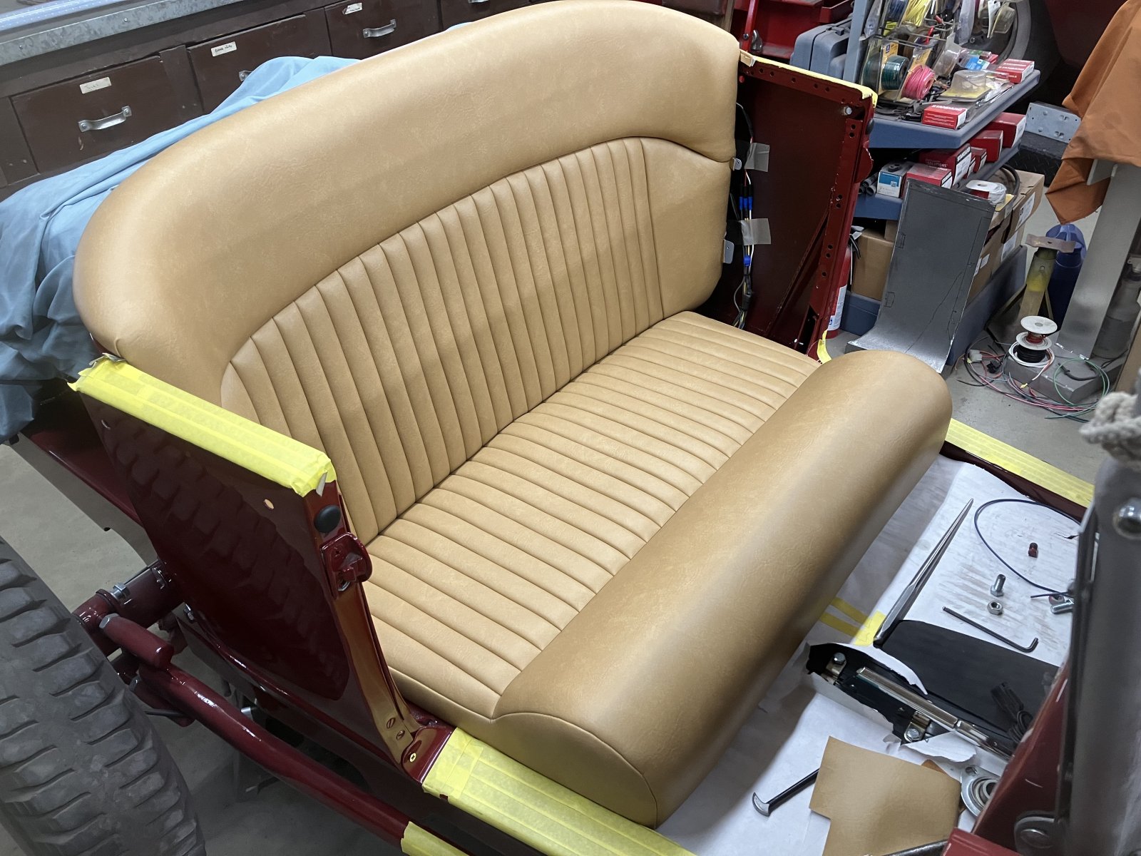

    I have the front seat lower cover done. Just need the foam to show up before I can attach it. It took me about 3 days to get done, but I'm pretty happy with the results!
    Squablow, brEad, Whoamel and 4 others like this.

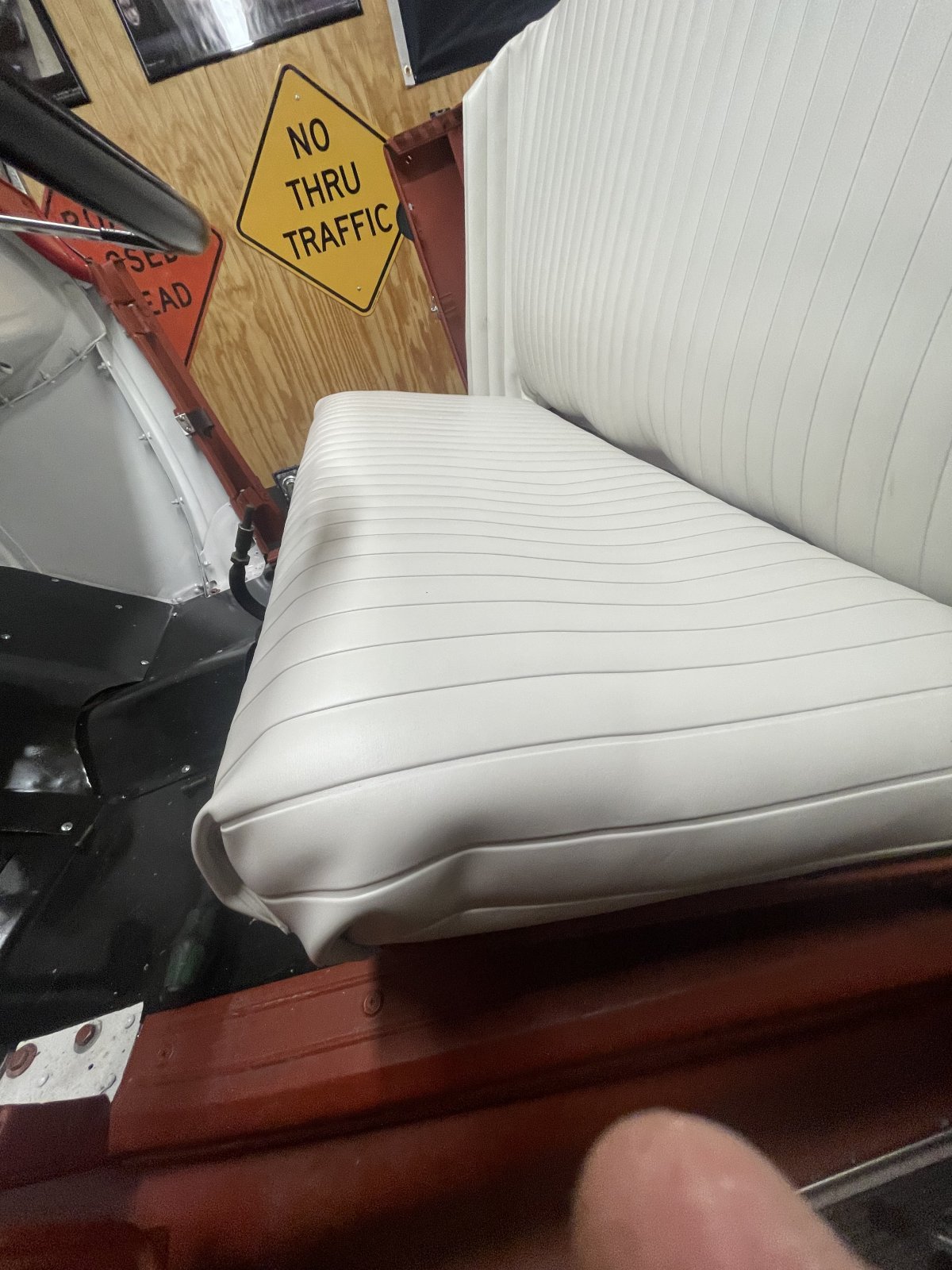

  17. Whoamel
    Joined: Jul 22, 2007
    Posts: 127
    Whoamel
    from So Cal

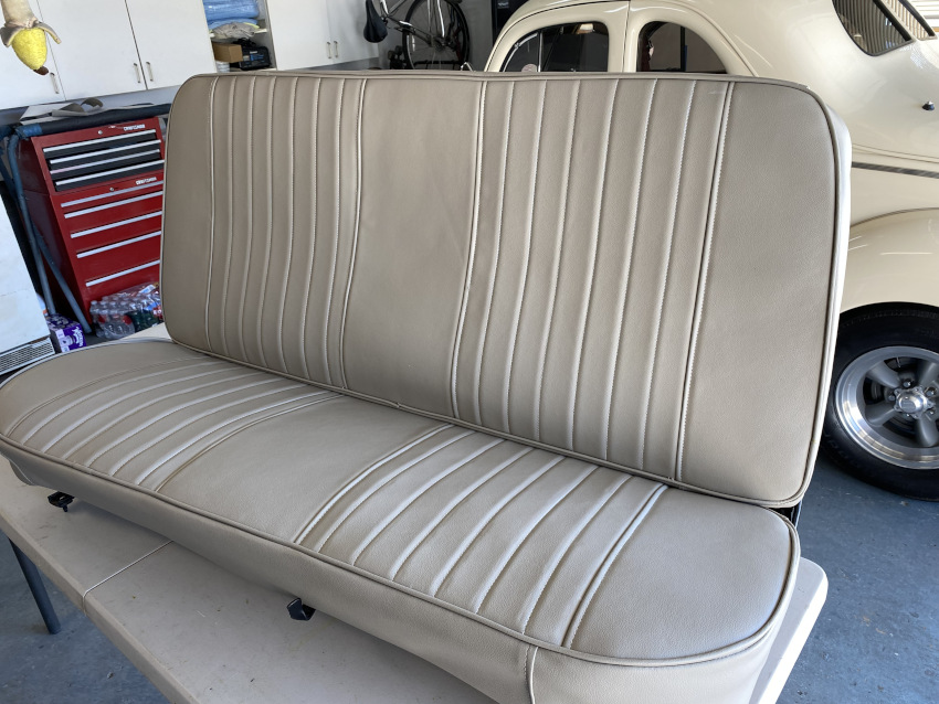

    I just got my very first seat done, as well. There is a bit of wonky in it, but for first try, it came out a bit better than I thought it would..
    Everytime I try something like this, I learn a little bit more..
    Squablow, reagen, brEad and 8 others like this.
  18. Sporty45
    Joined: Jun 1, 2015
    Posts: 1,387
    Sporty45
    Looks great to me! This is my first attempt at upholstery too, and I can see all my "wonky" spots too, but ya gotta look close :cool:

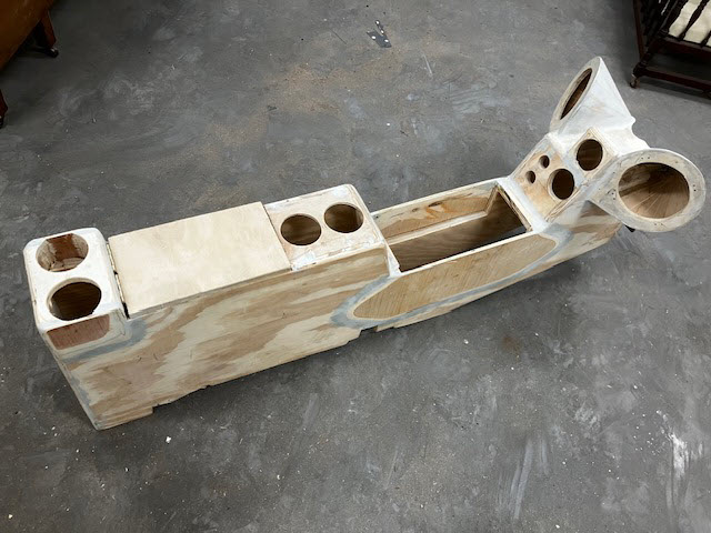

    Yours is an old post and I tried to start a thread covering center consoles that got erased but here is what I did before it gets erased! Wanted a center console for my '40 Plymouth. Made it of plywood then decided not to try to upholster it. I covered it in fibergl***, body finished the surface then painted it body color.

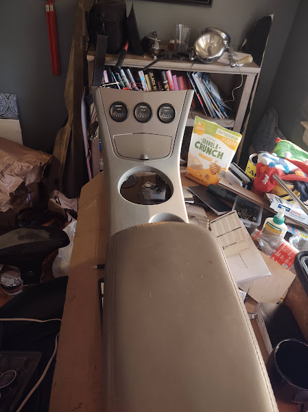

    I ended up going a different direction with an 08 Sebring. I took the HVAC knobs out and put the gauges in. I'm going to fill in the shift hole and put a kill switch and a trunk popper behind the little cubby door.

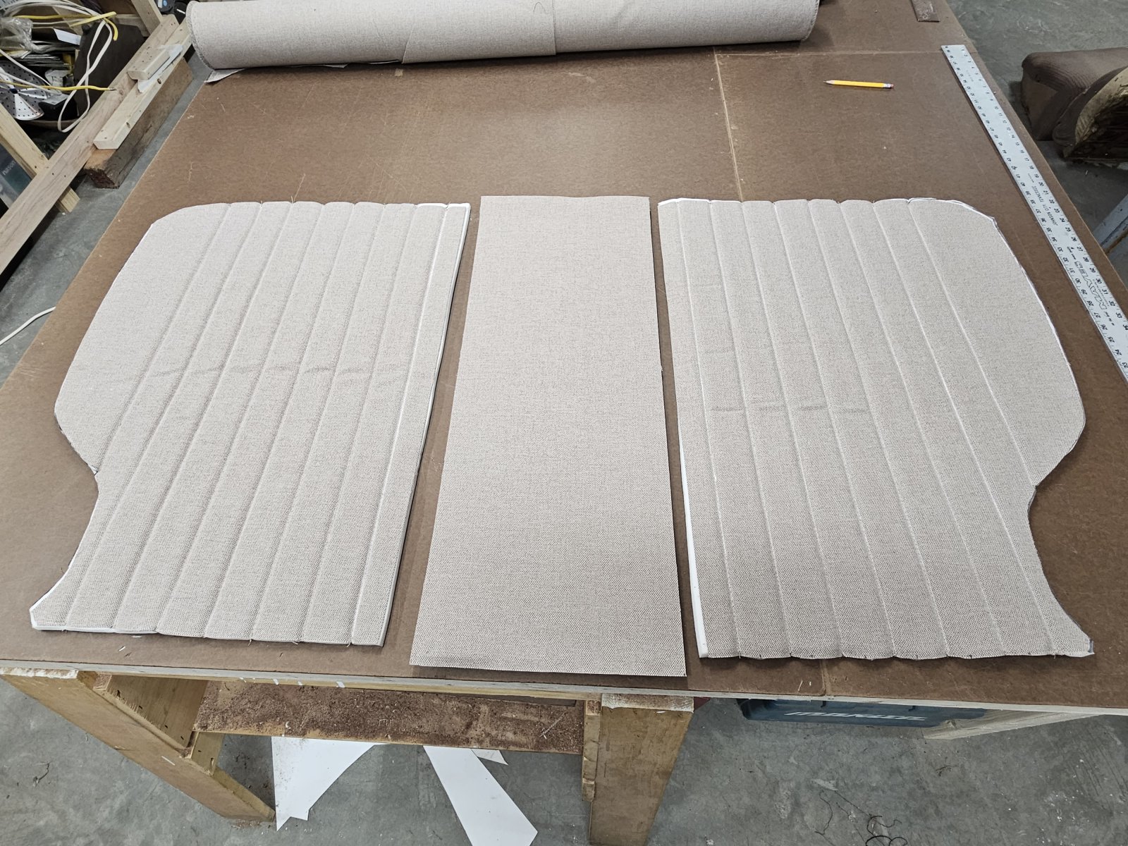

  23. Sporty45
    Joined: Jun 1, 2015
    Posts: 1,387
    Sporty45
    Got more work on my front seat done. I have the front section of the split seat backs done. Still need to do the backsides.
    A little before and after pic,
    And both sides done!
    brEad, snoc653, JD69 and 2 others like this.
  24. jakesbackyard
    Posts: 949
    jakesbackyard
    from ND
    A couple more barrel chairs added to the fleet…
    drdave, dana barlow, brEad and 3 others like this.

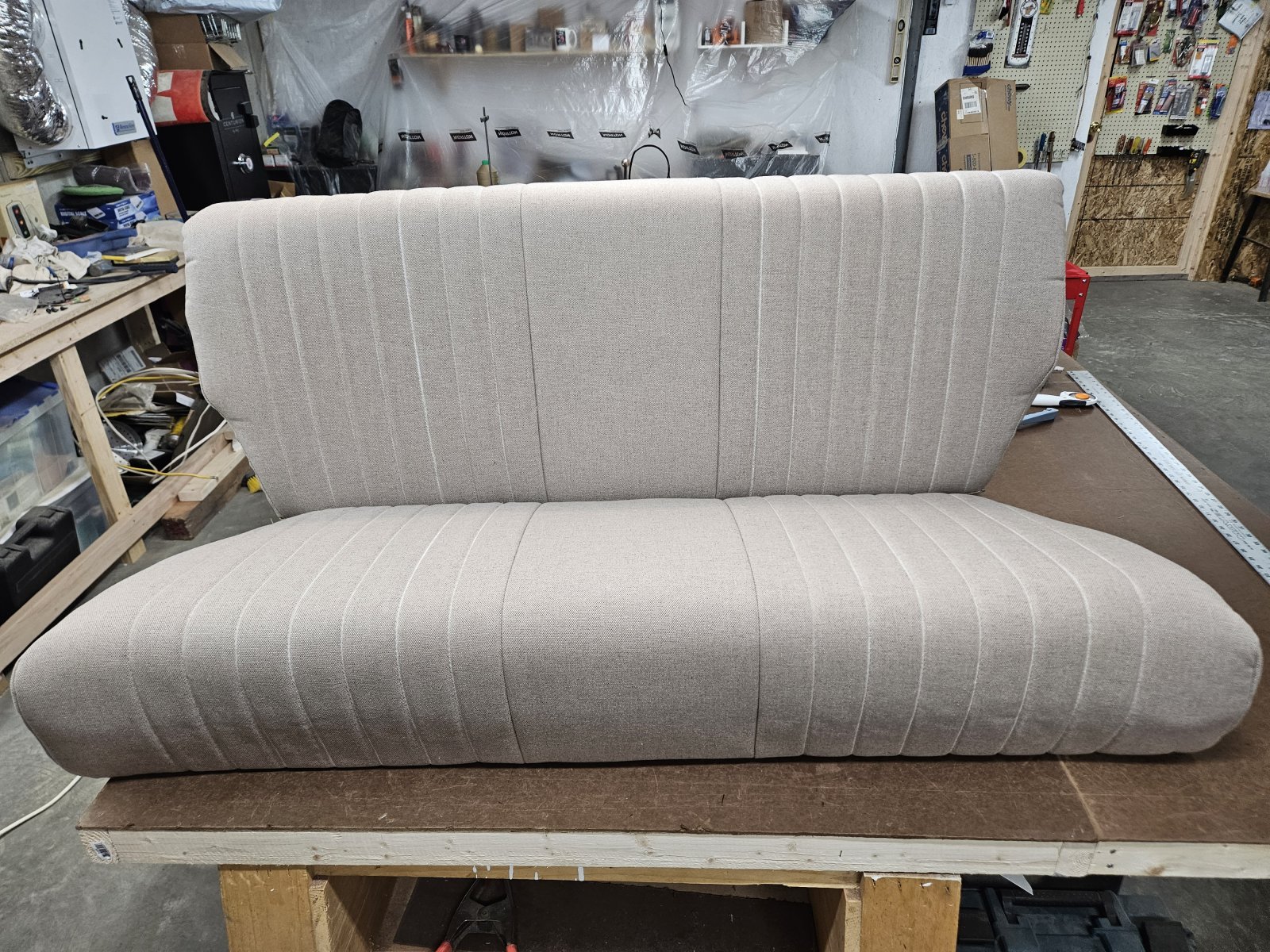

  25. Sporty45
    Joined: Jun 1, 2015
    Posts: 1,387
    Sporty45
    Getting there. Still waiting on foam for seat bottom to come in before I can attach the upholstery to it. I'm pretty happy with it so far.
    drdave, 3quarter32, brEad and 4 others like this.

  29. Sporty45
    Joined: Jun 1, 2015
    Posts: 1,387
    Sporty45
    Seats are done. I'm pretty satisfied with the way they turned out, not perfect by any means, but a tad better than what I started with! I have an issue with the drivers side seatback. It doesn't seem to fit into the back cover as well as the p***enger side does. I've tried several times to get it to fit better, but no dice. Not sure what is wrong. Take a look at the pics and you'll see what I'm talking about. Any ideas?
    brEad, SDS and Whoamel like this.
