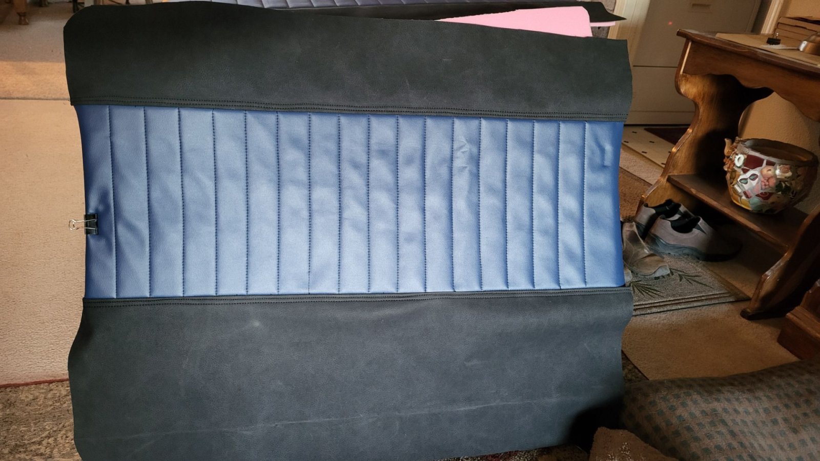

  7. SDS
    Joined: Apr 28, 2011
    Posts: 1,074
    SDS
    OK, gave birth to my first door panel today...
    IMG_7227.jpg IMG_7233.jpg IMG_7226.jpg PXL_20240506_185949433.jpg PXL_20240506_185955281.jpg

  12. SDS
    Posts: 1,074
    SDS
    Big kudos to whoever turned me on the Weldwood landau top adhesive. I returned the five spray cans of 3M stuff and bought a gallon of Weldwood and a $20 EZE glue spraygun. This stuff is amazing to work with and stocks like mad. In addition, I've made two door panels and only used about an inch from the gallon can.
    Will never go back to spray cans.

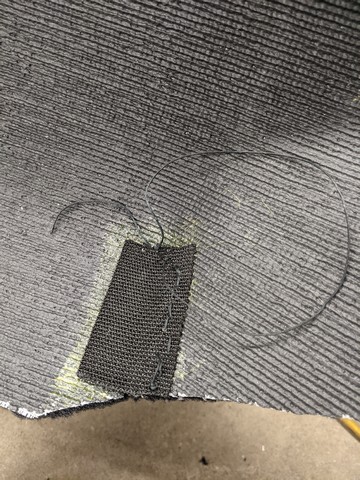

    SDS, one of the guys on allmetalshapers.com uses belting and adhesive and then sews with a large needle and twine to bind any darts or inside corners. That doesn't add to the thickness.

    Yes, but skipping the first hand sew portion and hand sewing the belting to the carpet on each side of the gap.
