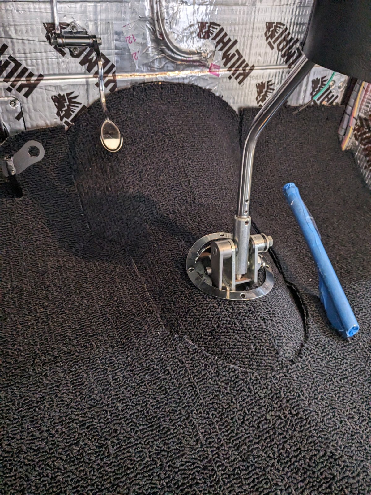

    I like the way your carpet is turning out, looks great! Is that a Gennie shifter you're using? Where did you get the trim ring? I'm using a Gennie shifter and am going to need one to fit it. I plan on sewing up my own leather boot.

    Yes, Gennie - call Nick and I'm sure he'll hook you up with just the ring.
    As a word of advice, plan in advance which orientation is best for your screw pattern. I did mine like a +, but it would've been better as an X to avoid things (linkage, wiring, etc.) underneath.

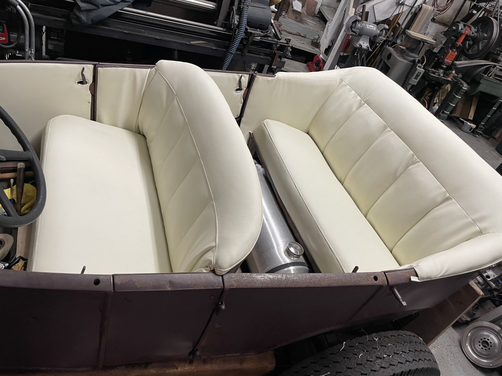

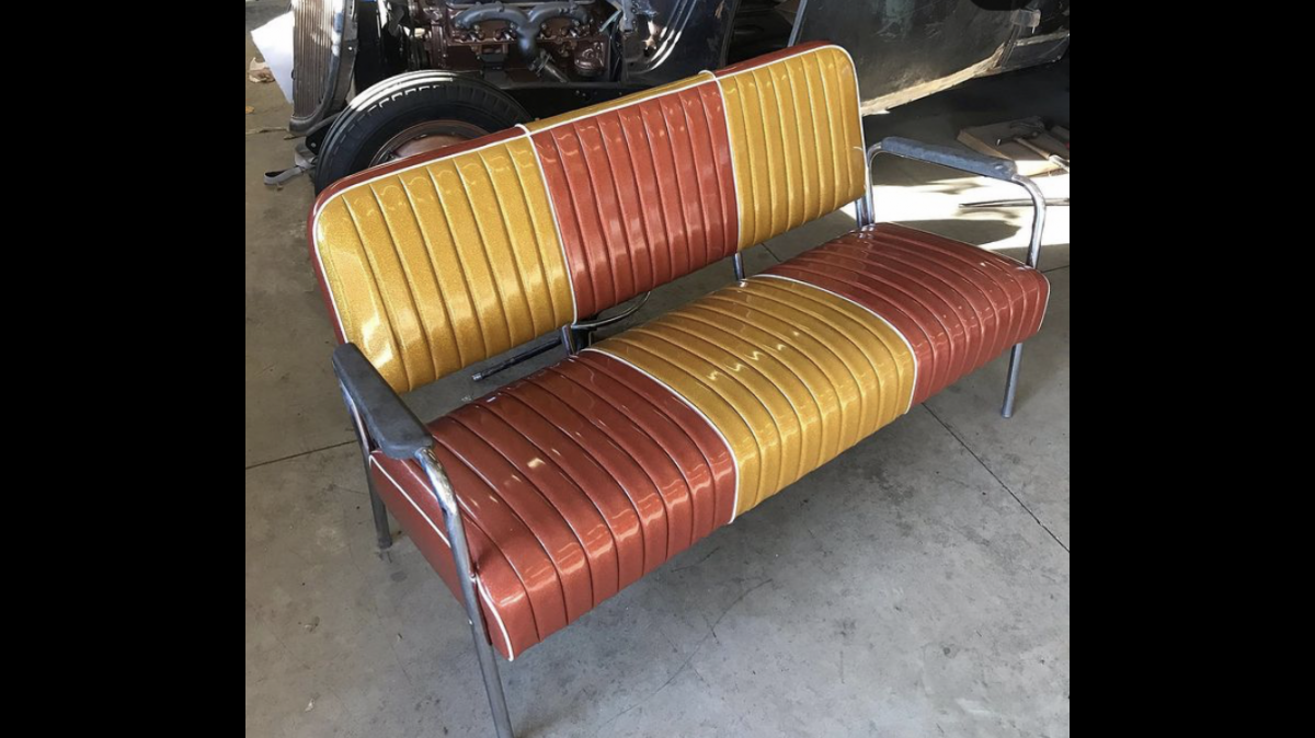

    Im not an upholstery guy, but I just made this 40s style interior for my buddy's T.
    Squablow, reagen, Okie Pete and 11 others like this.

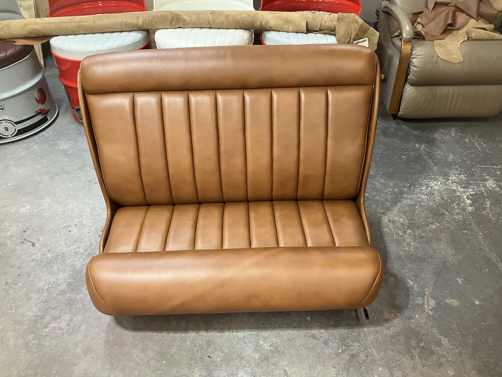

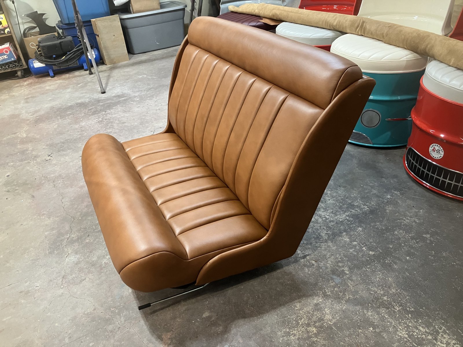

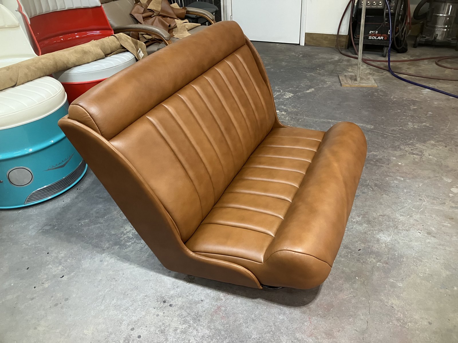

    I got talked into doing another hot rod seat. This one’s going in a deuce 5 window. Done in leather.

    That is *really* nice!

    That is great work on that seat.

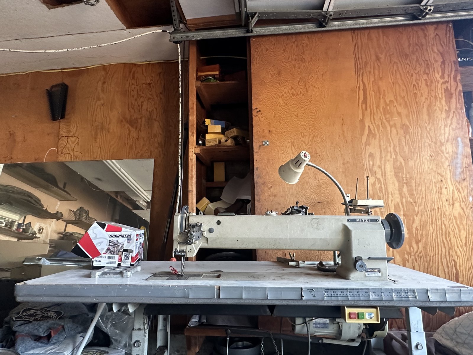

  19. Wow! I’ve been looking for a thread like this. I will be teaching myself how to do upholstery since I can’t afford what shops are asking. Have my machine and after my vacation I’ll be cleaning up the garage and setting it up to start to practice. My machine is a Mitzi LU401-25BTC. I don’t have a manual but am sure either my friend I got it from will help me out learning it.
    Damon777, RICH B, Roothawg and 4 others like this.

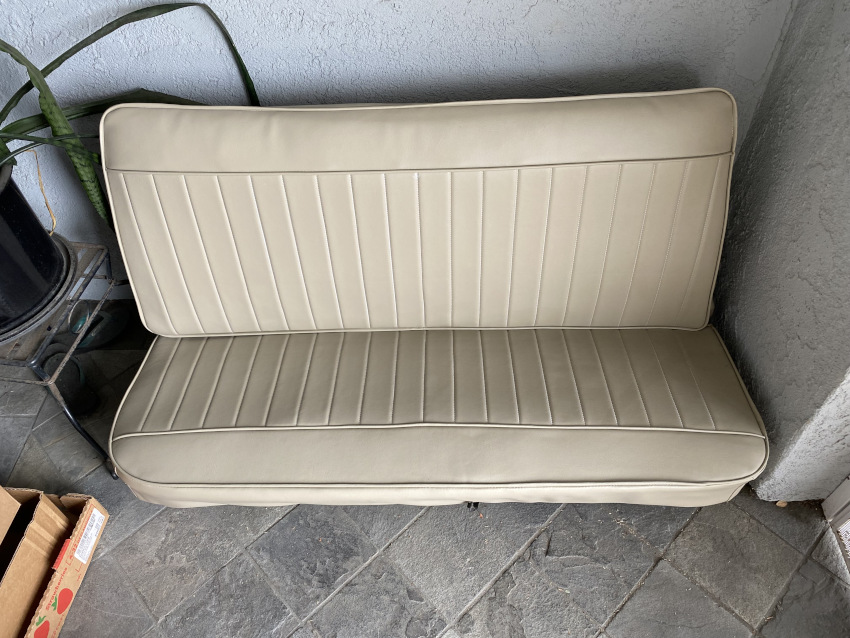

    I'm buying old Datsun pickup seats on the cheap, and redoing them for practice. I sell them really cheap so I can move onto the next. Here's the third one I've done. I'm not too sure if I'll ever get good at it, but I enjoy the challenge, and it keeps me busy.
    It's a bland color, but the grey can go with almost any interior color. They usually sell quickly.

    Put a layer of batting in there and sit it out in the sun - all those ripples and wrinkles will magically disappear. I was disappointed with mine until I did so.

    Thanks for the tip! That's a good one to remember.
