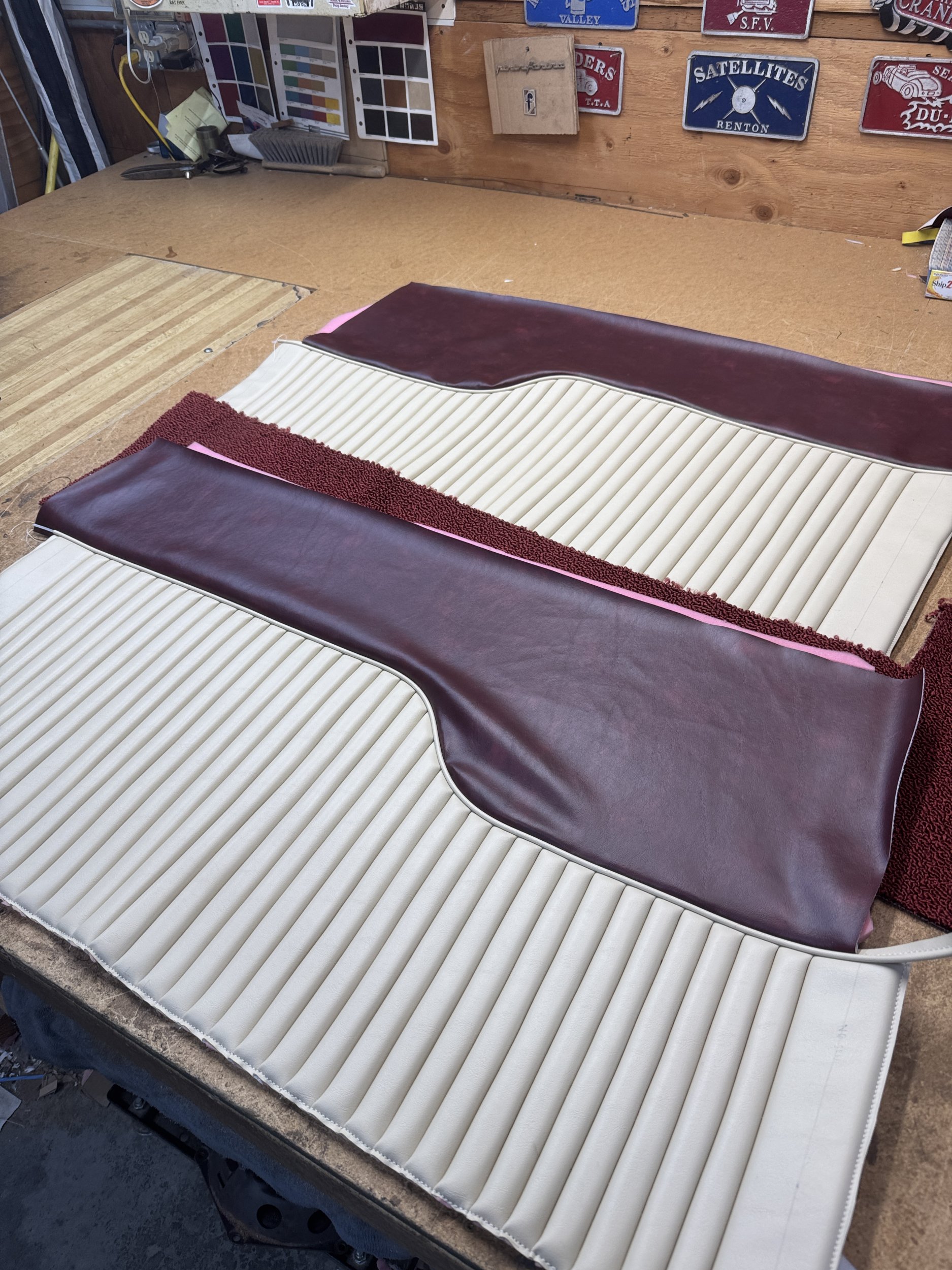

    im cutting on the black line and sewing the yellow. 2 1/2" wide pleat to start. finishing with 2" wide after sewn back together.
    f-head, the material shop i have been visiting said the 1/4" scrim is for the door panels and the 1/2" is for seats. 1/4" so the door handles clear

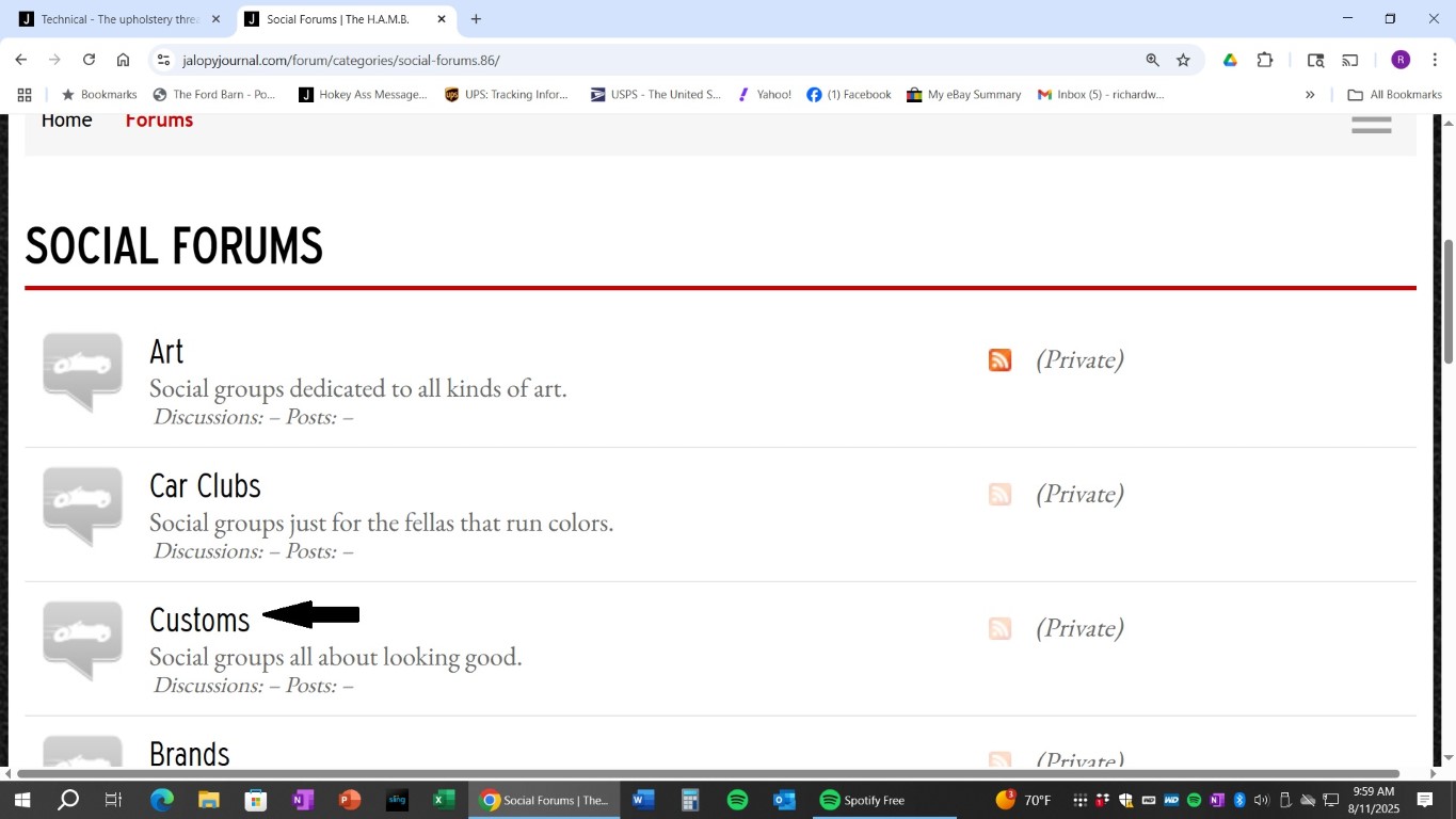

  22. RICH B
    Joined: Feb 7, 2007
    Posts: 6,014
    RICH B

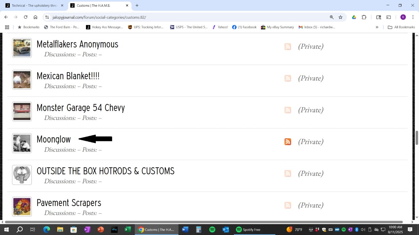

    Maybe try this; I just joined several with no problem (other than spending time reading a bunch of interesting posts).
    Here is a sample of how one join-up went.
    Go to Social Forums.
    Click on the main category; like "CUSTOMS"

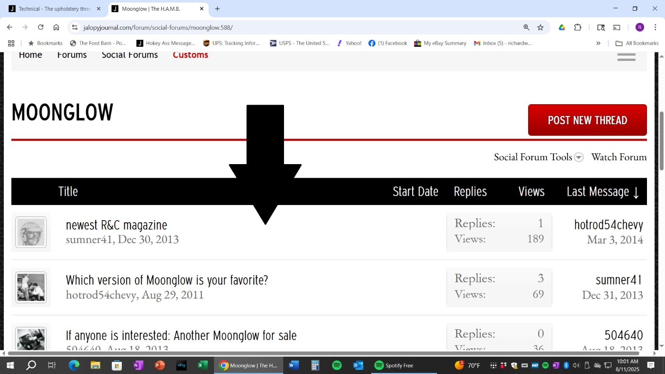

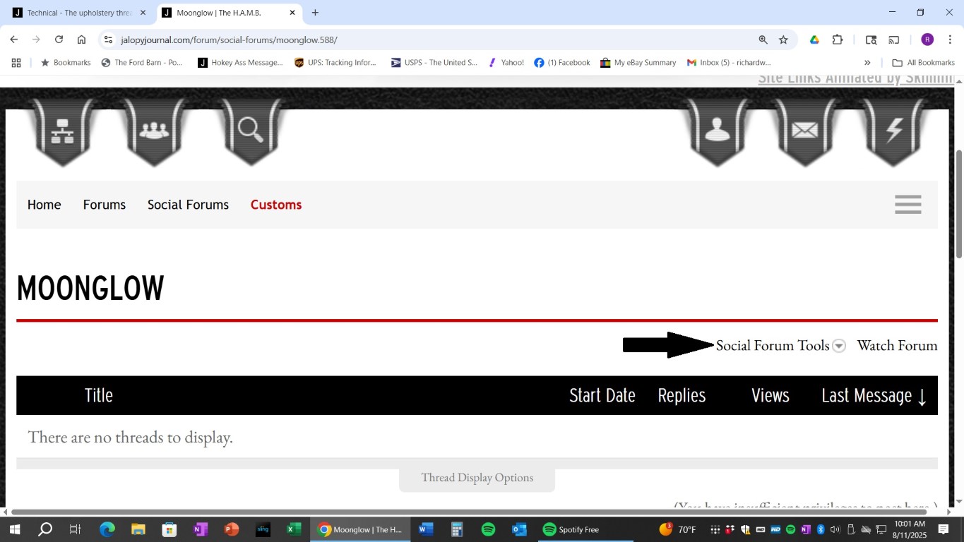

    Click on the group; like like "MOONGLOW"

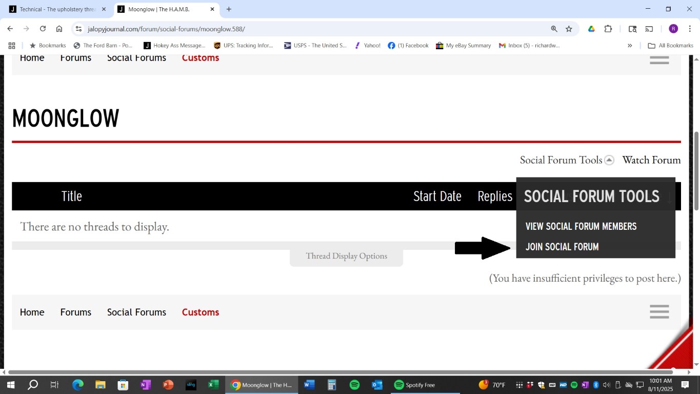

    Click on "social forum tools"
    Click on "join social forum"
    And you should end up in the posts.

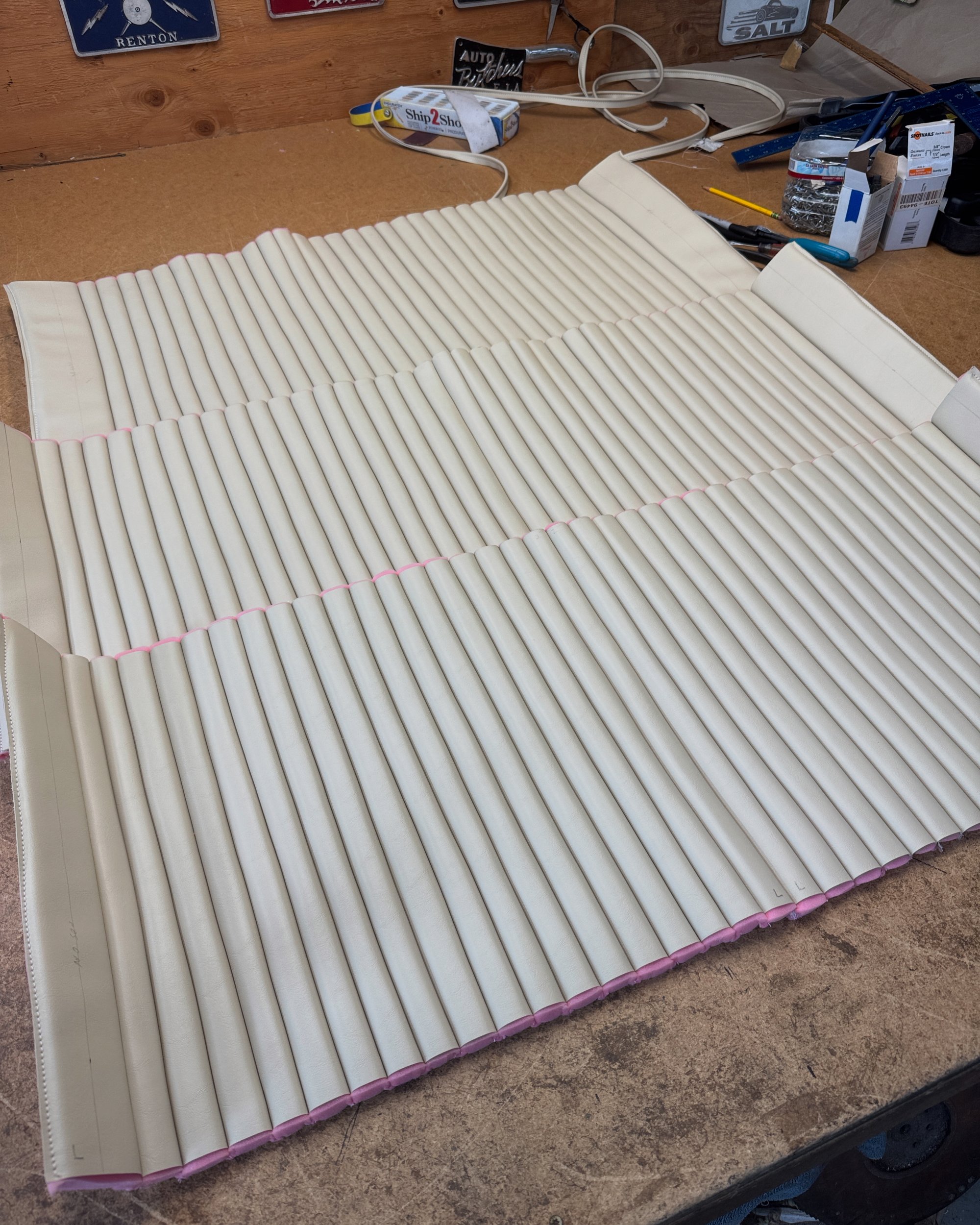

  27. There are a few ways to do tuck and roll. I am learning the stuffed style and pleated then fold and sow. Here are how different styles I am learning
    gassersteve and GuyW like this.

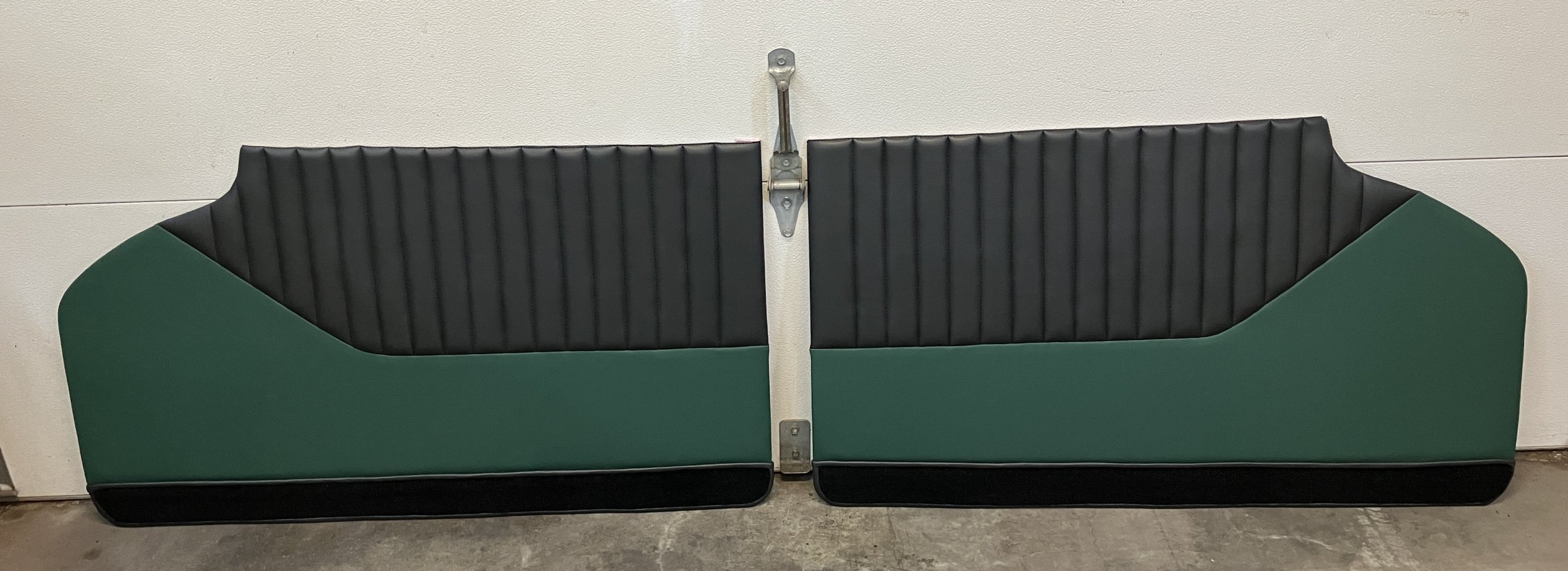

    Door panels I just finished for the ‘57 Ford Courier wagon I did the seats for a while back.
