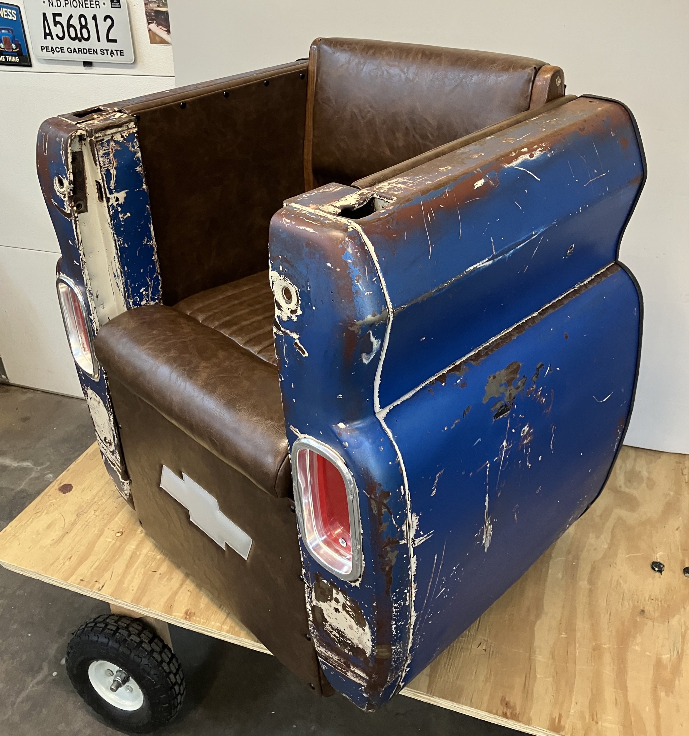

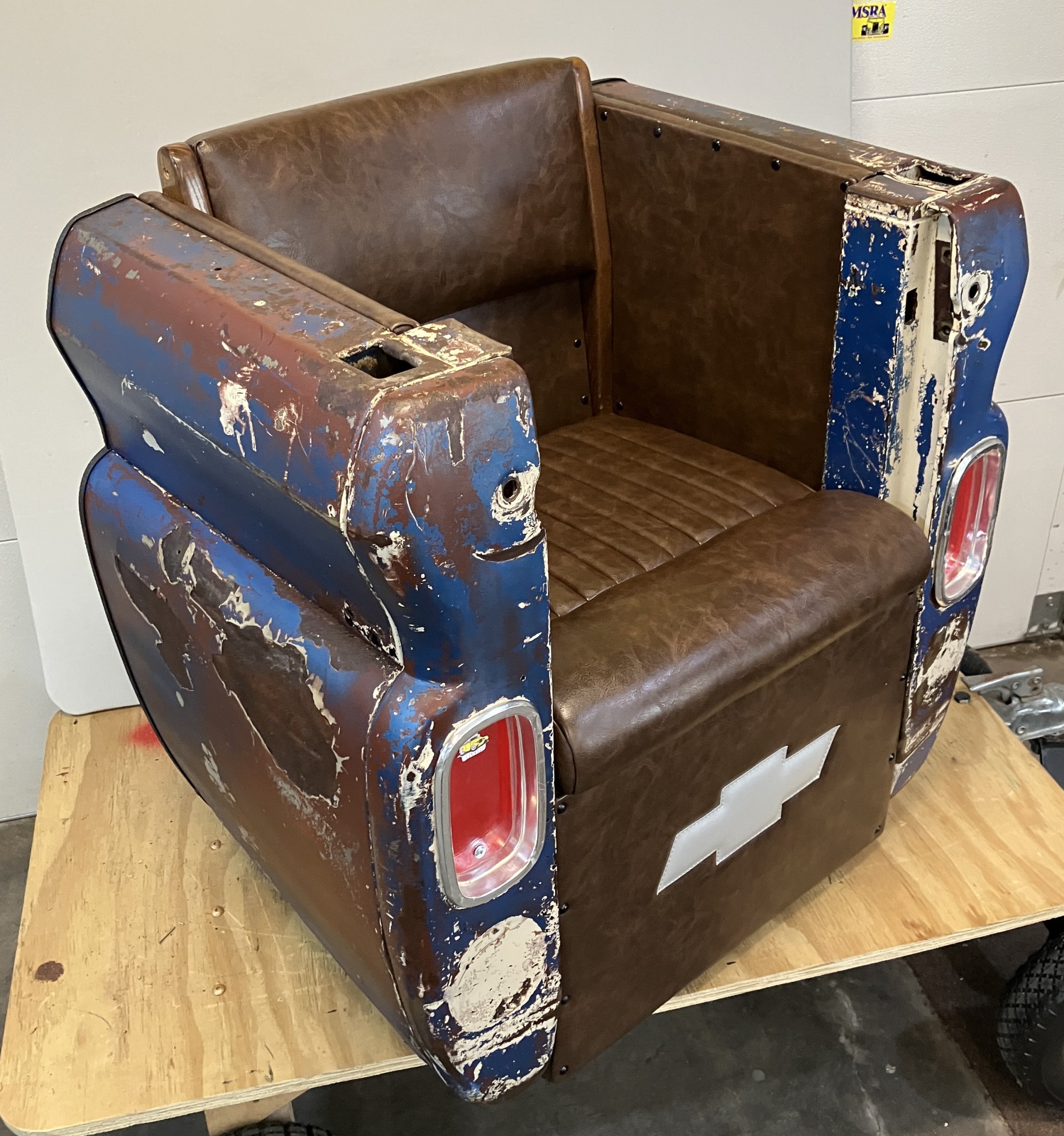

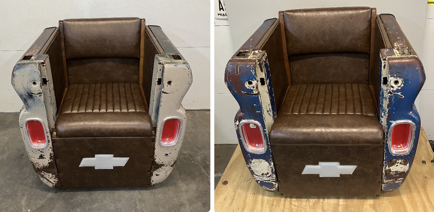

    Finished up another patina’d Chevvy box side chair. There’s now a pair out there…
