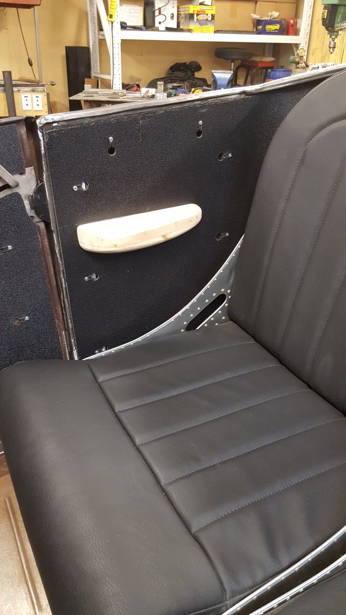

    I made all of the panels for the roadster out of abs. I was talking to a custom upholstery guy and he told me a horror story about ABS.
    He said that he did a roadster and during the drive over to the Hot Rod Garage about 45 minutes away, the sun started bowing the panels. The guys at the HRG called and asked him what in the world he had done. He had no idea what they were talking about. Ruined his interior. It ended up being a complete re-rag.
    He now uses a wood product, I can't remember the variety. I'll have to look at my notes.

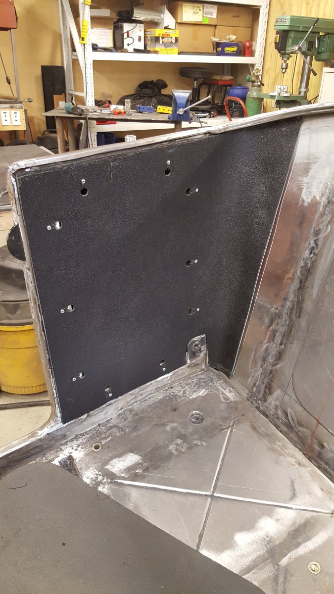

    Pressed and bonded Kraft paper with an unseen polyethylene sheet barrier.
    They go on to say how you can sew through it etc.
    Sewing through it will punch through the “barrier “ as will drilling into it for holes for clips or holes for armrests.
    Exposing the pressed paper to water infiltration.
    They also describe it as being up to the OEM specifications .
    After all the years I have spent in wrecking yards scouting and scouring for parts and seeing plenty of swollen water logged paper door panels all I can say is no thanks to that.
    I built my interior panels with 1/8” ABS for my RPU. Properly secured with push clips and I have no need or desire to sew through it.
    I’ll use glue to secure the upholstery.

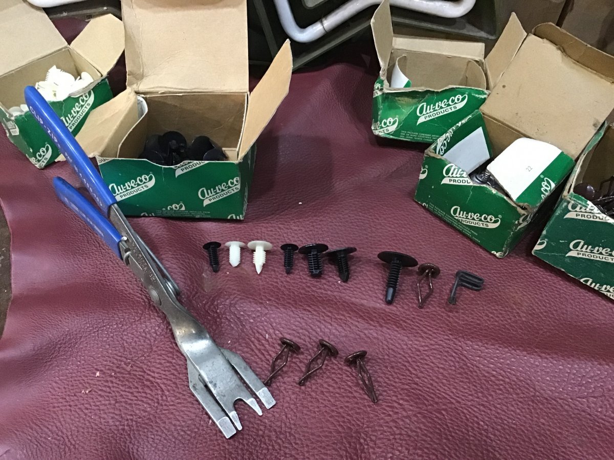

    @K13 what did he recommend for needles as his is a amazing trimmer and makes impossible tasks look easy.
    @-Brent- there are a number of fasteners I use or used and the ones I like are the metal spring clips and ****ons. I have used the Christmas tree plastic types and use them in certain places . The problem I found with them is the hole has to be dead-nuts on all of them or the teeth get distorted . It can be changed but if its imbedded into materials like foam or your upholstery not that easy. Plus you should use a panel clip tool to remove or separate the panel from the item. image.jpg

    These are the clips I’m using for my ABS panels
    The clips are Ford panel clips
    http://www.clipsandfasteners.com/Door_Trim_Panel_Fastener_Ford_p/a10780.htm
    You can see that they slip into the 1/8" ABS plastic panels through a 1/2" hole placed so that the pointed part lines up with the 17/64" holes for mounting the panel.
    You will notice that once I had the panel popped into place I marked the clips location and removed the panel.
    I then riveted them in place to the panel with short 1/8"pop rivets.
    That keeps them in place and make it a whole lot easier to line up the panel clips with the holes and then give the panel a smack with your hand at each clip to pop it into place.
    I'm going to s***ch up some vinyl the same material as my seats are done in and with the same 2" pleats.
    Probably a combo of some pleats and some smooth sections once I figure a pattern out.
    A thin layer of upholstery smoothing foam and then fold the vinyl over the panel edges and secure with a good upholstery glue like Dap weldwood high heat.

    3 different depths for different thicknesses you are going into. You will need a hole the size of a pencil to pop it into. If you must use a plastic clip, use the one`s in the bottom left corner. You can change them out if they get damaged, and they will. Scan0904.jpg
