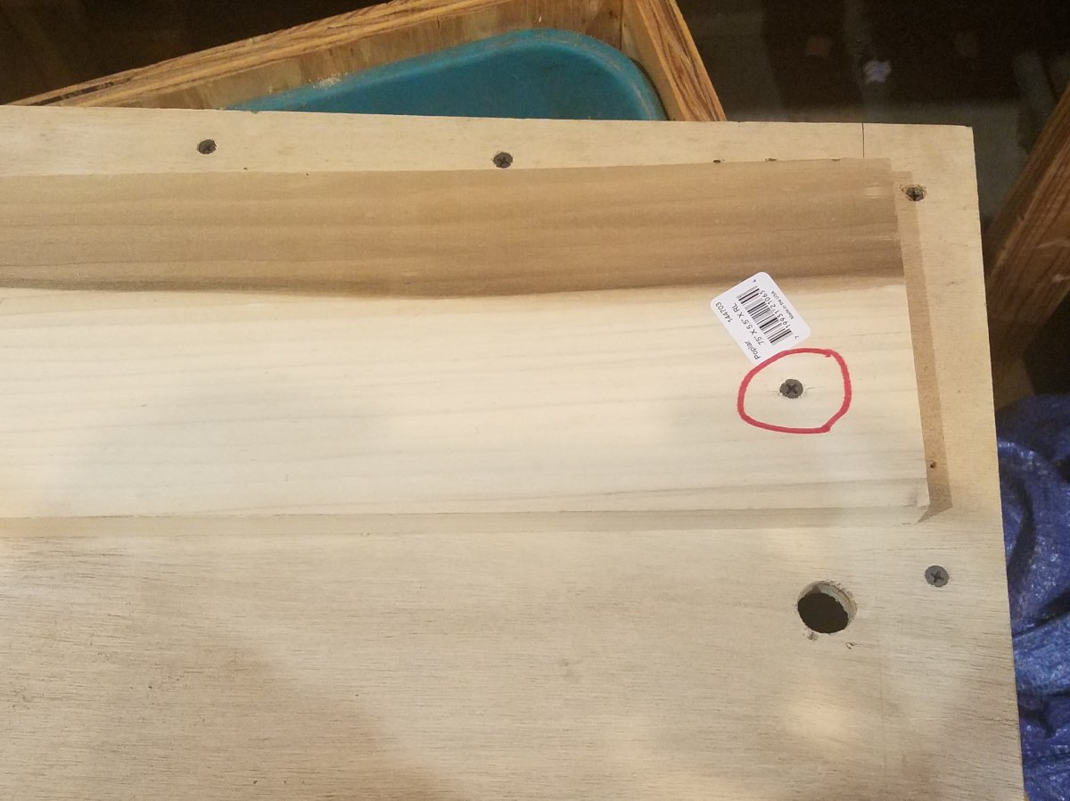

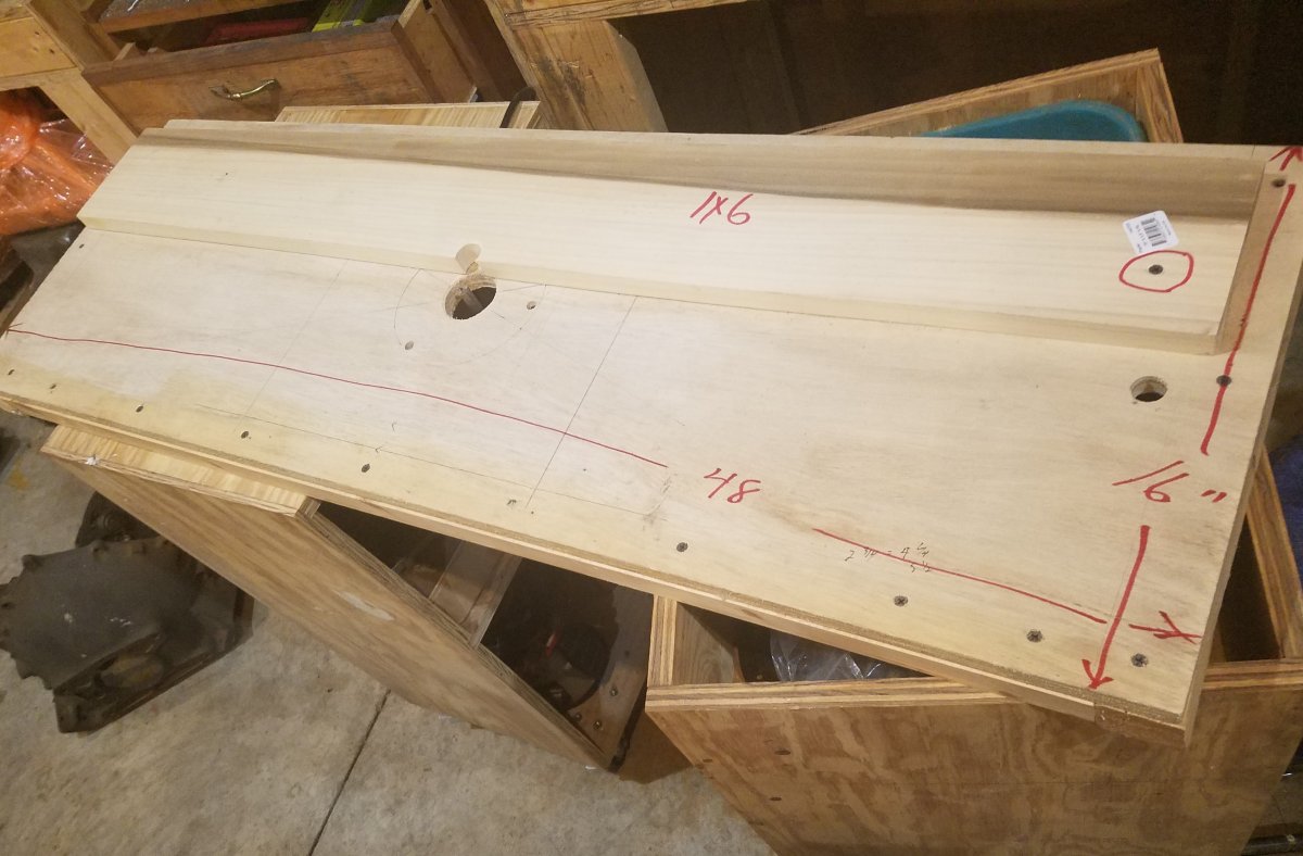

    Not trying to hijack the thread but here's an El Cheapo router table that you can build in less than an hour and works just as well as the high dollar factory types. 20210109_090608.jpg
    Drilled a hanger hole and hung it out of the way
    Used a piece of 3/4 plywood that was laying around. Your measurements can be whatever you want or need. 1x5 has a 1" hole to clear the router bit. Drilled a clearance hole for pivot screw which screws into table top. Layed out the router location using the screw holes in the router shoe. Used a 1 1/2" hole saw for hole in table top.

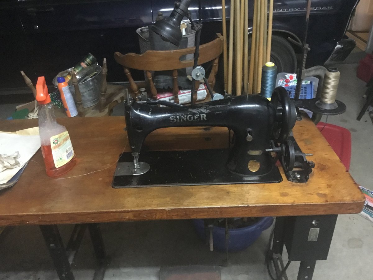

    I am no professional but have been sewing for 30 years .Now that makes me just a guy who can sew:D So @ekimneirbo a walking foot is number one if you plan on doing upholstery as for the speed control I am conflicted with that. I have two machines Pfaff and consew and they dont have the speed controllers . You will be surprised how much you wheel your machine by hand. You learn how to control your machine and can and do sew at a slower rate but kick *** when I need. Like making your welting you have to make a bunch and its pretty easy . The machine really does the work so I let it rip as fast as the machine can go and it’s FAST. When starting a s***ch you kinda do it with you hand wheel until your in position and go. The reverse is handy but can be accomplished by lifting your presser foot turning the materials a few hand s***ches and lift presser foot and start to sew. It’s more time consuming but most older machines dont have reverse.
    In fact I am looking to buy a singer 29 hand s***cher , so no motor just hand wheel ,no reverse and no fancy things besides gold leafing and scrolling but wicked cool from the 1910 era. I infact do hand s***ching on gun holsters, purses, wallets toolbags and stuff a sewing machine cant do unless its a cylinder machine( round base on the bottom where the bobbin goes).
    It’s kinda working in the garage or shop tools make you life easier but having a car lift is handy but not 100% necessary or air tools
    So my list would be walking foot machine with welting foot, hand full of bobbins ,basking tape, sharp shears , a few different size and kinds of needles point and knife. Good Thread like new 69 and 92 stuff and throw away what you got with the machine is key along with some contact cement spray like header bond or brush on in a ventilated area. I like a long neck stapler as @stanlow69 suggested and super handy and a must.

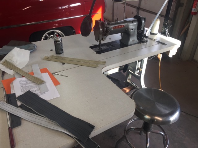

    Never had a long neck stapler but that`s fine. I have 6 others. A walking foot is like an air impact tool compared to a screwdriver as to a home machine. With a home machine you can sew a couple layers of material just fine. Add welt and foam backed vinyl, and it will not do the job. It can but you will struggle a bit.

    This machine is like a commercial version of a home machine. But from the 1950`s and before. It`s a bit better but you will struggle sewing multiple layers as it is not a true walking foot. It`s like 1950`s version of a walking foot. But it`s better than a home version. No reverse is on this machine. One with a reverse is about $450. With out, $250.
    loudbang and dana barlow like this.
  22. stanlow69
    Joined: Feb 21, 2010
    Posts: 7,346
    stanlow69
    We are getting a little better with this one. It is a true walking foot machine but has no reverse. Price range is about $650 plus.

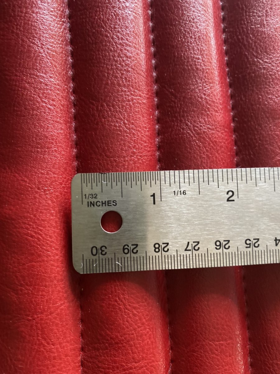

    The one thing you want in a machine is s***ch length. 4 s***ches per inch is a good thing. Take two good quality pieces of vinyl and sew them together. Measure your s***ch length. Now think when you add welt. Non pre made is another two layers of vinyl. That`s 4 layers. Your s***ch length just got shorter. Then if it has foam glued to it. the s***ch length just got shorter. It takes a bit more for the machine to pull it thru. How does the servo motor do when this happens?
    Look at the s***ch length, just think if the s***ches were closer. If it had more holes, just think of tearing off the paper along the dotted line. Also you need the depth between the needle and the machine head. When sewing pleats, you need to roll the material up as you sew more pleats. If the material is 50 inches wide with foam attatched to it, you would have to stuff 25 inches in the space between the head and the needle. That`s where a long arm comes in handy. They have 20 inchers and 30 inchers. But that`s more money. I do have a 20 incher that`s needs work, doesn`t have reverse. Came in handy when repairing a 30 foot tent with a hole in the middle. Was still a pain in the but. I also used it to sew up a tuck`n`roll headliner running front to back in my Dad`s 51 Ford Vicky.

    So what would be the common s***ch length for say 1/2” sew backing foam with 1” pleats? How do you know when you have the right amount of s***ches per inch? I’ve played around with this a bit and find to many just cuts into the vinyl. To little is like a loose nut on a bolt. Above seemed to be just right. When I went to take some of it apart it was really difficult. Which tells me it’s about the right amount. This is a bit advanced for a rookie but I found my self rolling half of the cover tight to feed thru the throat and was a bit of a challenge but went slow and it turned out nicely. I still would like to find a nice marking pencil or pen. I have a half a dozen so called fabric marking markers/pens that don’t mark? Any recommendations? Thanks for the input. David
