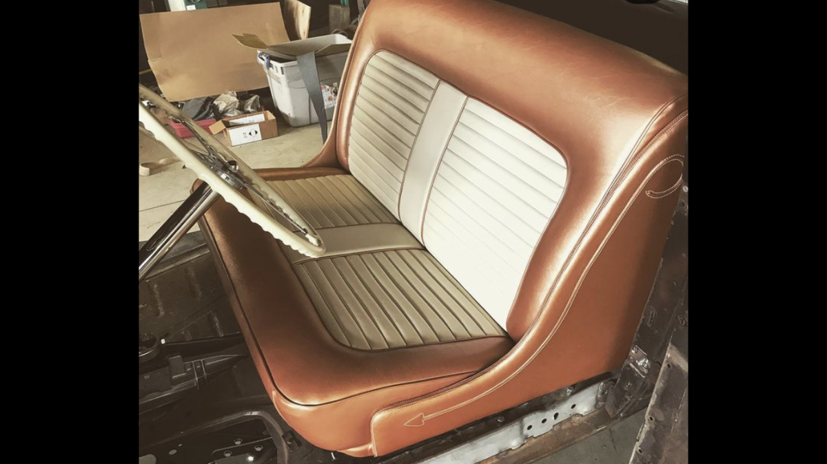

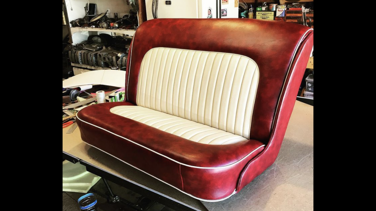

    Here’s my setup and a few seats I’ve done 8286D08A-0279-4EDD-BE1D-94857A647B0D.png 343E9C74-22E4-4CDE-9CBD-338B29FFAF7D.png 114A6BE6-C306-4286-B6E9-2569DD13395F.png 52F8E677-78EB-44EA-8EF9-000D9CB1FF18.png C09B668C-B797-414F-8B92-DC6355FFB4AD.png

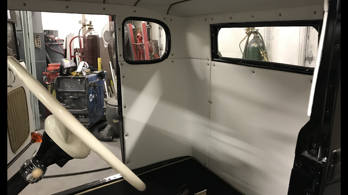

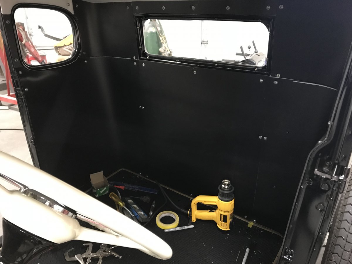

  10. 51box
    Joined: Aug 31, 2005
    Posts: 1,107
    51box
    from MA
    This is PVC foam board about 1/8” thick. I used it to make all the panels in my coupe. It was under $40 for a 4x8’ sheet. It can be stapled to or glued on and will form corners and shapes with some heat gun help pretty easily. It also flexes enough to manipulate panels into a tight spot after being upholstered. A0C653FF-9DEA-42A6-B1ED-E03C1D4E9975.jpeg
    Just Gary, Okie Pete, brEad and 10 others like this.

  13. Amazing work f head
    stanlow69 and loudbang like this.
  14. Roothawg
    Joined: Mar 14, 2001
    Posts: 25,962
    Roothawg
    @F-head, I really like the bench!
    dsiddons and loudbang like this.
  15. Yeah, that bench is killer!

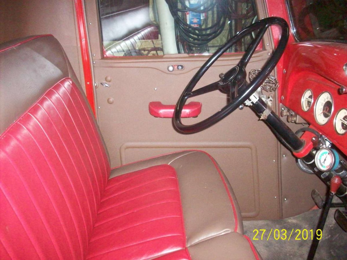

  18. junkyardjeff
    Joined: Jul 23, 2005
    Posts: 8,702
    junkyardjeff
    My latest which was last year on my 37 Chevy p/u 100_8762.JPG
