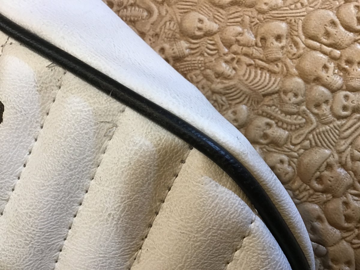

    A picture of foam cord 5/32 and solid cord in black for guys not knowing cording and just a few available. @stanlow69 that’s a great idea and thank you for the tip. It’s tips like that from Professionals like yourself that really make the difference. I haven’t used a bunch of the solid welting but have a roll of black and tried your tip. Wow it works awesome and super tight seam even on this practice piece. I owe you a Pop for the great tip my friend.. ACEF5E2C-788F-4065-B5D9-1A186942D856.jpeg 6D724B5C-9642-4CCE-AB22-751761F15C74.jpeg

    I'm sure it comes in limited colors i.e. primary colors etc. I would think you would almost have to make your own on something that was an odd color.

    @Roothawg they sell a few popular colors but haven’t found a source that has a ton and thats the reason I have been doing my own. Especially leather welting and with hides you dont want to waste a bunch on welting and have to really plan a hide.

    There are over 30 colors of pre made welt. You should be able to find a color close enough. Using an ink pen(not Space Pen)will bleed through even when it`s not hot outside. It`s the dye that bleeds thru. Red foam glue will do the same thing. Lighter colored vinyls are more prone to bleed thru. Knew a guy who had to redo 4 boat interiors. Never heard of a Space Pen before. Or a Servo motor for a sewing machine before the HAMB. I`m an grump stuck in my old ways. Never use plastic for door panels unless the customer requests it.
