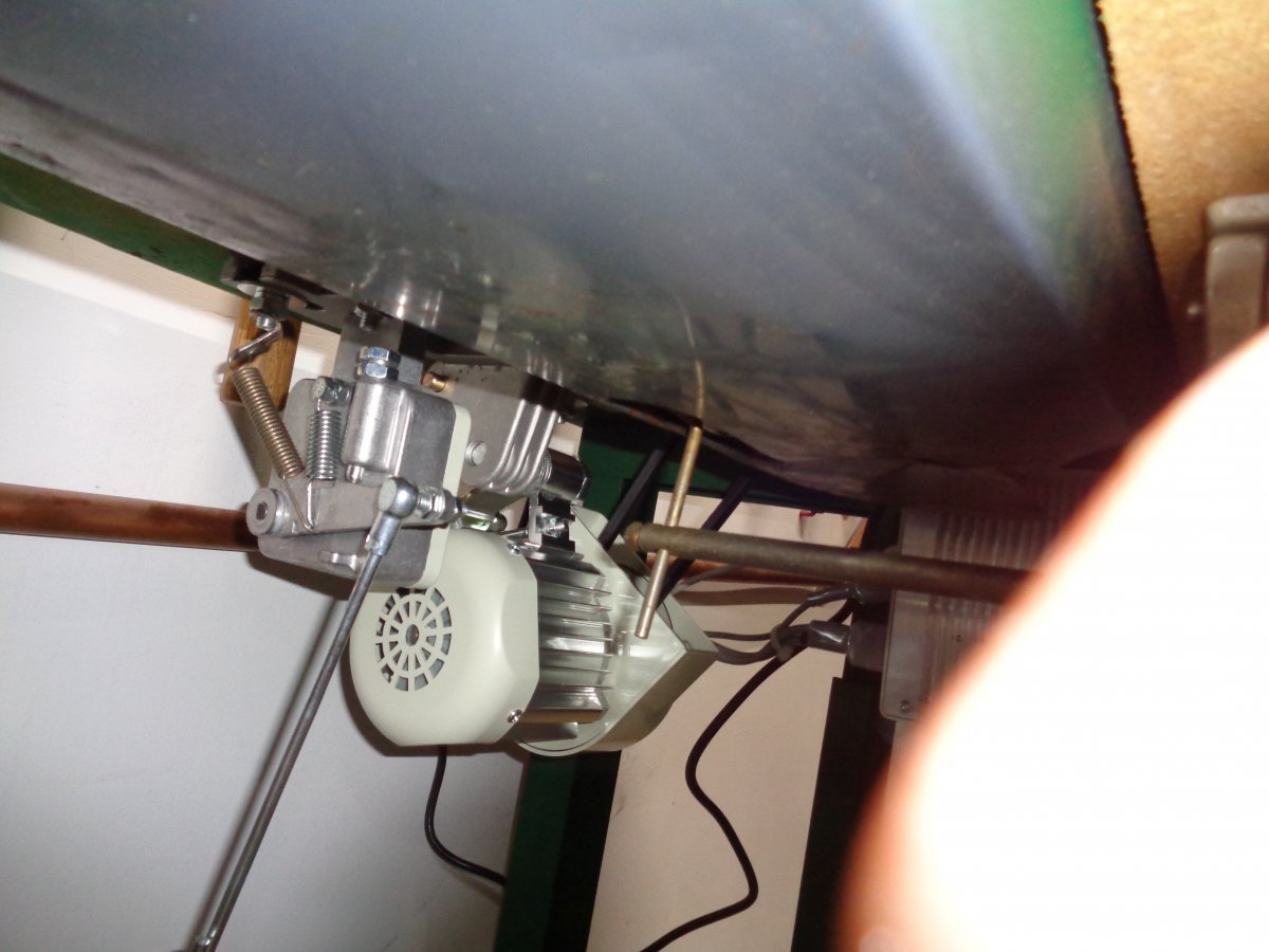

    I bought an industrial Juki LU-563 machine that was in great condition but changed out the clutch motor for a 1HP brushless, servo motor and also installed a 45mm pulley to slow it down considerably. I can now sew a single s***ch at a time or thousands per minute. It has excellent speed control now which is very important for the less experienced like me. It is a very heavy duty unison walking foot machine with reverse that is very easy to maintain and adjust as well. The next thing I need to do is get a good swivel, rolling stool with a small back for better maneuverability and comfort.

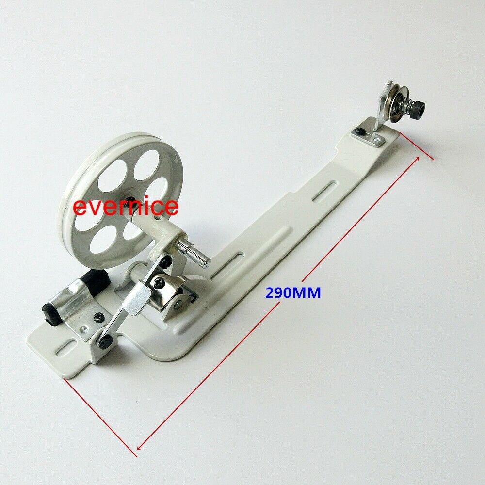

    i understand the peg, i know the threadstand, but where's the bobbin winder?
  19. A 2 B
    Joined: Dec 2, 2015
    Posts: 571
    A 2 B
    from SW Ontario
    When the bobbin is full the mechanism trips disengaging the drive wheel from the belt. s-l1600 (1).jpg
    Used for for pre-loading bobbins ahead of time so you have one ready to go when the one in use becomes empty. It winds as you sew until full.

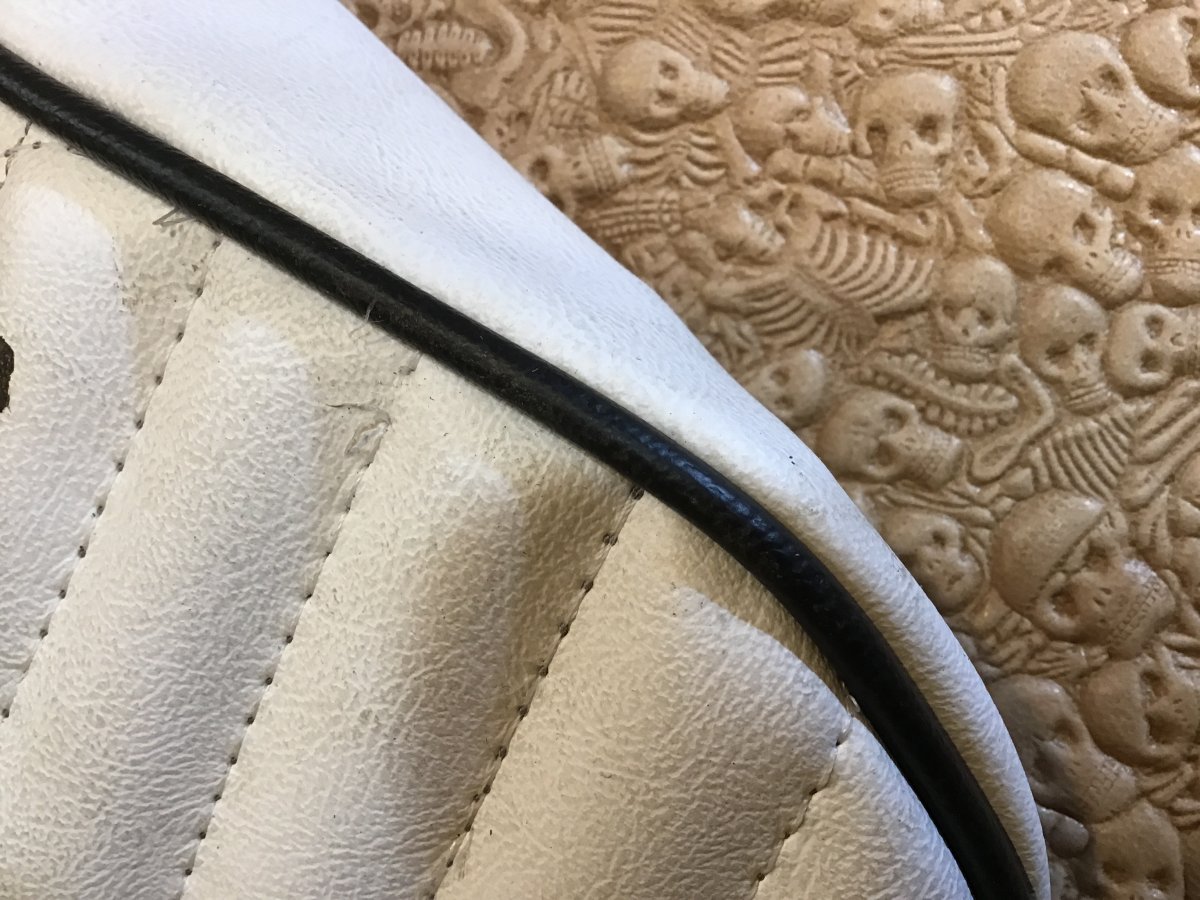

    Not to pic on you, but your tension is off a bit. You can see you bobbin thread lying on top. It is black. You want your knot right in the middle. I always use the same color of bobbin as the top thread. I never wind a bobbin when I sew. Pull your bobbin casing out of the machine when winding a new one. And pull your thread out of the take up lever too. When changing thread in your machine, just tie the two together and pull it thru. No need to thread the whole thing. Except thru the needle.

    I didn’t notice. But this is the kinda criticism we need. I looked at some of my practice stuff and have the same out come.

    You can only learn so much by watching U tube. Sometimes, it`s hard to get good even tension on a pre wound bobbin. It seems to vary a bit. Do you have a separate disc in your bobbin casing.
