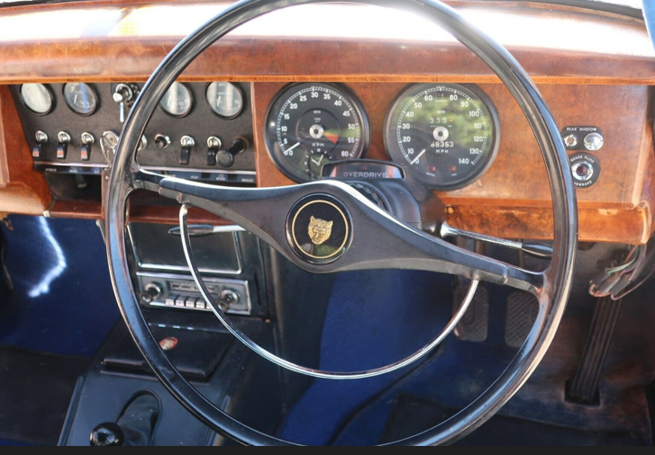

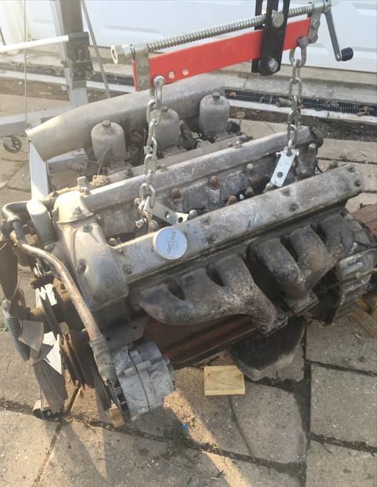

    Since Ryan has decided to recognize traditional customs and hot rods based on foreign car platforms (see his blog post), I'd like to be the first one to test his patience. :D
    Introducing the Upper Krust ('cuz UK, get it?) my full custom Jaguar Mk2. About 10 years ago, JamesD posted a Photoshopped version of this car and I haven't been able to get it out of my head, so here we are. The plan is to convert it to a 2 door and give it a mild chop. Why mild? Because that matches JamesD's rendering, and I'm 6'5" and would like to be able to drive it comfortably! It's a "big" British car, but really is closer to a Corvair in size.
    Before you say "foreign cars aren't traditional", there are a lot of good examples to the contrary, not to mention all the things that happened in the HAMB era overseas. Feel free to debate a****st yourselves in another thread.

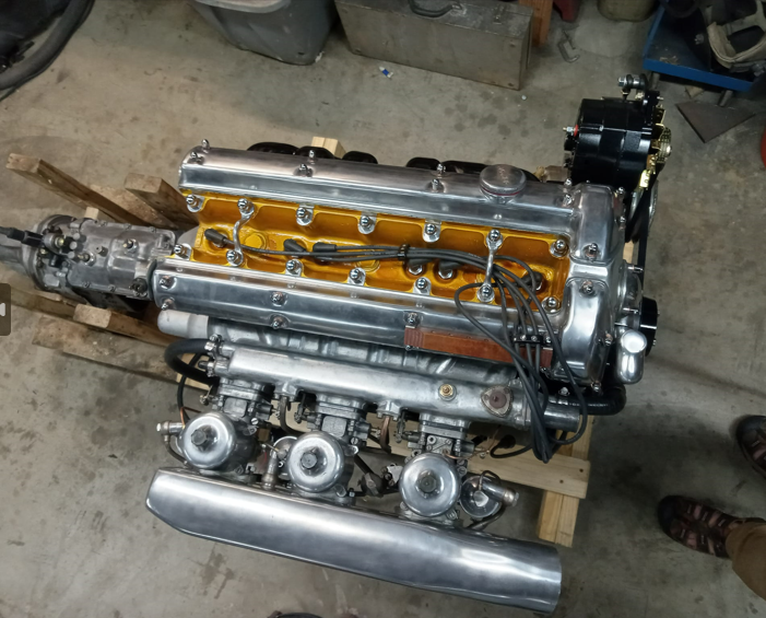

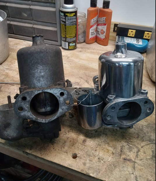

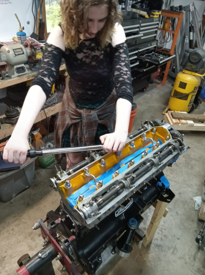

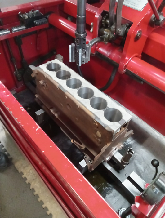

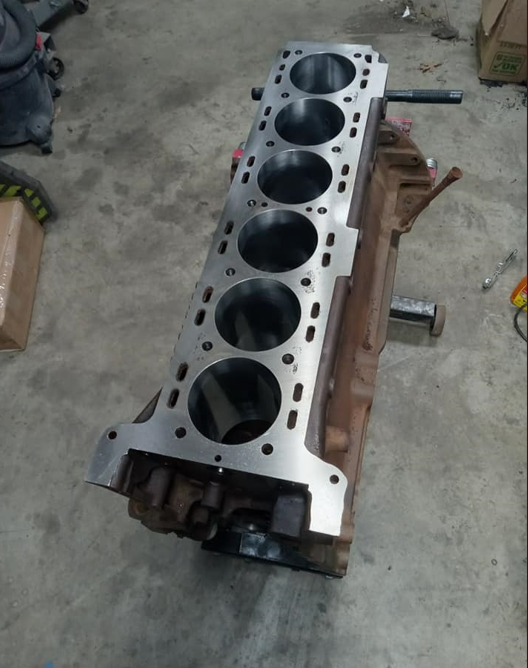

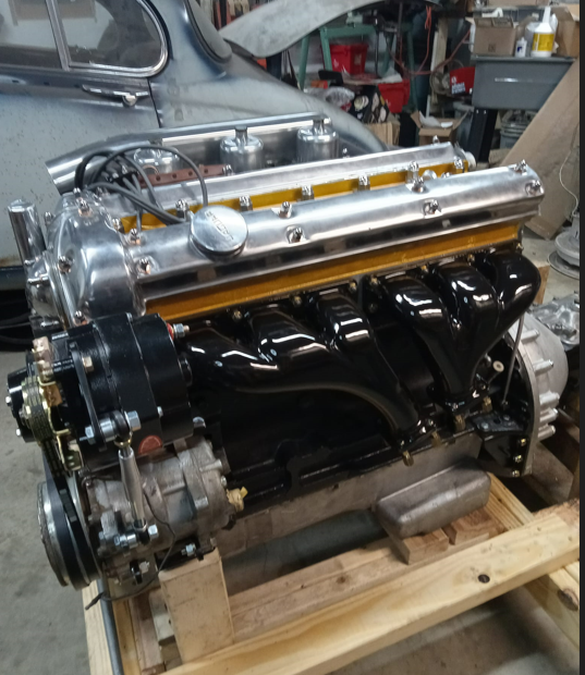

    My kid and I drove from VA to FL to pick up a complete 1965 Jaguar MkX 4.2 L (about 256 CI) engine with triple SU HD8 carbs. 9:1 compression. It turned out to be junk, but the intake manifold and carbs alone are worth what I paid for the engine and drive, plus it was a fun trip with the kid. So, I found another one. We rebuilt it with a slight overbore and re***embled it ourselves, added a 4-speed manual with overdrive. Due to a mix match of parts, I had to make a few parts, including a A/C-Alternator bracket. The engine+trans are about 6' long.

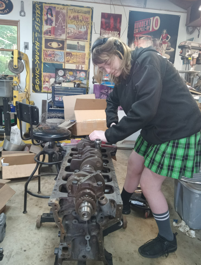

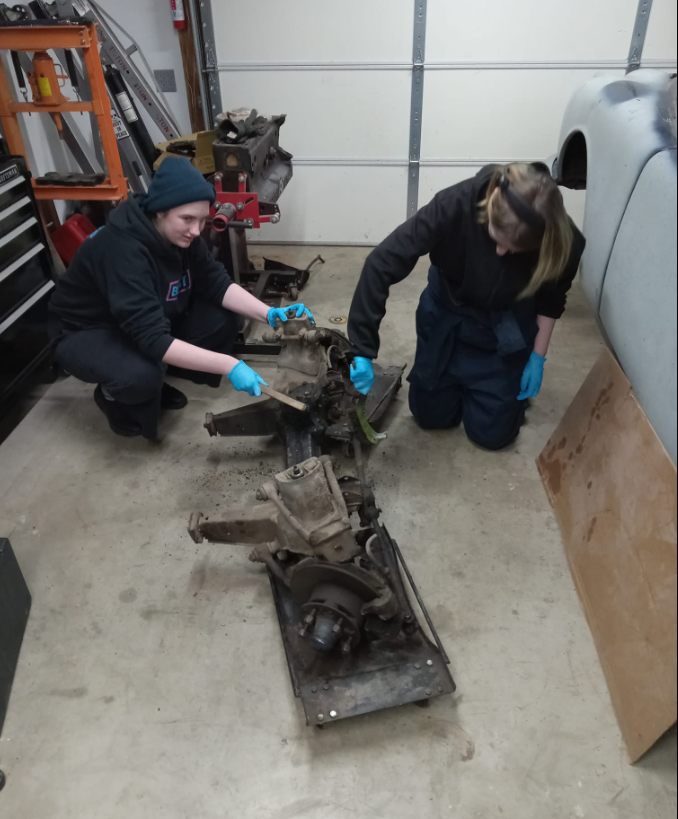

    My kids helped strip down and re***emble the front suspension and engine, and they helped polish miles of aluminum... but didn't always wear garage-appropriate clothes. One of them starts autobody cl***es in high school next year.

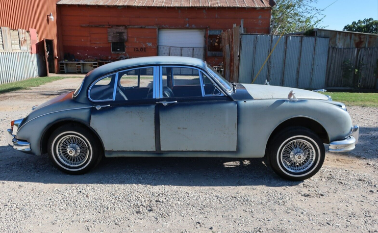

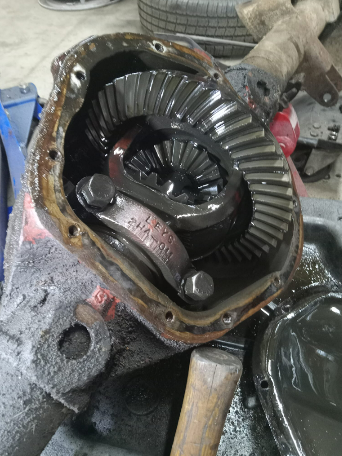

    The car has 60,000 original miles on it. A USAF service member stationed in Italy bought it and shipped it to TX in 1980... where it sat until I bought it. He had apparently pulled the puny 3.4L engine and dis***embled it. I left that in TX because I have a 4.2. No rust. It looks like it was smacked in the front. Someone beat out the metal and covered it with filler, but did a decent job. I need to strip all of that off.
    The front suspension now has lowered springs. Koppy lowered the rear (attempts were made to bag it, but it couldn't be done). The rear axle is notoriously difficult to pull apart, so I have a local shop working on it. I need to finish up the rear suspension, then it's on to body work...

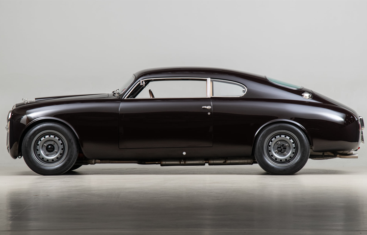

    Some inspiration from the 1956 Lancia Aurelia 520GT. My idea really is to make this a GT car... fast, but comfortable, and a custom... American combined with European styling and ingenuity.

    Actually, even stuffing in a 4.2 with triple carbs in place of the 3.8 with 2 carbs causes a lot of groaning. It requires cutting the inner fender, so a not-so-easily-reversible modification. Groaning in snootiness.
    The first thing I'm doing is getting rid of everything Lucas.
