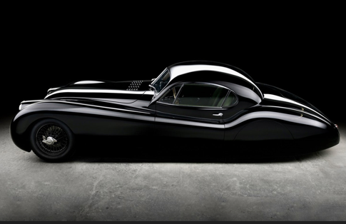

    That's Fluevog's MkX. This is Justin Hill's 1953 xk120 custom with a v12 upload_2024-5-20_12-22-15.png

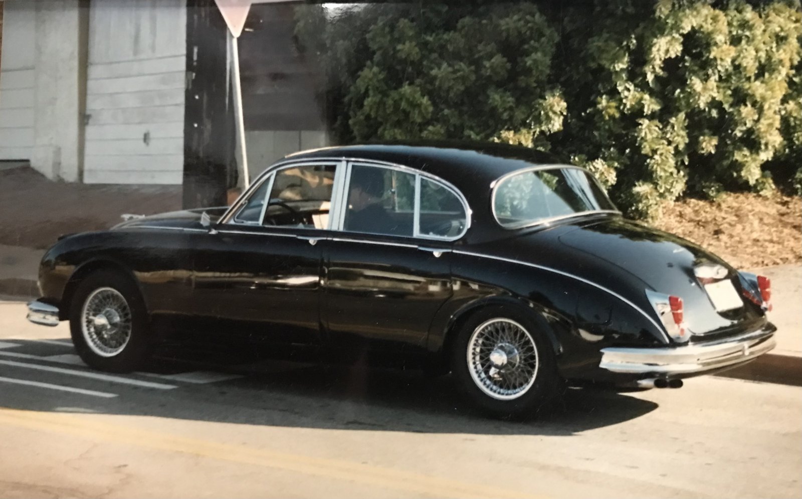

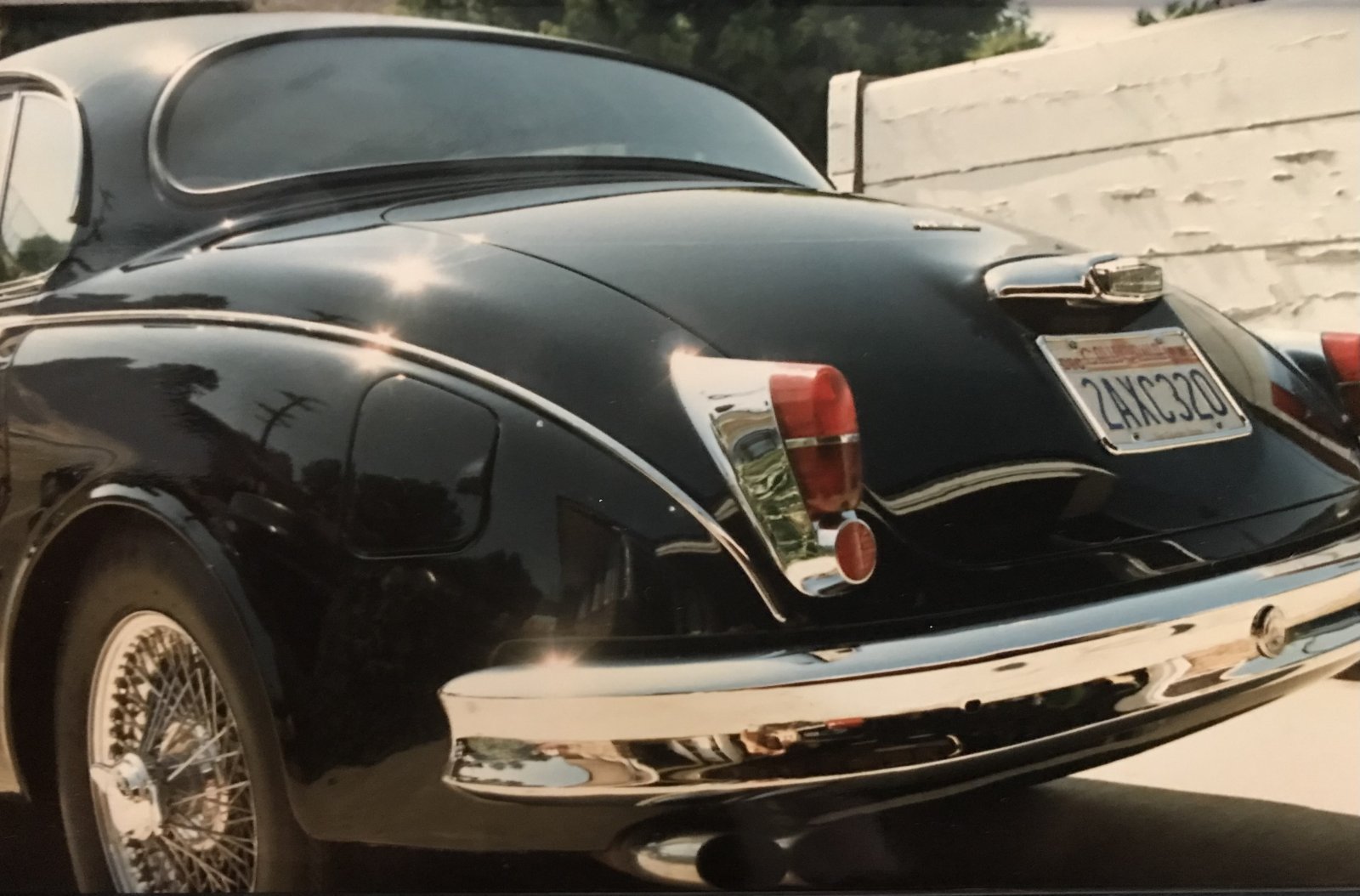

    I mildly customized my Mk II. I looked at it from the driver’s side one day and thought it just had too many things breaking up the sensuous curves, 4 doors, a gas door and the skirts, each it’s own gaps.
    So I used wheel opening flares from the front fenders of a donor Mk II to create new wheel openings just large enough to allow for changing the tires and then welded and molded the skirts on.
    It cleaned up the side nicely. Then I did a driveway black lacquer paint job.
    I sure like like what you’re doing with yours.

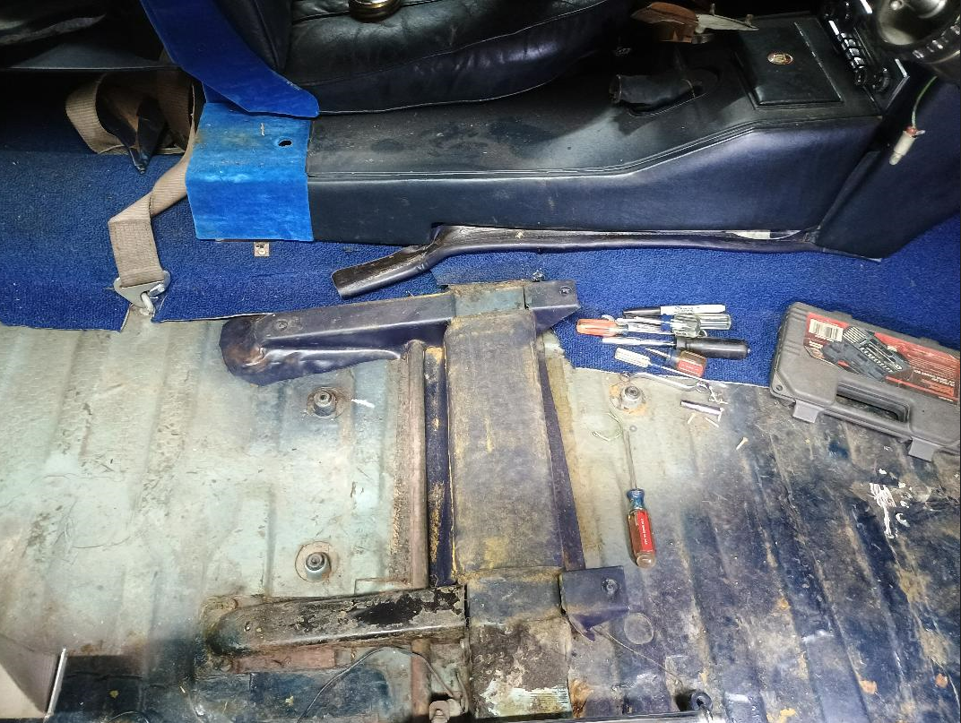

    I got the replacement outer rocker and fender patches in, so I started stripping the interior. When's the last time you saw an old car without rust in the floors (and only a small handful of mouse poop)?? There may be a small patch under the driver's feet, but otherwise it looks good.
