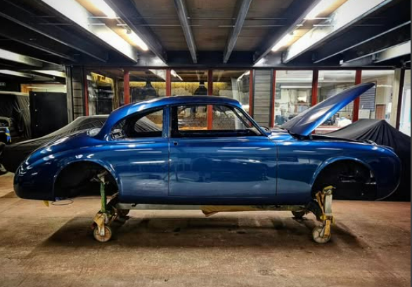

    This looks like the most recent update on her FB page

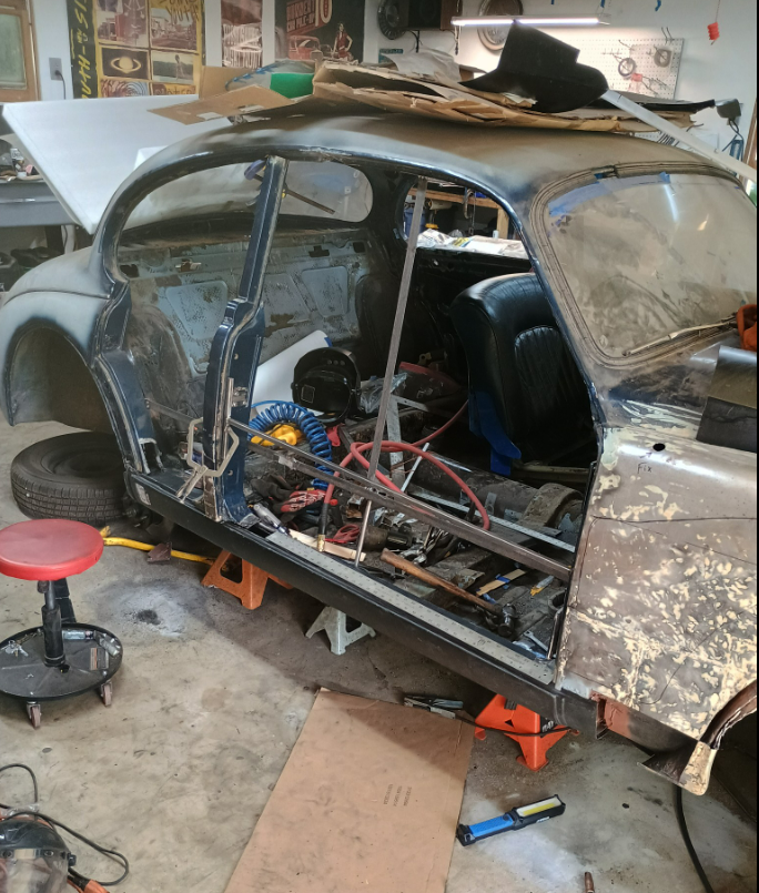

    All set to replace the rocker and part of the front fender this weekend. upload_2025-2-19_12-36-34.png
    and the reason for the surgery. Next will be the 2-door conversion part of the build. upload_2025-2-19_12-37-31.png

    Yikes...that is some nice metal work there. :eek: Good candidate for the 2 door conversion! :cool:

    I have a set of slightly rusty doors. The originals are surprisingly rust-free. I'm guessing this botched up job was an attempt at rust repair in the fenders and rockers. The other side isn't quite as bad. Only that fender was bad. The Bondo sculpting was impressive though.

    I got (most of) the rocker out and found some creative repairs, but it worked. I need to fabricate new support brackets for the A and B pillars, do some careful modification to the new rocker and weld it in. Then I can move on to the fender, or move the B pillar, or both.
    Under the A-pillar
    The rest

    Somebody spent a lot of time on those previous repairs. Maybe not the cleanest work, but not the worst I've seen by any stretch. I could live with that, at least on the inners.

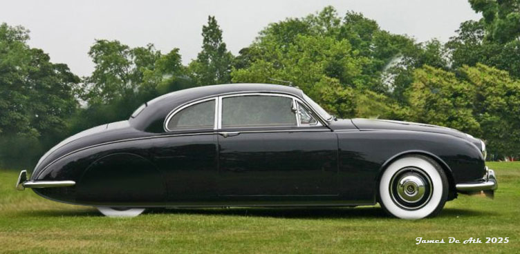

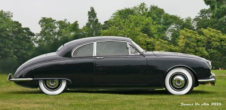

    I'd forgotten about Marcy's Jag. I was following along when new pictures popped up. Amazing build. Billet "spoke" wheels. Easy to overlook how they extended the bonnet so there's no cowl between the it and the totally reshaped door now. 75456829_2785699011453671_8010965325392642048_n.jpg 116203401_3436737899683109_960009364570455360_n.jpg
    The fastback short wheelbase version really wouldn't need an XKE donor. Just a hatch. I did a couple of rear views just to see. The angle makes it look a bit stubby. I don't think it would look so much like a Porsche 356 in real life.

    Slight amend to the rear valance. Left the exhaust off to show it better. Lifted the bumper slightly too. Just a thought. upload_2024-5-7_12-47-18.jpg

    It back-dates the car a bit, but it really flows. I'm not sure about the bumpers at different heights though. I've been debating making a full skirt or creating an opening like in the red fastback version, a little like the Mk2 S-type rear wheel. I definitely do not like the Coombs style or stock skirts. They make the wheel look small.

    The bumpers are already at a different height to each other originally. I only bumped it up a shade more. an inch or so.
    I covered the back wheels originally to hide the fact that they're so oddly far back on the car. It's why I shortened the wheelbase on the fast back, as it was the only way I could make it work. It would be horrific to do though!

    Oooh, I'm digging that!

    Hey James, any idea how much you lengthened the doors on that image? It's looking like 8-10" to me.
    porkshop likes this.
  21. James D

    This one has a slight rear chop, but unchanged front. I don't know how far they extended the door.

    That looks incredible. I honestly wouldn't have even known what it was if I saw that picture without context.
