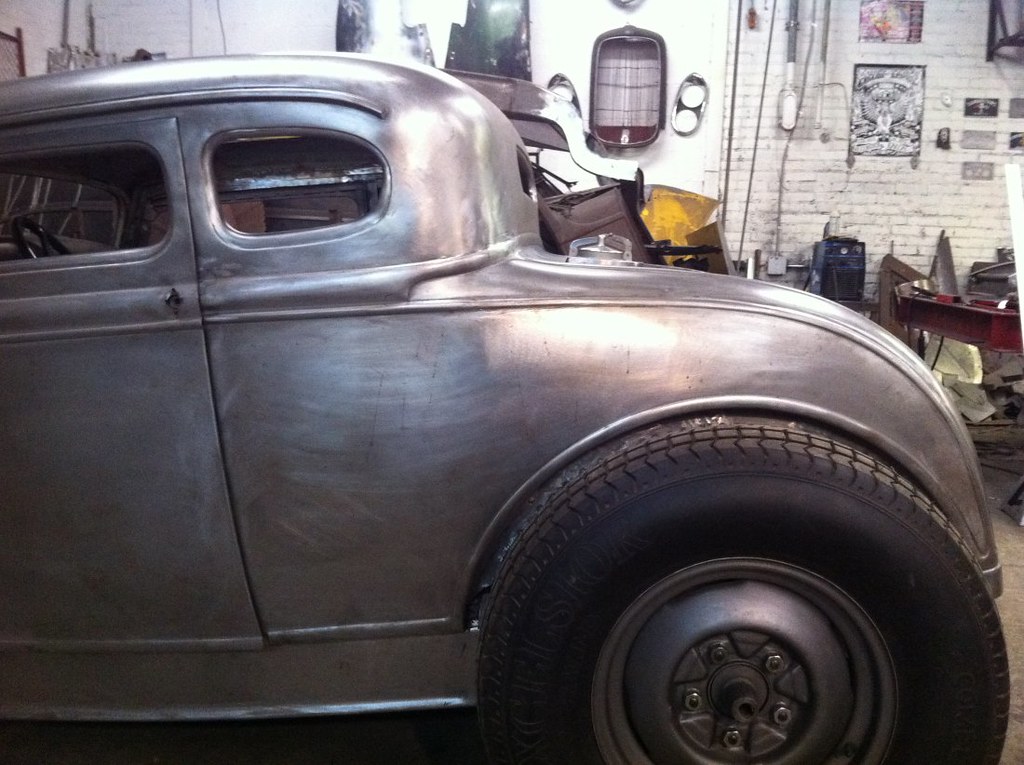

    Fabulous. I'm digging the '34 (?) windshield treatment on the model A body. It's different.

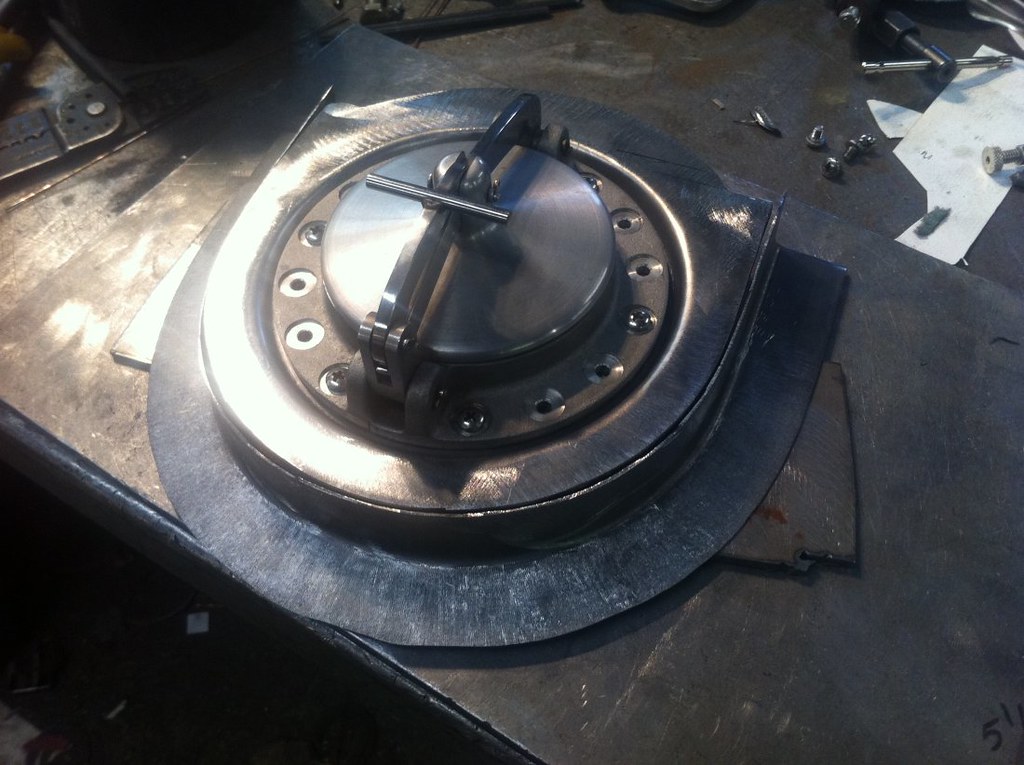

    Ya know, I look at B***' creations and want to go throw rocks at my stuff! He has more work and skill in that filler cap than I do a whole friggin' car!!! I'm not jealous, just REALLY admire the work that some CRAFTSMEN are capable of!
    He can build a whole car in the time it would take to me build that damn filler!

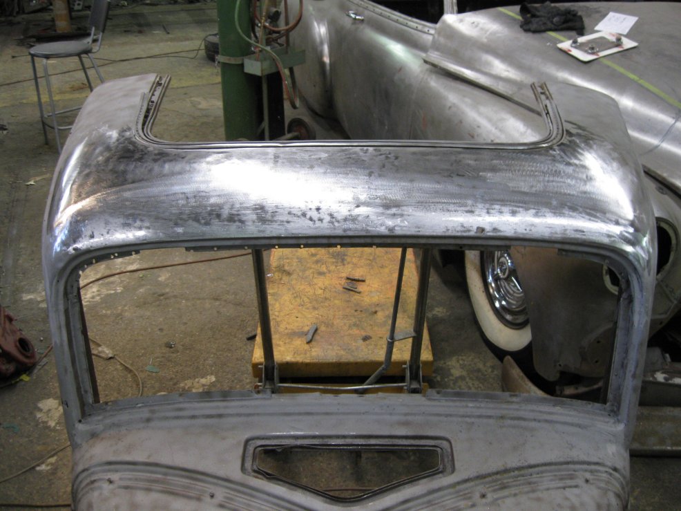

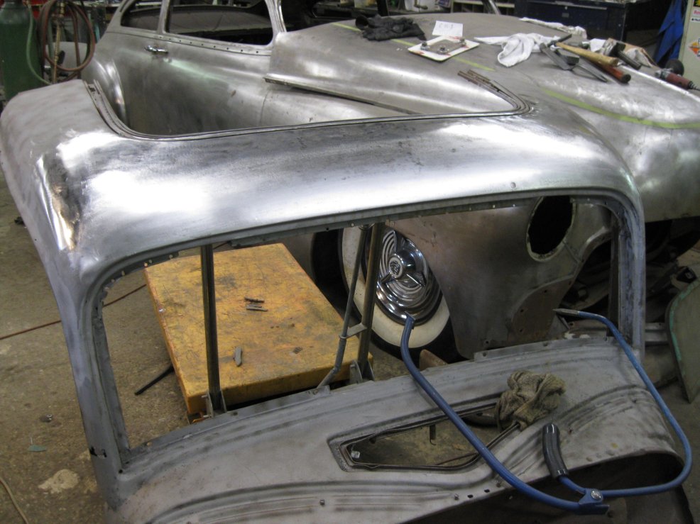

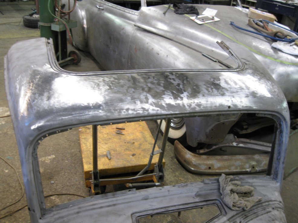

    Hope you don't mind a question but, when you worked these area's with the low crown hammer and high crown dolly, did you do hammer on dolly or off dolly or? I have a area like this on my roof and am not sure how to tackle it.

    It really depends on the area, but typically you hammer off dolly to bring down a high spot, and you can hammer on dolly to bring up a low spot. You have to be careful hammering on dolly, because it is possible to stretch the area if you overdo it. This is where shrinking comes in.
    Most of the time when you have a panel that's damaged this badly, it's going to be stretched a bit already, and straightening the metal is going to stretch it even more. I use a shrinking disc to shrink back high spots after roughing in the shape, and planish on and off dolly from there.

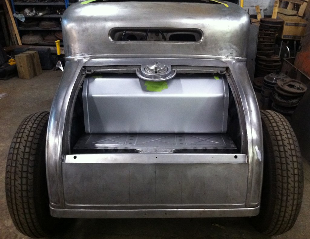

    First off, awesome work, as always. Second, what's going under, or is under, the tunnel at the rear of the trunk floor? Support structure for a push bar, perhaps? Or parachute mount for racing the salt flats? I'm sure time will tell, but I'm curious as it's behind-ish the rear crossmember.

    Good god... That fuel fill is awesome.
