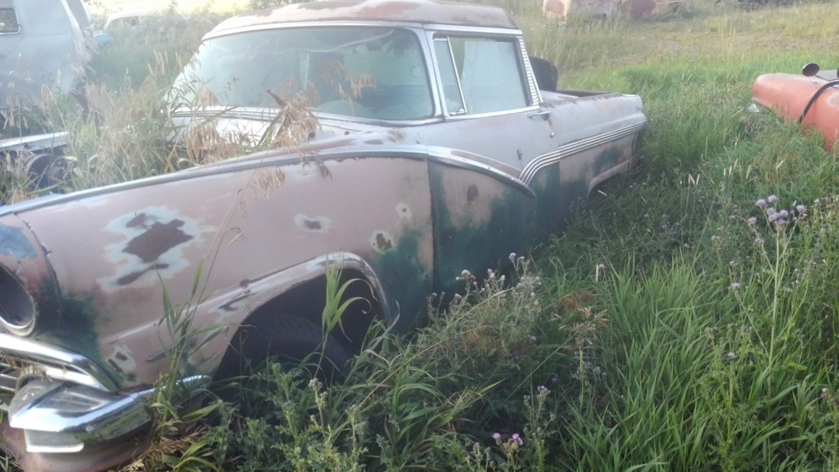

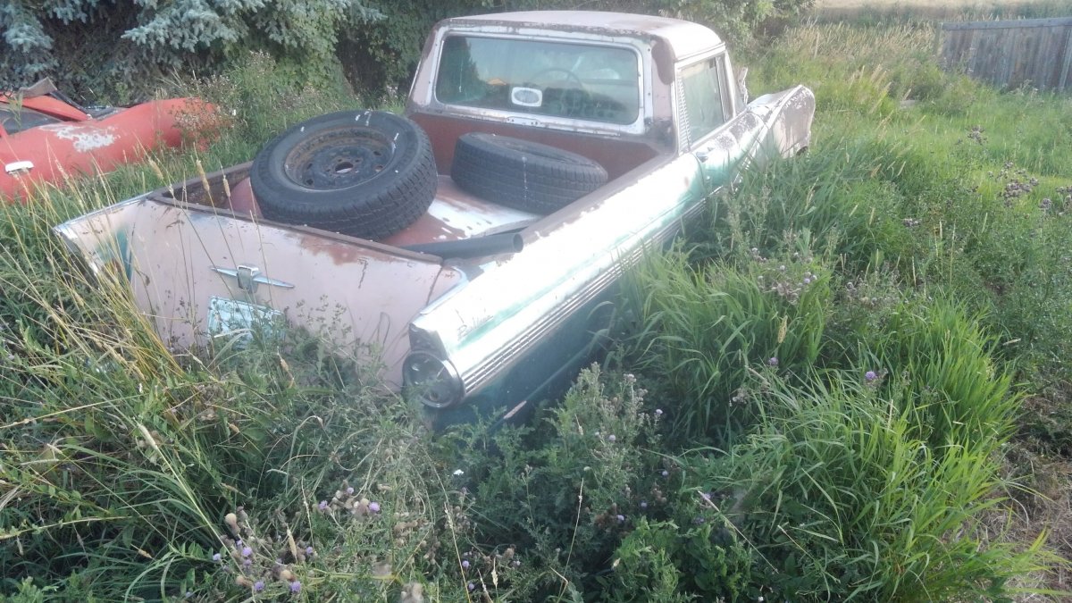

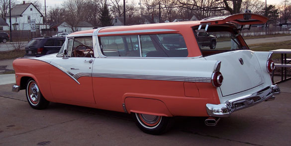

    55ford58597-2.jpg Have you done more than one of these? Because I saw one like it for sale about a month ago somewhere but as I recall it was 2 tone white and orange?
    edit:
    I found it: Cars on line..
    But your black one looks better, smoother flow and more finished looking.

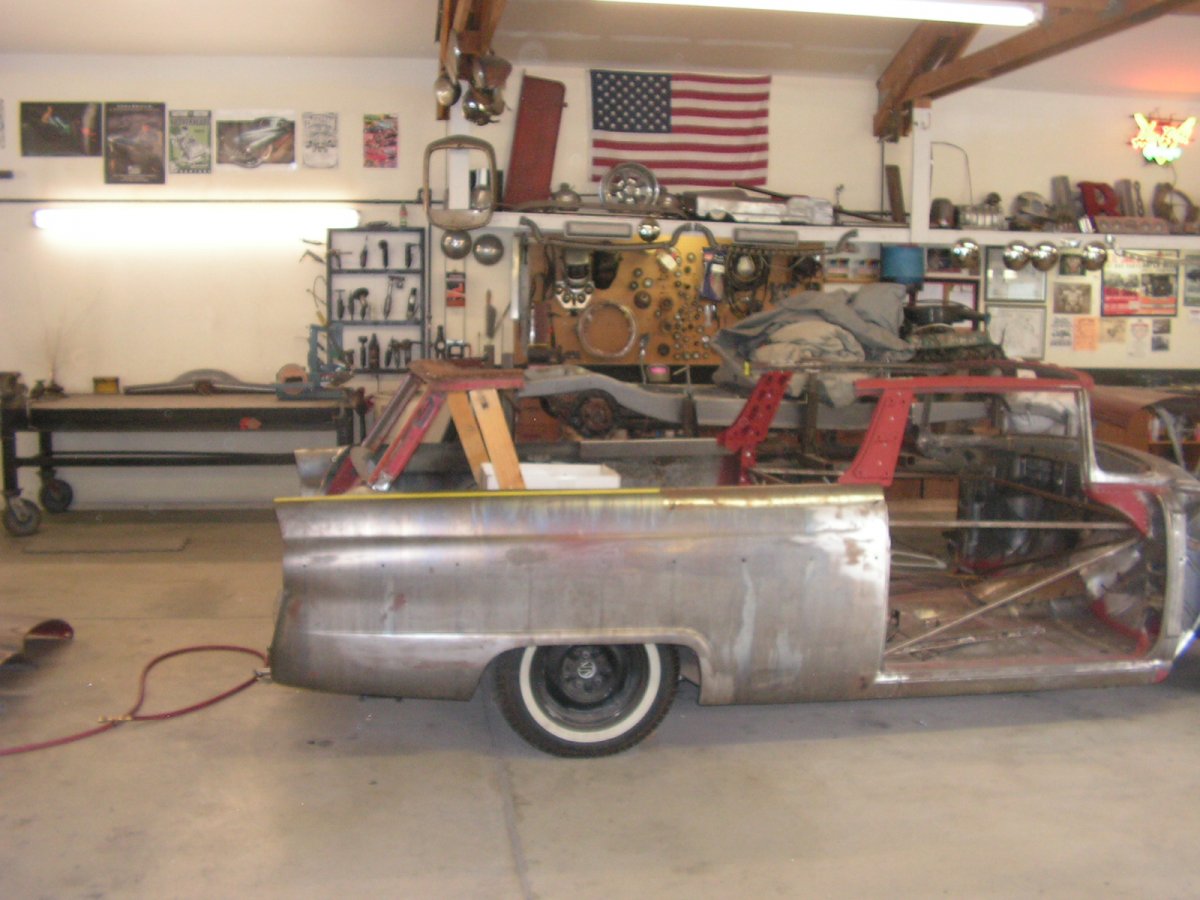

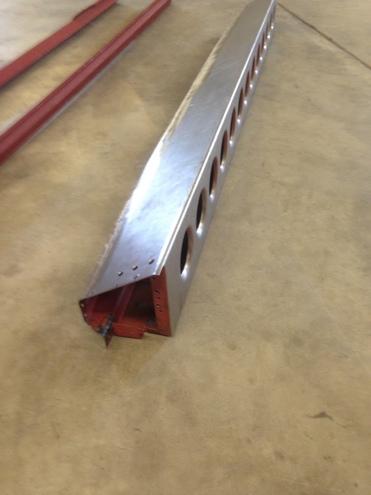

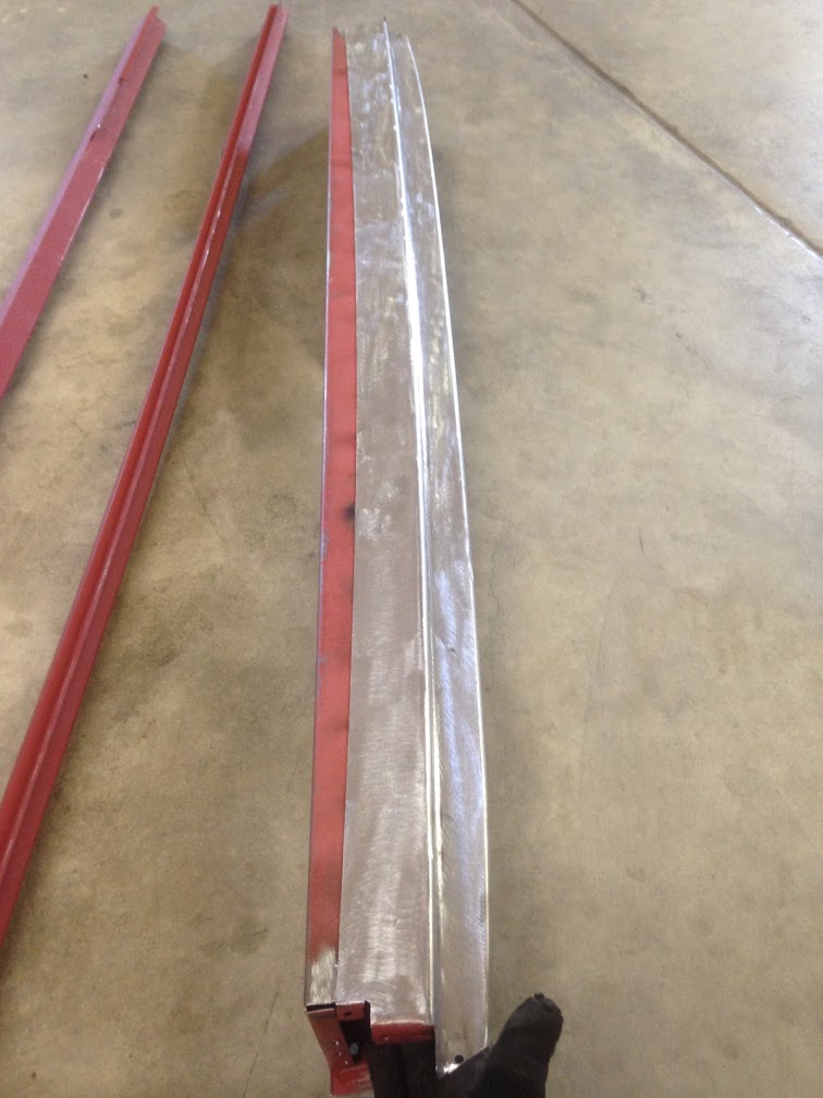

    Next up was fabricating a new roof structure. We discovered that the Crown Vic top actually began to start to arc down about midway through the door opening. The structure is all hand fabricated from there back. Also by getting the rear new C-pillars positioned where we liked them there was allot of work that needed to be done in the tail gate area.
    This was loosely patterned off the early 60's full size Ford wagons
    A wedge shape was made to lean the tailgate ahead to match the new C-pillar angle. We also took advantage of the structure being removed to make patches and remove the factory lead seams.
    lewk, 40two, BigO and 36 others like this.

  15. I ran across this car when I was researching things one day (we where already done with the major fab on the car at that point). The 2nd owner I believe it was & I spoke for awhile on the phone about the cars one day. I like the car but we went a totally different direction on the design from the B-pillars back.
  16. 56don
    Joined: Dec 11, 2005
    Posts: 10,333
    56don
    Yes, your design looks so much better. Looks like a factory built wagon..:)

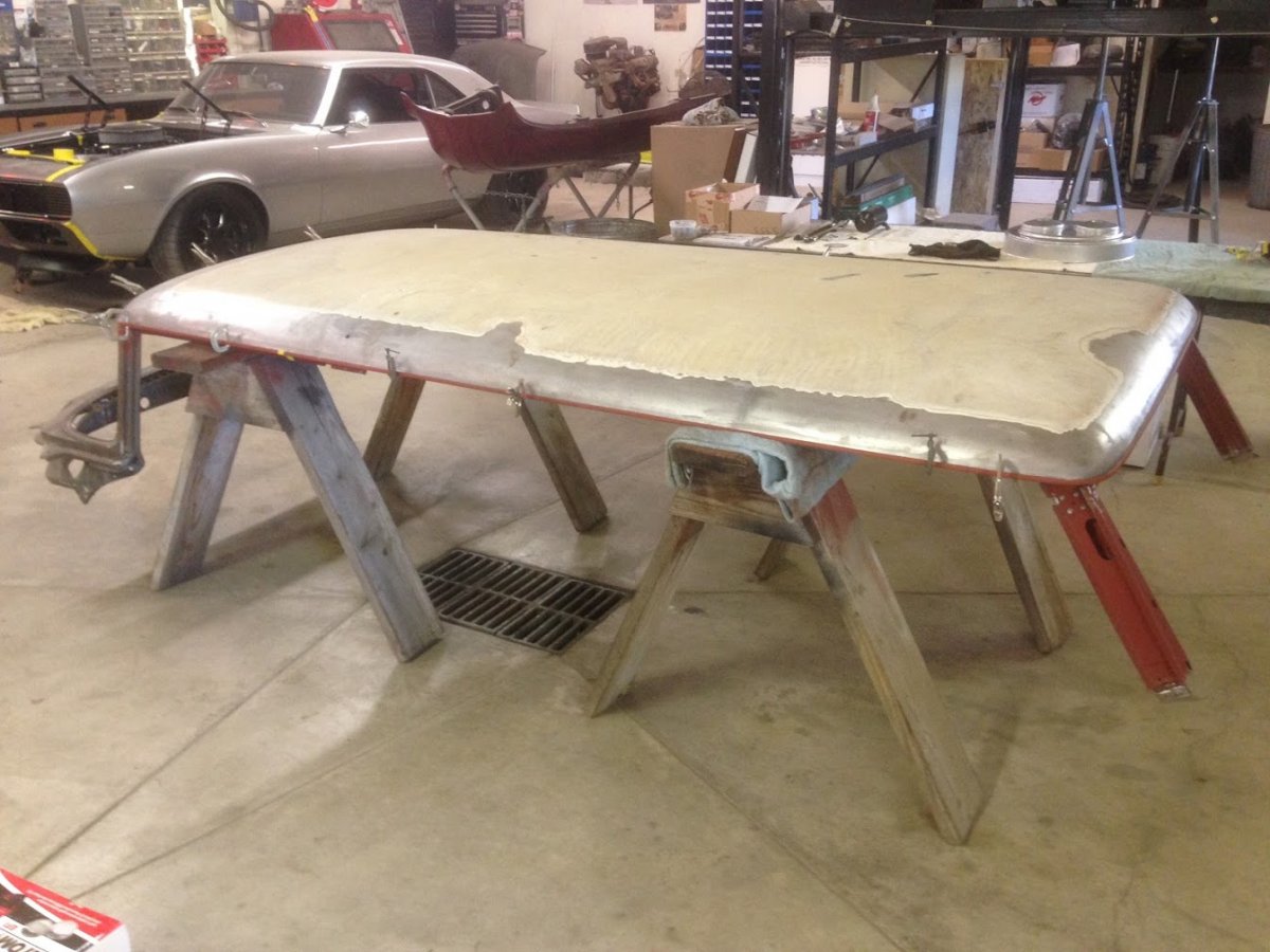

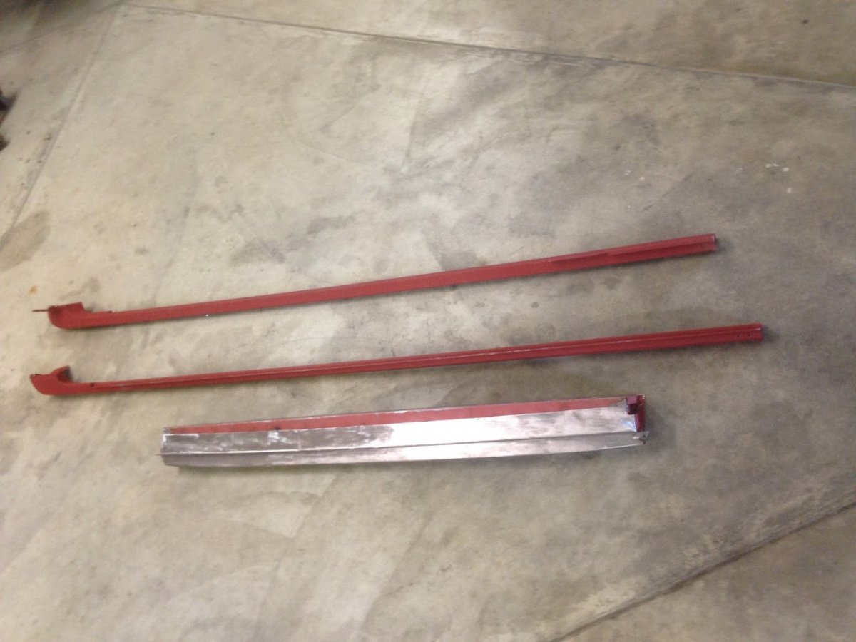

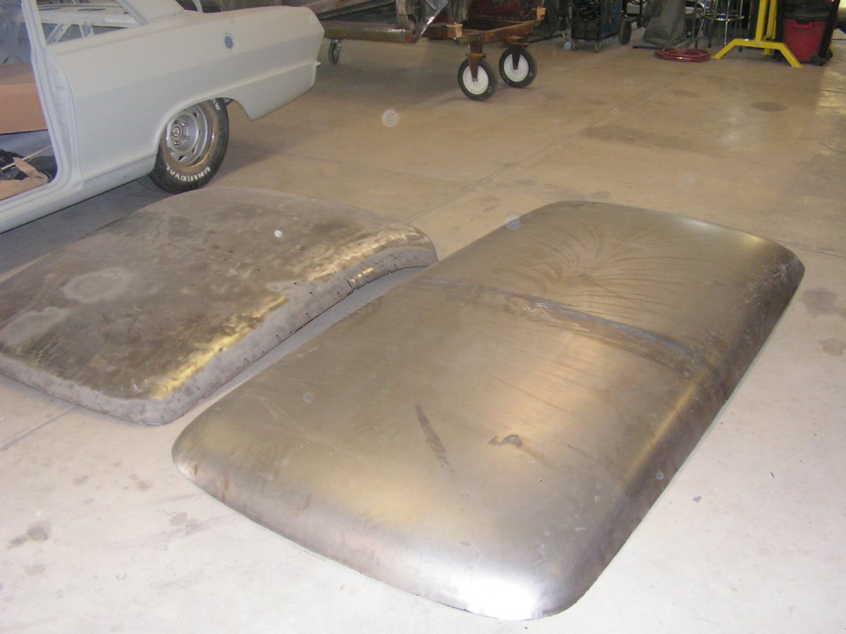

  17. Next up was the roof skin. We recycled the original wagon drip rails & Crown Vic header. the first 2"-3" had to be fabricated to get the corners & contour correct. IMG_3946.JPG
    The Crown Vic top & Wagon top. You can really see how "bubbly" the Wagon roof is.
    Some rust repair was needed.

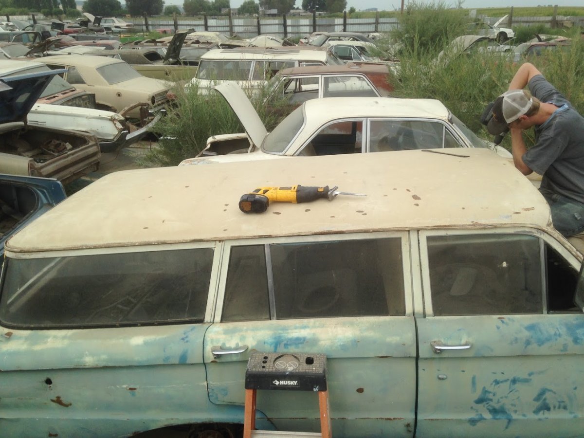

    After the initial mock up it was decided that the Wagon skin & Crown Vic front half was not going to get us the shape we wanted. Also the weld seem through the middle of the large low crown panel was going to be an issue. We decided to make a template & hit the wrecking yard to find something that'd hopefully work.
    The Falcon Wagon was a really close match
    BigO, brEad, Stogy and 19 others like this.

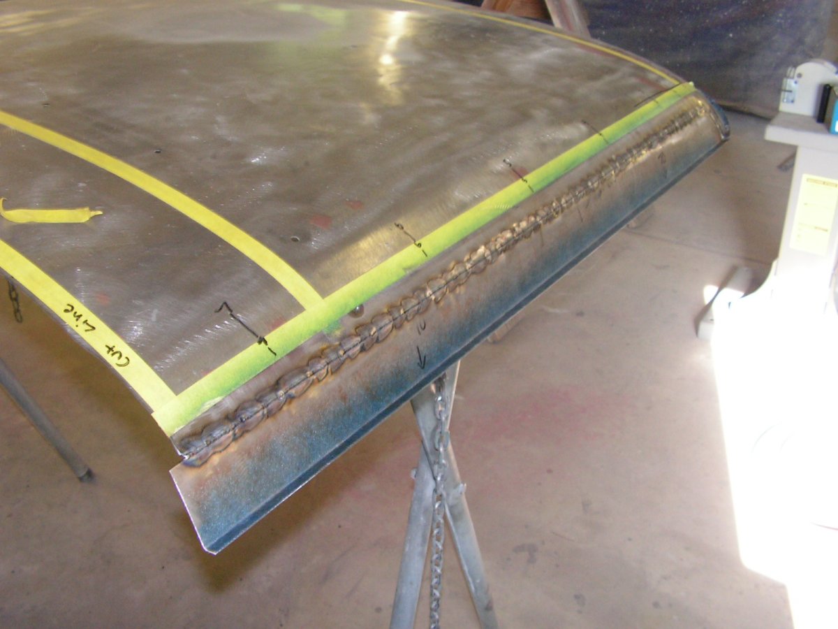

  23. Continuing on the roof skin....
    Mike attacking with the Sawzall!!!
    We attacked it like you would a "4-corner chop"
    After the welds where all hammered out and metal finished we removed the whole thing to primer the underside of the skin & structure. We also modified the original wagon braces and included them from the B-pillar back.
    BigO, brEad, Stogy and 28 others like this.
