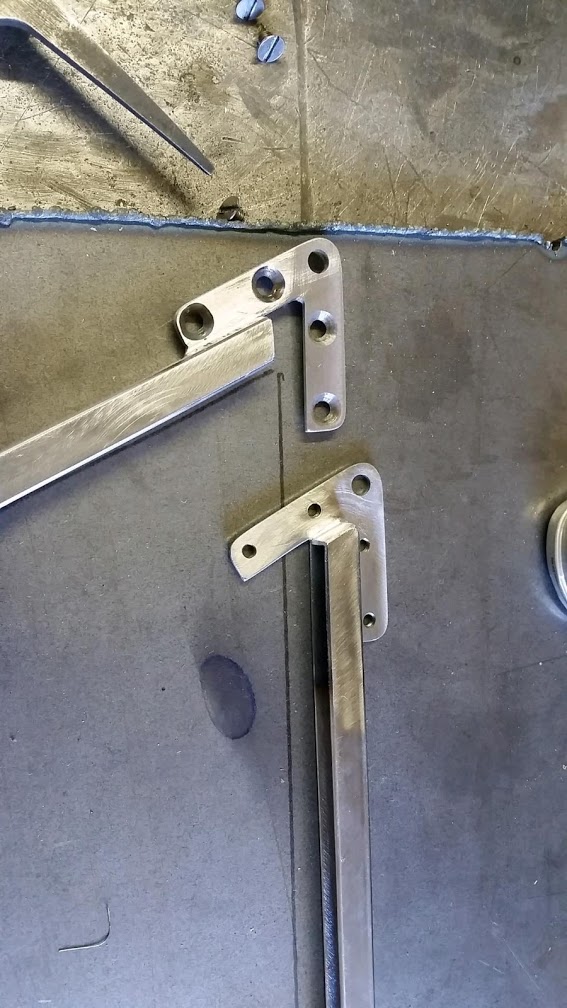

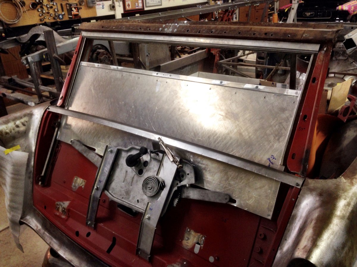

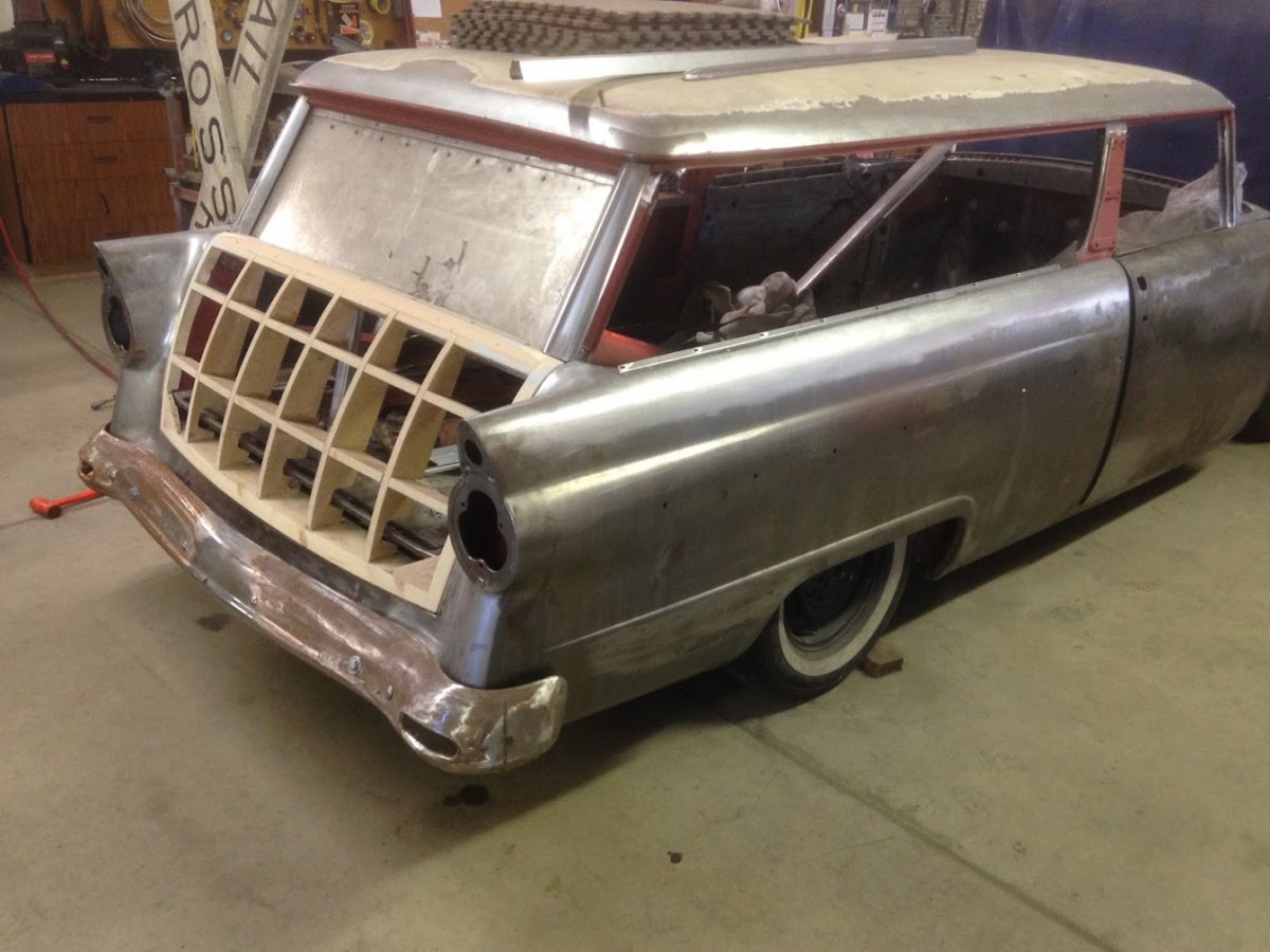

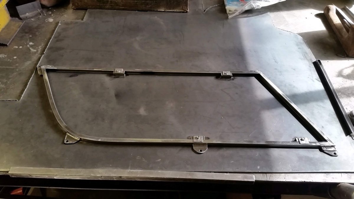

  2. Beginning to figure out the back window. Again we where really lucky to have the wrecking yard close by so we could go out there, study original cars, how they functioned & then try to back yard engineer things.
    We had looked into possibly using some sort of donor qtr. windows early on in the build but nothing was quite right. We talked with a company about making new "acrylic" windows for the car. The nice thing about going this route is we where free on the design & could make things look the way we wanted. We had to make aluminum "plugs" for the quarter windows & back window. They use these to make the new "gl***".
    After shaping the new window plugs Mike constructed window frames to house the windows.
    We wanted the windows to have a divider to look stock rather than a modern street roddish one piece window. You can also see the new structure stuff primered red.

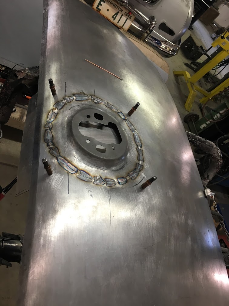

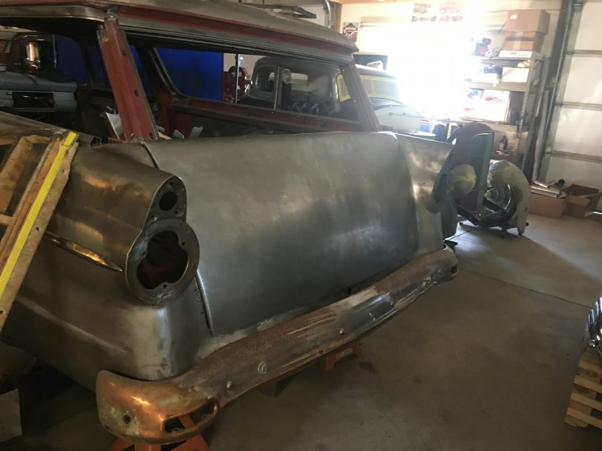

  3. Filled the gas tank door. The filler is now behind the driver side tail light.
    Shop etc. Oct 14 281.JPG Shop etc. Oct 14 283.JPG wagon quarter frame bare.jpg

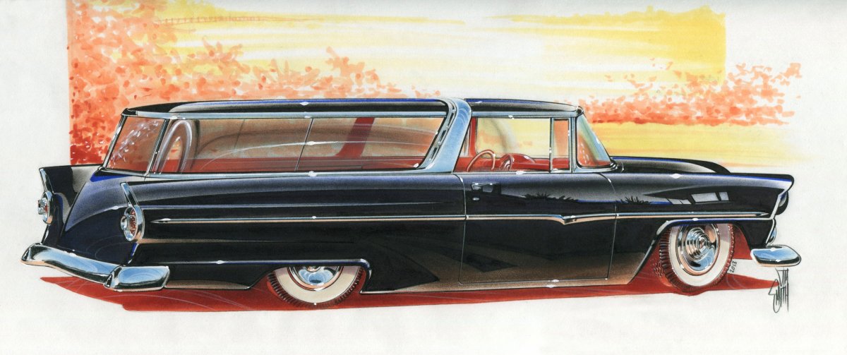

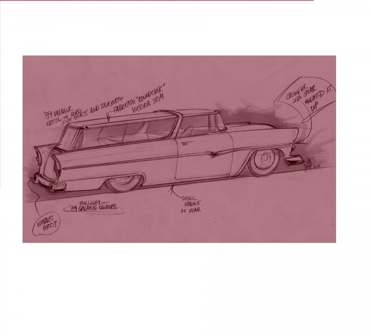

  4. Now's a good time to show the rendering by @Jeem
    Note the custom tail lights, side trim & '56 rear bumper.

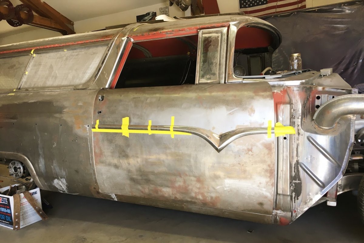

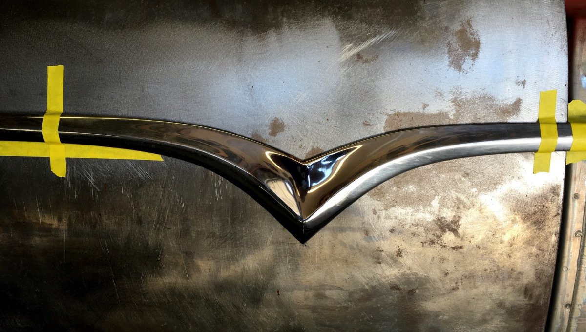

  12. By far the most challenging part of this build is all the customized & hand built stainless trim. Mike became a master at welding & finishing out the original stainless.
    As the renderings depict above we wanted to modify the side trim on the car. We used 4 "V" shaped door moldings cut in half & flipped to the other side to make one. The front fender trim is modified stock Ranch Wagon trim to flow into the new door molding.

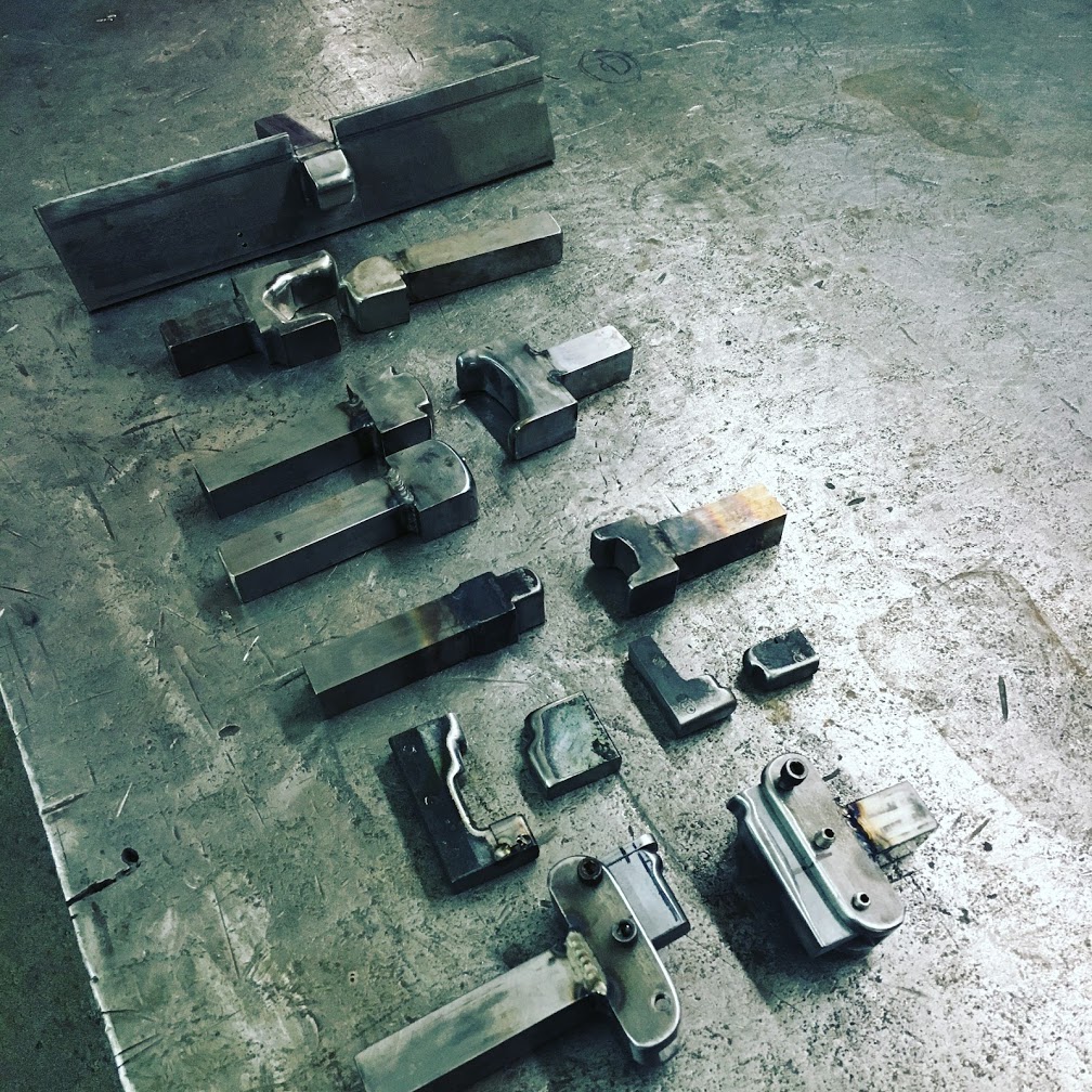

  13. Pretty much everything from the B-pillars back was either modified or custom made. We made our own dies for our Pullmax machine to form the trim above the drip rails from the B-pillar back. Also for the interior trim coming off the inside tiara molding, the molding above the back window & finally the molding on top of the quarters that extends from the B-pillars.

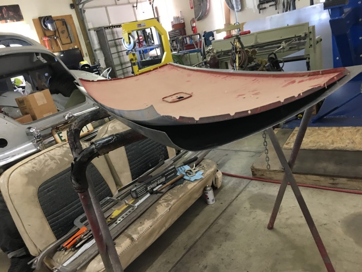

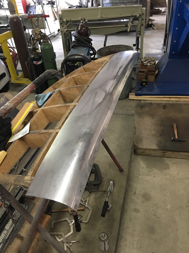

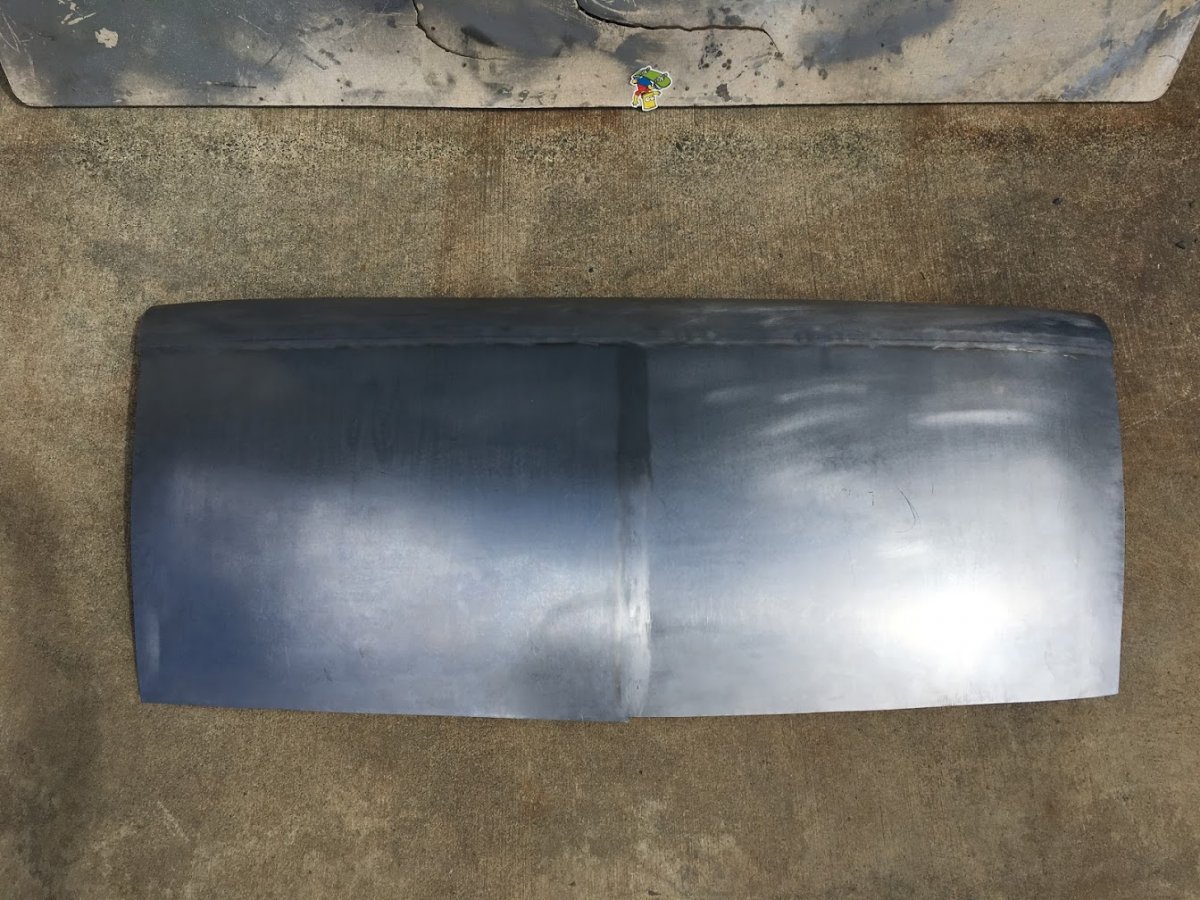

  19. We made up a buck for the new tail gate skin. The crown need to change allot at the top by being flatter but stay the same at the bottom to match the tail pan.
    Next up was shaping a new gate skin on the hammer. I'm no expert metal shaper so I need to make it in 3 pieces due to my lack of skills.
    40two, BigO, brEad and 21 others like this.

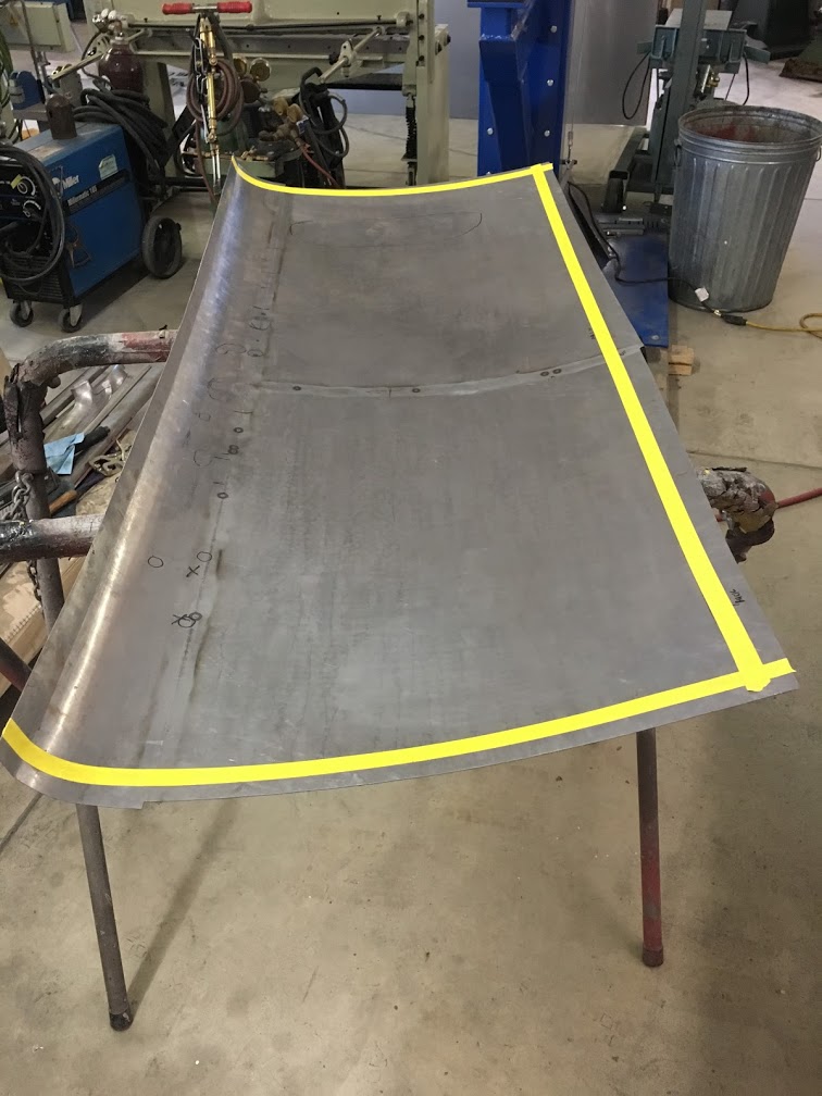

  20. You can see how much flatter the new skin is compared to the original skin. The original car was really round & "bubbly"
    Next was t******* the skin & tipping the flange to fit to the structure.
    First test fit.
    Donor gate that'll sacrifice some of it's mechanical parts & the bump deal for the power window switch.
