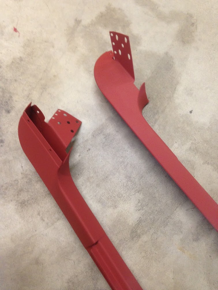

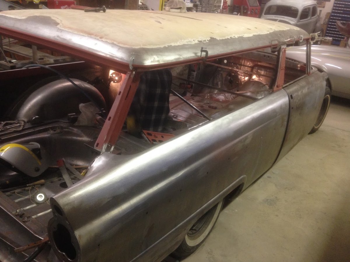

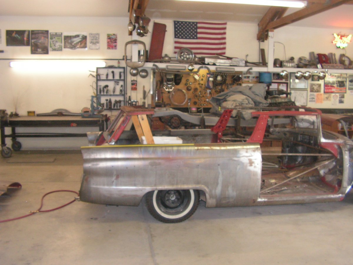

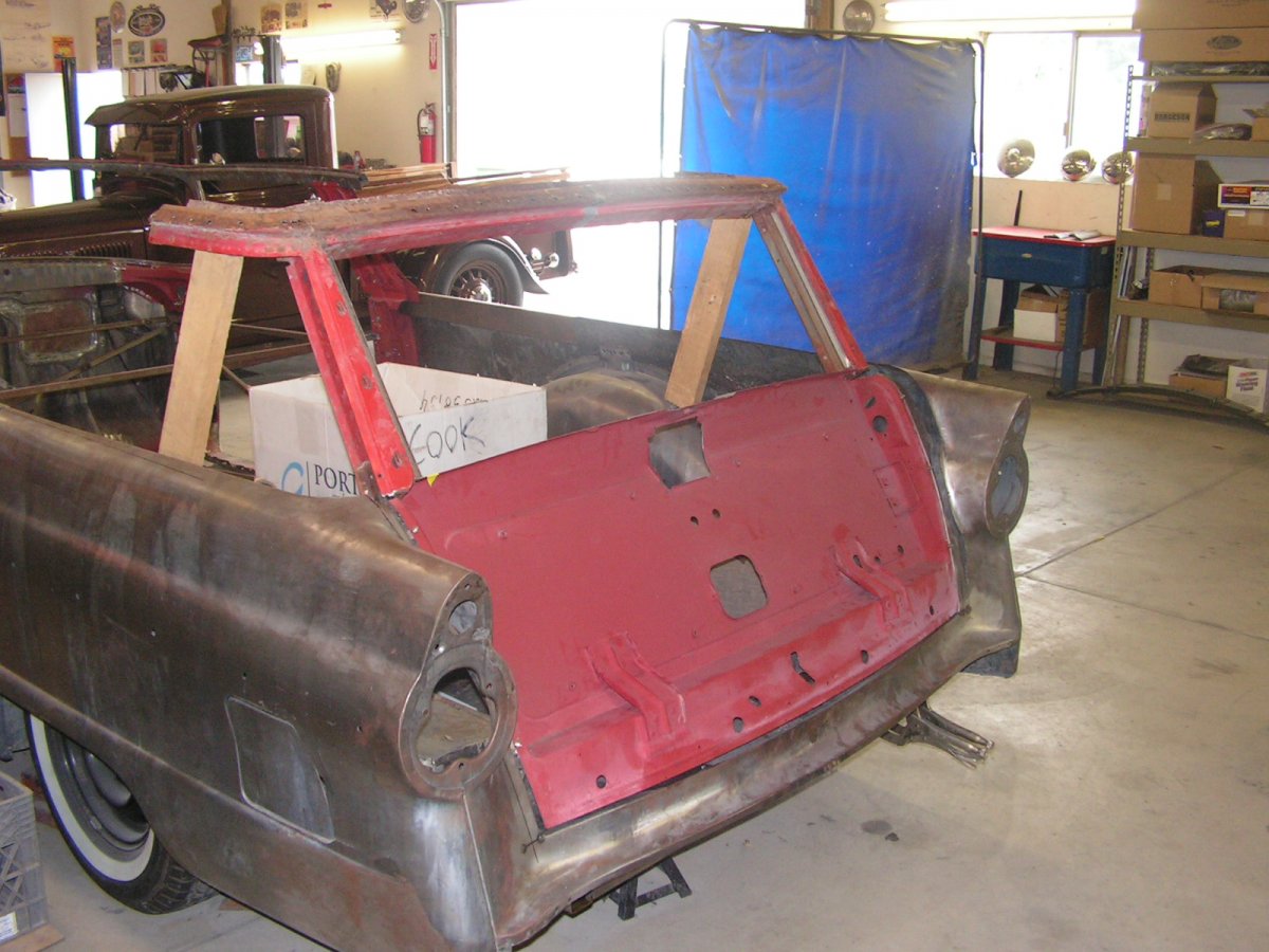

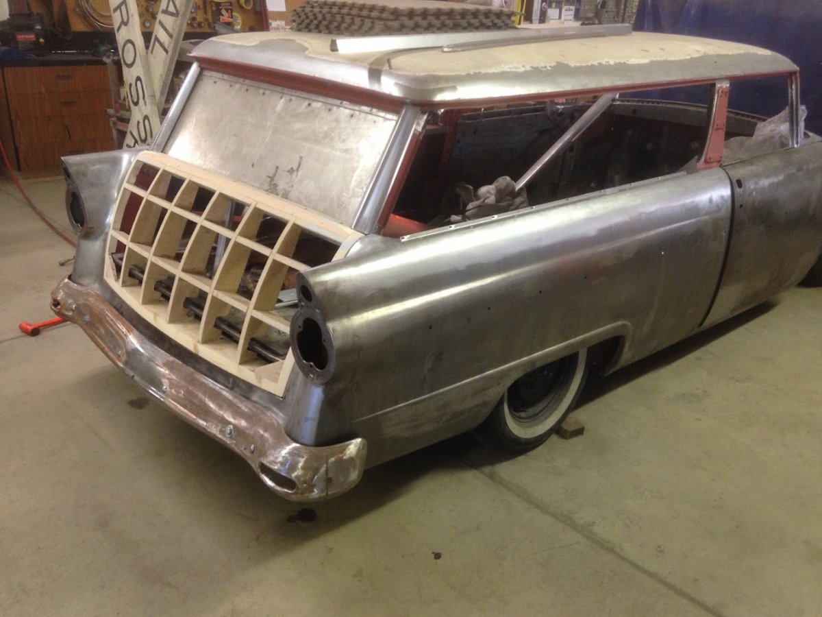

  8. Early on we knew we needed to re-make the tops of the quarters to work with the Crown Vic style trim & accept the new quarter windows. IMG_3568.JPG IMG_3545.JPG

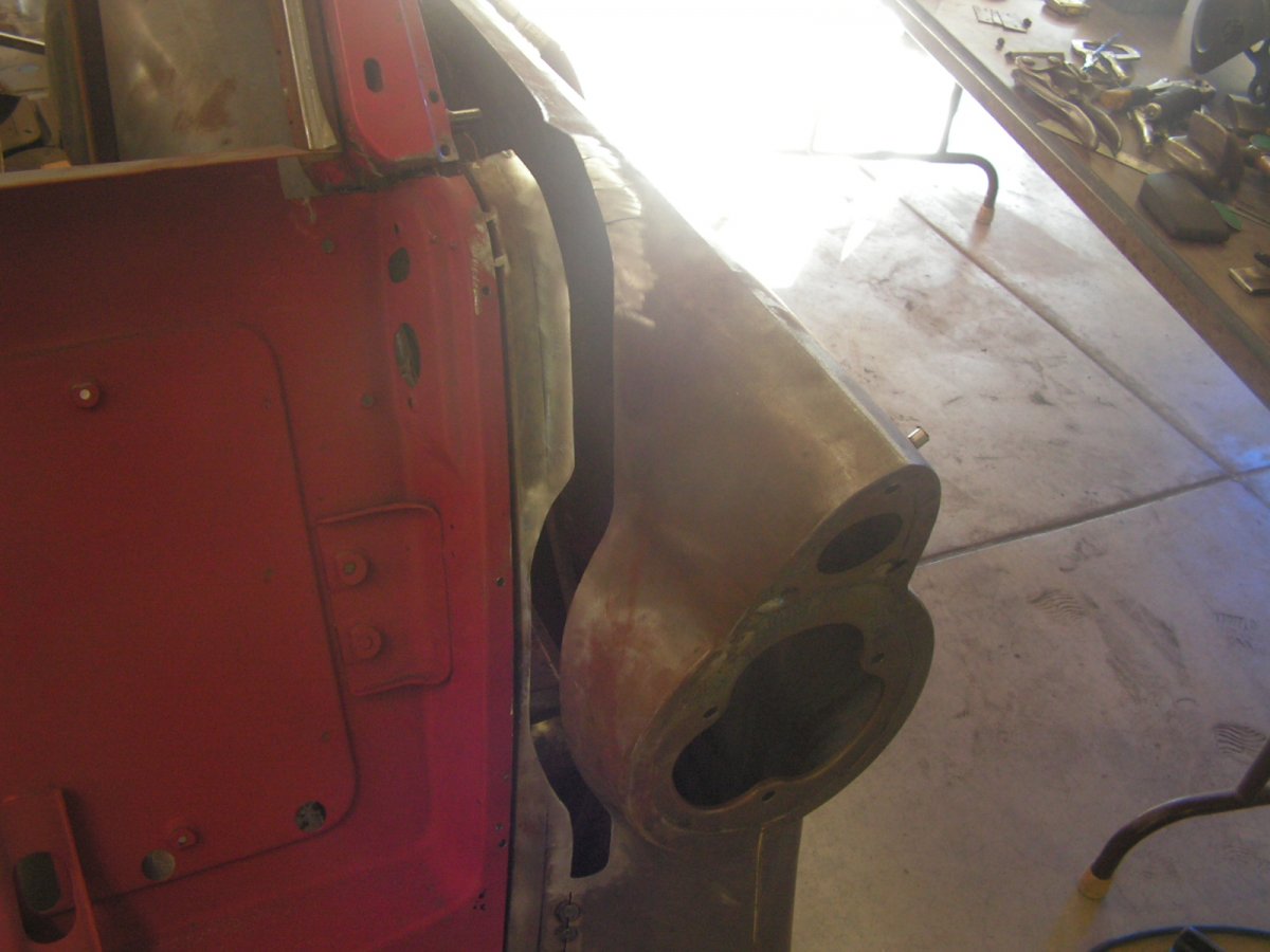

  9. We didn't like the stock tail lights. @Jeem suggested using modified Galaxie lenses & backup housings. IMG_3299.JPG

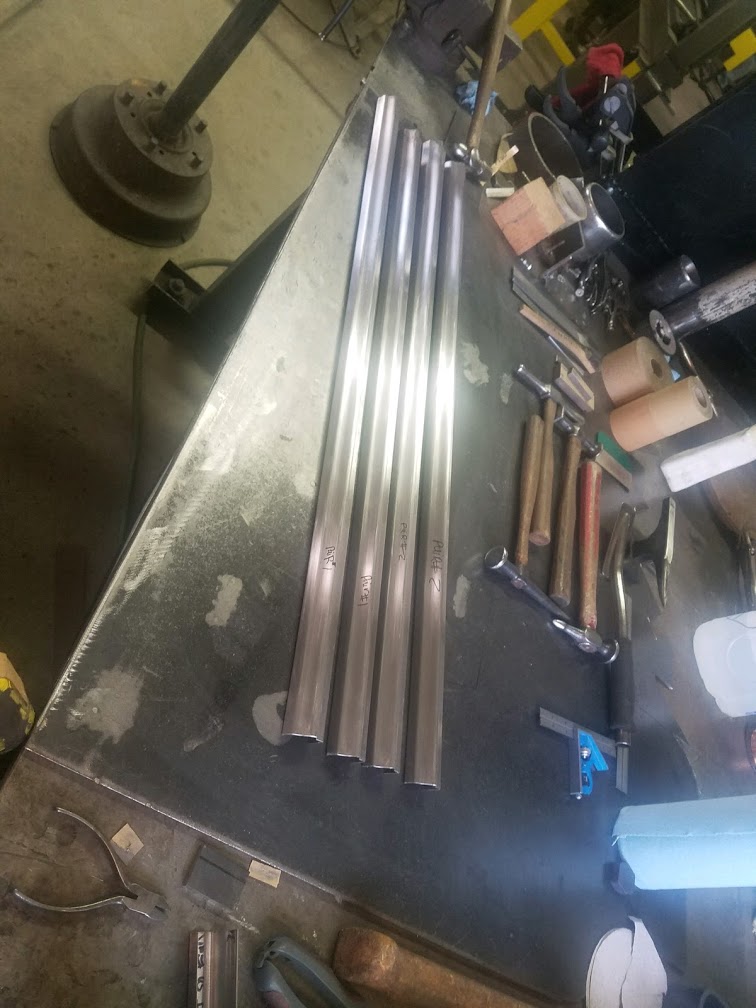

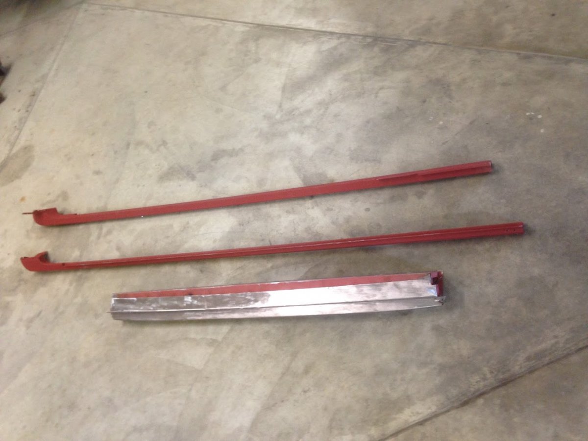

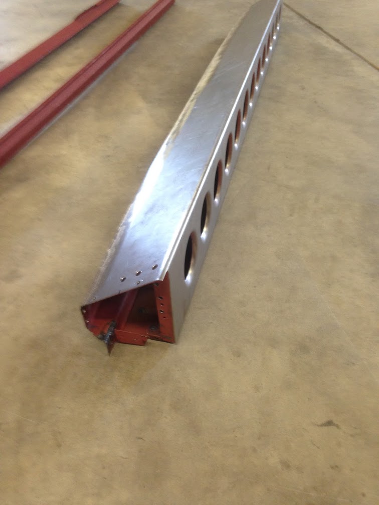

  10. The absolute hardest thing that needed done for this build is the custom trim that extends from the B-pillar all the way back to the tail fins that needed fabricated. Mike spent allot of time building the dies & welding all the pieces together to make it happen.
    12378122_522780374570313_110715177987074757_o.jpg 1421265_522780834570267_1343608164628229867_o.jpg 10557548_522781037903580_4870299184675422745_o.jpg 921401_522780911236926_1932301442240432823_o.jpg
    Test run to make the final product.
    63fdsnr, BigO, brEad and 21 others like this.

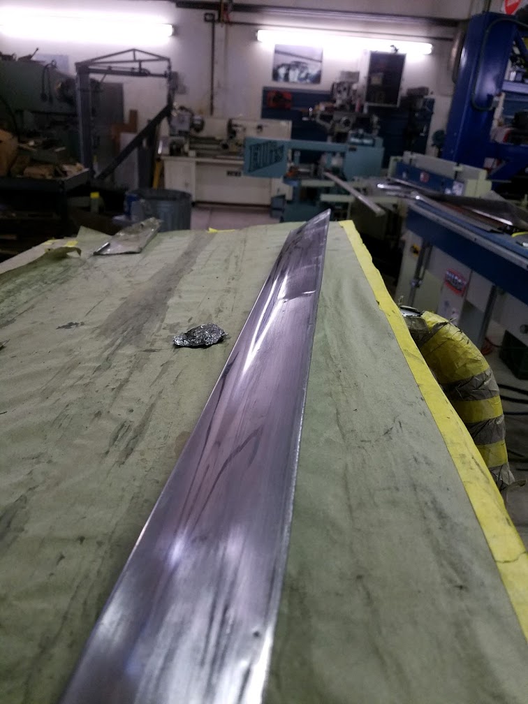

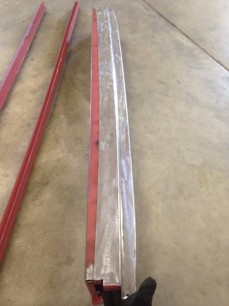

  11. We found out early on working with the stainless the best way to tackle welding it & blending 2 different part together is to use original Ford trim & cut strips to use as fill rod.
    We went to the wrecking yard again & found some nice flat rocker trim pieces from a Lincoln to re-purpose.
    After working out any small flaws on the Lincoln trim we formed it on the brake before running it through the Pullmax to give it the final profile.
    BigO, 54delray, drdave and 22 others like this.

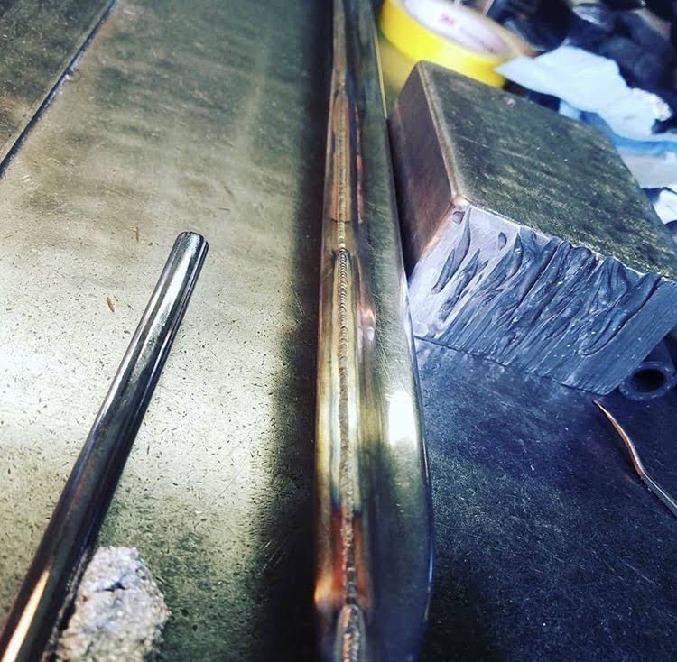

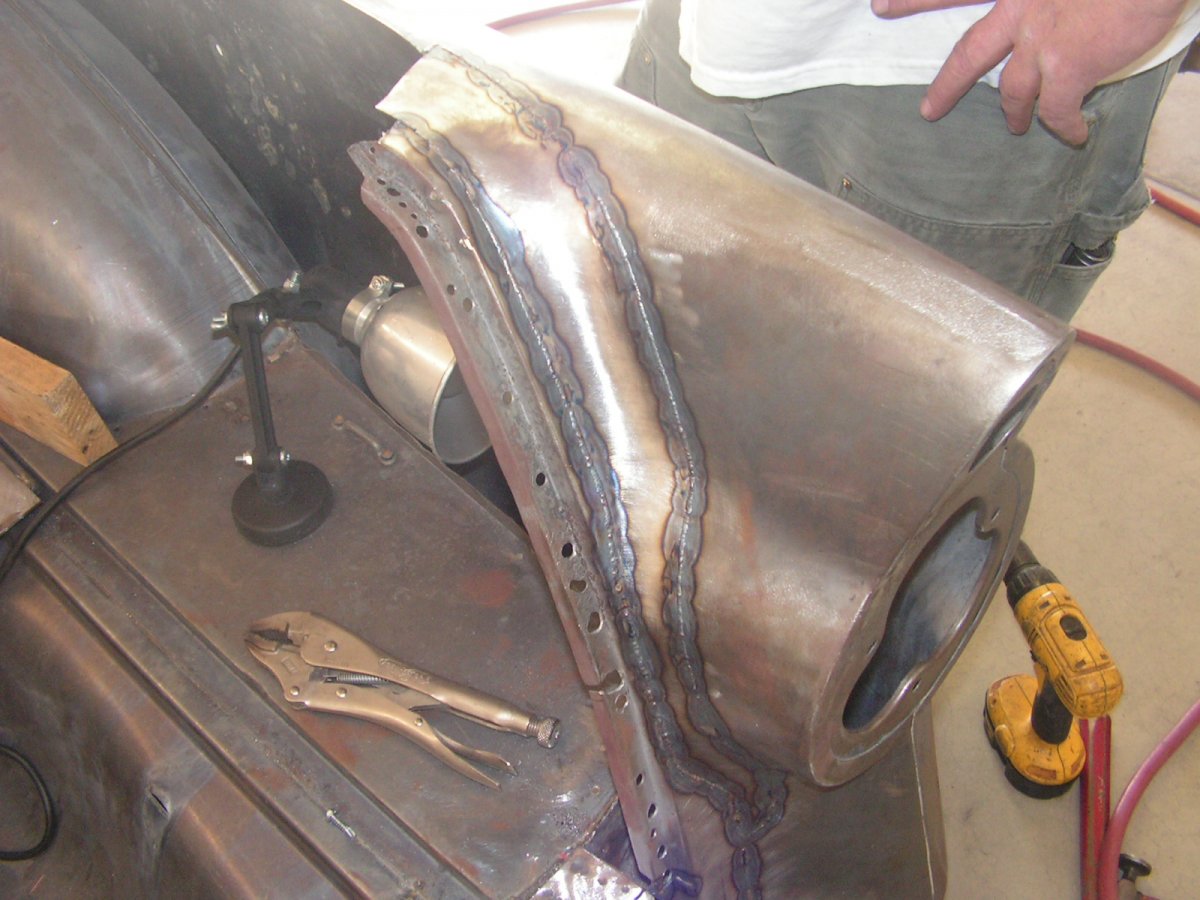

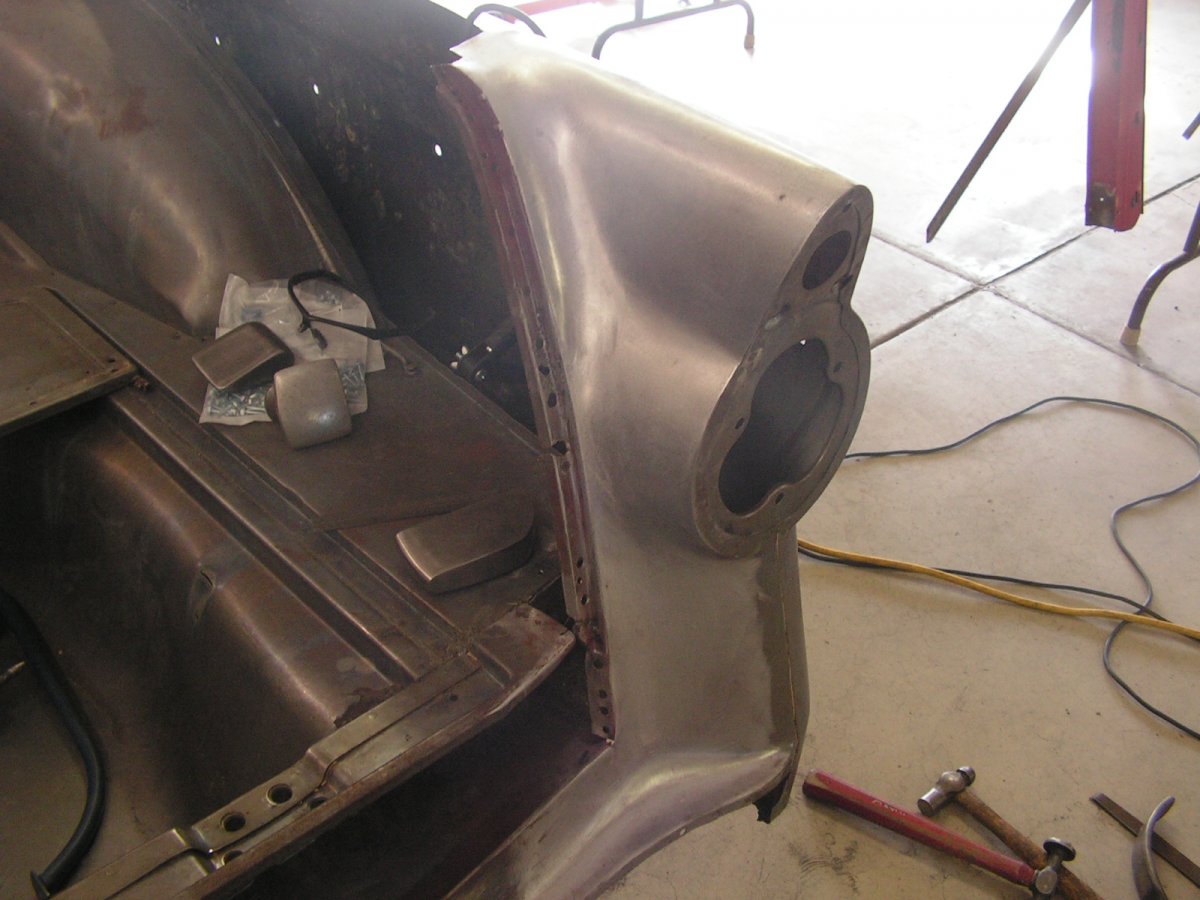

  13. Welding the trim together is a delicate deal.
    We re-used the stock Vic trim to finish out the ends above the tail lights. It involved adding along the bottom to match the new trim.
    IMG_4204.jpg IMG_4206.jpg 28514837_895307137317633_5542372096732245171_o.jpg
    Then comes the extremely tedious task of metal finishing the welds.
    lewk, Jim the Sweep, 63fdsnr and 27 others like this.

    Kudos to your welder. ..nice small welds (low bead height ), makes finishing so much easier. Good work.
