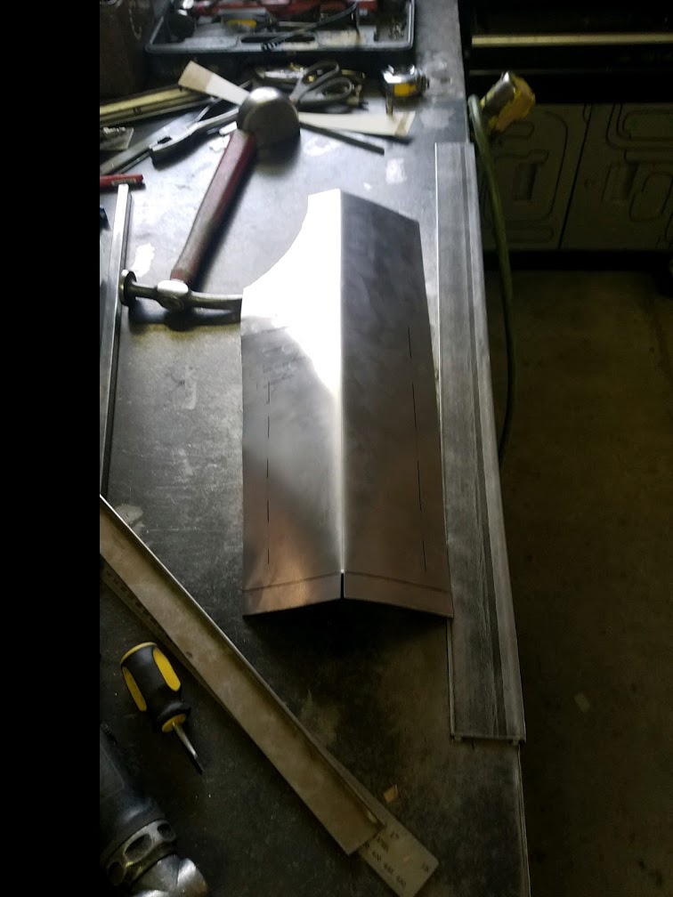

    When using your pullmax for making the custom trim, is this profile achieved after making several p***es? How do you keep the flat stock straight as the pullmax is forming considering the forces applied from the flat stock to the formed pcs?
  3. @METAL MELTDOWN We first formed the pieces into a "hat channel" profile so the hard bends are nice & straight from forming them on the sheet metal brake. Then run them through the Pullmax slowly with the machine at a higher speed. No real pressure making multiple p***es to slowly add the profile.

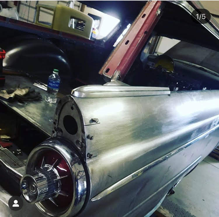

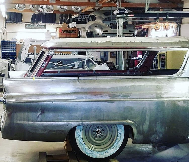

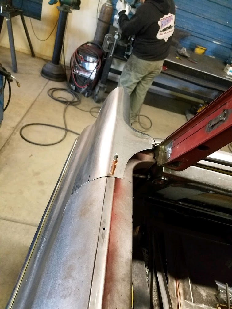

  4. The effect of making the trim that extends from the B-pillar nice & straight we realized the tail fin slightly trailed off. The solution was re-making & extending the top of the tail fin.
    It gave it a little more pronounced look.
    Trim mocked up.
  5. The consequence of modifying the tail fin is now the upper tail light bezel deal is no buno.
    Good opportunity to make something better.

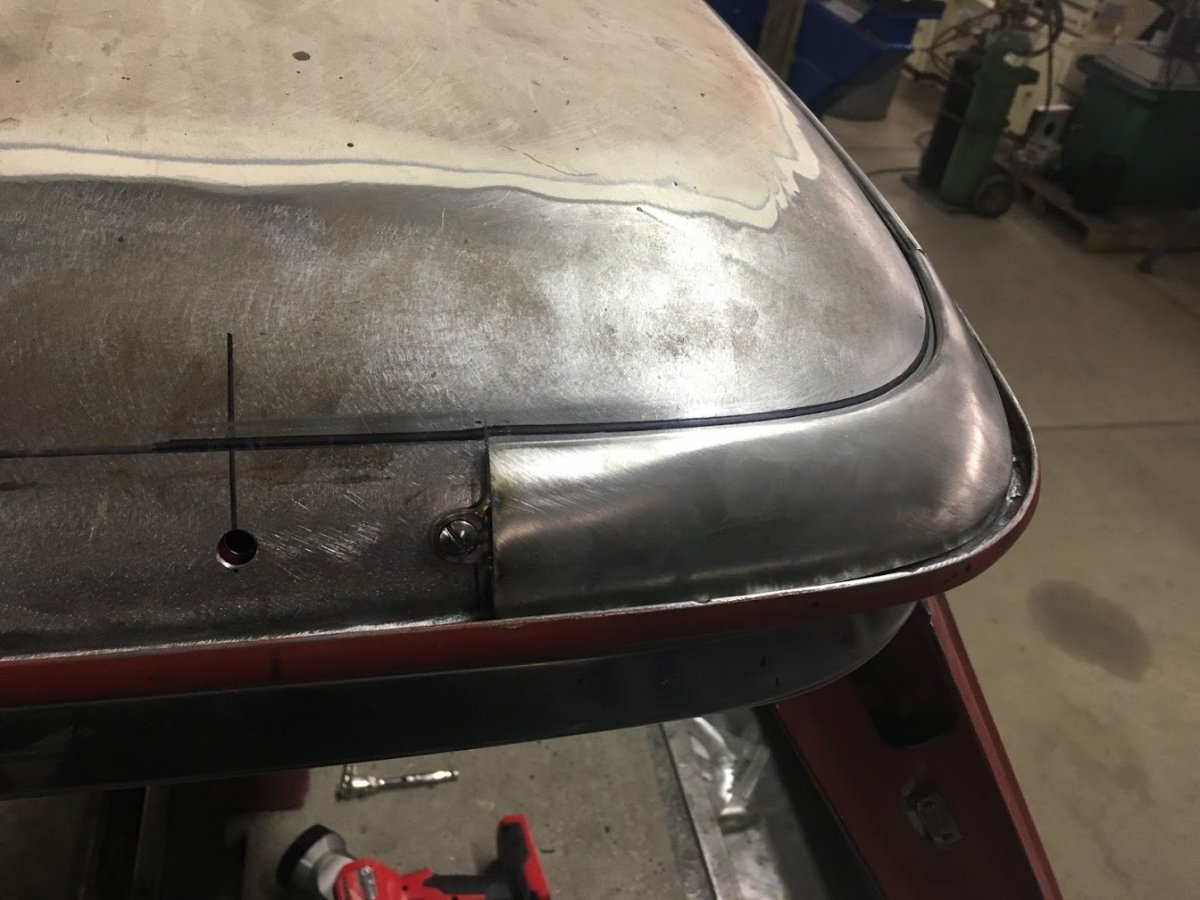

  20. That was exactly the intention. "factory prototype"

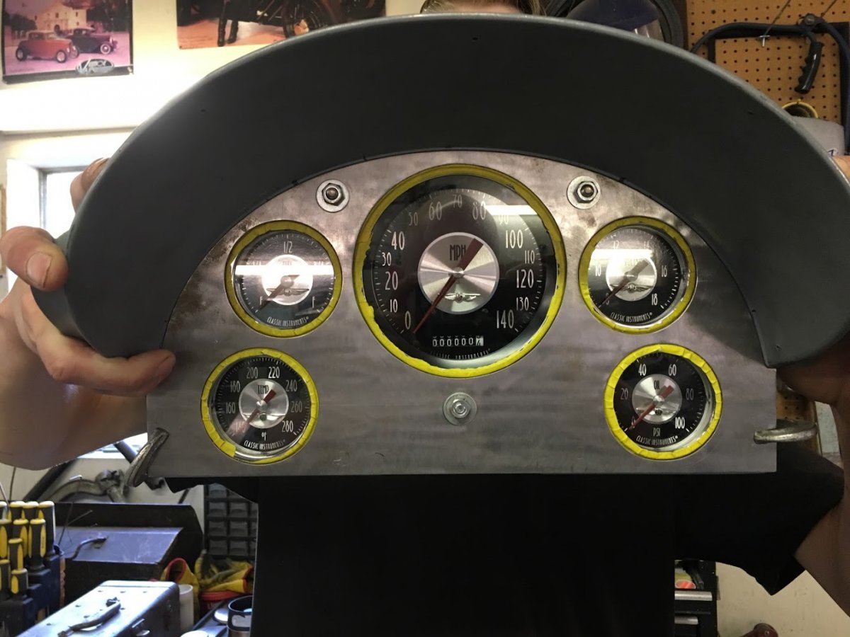

  21. We had decided that we liked the '56 Ford dash better. Scored a factory padded dash at the wrecking yard.
    We used a Lincoln/Mercury column to mostly use the Premier steering wheel we'd planned but also because they're good columns with a nice column shift. Allot fancier than the Fords.
    New gauge layout.
    Made up some AC side vents using black pipe & flat plate.
    The center vent is from a Mopar. The metal is a pattern for a future engine turned insert. We made a small finish trim piece to finish off the bottom edge.

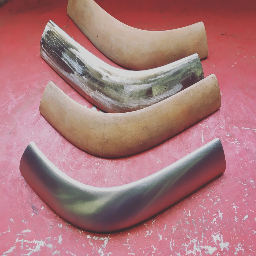

  22. Last trim that needed fabricated was the top corner pieces above the drip rails. We made a bondo "plug" to dial in the shape & profile we where after. Then cut out some blanks out of 1/2" stainless plate.
    Bent to the profile
    Attacked it with the grinder, sander & buffer.
