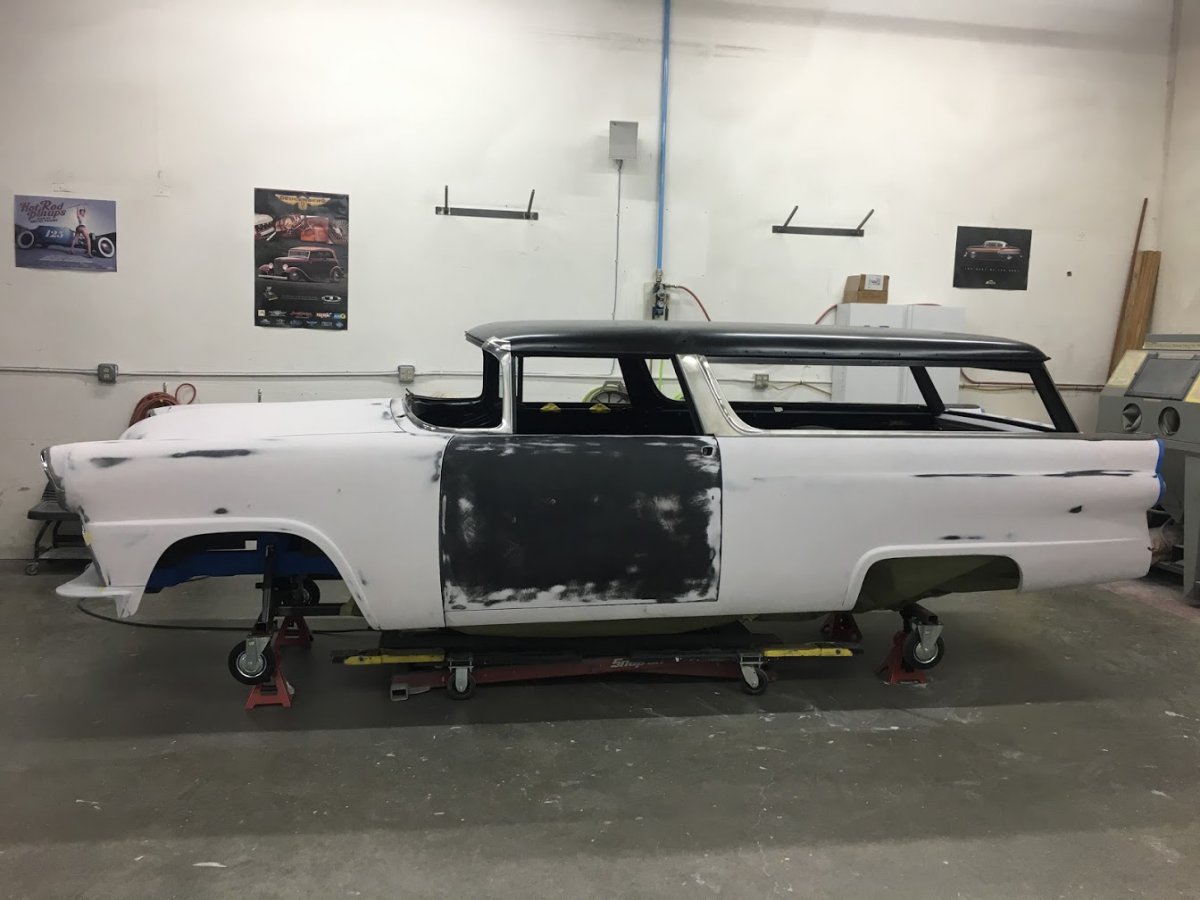

  6. Next up was dis***embling the car to head to Northwest legend Jon Byers & crew for paint.

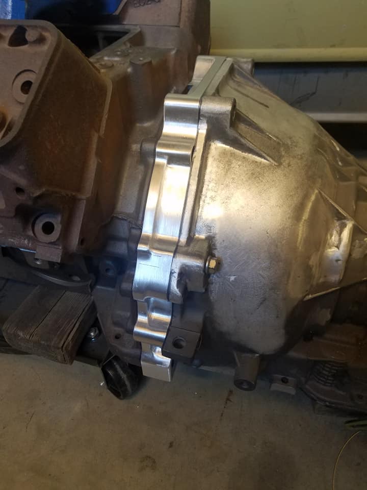

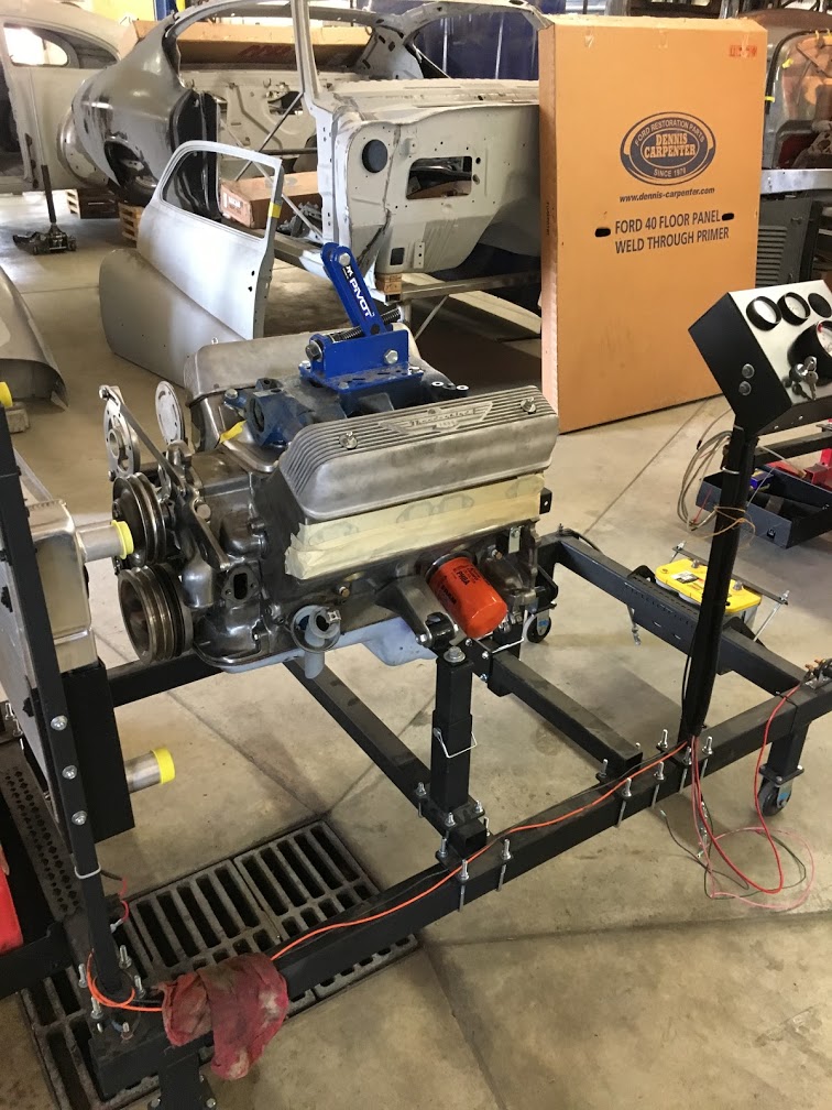

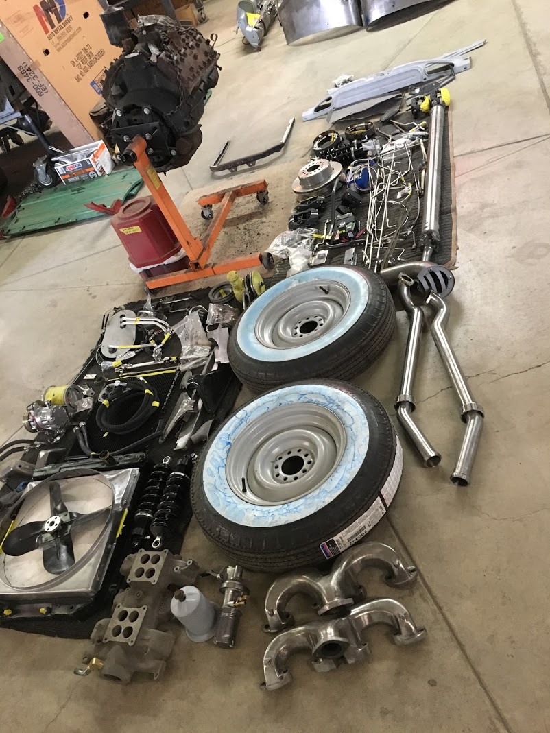

  7. While the body was off we could focus on getting the engine & drive trans all sorted out & ready to go. Also get all the parts ready for plating & other coatings.
    IMG_1682.JPG IMG_2353.JPG 74484989_2522494401172744_3583624298356539392_n.jpg 75369137_2522496211172563_7931838150760988672_n.jpg 75446660_2522496254505892_2613763546969800704_n.jpg 74789935_2522496544505863_3306486225002561536_n.jpg 75485214_2522496421172542_8671110199743873024_n.jpg 31919483_1670087653080094_3931857691210678272_o.jpg 75339507_2522496714505846_5988343802685816832_n.jpg 72628424_2522497224505795_4175807495706509312_n.jpg 76710739_2522499781172206_3629287849481732096_n.jpg

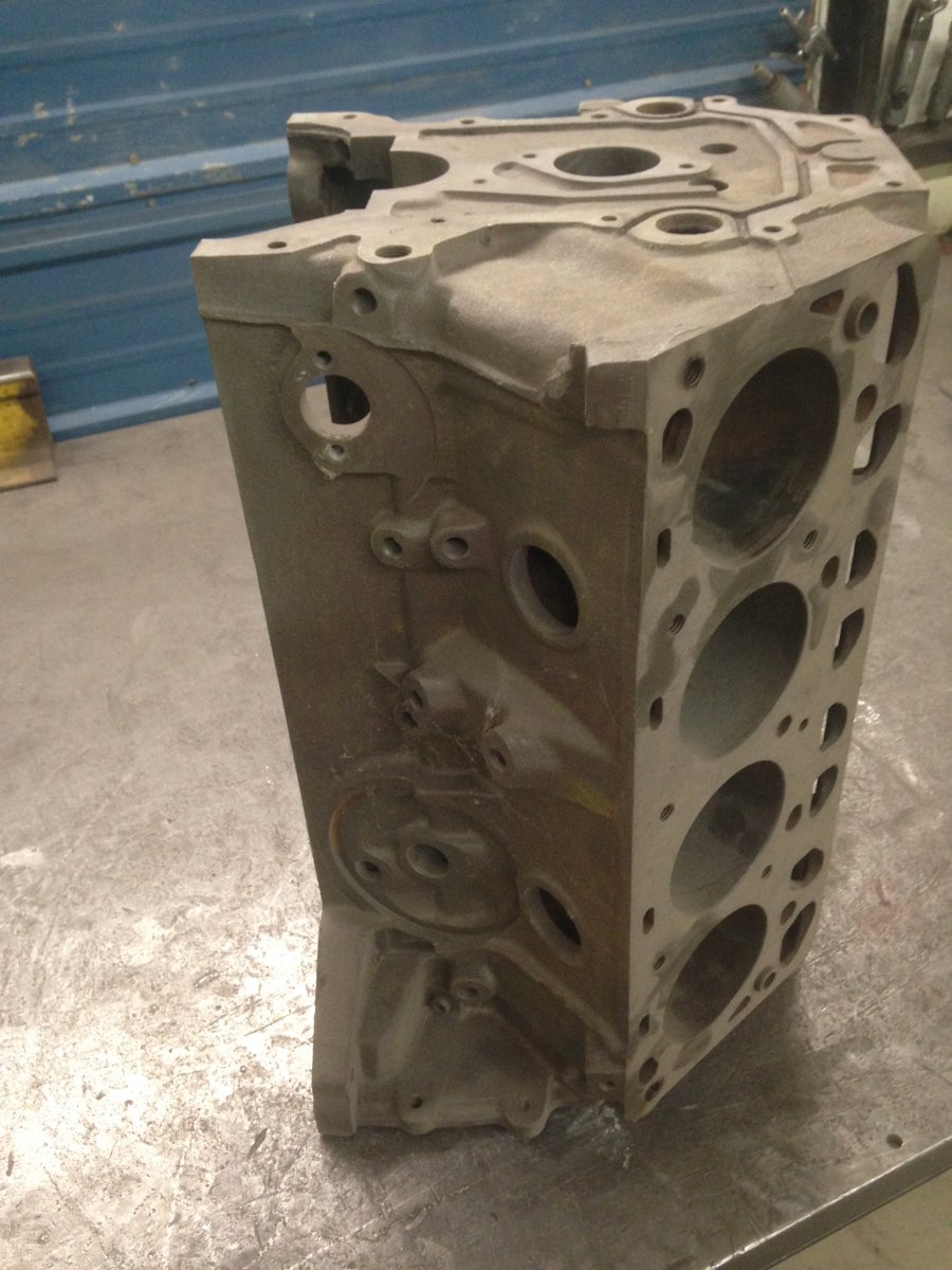

    You've obviously forgotten more things automotive than I will ever know but you might want to reconsider how you are hanging that flathead on the engine stand. JMO Parts pile 1.JPG

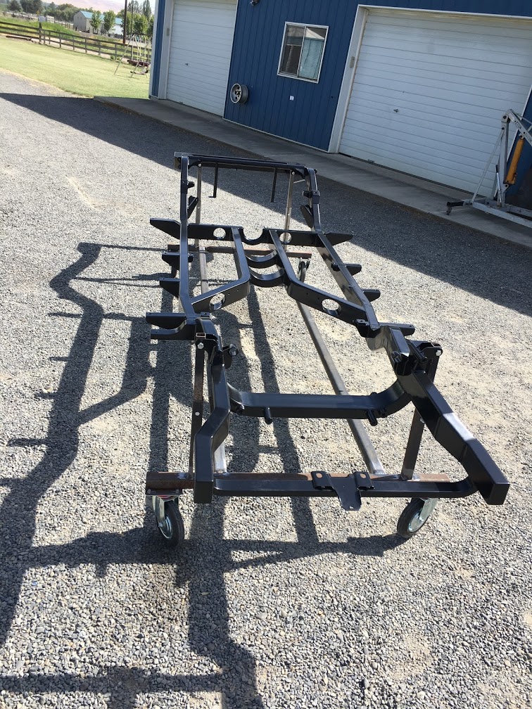

  17. Continuing on with the wagon. While Jon & the guys working away on the car.
    Final welding on the ch***is & rest of the under car components. Powder coated the frame & got it back to Byer's to be get the body installed for the last time.

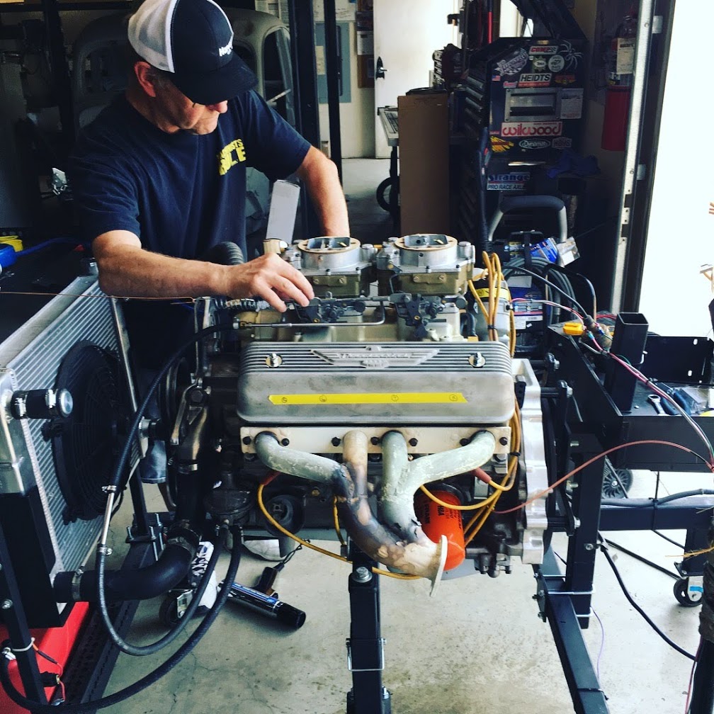

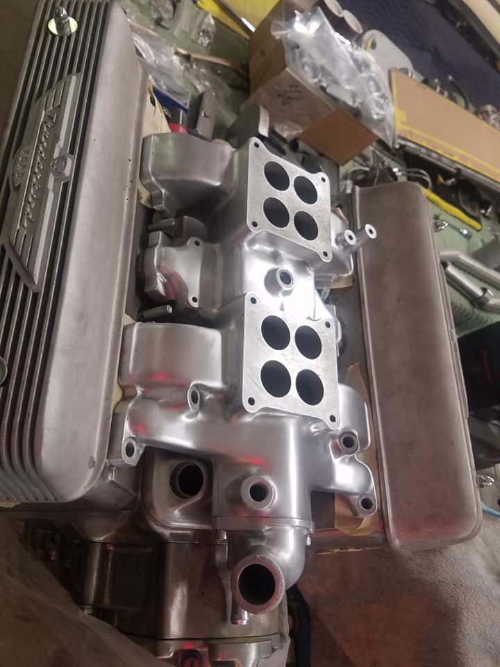

  18. My go to Engine builder (now retired :() Rich Eims built the 330 CI Y-block for the car. We used a 292 block with an offset ground 312 crank & turned down mains to fit into the 292 block. Custom Forged pistons & H-beam rods from Mummert. Ported & worked over a set of ECZ-G heads. Schneider Cam. Smoothed Edelbrock intake with a pair of Carter WCFBs from a 331 Crystler.
    We wanted it to look like something experimental by using the WCFBs like @jimmy six

  22. No idea. We never dyno'd it. We just ran it on the stand the tune it & break in the cam & stuff.
