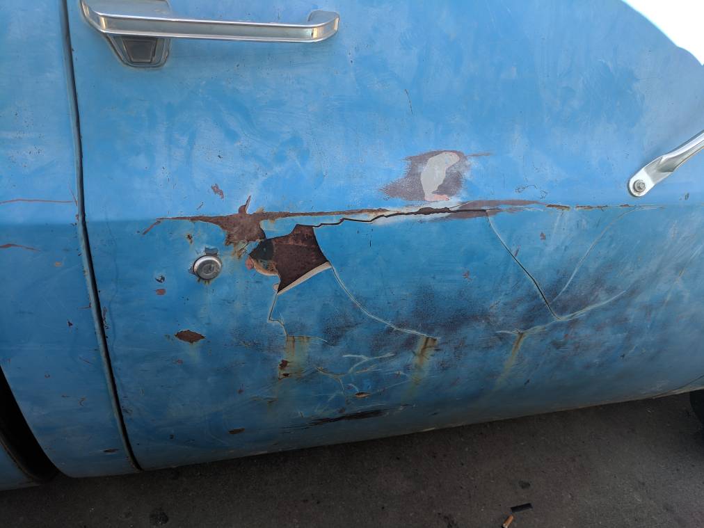

  12. My daughter had an OT small pickup that got smashed in the door. One of those traveling body men drove by her house and saw it and made her a screamin' deal on fixing it. She brought it by after the repair and it looked good, primered with a guide coat on it. Seemed like the bondo was a little soft though. She drove it for years like that and when it finally died, I did a little digging into the bondo. The stuff was still soft after many years. Maybe it was play dough.
    Nicholas Coe, mad mikey and Bleach like this.
  13. Bleach
    Joined: Apr 19, 2011
    Posts: 31,888
    Bleach
    ^^^Probably not enough hardener was used in the mix.

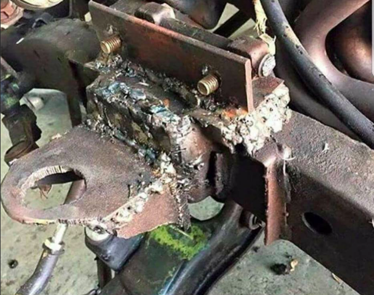

    Some people should just not weld. This was an attempt to weld a shock mount. Shocking indeed. Screen Shot 2018-12-24 at 11.14.22 AM.png
    brad2v, Dave Mc, alchemy and 8 others like this.
  15. X-cpe
    Joined: Mar 9, 2018
    Posts: 2,260
    X-cpe
    But it goes so well with the upper control arm mount.
  16. Exemplifies the term "bird **** weld".
  17. captainjunk#2
    Joined: Mar 13, 2008
    Posts: 4,420
    captainjunk#2
    that s the type of arc welding the ole guys referred to as stacking chicken s**t with chop sticks came from
    Boneyard51, Nicholas Coe and Bleach like this.

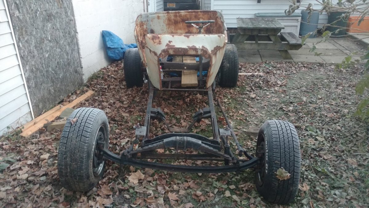

    IMG_20181112_064846777.jpg here's how the previous owner lowered the front end on this t bucket. They flipped the front cross member around and welded it upside down. It has since been removed.

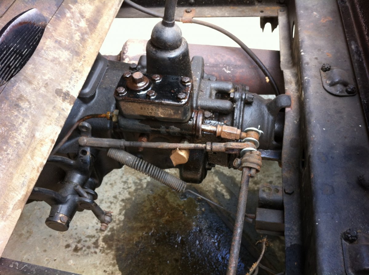

    OK, I'll play. There has been a lot of discussion over the years on converting a model A to hydraulic brakes. There are a lot of innovative things I found on my avatar. I am the third owner of the car and went all the way to the right coast to pick it up because it was owned by a man who bought it when he came home from WWII and drove it for many years, then restored it in the mid eighties. At least I got a decent original body. This could be a very long thread but I will only post the brake system and as a bonus, show what I cut off the frame.
    The heart of the brake system is some kind of weird master cylinder I have never seen. It was bolted backwards to the side of the transmission with a piece of rusty angle iron. Then an original brake rod (A) was run backwards to a piece of brake rod (B) that went from the frame to the transmission. Rod B was secured to a hole in the frame with a washer and cotter pin on each side. Rod A was supported by a piece of br*** screwed on next to the master cylinder When the brake pedal was depressed the rod A would pull rod B forward and that in turn would drove rod C into the master cylinder. Now that the master cylinder was mounted it was time to mount the backing plates. The front ones actually went together in a normal manner, but the rear backing plates have always been a problem. The first step was quite innovative. To clear the spring hanger he simply hogged out the brake cylinder hole and moved the wheel cylinder up. This was a giant step forward as the wheel cylinder now cleared the spring and shock hanger. The problem that arose next was that the brake shoes would no longer be centered on the backing plate. The cure was to bring the wheel cylinder back down and put some kind of putty in the hogged out hole. Finally the backing plates were clocked and he got that part to work, although the emergency brake cables really didnt work well but what the hell do we need an ebrake for anyway? All that was left was to plumb the lines. Steel is such a pain to deal with so copper was the choice of this master mechanic. Oh, did I mention that the son told me his father was a master mechanic who was so smart that he was called down to Florida to work on the space shuttle? I wonder if that was the one that went down??? The amazing thing is there was a Pennsylvania inspection sticker that was attached to the windshield less than fifty miles before what was showing on the working speedometer. You people in PA better not think your state's inspection stations are doing anything more than collecting money. So here are the pictures along with what was cut off the frame. IMG_0323.jpg IMG_0605.jpg
    Dave Mc, Bleach, 2FordGuy and 6 others like this.
  25. s55mercury66
    Joined: Jul 6, 2009
    Posts: 4,367
    s55mercury66
    from SW Wyoming
    This is a perfect example of a picture being worth a thousand words. I wonder if the PA inspections were like Ohio's, they only cared about pedal travel when checking the brakes, and the parking/e-brake had to work.
