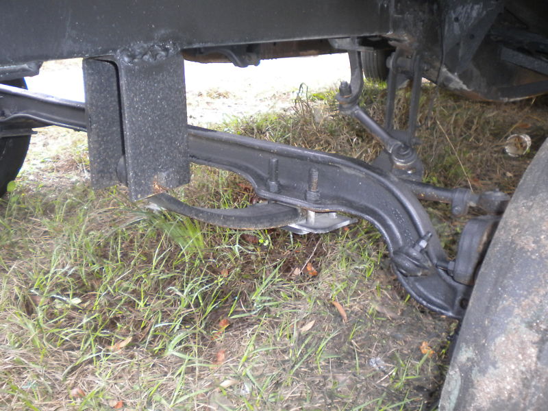

    I don't know about anyone else but I'm feeling a lot better about my "skills" after viewing this thread.

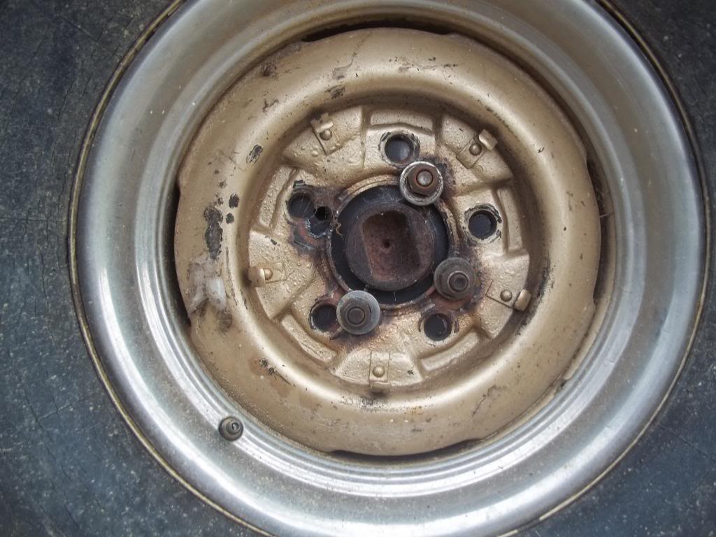

    Wheel doesn't fit? Just burn some new holes in it! 100_1720_zps431075e5.jpg 100_2721_zps4fid1kdw.jpg
    Don't worry about phasing the U joints, it'll work with them any old way

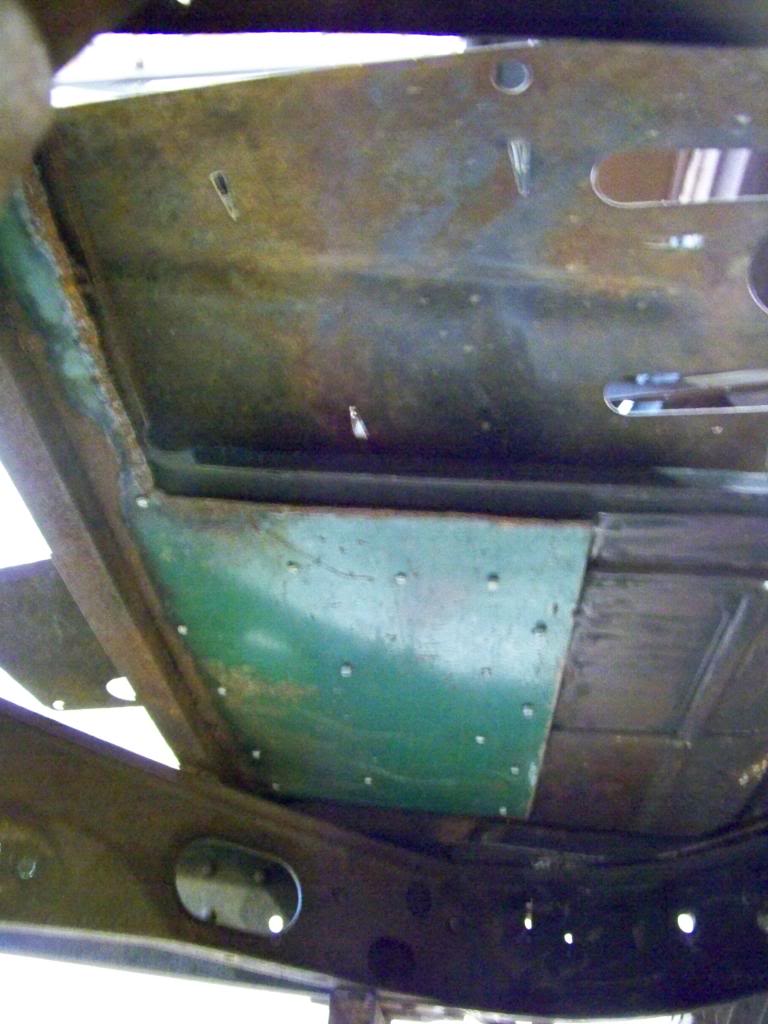

    from omaha, ne
    Where did you pry that from? Inner rocker and floor?

    I had an OT car with aftermarket wheels on it and the center whole opening was about a couple of millimeters bigger than the hub and that had a significant shake to it. I can't imagine that car being derivable at all.

  15. wicarnut
    Joined: Oct 29, 2009
    Posts: 9,204
    wicarnut
    It appears that not all car builders are craftsmen, I am amazed by some of the welding in the Pic's, WOW !

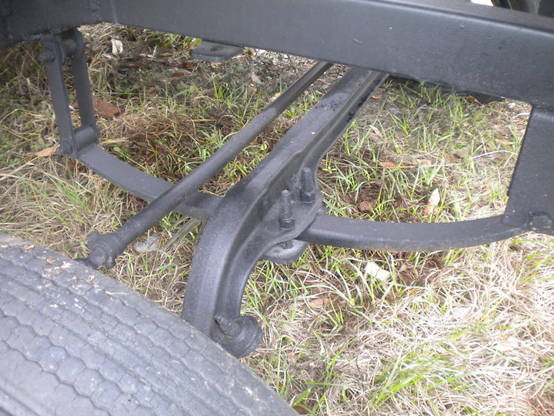

  17. Boneyard51
    Joined: Dec 10, 2017
    Posts: 6,776
    Boneyard51

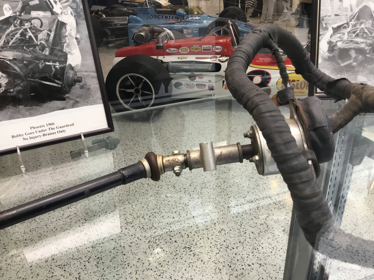

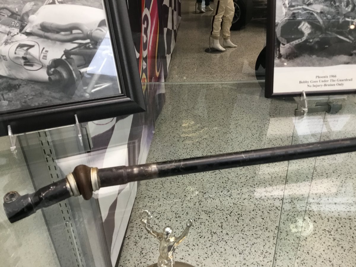

    I can’t believe some of these welds, they don’t look like they would hold for a minute. At least the dropped tie rod had heavy material and pretty good welds.
    Here on the HAMB I keep hearing about “ no welds” on the steering. Then I read about a guy cutting a steering box in two and welding it back together and that’s ok.Then I see these “ manufacturered “ couplings that are way weaker than a good weld being accepted.
    Then I go to the Indianapolis 500 Museum and see the weld on the steering on one of the Unsers race cars.
    Kinda hard to figure 4FA61741-DDD4-43C1-874A-17A2FC335E73.jpeg 9B849085-3652-43FD-A11B-C184C5543F28.jpeg 57CB0C88-EC2E-40D8-86F3-E2B38AB1F8C6.jpeg what’s right and what’s wrong with all this.
    I figure if it’s safe enough for an Indy car, it ought to be safe for a street car.
    Just my .02.
    Bones

    Most of those comments here, relate to steering components below the steering box , not the steering column shown in your post [which usually has a 16:1 mechanical advantage]
    If you ever do a Brinell test on a weld, you will notice that most welds are stronger than the parent material. Also the material next to the weld is usually softer than the parent material.
    Most welders kid themselves that their welds are stronger than the job they're welding, but don't realize their welding is actually weakening the parent material next to the weld
    The proper fix [usually at the high-end fabrication level] is to anneal the whole piece then heat treat it again.
    I had a cut and welded countershaft in a M22 that was done this way [I fed 650ft/lbs through it]
    I've also had a welded pitman arm on my old Road Race car , It never bothered me at 170+ mph.

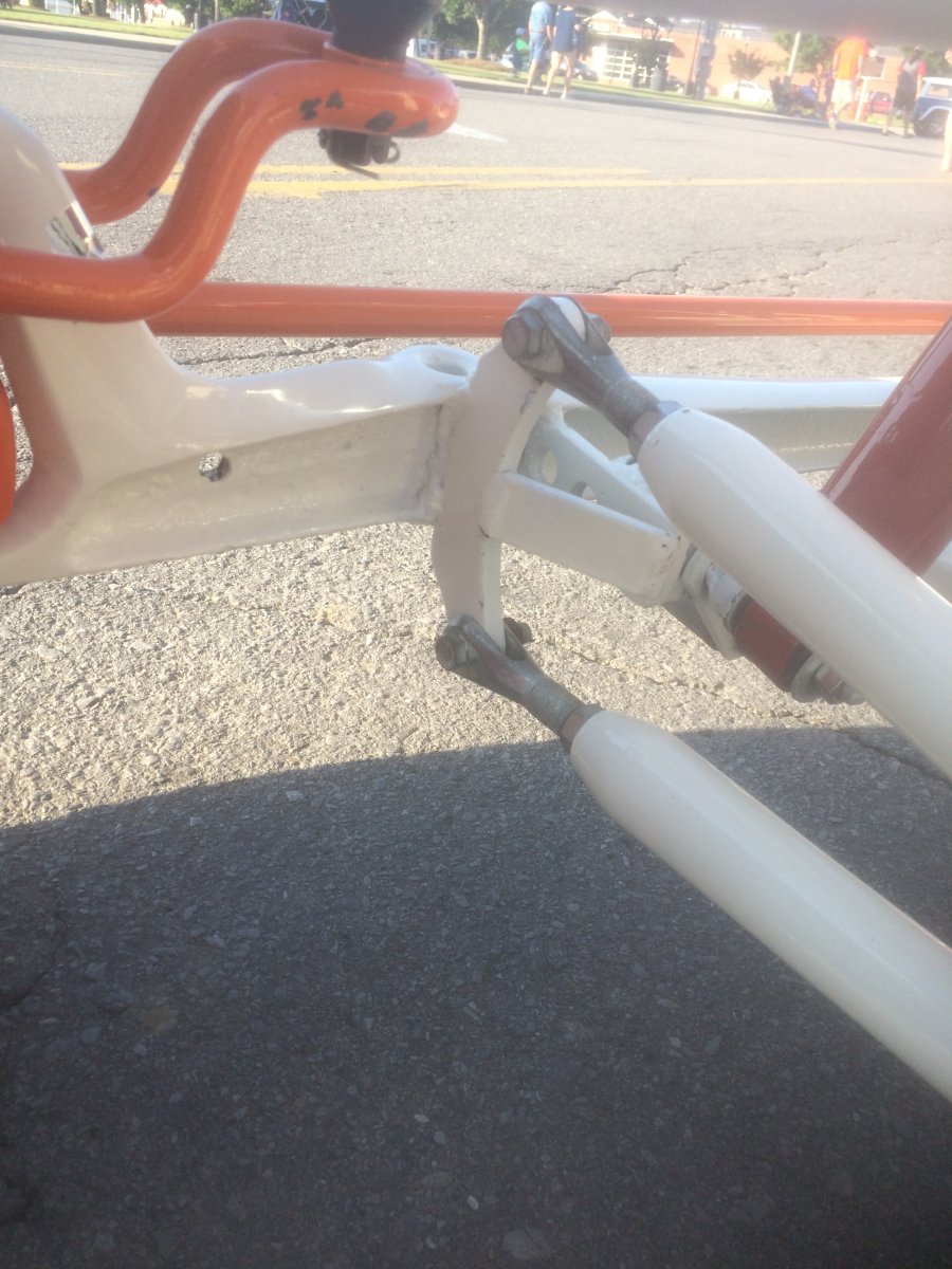

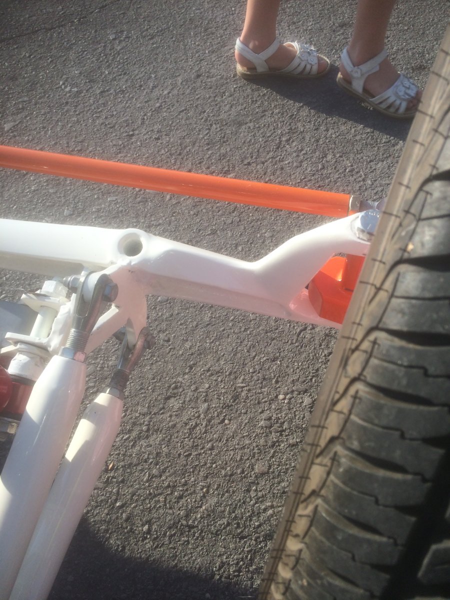

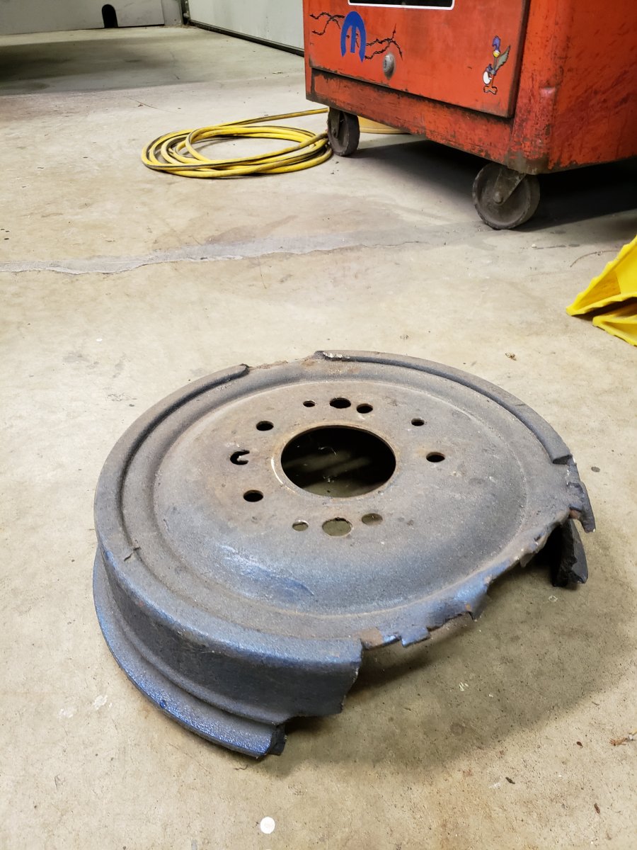

    My wall hanger likely belongs on a different thread, as it's simply an example of a part that wished very much to remain where it resided for decades. smashdrum.jpg
