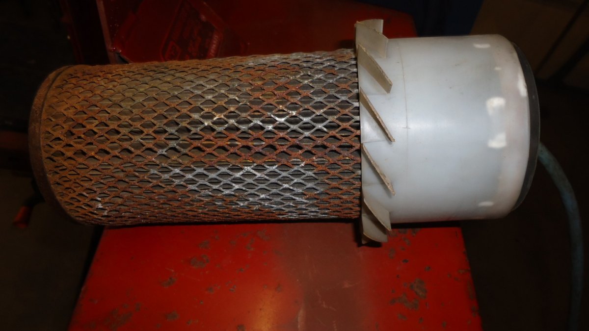

    Not car related, but definitely "LACK of MAINTENANCE"
    I could not believe what I found when on my nephews' Toro GroundsMaster when checking out why the Mitsubishi diesel engine was hard-starting.
    This wasn't their doing.....They bought the unit "used", and they did go see it and drive it.
    Seemed to run OK at the time; early fall.
    But there were some problems starting it when the weather got a little colder.
    This is/was the dry air cleaner ***embly ..... Toro 223D aircleaner assy_1.JPG

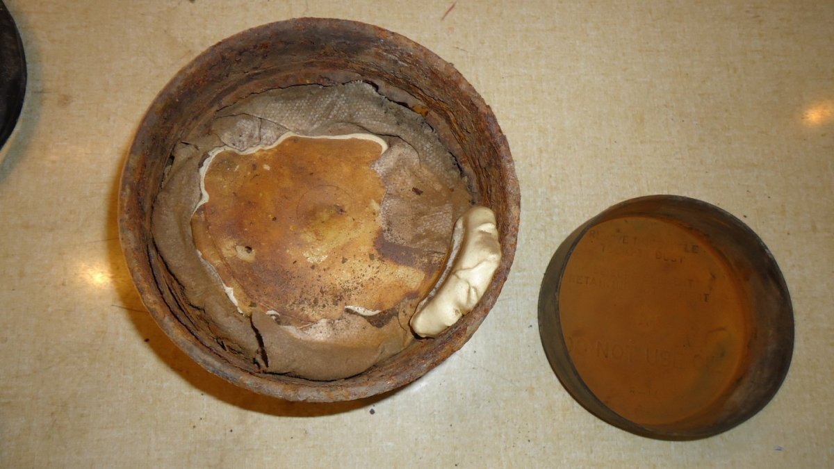

    A little rust...a few holes? No prob, stuff in some paper shop towels...

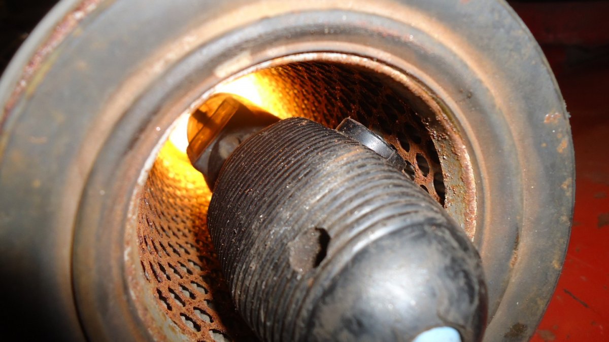

    There's actually a 60w trouble light inside here...
    Ran a compression check. Not good. Poor little Mitsubishi....could barely breathe !
    And if it did, it inhaled all kinds of grit, rust, fibers, etc.
    The engine had to be replaced as it would only start when it was warm out, or with ether.
    Not ideal for snow-blowing.
    New filter ***embly,

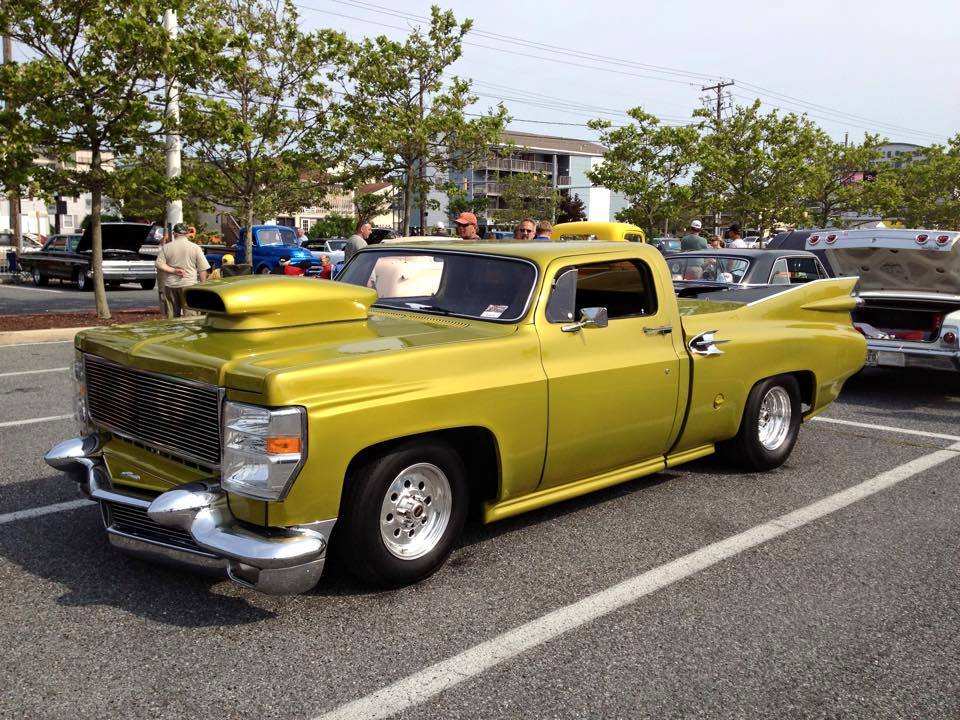

  2. Ok , ok, ok ok ok....... I am not smart enough to figure it out on my own.
    What in the **** is the trailer hitch doing on that front end ?!?!
    I am speechless at everything I have seen there is just so much wrong with everything on this .... um.... car?!?
    jimmy bruns, lewk, Bearcat_V8 and 9 others like this.
  3. gatz
    Joined: Jun 2, 2011
    Posts: 2,269
    gatz
    quick-change front end ?
    The headlight aiming looks like it would be easy from the ****pit tho'
    Nicholas Coe, AldeanFan and 62rebel like this.
  4. Joe H
    Joined: Feb 10, 2008
    Posts: 1,876
    Joe H
    Trailer ball appears to being used as a ball joint attaching the front axle to the frame with short leaf springs under them. Wonder what the rod and pivot does running up towards the front? On top of all that, it has coil-over shocks along with the cut down leaf springs!
  5. 56don
    Joined: Dec 11, 2005
    Posts: 10,333
    56don
    Looks like a school experiment on how to design a suspension using no conventional or logical engineering.
    classiccarjack and vetteguy402 like this.
  6. 62rebel
    Joined: Sep 1, 2008
    Posts: 3,233
    62rebel
    Are those Ford "twin-I beam axles"? WTF..... I feel like I'm watching "Junkyard Wars"
  7. BJR
    Joined: Mar 11, 2005
    Posts: 11,336
    BJR
    That is without a doubt the rattiest rat rod I have ever seen!!!:(

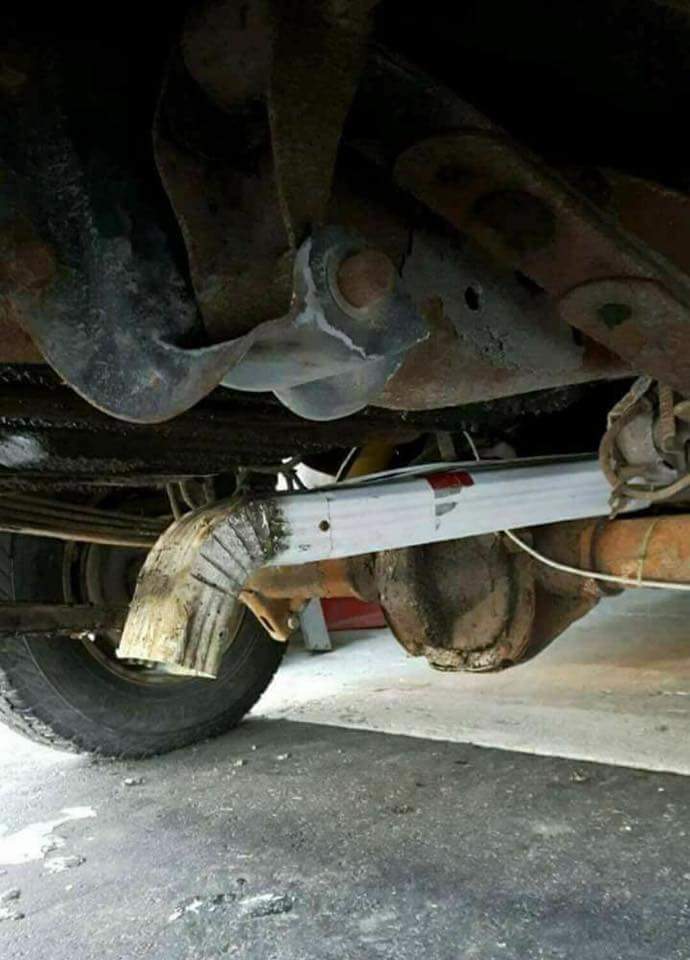

    I always loved this idea....never thought of buying an exhaust system at Home Depot. Need to make sure you use the aluminum and not the vinyl though!!!:rolleyes::D
