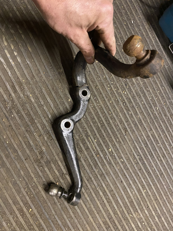

    So, having pretty much sorted the front brakes, (apart from waiting for some black VHT paint to arrive) I have turned my attention to the rear end. I have been scratching my head over what to do about the rear lower shock mounts. I don't want anything to bulky hanging down under the axle tubes and didnt really want to weld to the axle.
    Anyway, after a few false starts I thought about using some old Chevy truck steering arms I had in my leftovers from when i did my '41. I am thinking that I can bolt them to the axle flanges with some spacers. Kind of along the same lines as the F1 mounts up front, but turned upside-down.
    I cut one of them in half and knocked out the steering ball. Once I have pressed some bushes in I can screw in some shock studs. With a bit of heat and tweaking I think they should look ok.
    Here is what i have so far:
    I will turn up some spacers this weekend to see if I can get it to offer-up something like sensibly. Final position will be determined once I have the torque tube hooked up and the axle set at the correct angle.
    A very kind gent is helping me to get some truck water pumps sorted, so until they arrive, final motor and gearbox angle is undecided. There is also the option of z-ing the frame to get the back end down, which has been mentioned, but i'm not sure on that at the moment.........

    I made up some spacers and welded one of the ***emblies together today. I had to make a thin bush to thread the shock stud into. Also the bolt spacing was out by about 1/4” so I cut between the two mounting holes and re-welded at the correct distance.
    They need some heat to get the studs into the right position and some finishing off, but look like they will work ok.
