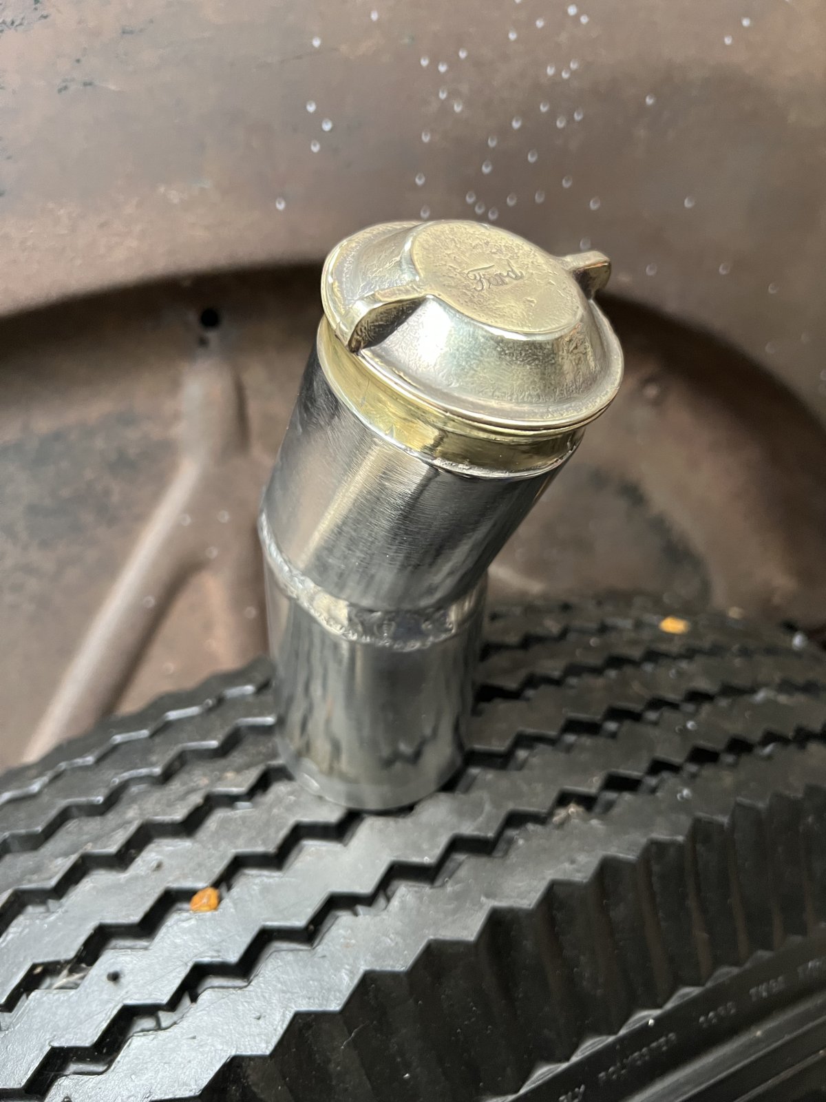

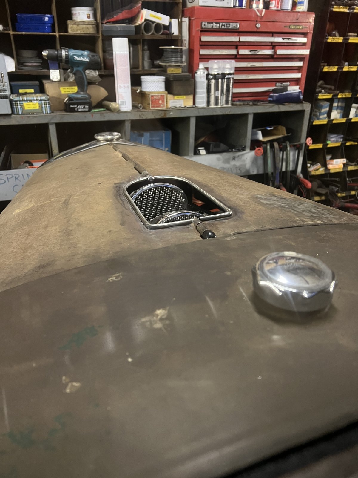

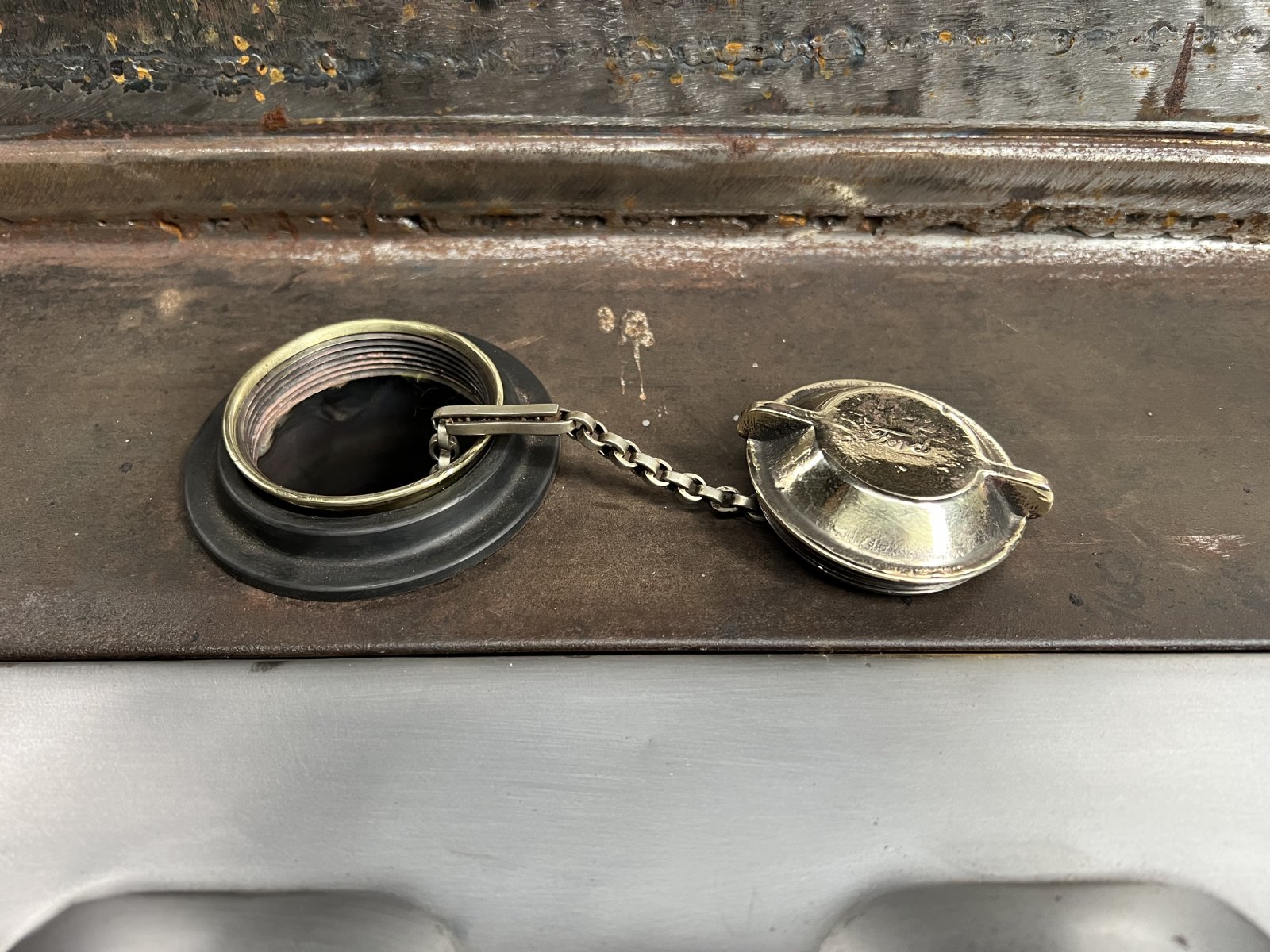

    I’ve finished off the fuel cap and filler neck. Got it sitting right to match the trunk header panel angle.

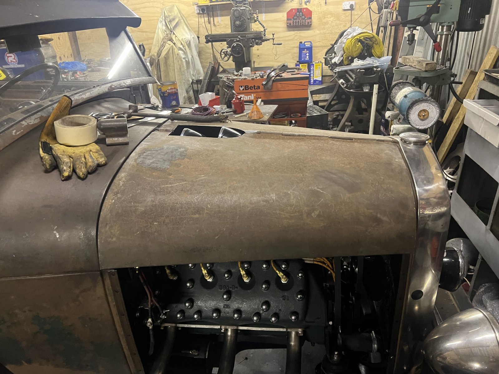

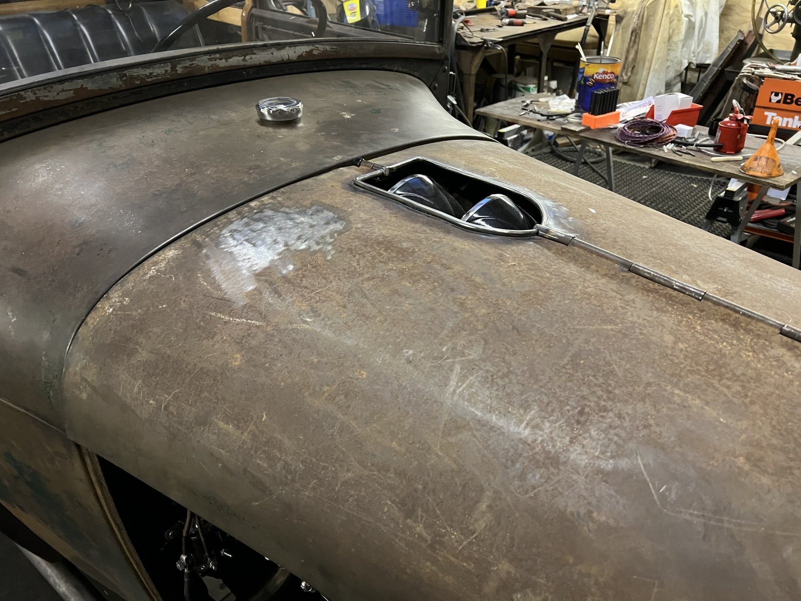

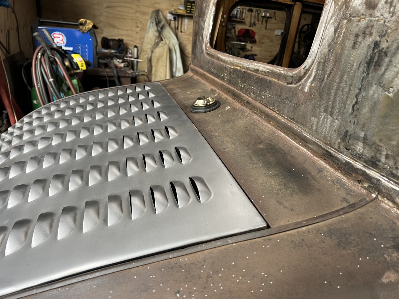

    I’ve made a start on a hood top. Still a bit of finishing required but I wanted to eyeball it in place before I decide how it will end up. I plan to fix the two sides via a strap underneath.

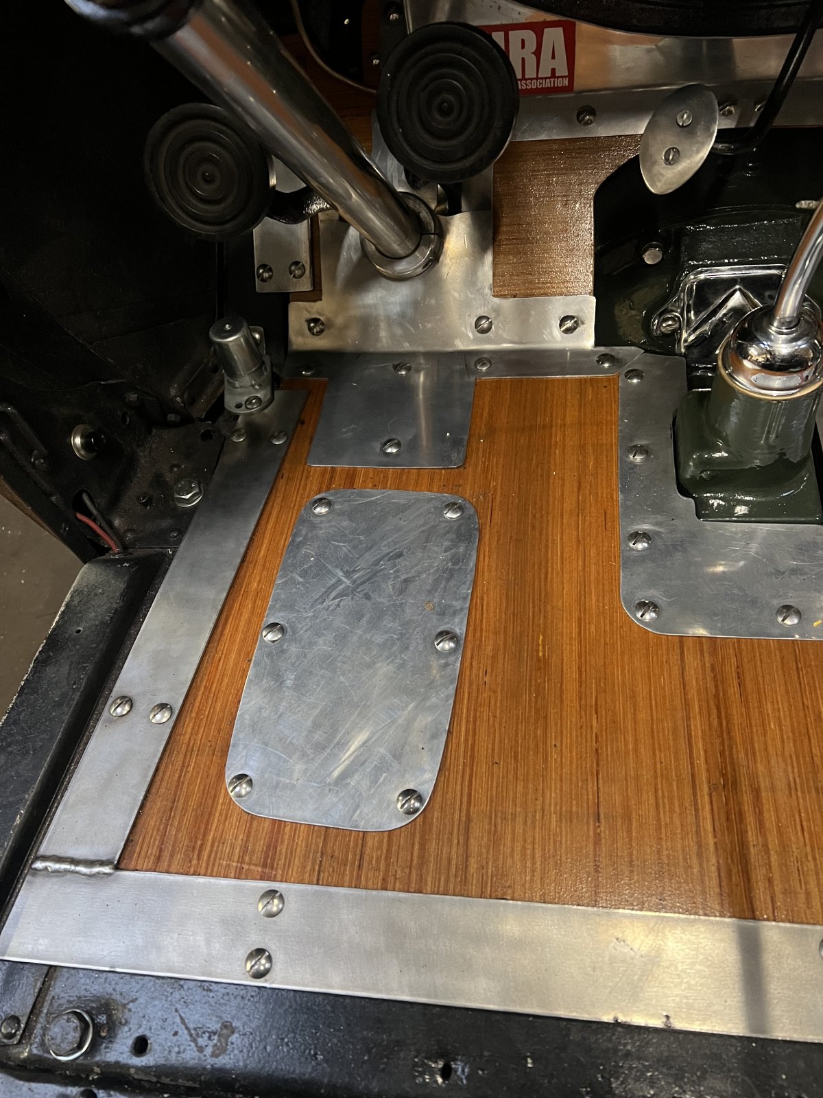

    Thanks Ian. It’s another area of the project that sounded ok until I did it, then I wasn’t happy with the raw edge of the sheet steel.

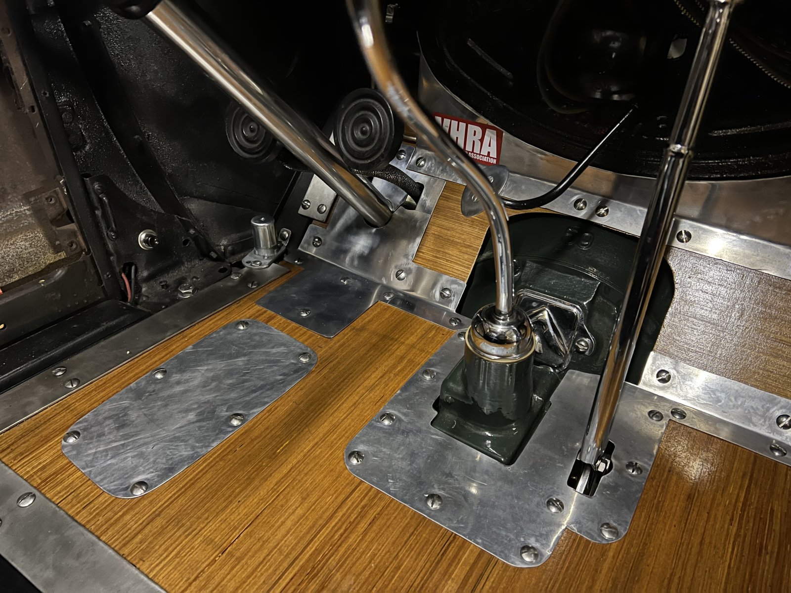

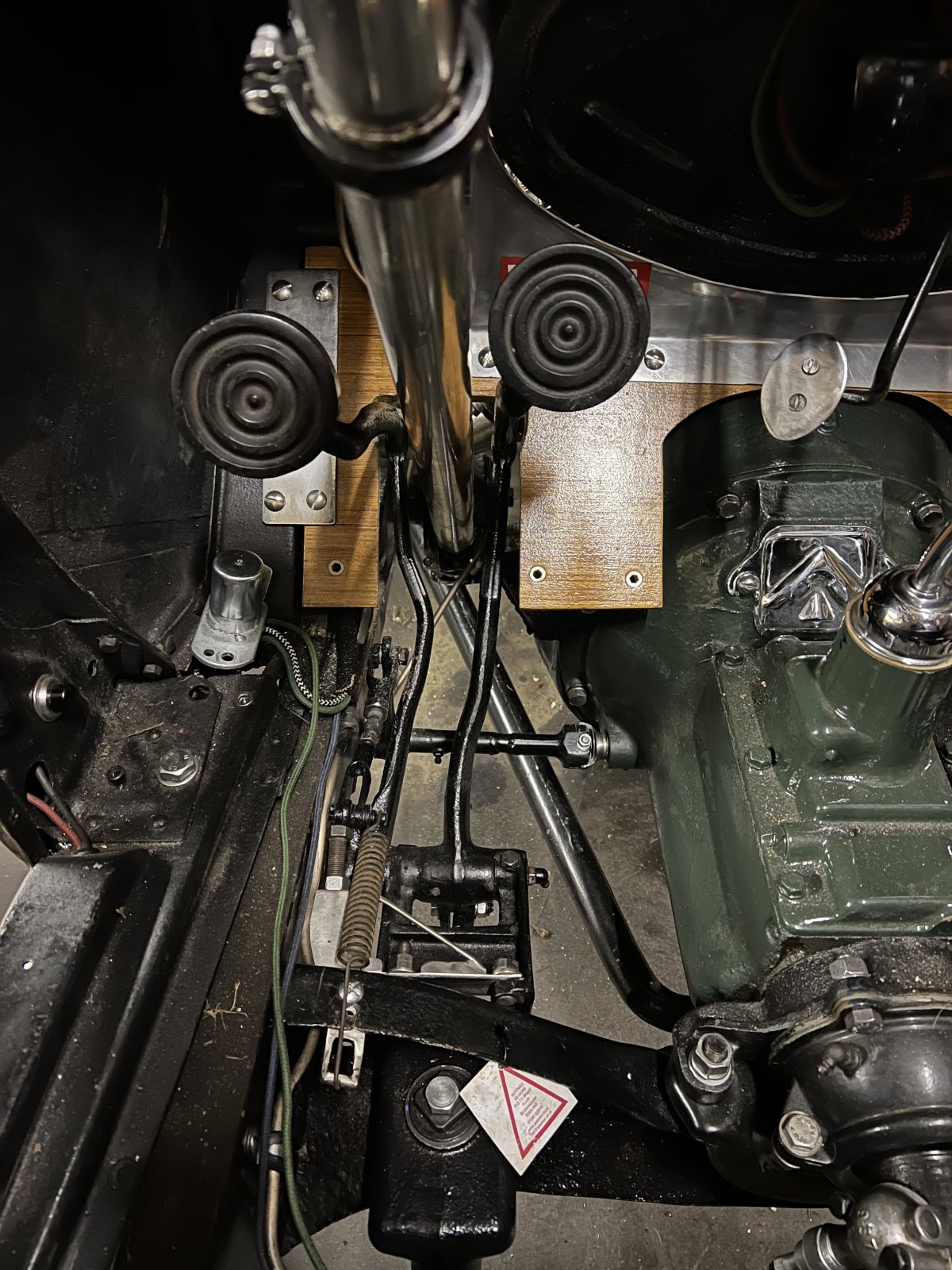

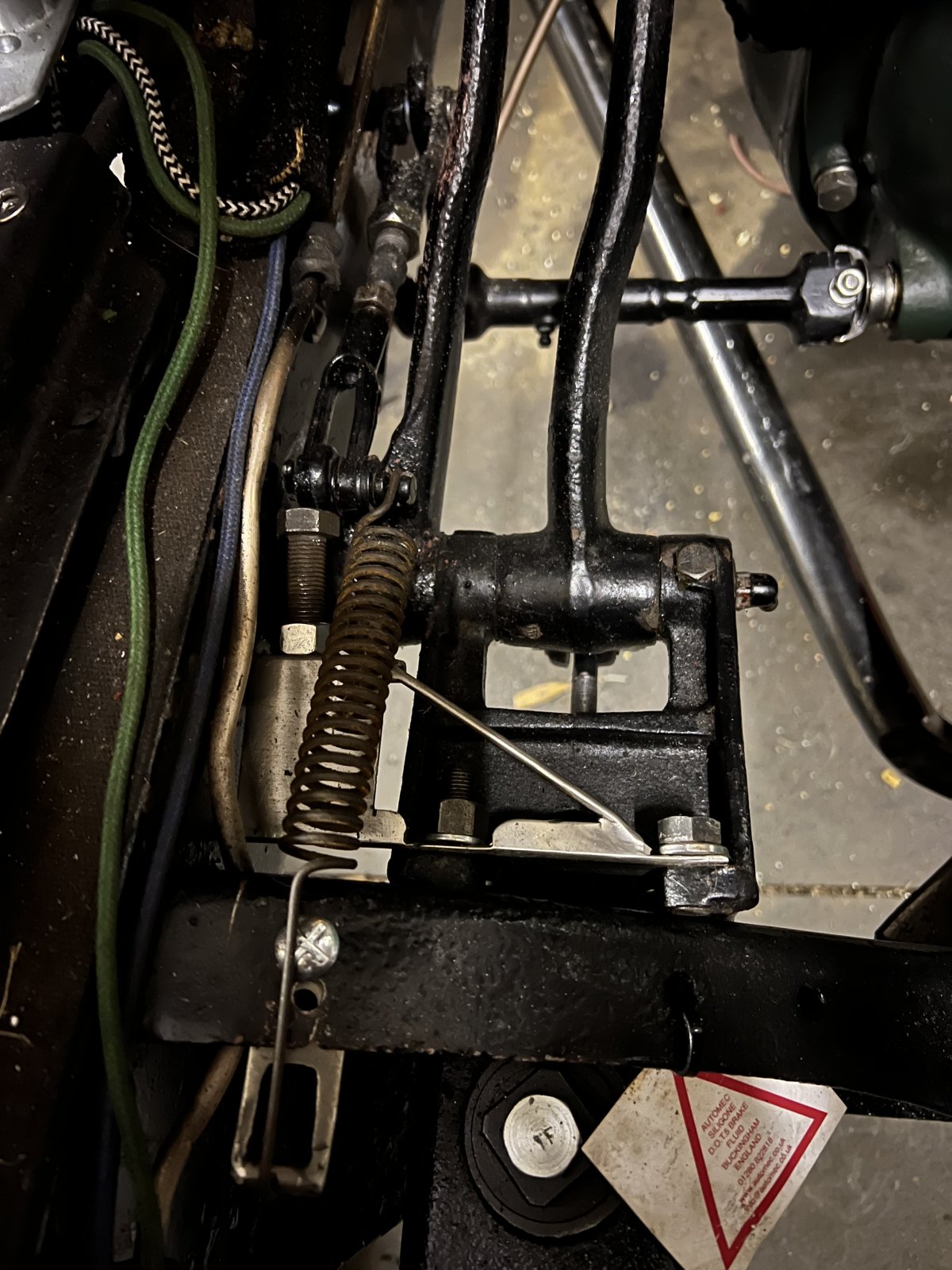

    I have also managed to get the pedal surround changed. It looks much better than the slots I had on the previous setup. I made a tweak to the profile of the pedals and made an adjustable clutch stop to keep the majority of the pedals below the floor level.

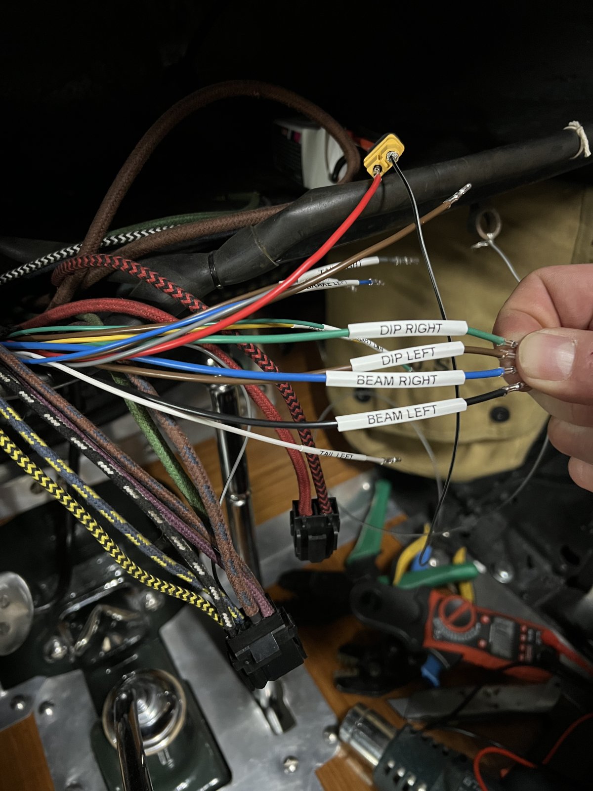

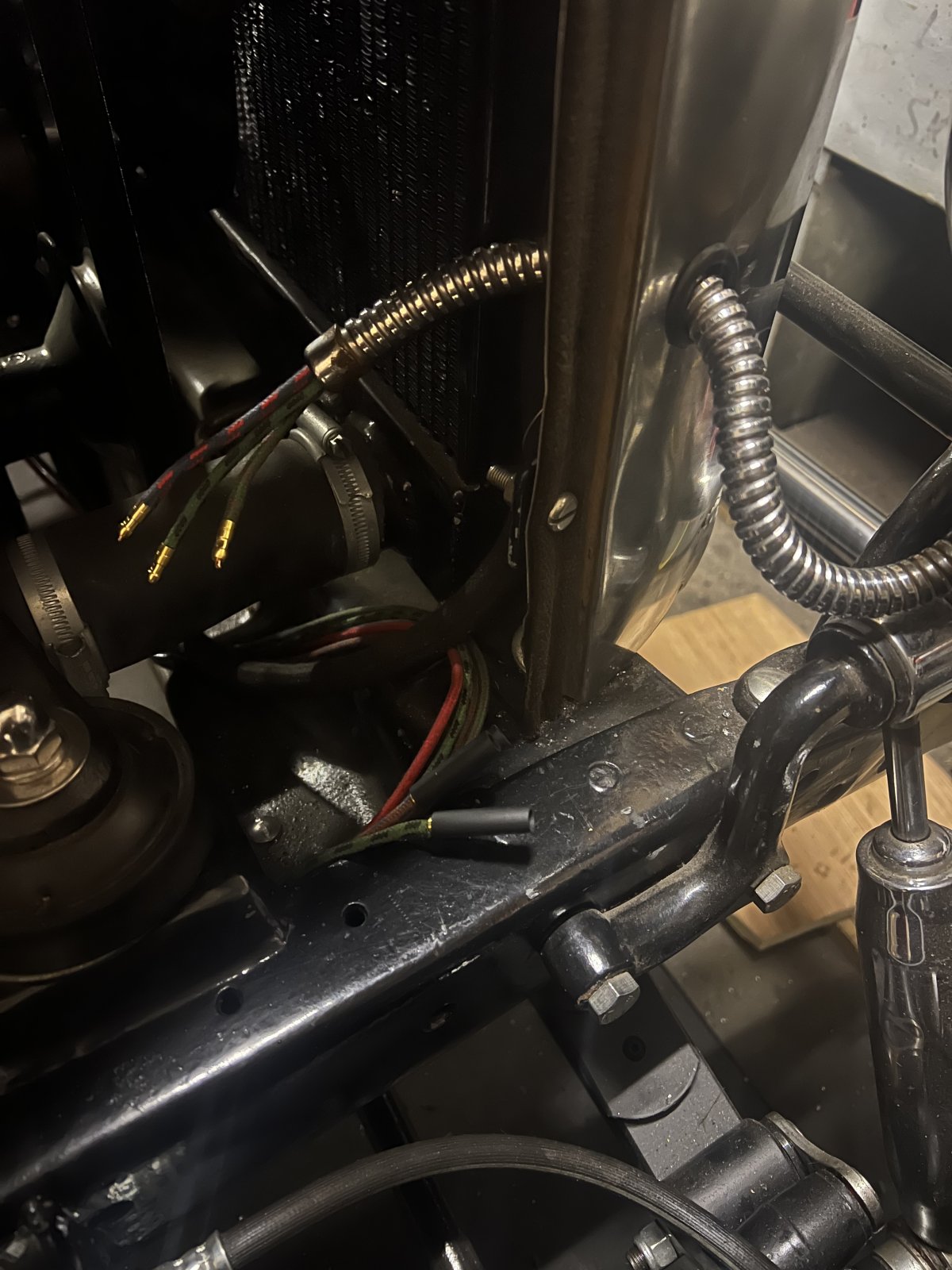

    Still working on wiring…..
    9AEB7B1C-EA39-4F42-9770-8A33689A17E4.jpeg 4DCA76AD-B992-4512-9C36-41E398DA7FE5.jpeg

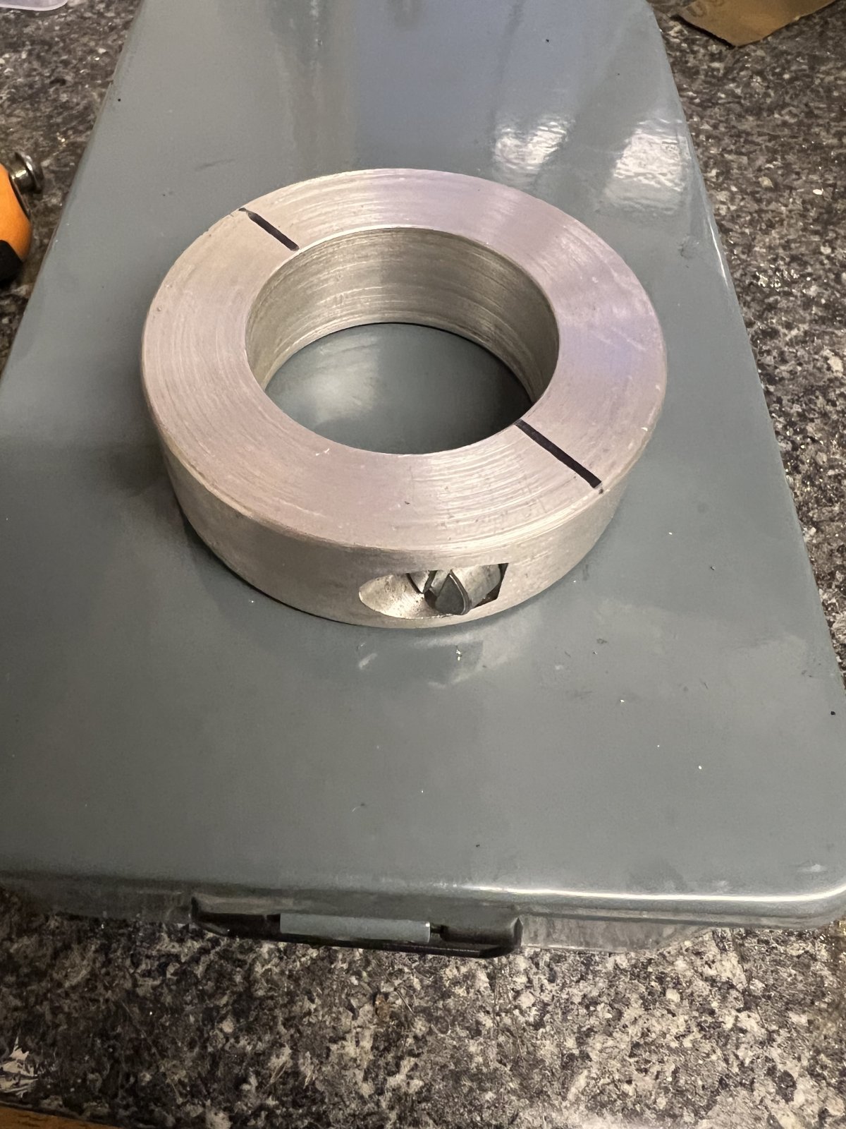

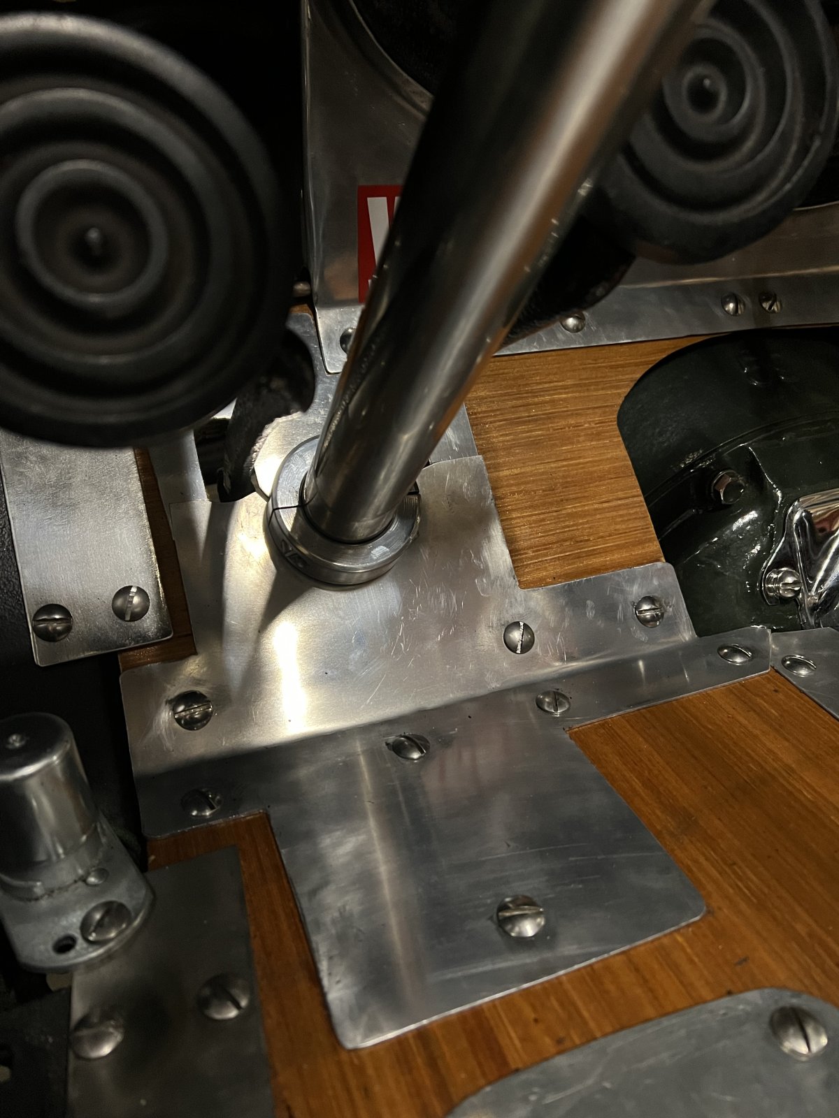

    And I made up a little alloy collar to go at the base of the steering column where it meets the floor panels.

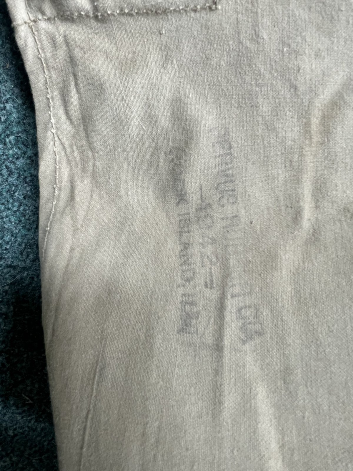

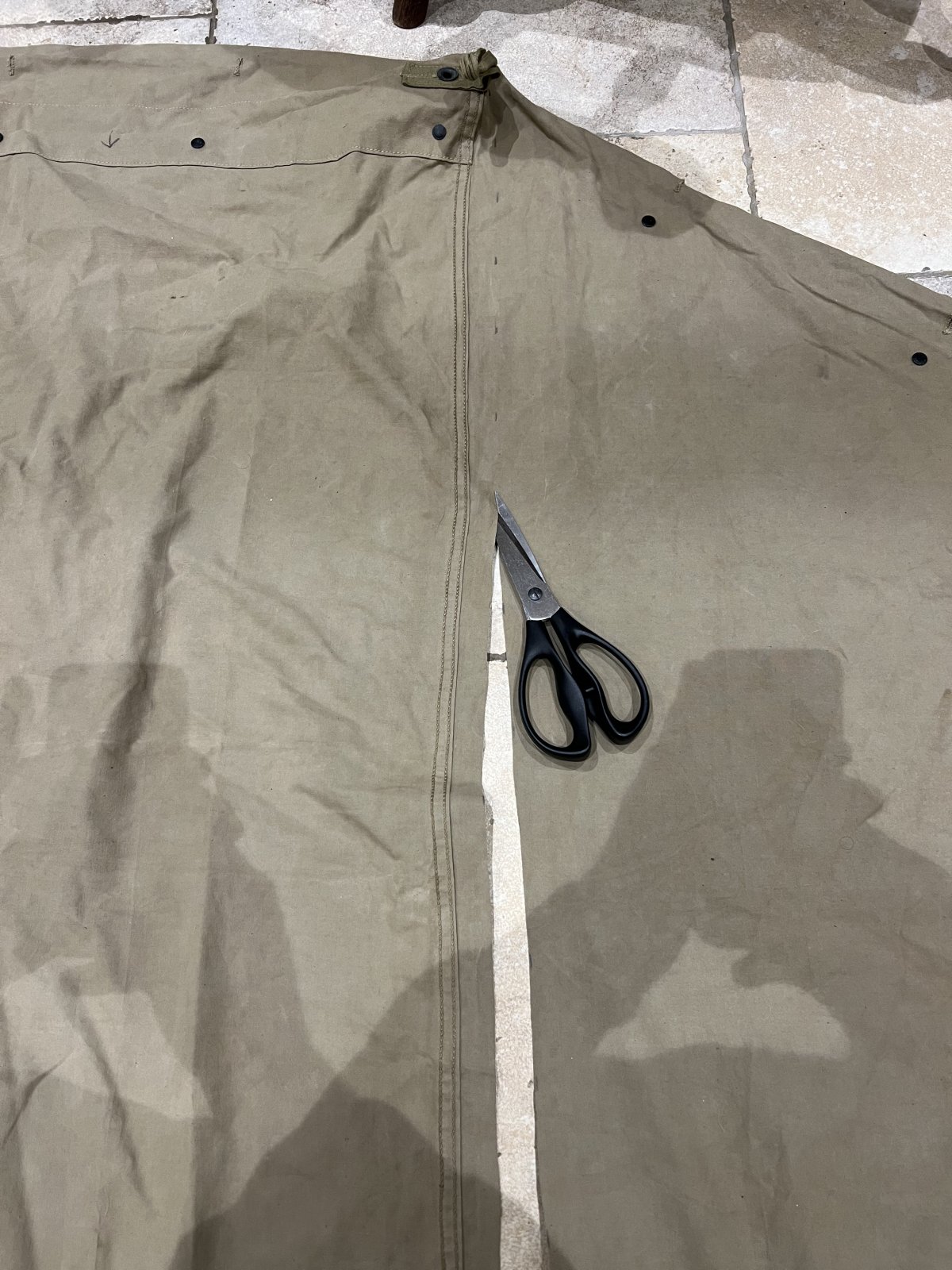

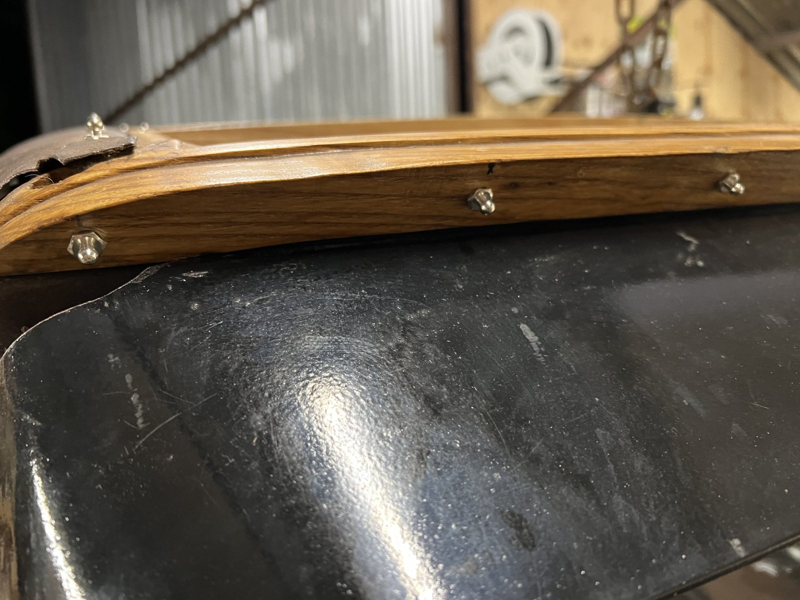

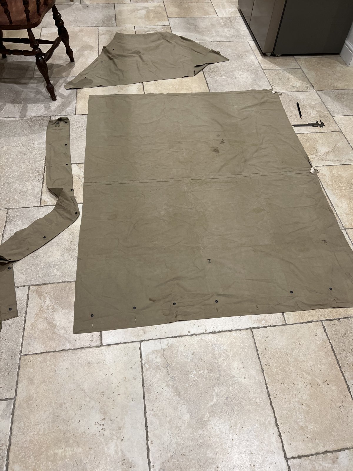

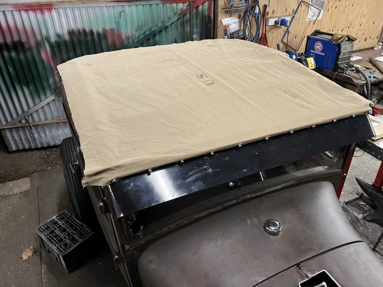

    Made a start on the roof panel. I’m going to try using an old pup tent as a temporary cover, secured with Tenax fasteners. Not looking for 100% waterproof, just something to keep the worst off that can be rolled up and stored in the trunk for emergency use.

  16. You could re-waterproof that canv*** to improve its ability to repel water.
    Originally it was likely given an oil skin treatment which you can easily redo yourself.
    Here's a YouTube showing the process:
    NOTE: I don't think you need to add the color to it for it to work (but I'm not sure about that)
    Another method to waterproof canv*** is to make it into a "Waxed Canv***" (None the less although this works well on new canv*** it might not be compatible over top of the army's original treatment so perhaps test it on some s**** first.)
    Here's a YouTube showing that process:

    Thanks Gregger. Those are interesting videos.
    I do plan to re-proof it some way, as it's pretty thin. There is a product over here called 'Fabsil' that is available in a can or a spray for not a lot of money. I was going to try that first. It's not as traditional as dressing as a frontiersman and applying it in the woods, but maybe it will get me a decent result :). I certainly don't want to color the material I have, or even make it too much darker if I can help it.
    Being a country boy, I have been known to wear a 'waxed jacket' from time to time, which is made with a similar material to the second youtube clip. The re-proofing for those coats is also available over here in spray form.
    We (read: my wife) are going to fold a hem on it and I have some 1.1/2" cotton webbing on the way to help strengthen the seams where the Tenax fittings are attached. We may also lay some across-ways in line with the wood roof bows to protect them from rubbing through.

    I have made a bit more progress on the insert with the help of my resident seamstress. It will need a couple of tucks at the front corners.

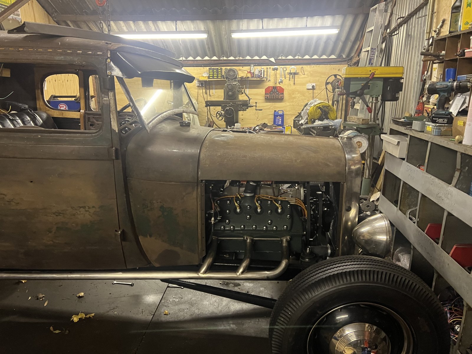

    It’s nice to finally have some decent weather. I have been playing about trying to get the motor set up. Still getting a bit of a stumble as I set off, but otherwise ok. Could be ignition as changing jets doesn’t seem to make much difference.
