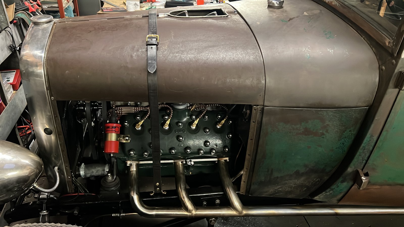

    Well Pendine Sands Hotrod Races are only a few weeks away and I still have a bit of a list of prep jobs to do.
    @uncle max has kindly given me some direction on carb setup. I hadn’t changed the power valves, believing that it was the main jets or idle screws causing my problems. I now understand that the power valves can affect performance when standing on the throttle, even from idle. Mine must have been dumping way too much fuel in. With #69s in it seems much more responsive. I will try and do some more road testing this weekend.
    Last night I got my race cl*** on the car and fitted the bonnet strap, as I wasn’t happy with my previous attempts on either.

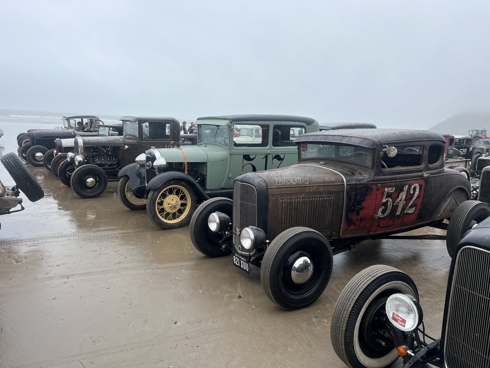

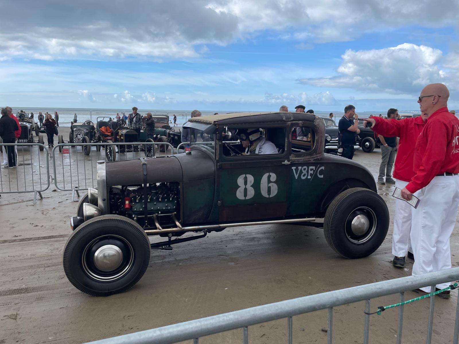

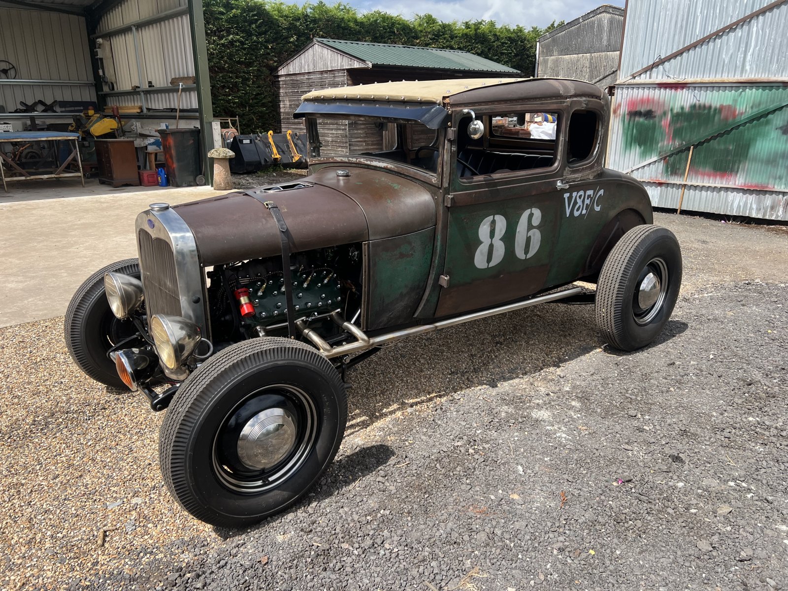

    Well the wee coupe made it down to Pendine Sands for the annual beach races and my best average speed was 76.75mph at the end of the 1/2 mile track.
    It ran well but still has more in it I am sure.
    I had a great time though and it was nice to be back on the race card (it didnt feel the same being a spectator last year)!
    Thanks to the team that put the event together.
