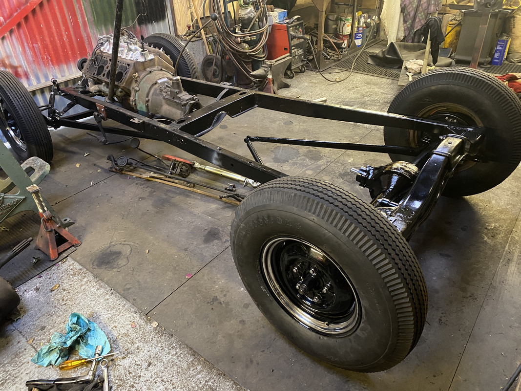

    I have been spending some time on the rear end and have removed the axle and hubs, backing plates etc, checked it all over and replaced some gaskets. Also given it all a quick blast of paint.
    I got it all put back together today and the finished shock mounts are finally fitted in place. All looks ok so far and would have been done much quicker if i hadn't accidentally put the axle back in upside down in my haste to get the rear spring mounted. I made a basic spring spreader from a tracor top link and a couple of bits of angle iron welded to the ends.

    Its all looking great Mark, your making good progress as well . Good to see you are finding help from around the globe. The pumps will definitely save having to make mods to the ch***is mounts, or a heath robinson affair to convert the car pumps .
    It all looks like its coming along great. Im guessing the axle internals were looking good and the slight issue with the shaft end is going to be fine ?
    Would like to see the spreader you made up for the rear spring , I see parts of it laying under the ch***is but would be good to see how it worked.. Bet it shocked you just how much these old ford springs will need to extend before they can be fitted .. Tractor ;ink spreader is thinking out the box but its surprising just how often common parts can have an alternative use .. :) Hope you are still finding everything as described and no junk .. :)
    Rear shock mounts are cool and a great departure from the usual , really clever , prepare to be copied lol..

    No junk here, Ian just treasure!
    The axle looks fine - certainly good enough to have a go with.
    I’m a bit embarr***ed to show pictures of the spring spreader as it’s a bit ‘agricultural’ and was just made to serve a purpose. It worked fine though, once I had greased the threads a bit. Those springs have some power!
    I will send you a picture tomorrow. It wouldn’t work with a spring over axle setup because of the diff getting in the way.

    Here’s the spring spreader, Ian. Ugly but quick and functional.....
