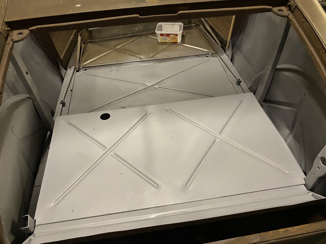

    Well i hope you put some cushion on that seat. It dont look comfy at all. Eeeee. Lol. Glad to see your making progress, at least. I did notice the battery hole in the floor board is on the wrong side. Floorboard just upside-down or is that for a reason?
  5. Little Terry
    Joined: Oct 17, 2007
    Posts: 817
    Little Terry
    The floor panel was just in the way so I dropped it in. Hopefully the battery will end up behind the seat.
